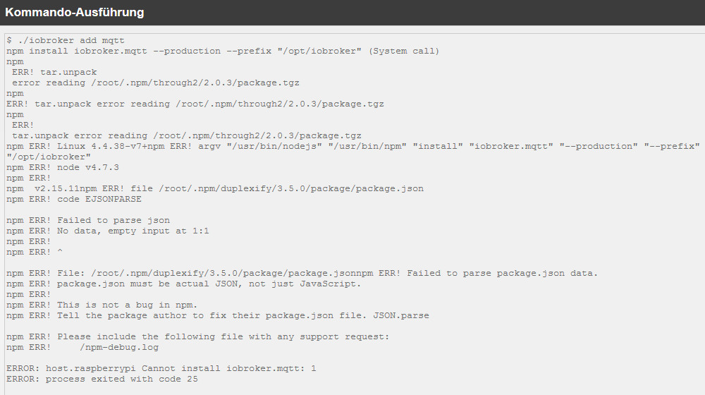

      versuche gerade den MQTT Adapter 1.3.2 zu installieren.
      Bekomme dabei aber unten stehende Fehlermeldung.
      Jemand einen Tipp woran das liegen könnte?

          Wenn ich versuche das direkt auf linux zu installieren bekomme ich folgden Fehlermeldungen:
          ` > pi@raspberrypi:/ $ cd opt
          pi@raspberrypi:/opt $ cd iobroker
          pi@raspberrypi:/opt/iobroker $ npm cache clean
          pi@raspberrypi:/opt/iobroker $ npm install iobroker.qmtt
          npm ERR! Linux 4.4.38-v7+
          npm ERR! argv "/usr/bin/nodejs" "/usr/bin/npm" "install" "iobroker.qmtt"
          npm ERR! node v4.7.3
          npm ERR! npm v2.15.11
          npm ERR! code E404
          npm ERR! 404 Registry returned 404 for GET on https://registry.npmjs.org/iobroker.qmtt
          npm ERR! 404
          npm ERR! 404 'iobroker.qmtt' is not in the npm registry.
          npm ERR! 404 You should bug the author to publish it (or use the name yourself!)
          npm ERR! 404 It was specified as a dependency of 'iobroker.core'
          npm ERR! 404
          npm ERR! 404 Note that you can also install from a
          npm ERR! 404 tarball, folder, http url, or git url.
          npm ERR! Please include the following file with any support request:
          npm ERR! /opt/iobroker/npm-debug.log
          pi@raspberrypi:/opt/iobroker $ `

              ` > pi@raspberrypi:/opt/iobroker $ sudo npm install mqtt
              npm ERR! tar.unpack error reading /root/.npm/through2/2.0.3/package.tgz
              npm ERR! argv "/usr/bin/nodejs" "/usr/bin/npm" "install" "mqtt"
              npm ERR! file /root/.npm/typedarray/0.0.6/package/package.json
              npm ERR! code EJSONPARSE
              npm ERR! Failed to parse json
              npm ERR! No data, empty input at 1:1
              npm ERR!
              npm ERR! ^
              npm ERR! File: /root/.npm/typedarray/0.0.6/package/package.json
              npm ERR! Failed to parse package.json data.
              npm ERR! package.json must be actual JSON, not just JavaScript.
              npm ERR!
              npm ERR! This is not a bug in npm.
              npm ERR! Tell the package author to fix their package.json file. JSON.parse
              pi@raspberrypi:/opt/iobroker $ ^C

                Wenn Du mal so versuchst auf /root/.npm/through2/2.0.3/package.tgz zuzugreifen?! Ist das File da? Kannst Du es lesen?
                Noch genug Platz da?
                  heinzie last edited by
                  Das Verzeichnis /root/ ist bei mir komplett leer.
                  Nach Aussage des Dateimanagers noch 9,4Gb frei
                  Ich muss aber dazu sagen, dass ich kein Linux Experte bin. Virelleicht mache ich auch generell etwas falsch.

                      @heinzie:
                      Habs hinbekommen `
                      Was war das Problem oder wie hast du es gelöst?
                        @Jey Cee:
                        @heinzie:
                        Habs hinbekommen `
                        Was war das Problem oder wie hast du es gelöst? `
                        Ich habe direkt auf dem raspberry den Befehl: node iobroker.js add mqtt eingegeben.
                        Danch lief es.
                          liegt das PAket noch nicht bei npm??
