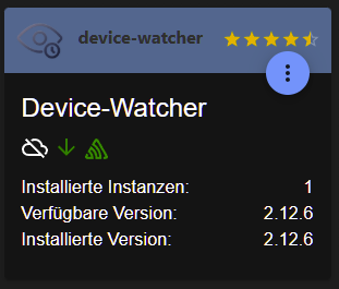

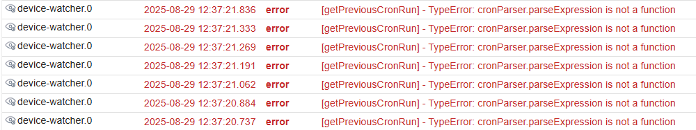

                Fichte @ilovegym last edited by
                @ilovegym
                Auch hier (2.12.6) habe ich den selben Fehler.

                                      2025-09-04 22:59:03.010  - error: device-watcher.0 (1806) [getPreviousCronRun] - TypeError: cronParser.parseExpression is not a function
                                      2025-09-04 22:59:03.060  - error: device-watcher.0 (1806) [getPreviousCronRun] - TypeError: cronParser.parseExpression is not a function
                                      2025-09-04 22:59:03.112  - error: device-watcher.0 (1806) [getPreviousCronRun] - TypeError: cronParser.parseExpression is not a function
                                      2025-09-04 22:59:03.162  - error: device-watcher.0 (1806) [getPreviousCronRun] - TypeError: cronParser.parseExpression is not a function
                                      2025-09-04 22:59:03.205  - error: device-watcher.0 (1806) [getPreviousCronRun] - TypeError: cronParser.parseExpression is not a function
                                      2025-09-04 22:59:03.248  - error: device-watcher.0 (1806) [getPreviousCronRun] - TypeError: cronParser.parseExpression is not a function
                                      2025-09-04 22:59:03.326  - error: device-watcher.0 (1806) [getPreviousCronRun] - TypeError: cronParser.parseExpression is not a function

                                        Thomas Braun Most Active @Fichte last edited by Thomas Braun
                                        @fichte sagte in Test Adapter Device-Watcher v2.x.x GitHub/Latest:
                                        Noch immer das selbe.
                                        Zumindest die grundsätzlichen Kinken sind jetzt raus.
                                        Was sagt denn
                                        cd /opt/iobroker/ && npm ls cron-parser
                                            @fichte
                                            Hab den Adapter auch gerade mal installiert. Schaut hier ähnlich aus:
                                            2025-09-04 23:21:15.515  - info: device-watcher.0 (1054123) starting. Version 2.12.6 in /opt/iobroker/node_modules/iobroker.device-watcher, node: v24.7.0, js-controller: 7.0.7
                                            2025-09-04 23:21:15.547  - info: device-watcher.0 (1054123) Number of selected adapters to monitor devices: 1. Loading data from: Alexa2 ...
                                            2025-09-04 23:21:16.753  - error: device-watcher.0 (1054123) [getPreviousCronRun] - TypeError: cronParser.parseExpression is not a function
                                            2025-09-04 23:21:16.763  - error: device-watcher.0 (1054123) [getPreviousCronRun] - TypeError: cronParser.parseExpression is not a function
                                            2025-09-04 23:21:16.867  - error: device-watcher.0 (1054123) [getPreviousCronRun] - TypeError: cronParser.parseExpression is not a function
