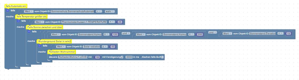

      Also ich habs jetzt mal so, und das kopiere ich mir dann für jeden Rollladen…..oder geht das einfacher?
      (Irgendwas muss ich mir noch als Trigger raussuchen)
      Skript
      ! <block 1999/xmlns="<URL url=" http:/www.w3.org/xhtml"="">http://www.w3.org/1999/xhtml" type="controls_if" id="vytCdb[Ng.EJDS[[s@[o" x="-237.20001220703125" y="63.40000915527344">
      ! <value name="IF0"><block type="logic_compare" id="pgWP!(4LyzbJg).YMuRd"><field name="OP">EQ</field>
      ! <value name="A"><block type="get_value" id="0p%Kud3^VlO,D(lb~;ir"><field name="ATTR">val</field>
      ! <field name="OID">javascript.0.Sonnenschutz.SonnenschutzAutomatik</field></block></value>
      ! <value name="B"><block type="logic_boolean" id="e1{v5,e?@E.+Etw#F/;f"><field name="BOOL">TRUE</field></block></value></block></value>
      ! <statement name="DO0"><block type="comment" id="b[XN;U3CsDT+EkNkk:b"><field name="COMMENT">falls Temperatur größer als</field>
      ! <next><block type="controls_if" id="~[koET{x;Q-?UW2bi.NA"><value name="IF0"><block type="logic_compare" id="#%uUE
      n.m++GEg%:yG:"><field name="OP">LT</field> ! <value name="A"><block type="get_value" id="BVHOu#iJs)O]~hBj0Z2"><field name="ATTR">val</field>
      ! <field name="OID">hm-rpc.0.LEQ0029551.1.TEMPERATURE</field></block></value>
      ! <value name="B"><block type="math_number" id="mmn+Sn=4wdRXy@iAP,cF"><field name="NUM">25</field></block></value></block></value>
      ! <statement name="DO0"><block type="comment" id="jXF?-Y:{@@qtAx-+Yp"><field name="COMMENT">Falls Sonne zwischen und über</field> ! <next><block type="controls_if" id="c3w;(.Pt,s%msH@B=U*o"><value name="IF0"><block type="logic_operation" id="xs!vFbfOHz:p?UYMT7aX"><field name="OP">AND</field> ! <value name="A"><block type="logic_operation" id="0M]mLW7-)TT!l2cVJiQ%"><field name="OP">AND</field> ! <value name="A"><block type="logic_compare" id="ITuAyTR#wt/*o|Y2.#!2"><field name="OP">GTE</field> ! <value name="A"><block type="get_value" id="GkB]v)%@jvuUI:c9/3NB"><field name="ATTR">val</field> ! <field name="OID">javascript.0.Sonnenstand.Azimut</field></block></value> ! <value name="B"><block type="math_number" id="Yf*/*?Qh#z.CyiWJ?GA]"><field name="NUM">120</field></block></value></block></value> ! <value name="B"><block type="logic_compare" id="MAHG=T*VY9_7ux+f{jlZ"><field name="OP">LTE</field> ! <value name="A"><block type="get_value" id="3:o_yWEOgLYzSp!T1}?*"><field name="ATTR">val</field> ! <field name="OID">javascript.0.Sonnenstand.Azimut</field></block></value> ! <value name="B"><block type="math_number" id="afrB!*DQ.-7]boypq#BR"><field name="NUM">200</field></block></value></block></value></block></value> ! <value name="B"><block type="logic_compare" id="R7#2BMUj*C-[uHC/*5t{"><field name="OP">LT</field> ! <value name="A"><block type="get_value" id=",LqoRFMx}A5(%?%hwdU"><field name="ATTR">val</field>
      ! <field name="OID">javascript.0.Sonnenstand.Elevation</field></block></value>
      ! <value name="B"><block type="math_number" id="4,zc,}lwSWi
      RlLPmLz;"><field name="NUM">15</field></block></value></block></value></block></value>
      ! <statement name="DO0"><block type="comment" id="w[o4;wby2%@fc6Ayx?J@"><field name="COMMENT">Wunderground Solar in w/m2</field>
      ! <next><block type="controls_if" id="cL1_JBwU-6{C3(=`vO_#"><value name="IF0"><block type="logic_compare" id="ecnhf8*DX-OE}.n5sB.E"><field name="OP">LTE</field>
      ! <value name="A"><block type="get_value" id="4Q~04F~|8h-V##PP973|"><field name="ATTR">val</field>
      ! <field name="OID">weatherunderground.0.current.solarradiation</field></block></value>
      ! <value name="B"><block type="math_number" id="eJw|I)p]?;HgKx__x}xk"><field name="NUM">50</field></block></value></block></value>
      ! <statement name="DO0"><block type="comment" id="~t/RV}#jzNJ?s?Eop4RO"><field name="COMMENT">Rollladen Wohnzimmer</field>
      ! <next><block type="control" id="WW}!p}Q+[nzWUI9]{eQP"><mutation delay_input="true"></mutation>
      ! <field name="OID">hm-rpc.0.LEQ0631546.1.LEVEL</field>
      ! <field name="WITH_DELAY">TRUE</field>
      ! <field name="DELAY_MS">3000</field>
      ! <field name="CLEAR_RUNNING">FALSE</field>
      ! <value name="VALUE"><block type="math_number" id=",Mn~re9n.6yTWG,XFDYB"><field name="NUM">35</field></block></value></block></next></block></statement></block></next></block></statement></block></next></block></statement></block></next></block></statement></block>

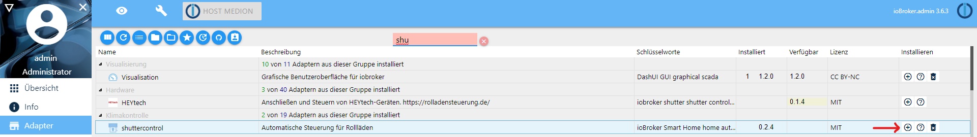

                  • sigi234
                    sigi234 Forum Testing Most Active @MartinK. last edited by
                    @MartinK sagte in [Frage] Beschattung Rollladensteuerung:
                    @e-s Sorry für die Fragen, aber ich noch relativ neu in Sachen ioBroker & co... wie wird denn diese neue Instanz hinzugefügt? 😕
                    MartinK. 1 Reply Last reply Reply Quote 0
                    • MartinK.
                      MartinK. @sigi234 last edited by
                      @sigi234 Vielen Dank! 😉 Habe es gerade auch gefunden 🙂
