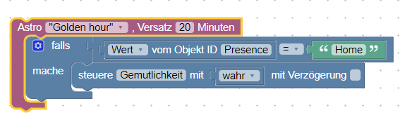

      Blockly...
      Ich frage den state
        "type": "state",
        "common": {
          "modify": "",
          "name": "Presence",
          "type": "string",
          "role": "info",
          "read": true,
          "unit": "",
          "write": true,
          "states": {
            "AWAY": "Away",
            "HOME": "Home"
      mit diesem simpel Blockly ab:
      Funktioniert nur nicht. Warum?
        MCU @Thomas Braun last edited by
        @thomas-braun
        Wert = HOME?
          Thomas Braun Most Active @MCU last edited by
          @mcu
          Na klar... Wie doof von mir...
