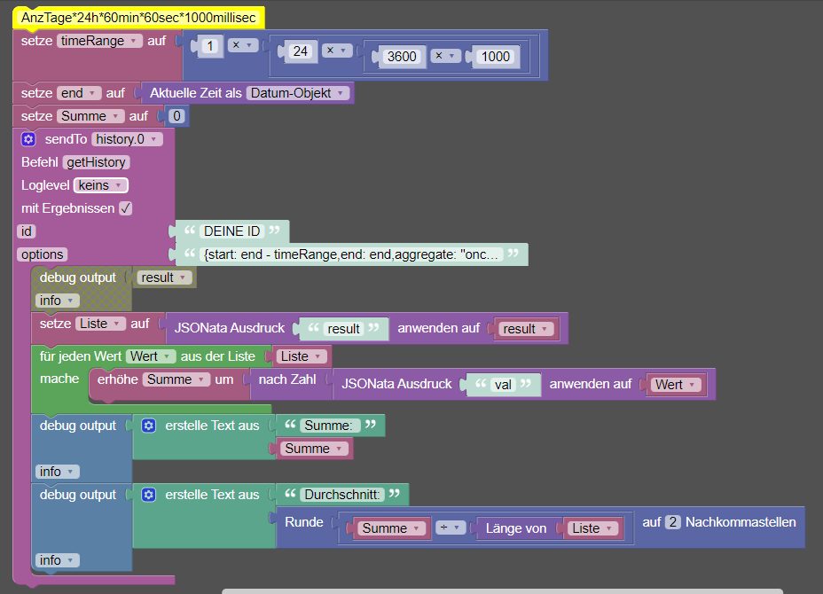

      ich habe einen täglichen Autarkie-Wert meiner Solaranlage. Bei diesem ist die History an und wird für 1 Jahr gespeichert.
      Wie kann ich (am liebsten mit Blockly) nun den gesammten Mittelwert über die History ausgeben?
        MCU last edited by MCU
        @caravandriver
        DEINE ID ersetzen
         <variables>
           <variable id="WX[:Tk-|~F2Z[odL2-!]">timeRange</variable>
           <variable id="gH-;kXfKuQjqeAAq)RR2">end</variable>
           <variable id="iw:GM1Yv=^4(|dJHog`+">Summe</variable>
           <variable id="vl)04H}3D;^/v=azk~1i">result</variable>
           <variable id="Z.VC)8^?qXuW0hD)HGzh">Liste</variable>
           <variable id="0bVTJYJUF1nDSgr|FqjF">Wert</variable>
         </variables>
         <block type="comment" id="Jddp97d8(p]]@YM,JUEf" x="213" y="-13">
           <field name="COMMENT">AnzTage*24h*60min*60sec*1000millisec</field>
             <block type="variables_set" id="{zrregDEN?Me90/1d~lJ">
               <field name="VAR" id="WX[:Tk-|~F2Z[odL2-!]">timeRange</field>
                 <block type="math_arithmetic" id="jk{`:MRK/aD}t|D_=mL}">
                     <shadow type="math_number" id="Q-Eba)+]Uzh(pSNP{?Zi">
                       <field name="NUM">1</field>
                     <shadow type="math_number" id="K2^6p1?S:Q%5j@JGpn,9">
                     <block type="math_arithmetic" id="7QvW=GTfBDPy=c^q2`u|">
                         <shadow type="math_number" id="tISN9oe7GZ.]EZE`k/k$">
                           <field name="NUM">24</field>
                         <shadow type="math_number" id="+RN6KgRYF.I;QZ]Va4#3">
                         <block type="math_arithmetic" id="0Dev)Rk0M/v6ik/t#cCi">
                             <shadow type="math_number" id="1BJXo0-FDwAu!C(Ee)En">
                               <field name="NUM">3600</field>
                             <shadow type="math_number" id="hDA~ywIKil3qy?X)hD=_">
                               <field name="NUM">1000</field>
                 <block type="variables_set" id="Z:{[VL5UGR[U|B7$1SUk">
                   <field name="VAR" id="gH-;kXfKuQjqeAAq)RR2">end</field>
                     <block type="time_get" id="@li@ZJIHB2*f:A1.*rk0">
                       <field name="OPTION">object</field>
                     <block type="variables_set" id="XcRsFZHAbPP)3i!]:{R;">
                       <field name="VAR" id="iw:GM1Yv=^4(|dJHog`+">Summe</field>
                         <block type="math_number" id="mbu!NGm~ag@1C0@bR,^u">
                           <field name="NUM">0</field>
                         <block type="sendto_custom" id="zTEsB]|`}*7!=loVr;bb">
                           <mutation xmlns="http://www.w3.org/1999/xhtml" items="id,options" with_statement="true"></mutation>
                           <field name="INSTANCE">history.0</field>
                           <field name="COMMAND">getHistory</field>
                           <field name="LOG"></field>
                           <field name="WITH_STATEMENT">TRUE</field>
                           <value name="ARG0">
                             <shadow type="text" id="n$)w3oaKN^+JqxvIop9.">
                               <field name="TEXT">DEINE ID</field>
                           <value name="ARG1">
                             <shadow type="text" id="OAj%c%(l{_^5Ps/#P,l.">
                               <field name="TEXT">{start: end - timeRange,end: end,aggregate: "onchange",ignoreNull: true}</field>
                             <block type="debug" id="l}2aWee;4)rLW(C=)6t?" disabled="true">
                               <value name="TEXT">
                                 <shadow type="text" id="^9Wqkh@C#vjBBfugg_z,">
                                   <field name="TEXT"></field>
                                 <block type="variables_get" id="^V*)DgZaz+b/`?J.@MyJ">
                                   <field name="VAR" id="vl)04H}3D;^/v=azk~1i">result</field>
                                 <block type="variables_set" id="}*sVU;}|4L0;2Sy%Ha(R">
                                   <field name="VAR" id="Z.VC)8^?qXuW0hD)HGzh">Liste</field>
                                     <block type="convert_jsonata" id="y/K+8!;G;(i=4$:m(oD}">
                                       <value name="EXPRESSION">
                                         <shadow type="text" id="gIr5s`CKArLh;Vsu/XOI">
                                           <field name="TEXT">result</field>
                                       <value name="TARGET">
                                         <block type="variables_get" id="`3aN!|FL})#Ts?6eu5Nb">
                                     <block type="controls_forEach" id="!5V~~(hgNh4oZs~1--RK">
                                       <field name="VAR" id="0bVTJYJUF1nDSgr|FqjF">Wert</field>
                                       <value name="LIST">
                                         <block type="variables_get" id="iVDQ)r4p]J#_t^n32]?9">
                                       <statement name="DO">
                                         <block type="math_change" id="p1y9KG/7!$n-}*)CcR|l">
                                           <value name="DELTA">
                                             <shadow type="math_number" id="v4~EHLd(pixLSUv.;8?u">
                                             <block type="convert_tonumber" id="!Hy*1iC=ey?EY;o)_h@g">
                                                 <block type="convert_jsonata" id="mDx0%hy}X2#]A~N=qF*W">
                                                     <shadow type="text" id="]DZeDs3~Gl!6Mz!YtGyI">
                                                       <field name="TEXT">val</field>
                                                     <block type="variables_get" id="W7L^(fINXEv5f=CaXoY:">
                                         <block type="debug" id="uGQn4l{4OQV@2~7Qcd2:">
                                           <value name="TEXT">
                                             <shadow type="text" id="spO7GG8y*H5OrJhl}~IH">
                                             <block type="text_join" id="qO8Y4TW#3!r^Z;iJ8ox2">
                                               <value name="ADD0">
                                                 <block type="text" id="2b(YU/$^*Pnts+)^LD4C">
                                                   <field name="TEXT">Summe: </field>
                                               <value name="ADD1">
                                                 <block type="variables_get" id="YS$woJ[R`P2_|`w:WY]@">
                                             <block type="debug" id="=t{JgCN9{x~#*IDelkNS">
                                               <value name="TEXT">
                                                 <shadow type="text">
                                                 <block type="text_join" id="!8de!t!]B=!|r0s/#:E@">
                                                   <value name="ADD0">
                                                     <block type="text" id="-FX|Z!(L)xfD)]X?~5cB">
                                                       <field name="TEXT">Durchschnitt:</field>
                                                   <value name="ADD1">
                                                     <block type="math_rndfixed" id="(#D@Er#dV!C!Sg~5W`X4">
                                                       <field name="n">2</field>
                                                       <value name="x">
                                                         <shadow type="math_number" id="Rz6y+])UUuu[H8+4isq$">
                                                           <field name="NUM">3.1234</field>
                                                         <block type="math_arithmetic" id="|Y[v9Terc[=CaA)8+xw`">
                                                           <field name="OP">DIVIDE</field>
                                                             <shadow type="math_number" id="S;7qx!t0MKc2A/BM|44k">
                                                             <block type="variables_get" id="Erd|8)U[pEqTzHJ}hn!,">
                                                             <shadow type="math_number" id="~=K{Vc/nTavG6PwWqx~C">
                                                             <block type="lists_length" id="|;+7~`q*OR7/Qwx|wR5O">
                                                                 <block type="variables_get" id=";lm+0#;%Gx2(]ffRD2:t">
        caravandriver 1 Reply Last reply Reply Quote 0
