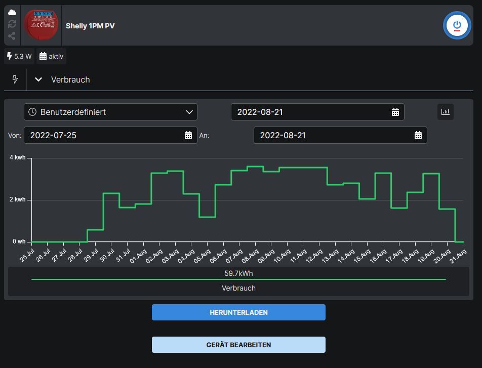

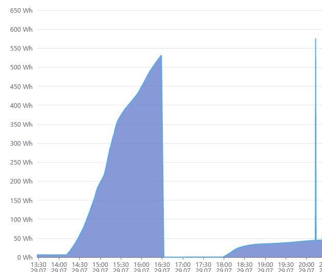

      ich habe hier ein shelly 1 pm der mir im account die werte anders anzeigt als im shelly adapter vom iobroker.
      wie bekomme ich das hin das fortlaufend mein pv erzeugnis gezählt wird und das ohne unterbrechung .. ?
      VG

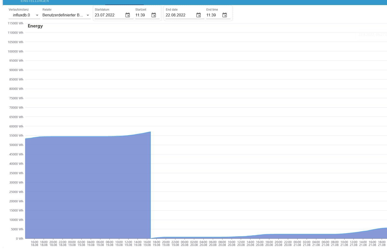

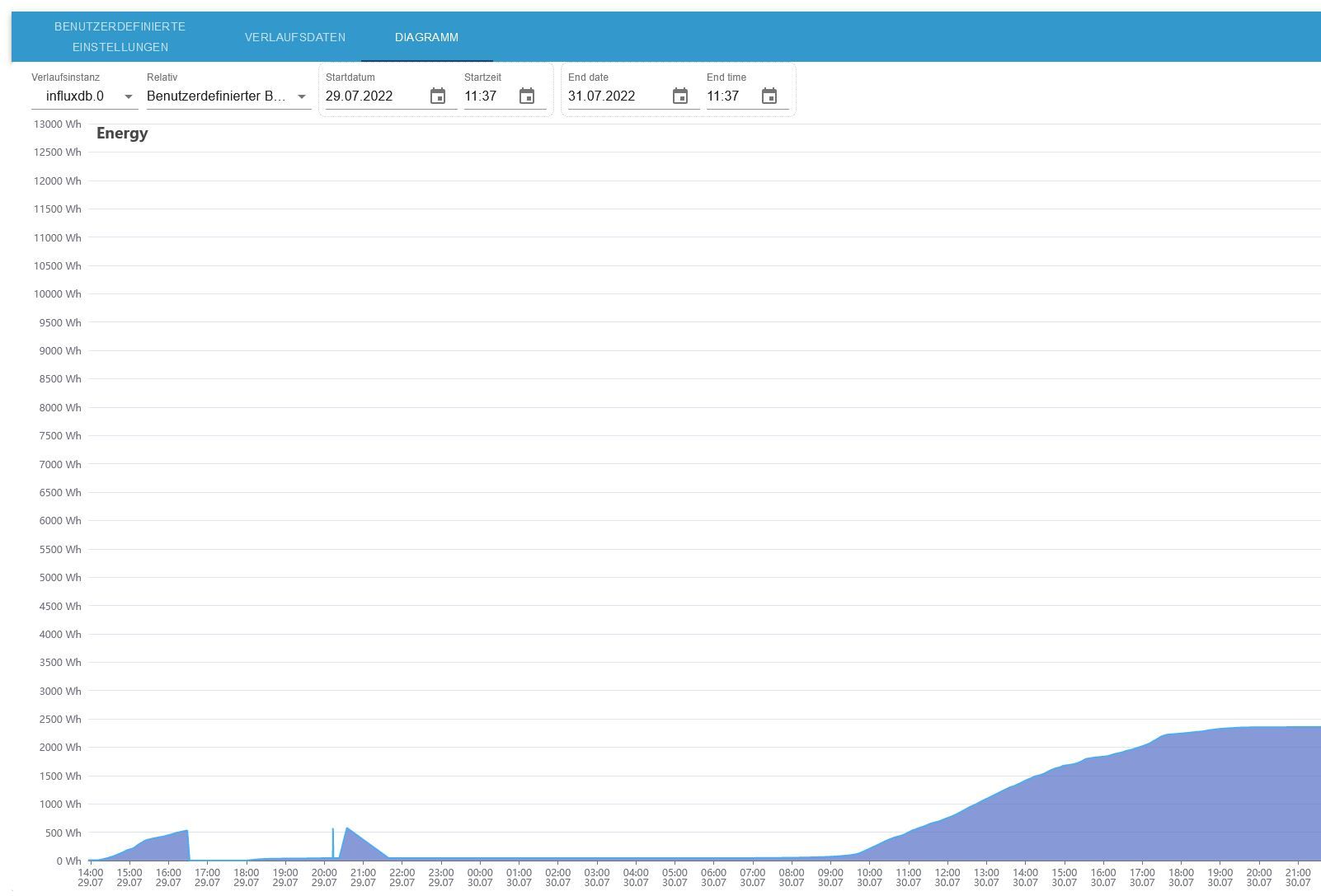

        rebel85 @rebel85 last edited by rebel85

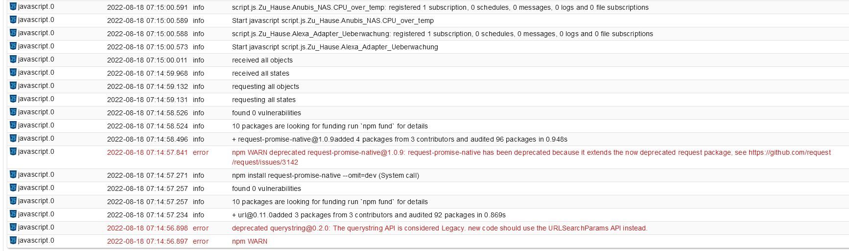

        @rebel85 und schonwieder eine influx unterbrechung
        javascript.0
        	2022-08-18 07:15:00.011	info	received all objects
        javascript.0
        	2022-08-18 07:14:59.968	info	received all states
        javascript.0
        	2022-08-18 07:14:59.132	info	requesting all objects
        javascript.0
        	2022-08-18 07:14:59.131	info	requesting all states
        javascript.0
        	2022-08-18 07:14:58.526	info	found 0 vulnerabilities
        javascript.0
        	2022-08-18 07:14:58.524	info	10 packages are looking for funding run `npm fund` for details
        javascript.0
        	2022-08-18 07:14:58.496	info	+ request-promise-native@1.0.9added 4 packages from 3 contributors and audited 96 packages in 0.948s
        javascript.0
        	2022-08-18 07:14:57.841	error	npm WARN deprecated request-promise-native@1.0.9: request-promise-native has been deprecated because it extends the now deprecated request package, see https://github.com/request/request/issues/3142
        javascript.0
        	2022-08-18 07:14:57.271	info	npm install request-promise-native --omit=dev (System call)
        javascript.0
        	2022-08-18 07:14:57.257	info	found 0 vulnerabilities
        javascript.0
        	2022-08-18 07:14:57.257	info	10 packages are looking for funding run `npm fund` for details
        javascript.0
        	2022-08-18 07:14:57.234	info	+ url@0.11.0added 3 packages from 3 contributors and audited 92 packages in 0.869s
        javascript.0
        	2022-08-18 07:14:56.898	error	deprecated querystring@0.2.0: The querystring API is considered Legacy. new code should use the URLSearchParams API instead.
        javascript.0
        	2022-08-18 07:14:56.897	error	npm WARN
        hängt das zusammen?
        die JS meldung habe ich per zufall abgefangen gehabt, kann diese aber nciht direkt zuordnen
        komisch ist die uhrzeit des resets
        mikeal created this issue in request/request
        open Request’s Past, Present and Future #3142
        Homoran apollon77 3 Replies Last reply Reply Quote 0

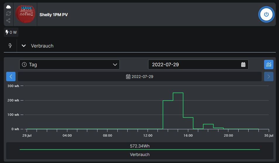

            rebel85 @Homoran last edited by
            anbei 2 screenshots.
            es ist der datenpunkt für energymessung eines balkon kraftwerks.
            im shelly selber ist die maximal erzeugte energy sichtbar nur im DP nicht.

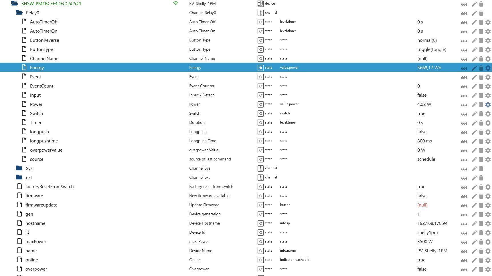

                      rebel85 @crunchip last edited by rebel85
                      @crunchip
                      der normale shelly 1 pm
                      kann ich das umstellen?
                      und die cloud ist doch nur für die steuerung da um von außen auf den schelly zu zu greifen.
                      gibts es eine andere methode um die erzeugte gesammtleistung zu messen?
                      strom war meines wissen nicht weg, der 2. reset bis lang erfolgte direkt am nachmittag.
                      im grafana graphen wo ich die aktuelle momentan leistung sehe war ncihts zu sehen mit einem einbruch oder der gleichen
                      im influx oder history aufruf vom DP im shelly adapter kann ich ja die übermittelten daten sehen.
                      im shelly selber sehe ich die konstante und steigende erzeugte leistung ohne unterbrechung.

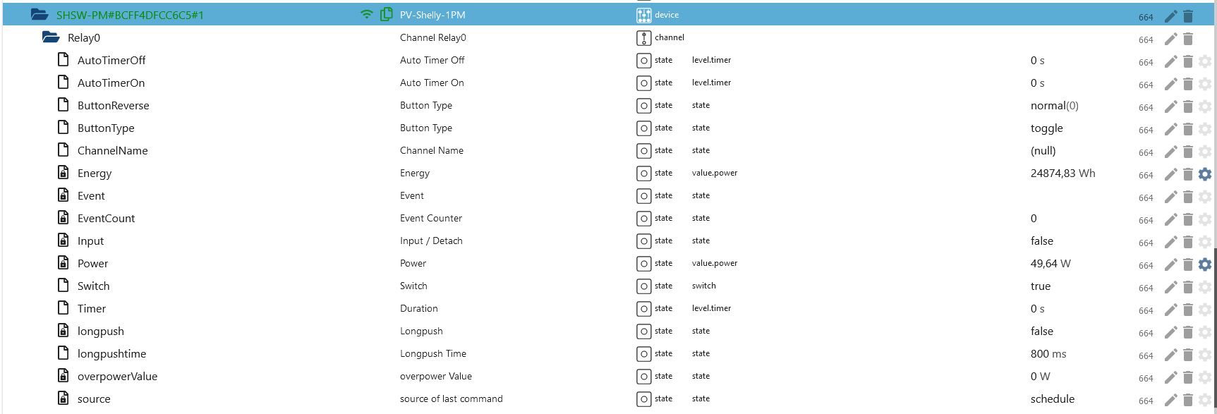

                      Unbenannt.JPG vom shelly
                      112.JPG reset 1
                      122.JPG reset 2
                      Unbenannt.JPG kompletter objekt baum

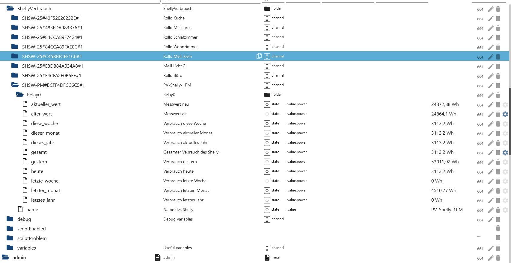

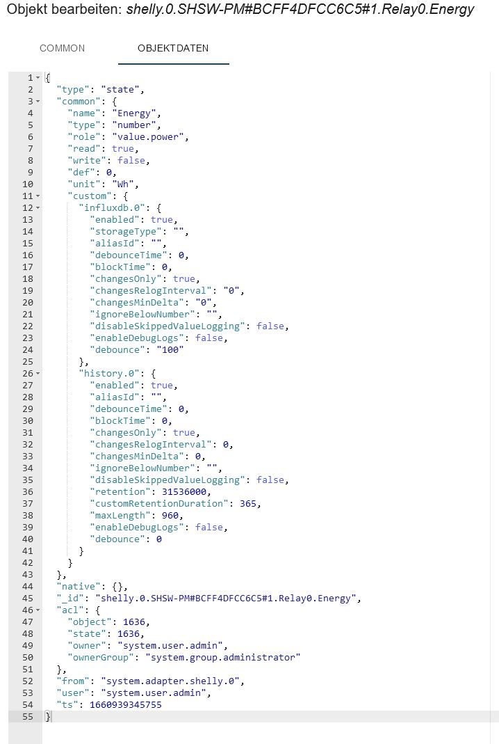

                        rebel85 @Homoran last edited by rebel85
                        @homoran sagte in Shelly 1 pm, Influx und Grafana Logging Unterbrechung:
                        @rebel85
                        was ist das für ein Datenpunkt?
                        DP vom shelly adapter
                        was misst der?
                        pv gesammt erzeugnis
                        ist das ein kumulierter Wert?
                        vom shelly übermittelt
                        für welchn Zeitraum?
                        28.07.22 - dato
                        wie sieht die Datenreihe aus?

                            Homoran Global Moderator Administrators @rebel85 last edited by
                            @rebel85 sagte in Shelly 1 pm, Influx und Grafana Logging Unterbrechung:
                            zeigen!
                            und?
                                  siehe meine antwort auf crunchip dort ist ein screenshot davon vom DP
                                    aber die Datenreihe sehe ich immer noch nicht!

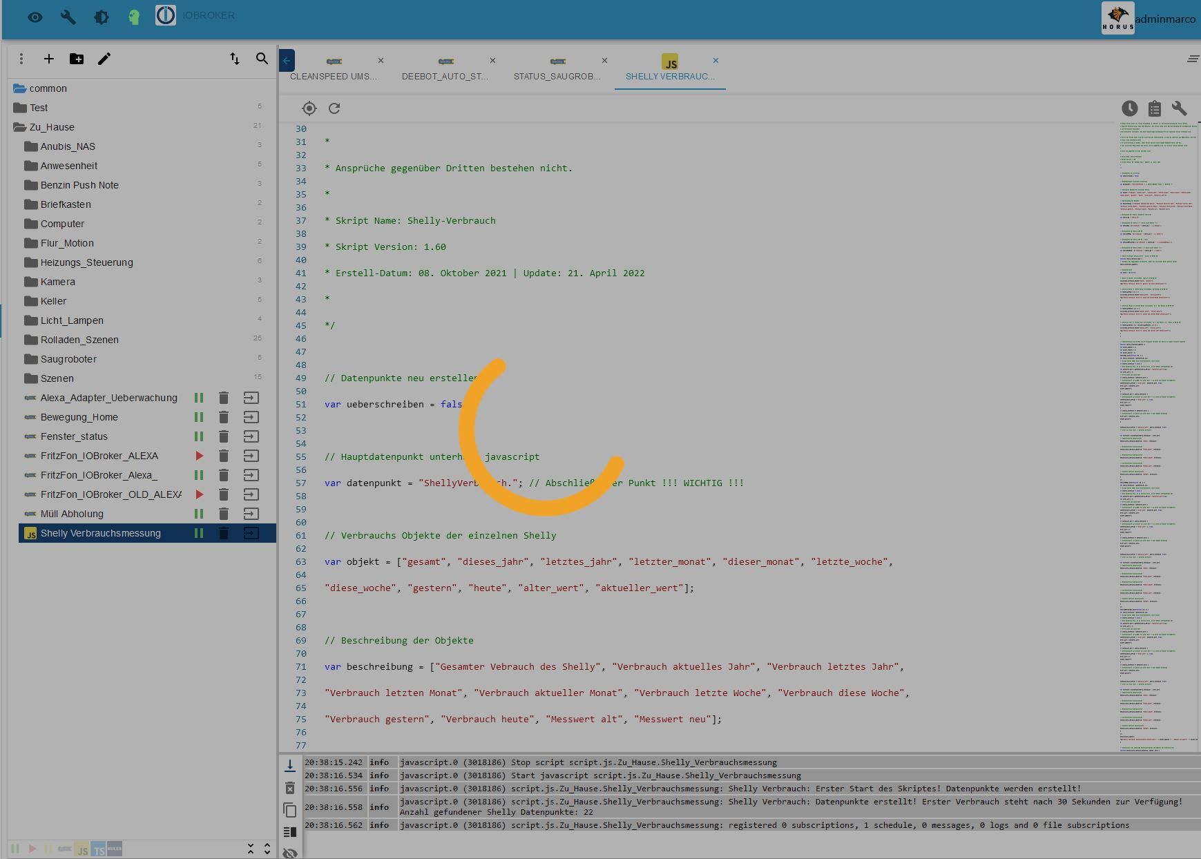

                                      @rebel85 https://www.kreyenborg.koeln/shelly-verbrauchs-historie-fuer-tag-woche-monat-jahr/
                                        @crunchip
                                        ist das normal das das skript nach erstellen und starten den iobroker ins stocken bringt?
                                        • crunchip
                                          crunchip Forum Testing Most Active @rebel85 last edited by
                                          @rebel85 was heisst ins stocken?

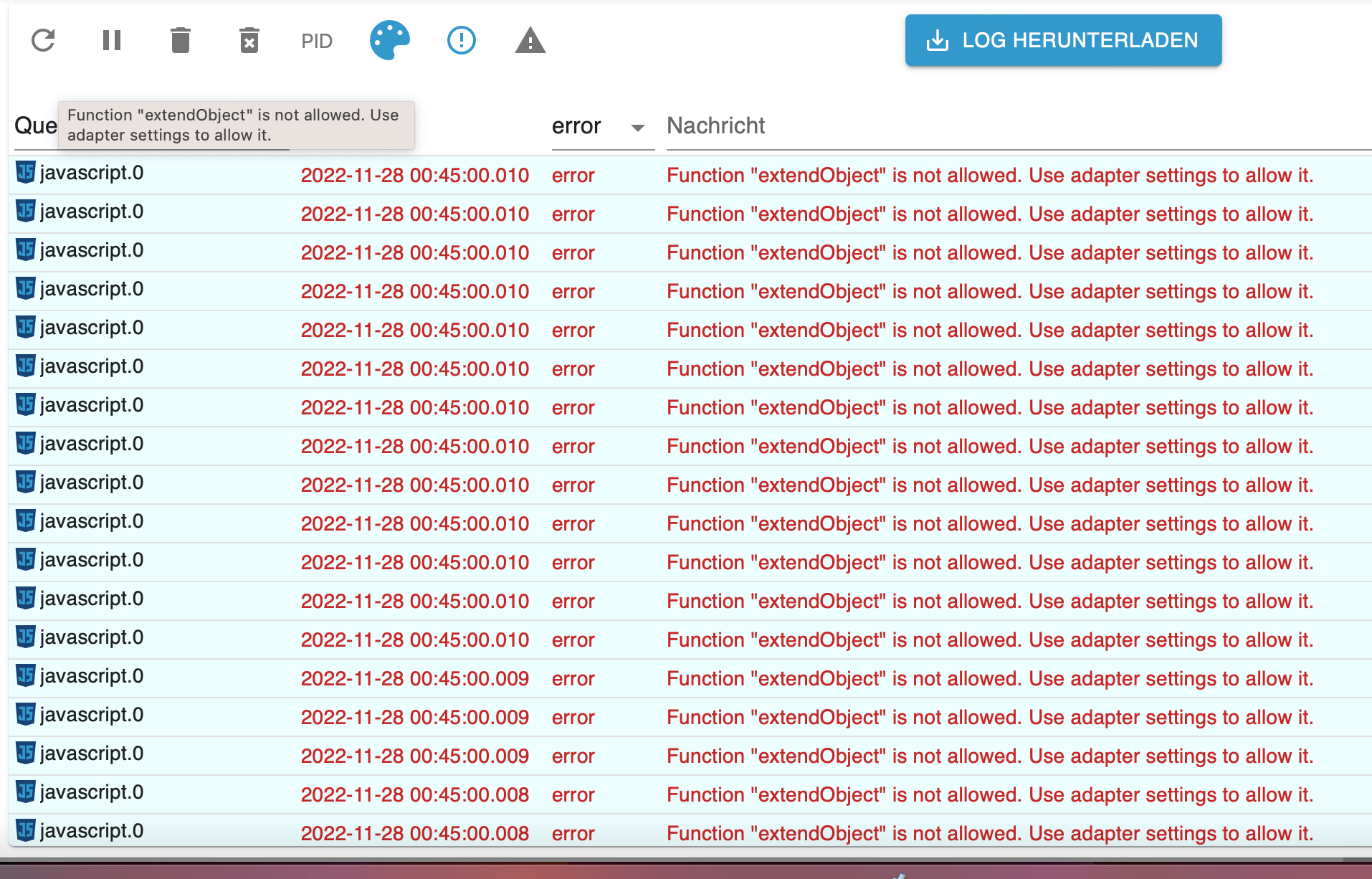

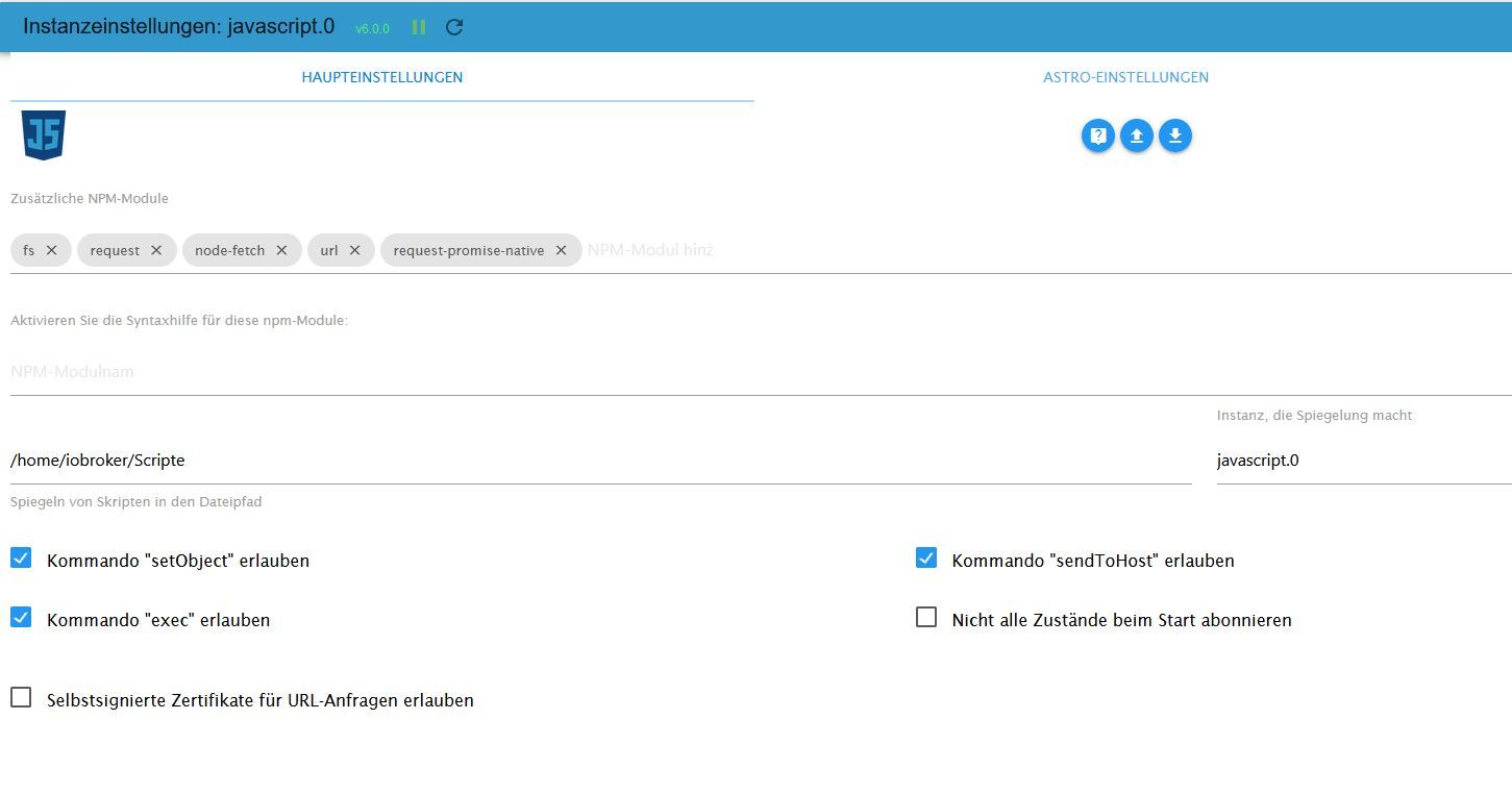

                                            @crunchip wie nen reboot und das skript ist wieder aus
                                            sobald das skript läuft, erst kommt der runde ladebalken und dann ne iobroker neu anmeldung.
                                            ist ja richtig das es in ein JS skript kommt oder?
