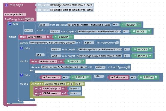

          kann man das so machen?
            <variables>
              <variable id="G(JC:W*|750X0dsYewe8">VAR-Aussen</variable>
              <variable id="UUQ%oRYf@/Gc}Qn|k{;S">VAR-Garage</variable>
              <variable type="timeout" id="VAR-Ruecksetzen">VAR-Ruecksetzen</variable>
            </variables>
            <block type="on_ext" id="mxlAMn]RfkXvQGeA2sZ#" x="-512" y="38">
              <value name="OID0">
                <shadow type="field_oid" id="zwU-#CVw:#O[WY;xw.3g">
                  <field name="oid">sonoff.0.RF-Bridge-Aussen.RfReceived_Data</field>
              <value name="OID1">
                <shadow type="field_oid" id="FYe{v0=QIP3D^[W]Yf%u">
                  <field name="oid">sonoff.0.RF-Bridge-Garage.RfReceived_Data</field>
                <block type="controls_if" id=")8sPY`O#)8I(=8H$_pLX">
                    <block type="logic_operation" id="7#$#W1]Nopz$n64z$P.n" inline="false">
                      <field name="OP">AND</field>
                        <block type="logic_compare" id="1zTbk;QIv)R|Hm-C-IN%">
                          <field name="OP">EQ</field>
                            <block type="get_value" id="|PPi+`1N5$VLs[s%1O1q">
                              <field name="OID">sonoff.0.RF-Bridge-Aussen.RfReceived_Data</field>
                            <block type="text" id="kE`Gq+;yfZLD2f={/AG;">
                              <field name="TEXT">88DC91</field>
                        <block type="logic_negate" id="-US[pg:vd#h.cgNT:C3D">
                          <value name="BOOL">
                            <block type="logic_compare" id="ILr);[.12RkoYWX.SZ]R">
                                <block type="get_value" id="SKtEo|HJanZ.[}w*HcC!">
                                  <field name="OID">sonoff.0.RF-Bridge-Garage.RfReceived_Data</field>
                                <block type="text" id="/P{F.`QLDUW{(RM%KJNY">
                    <block type="variables_set" id="6!@1ku.6]oB-GE~SS]8h">
                      <field name="VAR" id="G(JC:W*|750X0dsYewe8">VAR-Aussen</field>
                        <block type="text" id="_#S_]vB9f4YwWf1gJLcr">
                        <block type="control" id="AjY*c=Orj]reO![kPO5/">
                          <field name="OID">deconz.0.Lights.3.on</field>
                            <block type="logic_boolean" id="TkiA%{TefEml.Gr?U~@A">
                            <block type="controls_if" id=";uw|M%7HnBGuyb0eShi4">
                                <block type="logic_operation" id="M{ST:XLRU=Tx;/~n~4]o" inline="false">
                                    <block type="logic_compare" id="I:ccBIQM;(ZRC{Eg]:i;">
                                        <block type="get_value" id="?Fn.~p/q!|$=$]u.HC,O">
                                        <block type="text" id="3V8*A|9EkR=brfE8-o0x">
                                    <block type="logic_compare" id="%TY$,s*x3h1z(g+MnEs.">
                                      <field name="OP">NEQ</field>
                                        <block type="get_value" id="TH_QnWuU7lGq@]}pC0p*">
                                        <block type="text" id="Oq(@XiTHK6_QTI!4;p}D">
                                <block type="variables_set" id="sno;s.VRib1L2NlV:3PB">
                                  <field name="VAR" id="UUQ%oRYf@/Gc}Qn|k{;S">VAR-Garage</field>
                                    <block type="text" id="dCpA^k7Q%MauXxt%!VvZ">
                                    <block type="control" id="19);/*.:(ma+7io~nyB7">
                                        <block type="logic_boolean" id="/_B]K$`V;_{?waL8]U[Q">
                                <block type="controls_if" id="WTPMHJKN,U^R}vEPRD)_">
                                    <block type="logic_operation" id=":P#?KhQpJsskAGVC.`pL">
                                      <field name="OP">OR</field>
                                        <block type="logic_compare" id="#s#0b%!6.tvRI;I_-ai$">
                                            <block type="variables_get" id="@#_E@b5DrM2hv4*!r0DX">
                                            <block type="text" id="fPagBKqT`C6GLn*7Sk5+">
                                        <block type="logic_compare" id="mbAKuu_SpI+yw|m;zf%c">
                                            <block type="variables_get" id="=_j[gKfI-Xb6?]`zEph*">
                                            <block type="text" id="2=Y6G6[]E+3*!;v}Oiim">
                                    <block type="timeouts_settimeout" id="i{2K2H_h}*Du#/faawvR">
                                      <field name="NAME">VAR-Ruecksetzen</field>
                                      <field name="DELAY">1</field>
                                        <block type="variables_set" id="3*1c-]VAiM|HovjGzKn_">
                                            <block type="logic_boolean" id="gk!^7Z)X|c981zPh8MYL">
                                            <block type="variables_set" id="pWZLt}h`1mJLsP].aq@I">
                                                <block type="logic_boolean" id="`_H:A2.xNr$Xllv4J6c.">
          Blödsinn was ich da gemacht habe

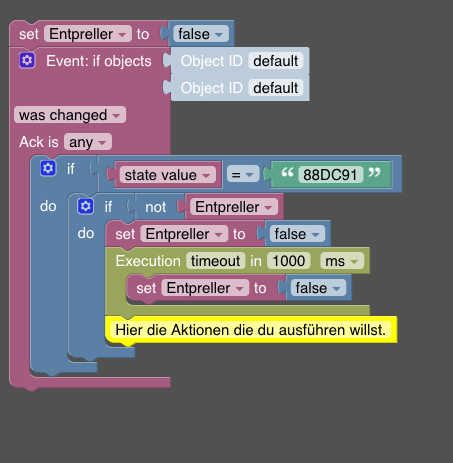

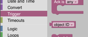

            @ludino Das kann man ggf. so machen, ist aber nur bedingt sinnvoll - im Detail hab ich das nicht analysiert.
            Du solltest diesen Baustein nutzen. Damit kannst du im Trigger
            • abfragen welcher der beiden Trigger Datenpunkte den Trigger ausgelöst hat (und damit für eine Zeit die Auslösung durch den anderen blockieren) Dann Lässt du den als "Objekt ID" stehen
            • den Wert abfragen der den Trigger auslöst - dann stellst du den auf "wert" ("state value") um.
            Damit sollte ein Skript wie dieses funktionieren.
            Wenn du noch unterschiede machen willst welche der RF Bridges den Befehl ausgelöst hast bräuchtest du noch ein Falls zur Abfrage von "Objekt ID".

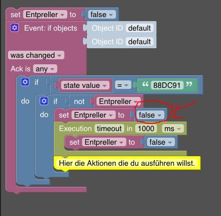

                Hallo müsste da nicht ein true sein?
                • Asgothian
                  Asgothian Developer @ludino last edited by
                  @ludino sagte in 2 sonoff RF bridge tasmota Flash blocky:
                  Ja, du hast den eingebauten Fehler gefunden. 🙂
                  Spass beiseite - ich hatte das heute morgen kurz zusammenkopiert. Das ist ein Kopierfehler, da muss wirklich "true" stehen.
                  A.
