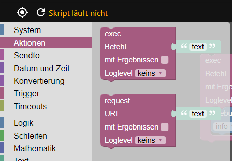

                      curl -v -X POST -H "Content-Type: application/json" -d '{"input":"doorbell","param":"1","output":[{"event":"http","param":"0","schedule":{"weekdays":[{"to":"79199","from":"79200"}]}},{"event":"http","param":"3","schedule":{"weekdays":[{"to":"79199","from":"79200"}]}},{"event":"http","param":"2","schedule":{"weekdays":[{"to":"79199","from":"79200"}]}},{"event":"http","param":"1","schedule":{"weekdays":[{"to":"79199","from":"79200"}]}},{"event":"notify","param":"","schedule":{"weekdays":[{"to":"79199","from":"79200"}]}}]}' http://xxx:xxx@xxx/bha-api/schedule.cgi**
                      ( Hier War die Anfrage den Zeitplan zu Ändern...)
                      Weis jemand wie ich so einen befehl über Blockly rausbekomme ?
                      Balu

                          MCU @Balu 0 last edited by
                          @balu-0
                          Muss in javascript-Instanz aktiv gesetzt sein

                              Balu 0 @MCU last edited by
                              @mcu
                              Lääääuft !!!!!!!
                              Danke Danke Danke DANKE !
