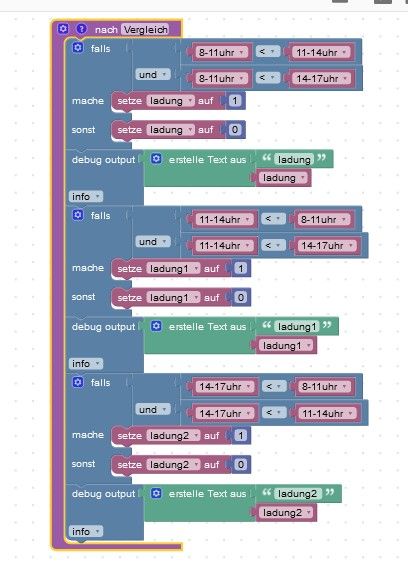

          babl @paul53 last edited by babl
          @paul53 danke, ja dann habe ich den mindestwert, aber noch nciht den dazugehörigen datenpunkt. Habs jetzt mal so gelöst.
          <block xmlns="https://developers.google.com/blockly/xml" type="procedures_defnoreturn" id="^ey=@1mMZkChkusZQ4g4" x="-837" y="813">
            <field name="NAME">Vergleich</field>
            <statement name="STACK">
              <block type="controls_if" id="yp!aQQGb:Hgs/-VcU.+/">
                  <block type="logic_operation" id="v*LzvZ,Xf*,tmwqa$h?s" inline="false">
                    <field name="OP">AND</field>
                      <block type="logic_compare" id="ZPkbJYkHQAWe?T5J-a.c">
                        <field name="OP">LT</field>
                          <block type="variables_get" id="Xfn;e_c3DN@MTk3stMtg">
                            <field name="VAR" id="(JO:=)e=+tJR#}bXtA[u">8-11uhr</field>
                          <block type="variables_get" id="#-}UCXIioZHc3LJm2~ws">
                            <field name="VAR" id="gHLWUH_VgSv2JT6o:`}:">11-14uhr</field>
                      <block type="logic_compare" id="P%FGOmt2wrVMI(lg#l9i">
                          <block type="variables_get" id="iIh67n4v4D)pCkKvzOa6">
                          <block type="variables_get" id="PWH`s]mI6uA5BSiICB#/">
                            <field name="VAR" id="@`9|:c](WH@z6b$jA_;{">14-17uhr</field>
                  <block type="variables_set" id="uL*Z4reWmGbf5d.nnV/r">
                    <field name="VAR" id="7a$/IRd53g%KB_-#Y8R8">ladung</field>
                      <block type="math_number" id="rZ|#Qyc(ezdCOMiGoI[s">
                        <field name="NUM">1</field>
                <statement name="ELSE">
                  <block type="variables_set" id="b^MhltsV@w/.*;kqzC?1">
                      <block type="math_number" id="NoQ6QjHD]}@FlPPOy^4s">
                        <field name="NUM">0</field>
                  <block type="debug" id="4T^VTf,i)zv:(^Os,vhU">
                    <value name="TEXT">
                      <shadow type="text" id="S@!Zx-#|w1LC;aoW#*#S">
                      <block type="text_join" id="%{L:zCQJsby[b?k*1~:W">
                        <value name="ADD0">
                          <block type="text" id="E~e0RQQ$9!=$h!h(m8qq">
                            <field name="TEXT">ladung </field>
                        <value name="ADD1">
                          <block type="variables_get" id="XT6zF_@[qrJlogSBxtC_">
                      <block type="controls_if" id=")q%CZ(wr/;:+zL:[aGG/">
                          <block type="logic_operation" id="USZ$j`Z*[*UD%vdrCFYd" inline="false">
                              <block type="logic_compare" id="$J=CU?FZt-B;uj#T]deB">
                                  <block type="variables_get" id="hF/no$#5JZxP-;+tJn$t">
                                  <block type="variables_get" id="XFV(Uaq*{xuWGa}5,3!Q">
                              <block type="logic_compare" id="KD^6!{stzDsKy!#CeR)0">
                                  <block type="variables_get" id="gbC*i3$oO@*?=D|WmE^m">
                                  <block type="variables_get" id="(qe|)oIZ!Ic_IwMJE#BW">
                          <block type="variables_set" id="}XhH[oJaGE1Bub4v:x`v">
                            <field name="VAR" id="qg/,j#?UTK==/2H9j|/D">ladung1</field>
                              <block type="math_number" id="~L=+8V]OM%@gpVy./-#d">
                          <block type="variables_set" id="3zH3r45qZg3{9N),x)fY">
                              <block type="math_number" id="Z0J~T,v/RZ3No$!)rWnR">
                          <block type="debug" id="M|IbERnhA}J-$y!{D/`]">
                            <value name="TEXT">
                              <shadow type="text">
                              <block type="text_join" id="hFL^Eqz]cbM)L+!$,zFY">
                                <value name="ADD0">
                                  <block type="text" id="PMg)KO^[tJk;If#r8wrY">
                                    <field name="TEXT">ladung1 </field>
                                <value name="ADD1">
                                  <block type="variables_get" id="0#e,hm.oCM%-e}PzqECK">
                              <block type="controls_if" id="pykuRk/e6l-2=(-6I3Y|">
                                  <block type="logic_operation" id="-oc_EOmr$neQK[;yn+pD" inline="false">
                                      <block type="logic_compare" id="`v.I5^PNglvhDo82v#Bw">
                                          <block type="variables_get" id="4%ww)uae3*uE6q3`ejp;">
                                          <block type="variables_get" id="s#WO^NHjs3WHUpg=!5pk">
                                      <block type="logic_compare" id="YN{lN#pW5GK;DPQ$NJ|8">
                                          <block type="variables_get" id="I#leYk|QobPO!e!F$LvN">
                                          <block type="variables_get" id="[x*CqIS,i[toRoG=+QhW">
                                  <block type="variables_set" id="L#Y[~N}|-,:-@JjcZF/!">
                                    <field name="VAR" id="G00M.8WH)J#1V3RPX[OH">ladung2</field>
                                      <block type="math_number" id="5eI*6}wn995gkJJ];E6/">
                                  <block type="variables_set" id="qj;u(vNMc17$y_)0lq{#">
                                      <block type="math_number" id="@3i@A{*T8i~Un2,6cHSd">
                                  <block type="debug" id="eX9jS?w4fP^CP$.]@fA4">
                                    <value name="TEXT">
                                      <block type="text_join" id="io]tyTF3W/.fF$7O$Jdc">
                                        <value name="ADD0">
                                          <block type="text" id="C?o/M;dP0722RZo,(:Rr">
                                            <field name="TEXT">ladung2  </field>
                                        <value name="ADD1">
                                          <block type="variables_get" id="u@@KoW{[HY,niwSz_#as">

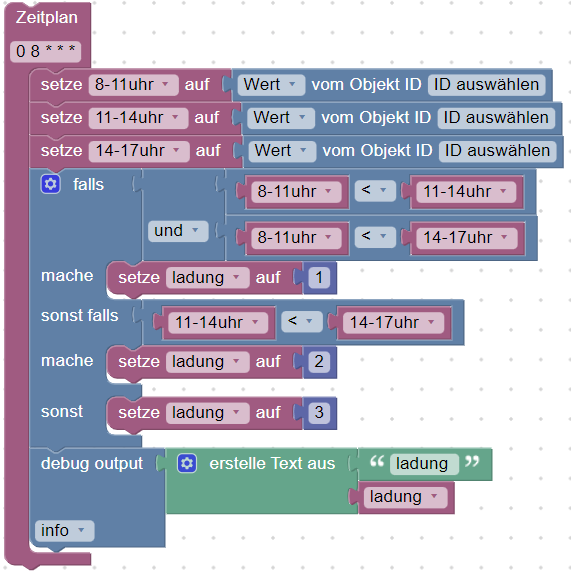

            paul53 @babl last edited by
            @babl sagte: Habs jetzt mal so gelöst.
            Das geht einfacher.
              @paul53 danke war mir schon klar, daß das einfacher geht, ich bin ja schon froh daß es überhaupt funktioniert, aber danke dir. Wie immer Top Hilfe
