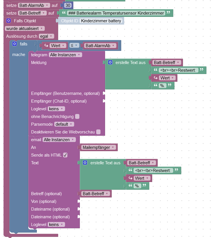

      Ich bekomme massenhaft diese Fehlermeldungen:
      javascript.0
      	2022-08-21 11:23:45.042	error	script.js.common.Aqara_Sensoren.Batterie_72:_Temperatur_Terrasse Error by subscription: ID of type boolean or number is not supported.
      javascript.0
      	2022-08-21 11:23:45.010	error	script.js.common.Aqara_Sensoren.Batterie_09:_Wassersensor_Hobbyraum Error by subscription: ID of type boolean or number is not supported.
      javascript.0
      	2022-08-21 11:23:45.005	error	script.js.common.Aqara_Sensoren.Batterie_69:_Temperatur_Kinderzimmer Error by subscription: ID of type boolean or number is not supported.
      javascript.0
      	2022-08-21 11:23:44.995	error	script.js.common.Aqara_Sensoren.Batterie_66:_Temperatur_Wohnzimmer Error by subscription: ID of type boolean or number is not supported.
      javascript.0
      	2022-08-21 11:23:44.990	error	script.js.common.Aqara_Sensoren.Batterie_63:_Temperatur_Tiefkühlschrank Error by subscription: ID of type boolean or number is not supported.
      javascript.0
      	2022-08-21 11:23:44.985	error	script.js.common.Aqara_Sensoren.Batterie_60:_Temperatur_Büro_Sonja Error by subscription: ID of type boolean or number is not supported.
      javascript.0
      	2022-08-21 11:23:44.961	error	script.js.common.Aqara_Sensoren.Batterie_08:_Wassersensor_HWR Error by subscription: ID of type boolean or number is not supported.
      javascript.0
      	2022-08-21 11:23:44.956	error	script.js.common.Aqara_Sensoren.Batterie_57:_Temperatur_Kühlschrank1 Error by subscription: ID of type boolean or number is not supported.
      javascript.0
      	2022-08-21 11:23:44.951	error	script.js.common.Aqara_Sensoren.Batterie_54:_Temperatur_Garage Error by subscription: ID of type boolean or number is not supported.
      javascript.0
      	2022-08-21 11:23:44.946	error	script.js.common.Aqara_Sensoren.Batterie_51:_Temperatur_Kühlschrank2 Error by subscription: ID of type boolean or number is not supported.
      javascript.0
      	2022-08-21 11:23:44.941	error	script.js.common.Aqara_Sensoren.Batterie_48:_Temperatur_Gäste_WC Error by subscription: ID of type boolean or number is not supported.
      javascript.0
      	2022-08-21 11:23:44.937	error	script.js.common.Aqara_Sensoren.Batterie_45:_Temperatur_Büro_Volker Error by subscription: ID of type boolean or number is not supported.
      javascript.0
      	2022-08-21 11:23:44.932	error	script.js.common.Aqara_Sensoren.Batterie_42:_Temperatur_Dachboden Error by subscription: ID of type boolean or number is not supported.
      javascript.0
      	2022-08-21 11:23:44.926	error	script.js.common.Aqara_Sensoren.Batterie_39:_Temperatur_Büro_Sonja Error by subscription: ID of type boolean or number is not supported.
      javascript.0
      	2022-08-21 11:23:44.922	error	script.js.common.Aqara_Sensoren.Batterie_36:_Temperatur_Schlafzimmer Error by subscription: ID of type boolean or number is not supported.
      javascript.0
      	2022-08-21 11:23:44.916	error	script.js.common.Aqara_Sensoren.Batterie_32:_OpenClose_Garagentor Error by subscription: ID of type boolean or number is not supported.
      javascript.0
      	2022-08-21 11:23:44.911	error	script.js.common.Aqara_Sensoren.Batterie_31:_Wassersensor_Badezimmer Error by subscription: ID of type boolean or number is not supported.
      Die Scripte sind alle identisch (bis auf die Datenpunkte) und sollen vor leerer Batterie warnen:
      Hat jemand eine Idee?

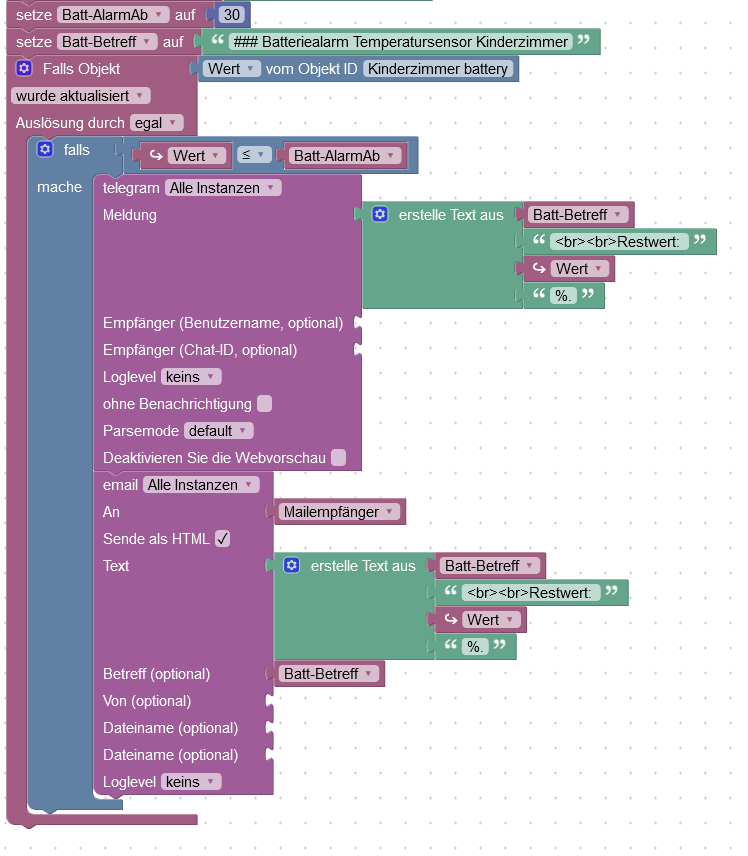

          paul53 @myssv last edited by
          @myssv sagte: Hat jemand eine Idee?
          An den Trigger muss eine ID übergeben werden - kein Wert.
          M Homoran 2 Replies Last reply Reply Quote 2
            myssv @paul53 last edited by
            @paul53 ah verstehe. Also so:
            Vielen Dank!
