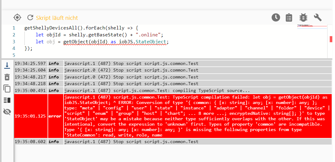

      Ich bekomme einen Fehler wenn ich iobJS.StateObject innerhalb eines forEach() verwende.
      getShellyDevicesAll().forEach(shelly => {
          let objId = shelly.getBaseState() + ".online";
          let obj = getObject(objId) as iobJS.StateObject;
      ...führt noch zu einem Fehler:
      javascript.1 (487) script.js.common.Test: TypeScript compilation failed: let obj = getObject(objId) as iobJS.StateObject; ^ ERROR: Conversion of type '{ common: { [x: string]: any; [x: number]: any; }; type: "meta" | "config" | "user" | "state" | "instance" | "adapter" | "channel" | "folder" | "device" | "script" | "enum" | "group" | "host" | "chart"; ... 8 more ...; encryptedNative: string[]; }' to type 'StateObject' may be a mistake because neither type sufficiently overlaps with the other. If this was intentional, convert the expression to 'unknown' first. Types of property 'common' are incompatible. Type '{ [x: string]: any; [x: number]: any; }' is missing the following properties from type 'StateCommon': read, write, role, name

        Ok da muss ich wirklich nochmal ran. Schön ist das nicht...
        @uwe72 sagte in TypeScript: Zugriff iobJS.StateObject innerhalb forEach():
        ersetzen durch:
        getObject(objId) as unknown as iobJS.StateObject

          @alcalzone said in TypeScript: Zugriff iobJS.StateObject innerhalb forEach():
          Hat funktioniert. Danke dir von Herzen!!
