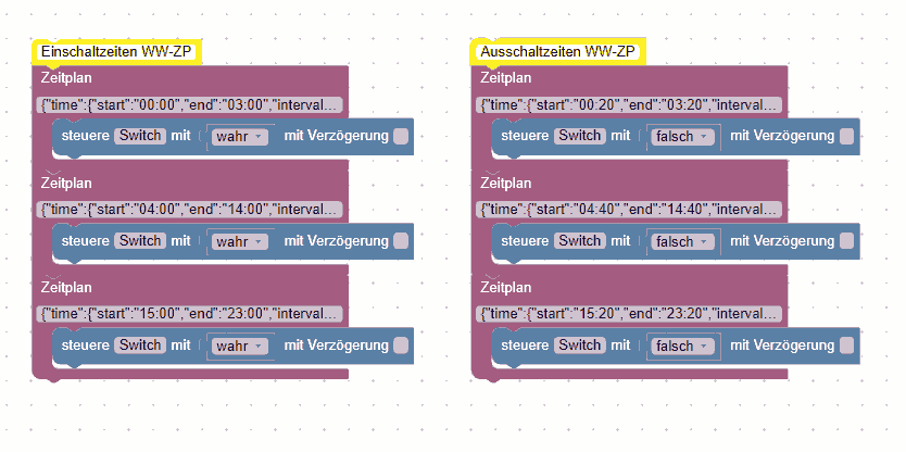

    5. Schaltzeiten so richtig im Blockly eingetragen?
    • G
      Gismoh last edited by
      habe ich das Blockly so richtig angelegt?
      Die Pumpe soll zu verschiedenen Zeiten ein und wieder ausgeschaltet werden.blockly.png
        <block type="schedule" id="$Q0{)cu@QieJMH*Lggha" x="-737" y="-1063">
          <field name="SCHEDULE">{"time":{"start":"00:00","end":"03:00","interval":1,"mode":"hours"},"period":{"days":1},"valid":{"from":"11.09.2022","to":""}}</field>
            <block type="control" id=",Sl(D#Y(Zom|2$E{x7yy">
              <field name="OID">shelly.0.SHSW-PM#E89F6D858E10#1.Relay0.Switch</field>
                <block type="logic_boolean" id="P):Nv|1ujVt^=`YL_0!:">
            <block type="schedule" id="COzfr!Zyw{rRyzNc;p))">
              <field name="SCHEDULE">{"time":{"start":"04:00","end":"14:00","interval":1,"mode":"hours"},"period":{"days":1}}</field>
                <block type="control" id="7m6i}uVFO|Xyt3kIzwU3">
                    <block type="logic_boolean" id="uDYGxUB8a^h,on#22th9">
                <block type="schedule" id="A-IQ01zaXVp}[HFhwr:|">
                  <field name="SCHEDULE">{"time":{"start":"15:00","end":"23:00","interval":1,"mode":"hours"},"period":{"days":1},"valid":{"from":"11.09.2022","to":""}}</field>
                    <block type="control" id="b$|w2Zi(1JPE~2Y3wz;i">
                        <block type="logic_boolean" id="w7pR|]22YKPA%Vdif,3}">
        <block type="schedule" id="ee}h|y2Ee!~()AHd2X^i" x="-287" y="-1063">
          <field name="SCHEDULE">{"time":{"start":"00:20","end":"03:20","interval":1,"mode":"hours"},"period":{"days":1}}</field>
            <block type="control" id="+#.n-3]D8x7(rx9DN*SU">
                <block type="logic_boolean" id="yX1FhCV,G2:@TT]WwV?_">
            <block type="schedule" id="4H$FNiSu[-WAU9fYq?$s">
              <field name="SCHEDULE">{"time":{"start":"04:40","end":"14:40","interval":1,"mode":"hours"},"period":{"days":1}}</field>
                <block type="control" id="?iFQ;=TJGYSZQoE{U%T^">
                    <block type="logic_boolean" id="l#pd]GB2*O$7-jSKKXek">
                <block type="schedule" id="sWsQlEhqMaE7iYq?)Sk0">
                  <field name="SCHEDULE">{"time":{"start":"15:20","end":"23:20","interval":1,"mode":"hours"},"period":{"days":1}}</field>
                    <block type="control" id="xa?R.z?ZyXjWrQMPTo6=">
                        <block type="logic_boolean" id="aL$+{S{pccT_qBtLfuV9">

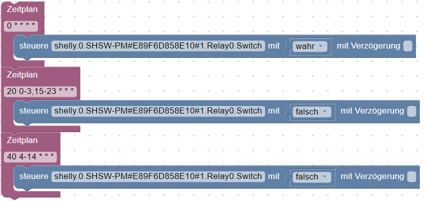

        paul53 @Gismoh last edited by paul53
        @gismoh sagte: habe ich das Blockly so richtig angelegt?
        Nimm besser die CRON-Variante:
