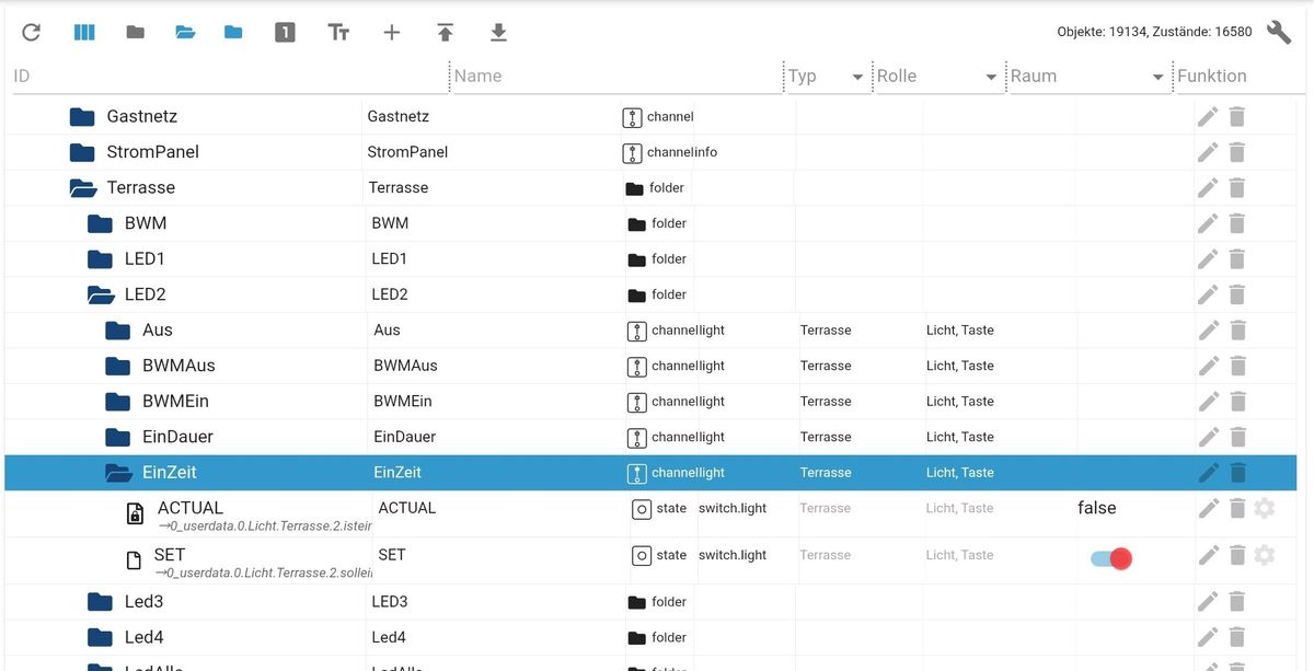

                              peterfido last edited by peterfido
                              @tt-tom Es gibt mit der aktuellen Skript-Version v4.7.1.2 mehrere Problemchen, sodass ich weiterhin die 4.0.5 (mit Änderungen auf axios) nutze.
                              Icon-Farben werden nicht korrekt angezeigt:
                              let Bel_Terrasse: PageType =
                                  'type': 'cardGrid',
                                  'heading': 'Terrasse',
                                  'useColor': true,
                                  'items': [
                                      {navigate: true, id: 'alias.0.NSPanel.Terrasse.LED2.EinZeit', targetPage: 'Terrasse_LED2', icon: 'led-strip-variant', offColor: MSRed, onColor: MSGreen, name: 'Schlauch'},
                                      {navigate: true, id: 'alias.0.NSPanel.Terrasse.Led3.EinZeit', targetPage: 'Terrasse_LED3', icon: 'led-strip', offColor: MSRed, onColor: MSGreen, name: 'LED 1'},
                                      {navigate: true, id: 'alias.0.NSPanel.Terrasse.Led4.EinZeit', targetPage: 'Terrasse_LED4', icon: 'led-strip', offColor: MSRed, onColor: MSGreen, name: 'LED 2'},
                                      {navigate: true, id: 'alias.0.NSPanel.Terrasse.LED1.EinZeit', targetPage: 'Terrasse_LED1', icon: 'spotlight-beam', offColor: MSRed, onColor: MSGreen, name: 'Strahler'},
                                      {navigate: true, id: 'alias.0.NSPanel.Terrasse.BWM.Ein', targetPage: 'Terrasse_BWM', icon: 'motion-sensor', offColor: MSRed, onColor: MSGreen, name: 'Bewegungsm.'},
                                      {id: 'alias.0.NSPanel.Terrasse.LedAlle.Aus', icon: 'power', offColor: MSRed, onColor: MSRed, name: 'Alles aus'}
                              Unter 4.0.5 keine Probleme:
                              let Bel_Terrasse = <PageGrid>
                                  'type': 'cardGrid',
                                  'useColor': true,
                                  'items': [
                                      <PageItem>{ navigate: true, id: 'alias.0.NSPanel.Terrasse.LED2.EinZeit', targetPage: 'Terrasse_LED2', icon: 'led-strip-variant', offColor: MSRed, onColor: MSGreen, name: 'Schlauch', useColor: true, useValue: true},
                                      <PageItem>{ navigate: true, id: 'alias.0.NSPanel.Terrasse.Led3.EinZeit', targetPage: 'Terrasse_LED3', icon: 'led-strip', offColor: MSRed, onColor: MSGreen, name: 'LED 1'},
                                      <PageItem>{ navigate: true, id: 'alias.0.NSPanel.Terrasse.Led4.EinZeit', targetPage: 'Terrasse_LED4', icon: 'led-strip', offColor: MSRed, onColor: MSGreen, name: 'LED 2'},
                                      <PageItem>{ navigate: true, id: 'alias.0.NSPanel.Terrasse.LED1.EinZeit', targetPage: 'Terrasse_LED1', icon: 'spotlight-beam', offColor: MSRed, onColor: MSGreen, name: 'Strahler', useColor: true, useValue: true},
                                      <PageItem>{ navigate: true, id: 'alias.0.NSPanel.Terrasse.BWM.Ein', targetPage: 'Terrasse_BWM', icon: 'motion-sensor', offColor: MSRed, onColor: MSGreen, name: 'Bewegungsmelder', useColor: true, useValue: true},
                              //        <PageItem>{ id: 'alias.0.NSPanel.Terrasse.LedAlle.Aus', offColor: MSRed, onColor: MSRed, name: 'Alles aus', useValue: false}
                                      <PageItem>{ id: 'alias.0.NSPanel.Terrasse.LedAlle.Aus', offColor: MSRed, onColor: MSRed, name: 'Alles aus'}
                              1. Der Entitiy Watcher achtet jetzt auf 'any' statt 'ne', was die Seite mit den Icons ständig neu aufbaut, da die aliase wohl sehr oft synchronisiert werden.

                                      TT-Tom @peterfido last edited by
                                      @peterfido
                                      Kannst du das bitte genauer definieren, was da nicht passt.
                                      Bitte auch die Objektdaten von dem Channel
                                      und die Datenpunkte darunter.
                                        peterfido @TT-Tom last edited by peterfido
                                        @tt-tom Die Icons werden in grün statt rot angezeigt.
                                        Edit:
                                          "_id": "alias.0.NSPanel.Terrasse.LED2.EinZeit",
                                          "common": {
                                            "name": {
                                              "de": "EinZeit"
                                            "role": "light",
                                            "icon": "",
                                            "color": null
                                          "native": {},
                                          "type": "channel",
                                          "user": "system.user.admin",
                                          "ts": 1682928709794,
                                          "acl": {
                                            "object": 1636,
                                            "owner": "system.user.admin",
                                          "_id": "alias.0.NSPanel.Terrasse.LED2.EinZeit.ACTUAL",
                                          "native": {},
                                          "type": "state",
                                          "common": {
                                            "alias": {
                                              "id": "0_userdata.0.Licht.Terrasse.2.istein"
                                            "name": "ACTUAL",
                                            "role": "switch.light",
                                            "write": false,
                                            "type": "boolean"
                                          "ts": 1682928727120,
                                          "acl": {
                                            "object": 1636,
                                            "state": 1636,
                                        [/s]
