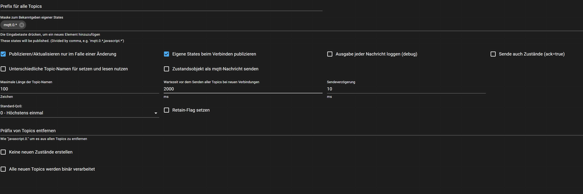

                        • W
                          welli last edited by
                          Hallo
                          Bekomme seit einigen Tagen diese Info im Protokoll Fenster.
                          Hat jemand ein Idee wie was das sein könnte?
                          mqtt.0
                          2025-10-10 18:32:45.158 info Client [DVES_0B8CD4] connection closed: Error: read ECONNRESET
                          mqtt.0
                          2025-10-10 18:30:47.717 info Client [DVES_0B8CD4] publishOnSubscribe send all known states
                          mqtt.0
                          mqtt.0
                          2025-10-10 18:30:47.715 info Client [DVES_0B8CD4] publishOnSubscribe send all known states
                          mqtt.0
                          2025-10-10 18:30:47.516 info Client [DVES_0B8CD4] subscribes on "cmnd/DVES_0B8CD4_fb/#" with regex /^mqtt.0.cmnd.DVES_0B8CD4_fb..*/
                          mqtt.0
                          2025-10-10 18:30:47.516 info Client [DVES_0B8CD4] subscribes on "cmnd/DVES_0B8CD4_fb/#" with regex /^cmnd.DVES_0B8CD4_fb..*/
                          mqtt.0
                          2025-10-10 18:30:47.516 info Client [DVES_0B8CD4] subscribes on "SmartHome/tasmotas/cmnd/#" with regex /^mqtt.0.SmartHome.tasmotas.cmnd..*/
                          mqtt.0
                          2025-10-10 18:30:47.516 info Client [DVES_0B8CD4] subscribes on "SmartHome/tasmotas/cmnd/#" with regex /^SmartHome.tasmotas.cmnd..*/
                          mqtt.0
                          2025-10-10 18:30:47.516 info Client [DVES_0B8CD4] subscribes on "SmartHome/NSPanel_2/cmnd/#" with regex /^mqtt.0.SmartHome.NSPanel_2.cmnd..*/
                          mqtt.0
                          2025-10-10 18:30:47.516 info Client [DVES_0B8CD4] subscribes on "SmartHome/NSPanel_2/cmnd/#" with regex /^SmartHome.NSPanel_2.cmnd..*/
                          mqtt.0
                          2025-10-10 18:30:47.463 info Client [DVES_0B8CD4] connected with secret 1760113847461_6512
                          mqtt.0
                          2025-10-10 18:30:47.277 info Client [DVES_0B8CD4] connection closed: Error: Cannot parse topic
                          mqtt.0
                          2025-10-10 18:30:47.277 info Client [DVES_0B8CD4] Received pubrel for unknown message ID: 25964
                          mqtt.0
                          mqtt.0
                          mqtt.0
                          2025-10-10 18:30:42.684 info Client [DVES_0B8CD4] Received pubrel for unknown message ID: 25964
                          mqtt.0
                          2025-10-10 18:30:42.558 info Client [DVES_0B8CD4] Received pubrel for unknown message ID: 25964
                          mqtt.0
                          2025-10-10 18:30:42.268 info Client [DVES_0B8CD4] Received pubrel for unknown message ID: 25964
                          • Armilar
                            Armilar Most Active Forum Testing @welli last edited by Armilar
                            @welli
                            Sieh mal nach, ob da ein Haken bei "Ausgabe jeder Nachricht loggen (debug)" gesetzt ist. Falls ja, entfernen...
                            Mir quatscht der MQTT-Adapter sowieso zu viel... Habe den Log-Level auf warn eingestellt. Dann kommt nur noch das wichtige...

                                TT-Tom @mschmidt last edited by
                                @mschmidt
                                Du wirst ein Problem mit Deiner MQTT Verbindung haben. Hast Du am MQTT Adapter oder am Panel in Tasmota was angepasst???

                                    welli @Armilar last edited by
                                    @armilar
                                    "Ausgabe jeder Nachricht loggen (debug)" ist nicht gesetzt.
                                    Info kommt immer noch aber nur von einem von zwei Paneelen
                                    Hier drunter meine MQTT einstellungen.
