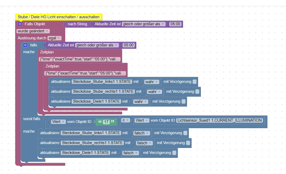

      Moin @all
      Mein erstes Blockly Script, bin absoluter Anfänger.
      // Stube / Diele HG Licht einschalten / ausschalten
      on({id: [].concat(('' + compareTime("05:00", "null", ">="))), change: "ne"}, async function (obj) {
        var value = obj.state.val;
        if (compareTime("05:00", "null", ">=")) {
          schedule('{"time":{"exactTime":true,"start":"05:00"},"valid":{"to":"20.04.3000"},"period":{"days":1,"dows":"[1,2,3,4,5]"}}', async function () {
            schedule('{"time":{"exactTime":true,"start":"05:00"},"valid":{"to":"20.04.3000","from":"24.09.2022"},"period":{"months":"[1,2,3,4,9,10,11,12]"}}', async function () {
              setState("hm-rpc.0.0001D3C99C2CF1.2.STATE"/*Steckdose_Stube_links1 1.STATE*/, true, true);
              setState("hm-rpc.0.0001D3C99C2D31.2.STATE"/*Steckdose_Stube_rechts1 1.STATE*/, true, true);
              setState("hm-rpc.0.0001D3C99CBF6E.2.STATE"/*Steckdose_Diele1 1.STATE*/, true, true);
        } else if (getState('17').val >= getState("hm-rpc.0.000D5A499AFE23.1.CURRENT_ILLUMINATION").val) {
          setState("hm-rpc.0.0001D3C99C2CF1.2.STATE"/*Steckdose_Stube_links1 1.STATE*/, false, true);
          setState("hm-rpc.0.0001D3C99C2D31.2.STATE"/*Steckdose_Stube_rechts1 1.STATE*/, false, true);
          setState("hm-rpc.0.0001D3C99CBF6E.2.STATE"/*Steckdose_Diele1 1.STATE*/, false, true);
      //JTNDeG1sJTIweG1sbnMlM0QlMjJodHRwcyUzQSUyRiUyRmRldmVsb3BlcnMuZ29vZ2xlLmNvbSUyRmJsb2NrbHklMkZ4bWwlMjIlM0UlM0NibG9jayUyMHR5cGUlM0QlMjJjb21tZW50JTIyJTIwaWQlM0QlMjJ3NiUyQlA5VzM2ZCUzQUF3TUFaMHVucSglMjIlMjB4JTNEJTIyMTg4JTIyJTIweSUzRCUyMi0xMDg3JTIyJTNFJTNDZmllbGQlMjBuYW1lJTNEJTIyQ09NTUVOVCUyMiUzRVN0dWJlJTIwJTJGJTIwRGllbGUlMjBIRyUyMExpY2h0JTIwZWluc2NoYWx0ZW4lMjAlMkYlMjBhdXNzY2hhbHRlbiUzQyUyRmZpZWxkJTNFJTNDbmV4dCUzRSUzQ2Jsb2NrJTIwdHlwZSUzRCUyMm9uX2V4dCUyMiUyMGlkJTNEJTIycVclMjNjaXNaTFVvS185eHRDaylmdyUyMiUzRSUzQ211dGF0aW9uJTIweG1sbnMlM0QlMjJodHRwJTNBJTJGJTJGd3d3LnczLm9yZyUyRjE5OTklMkZ4aHRtbCUyMiUyMGl0ZW1zJTNEJTIyMSUyMiUzRSUzQyUyRm11dGF0aW9uJTNFJTNDZmllbGQlMjBuYW1lJTNEJTIyQ09ORElUSU9OJTIyJTNFbmUlM0MlMkZmaWVsZCUzRSUzQ2ZpZWxkJTIwbmFtZSUzRCUyMkFDS19DT05ESVRJT04lMjIlM0UlM0MlMkZmaWVsZCUzRSUzQ3ZhbHVlJTIwbmFtZSUzRCUyMk9JRDAlMjIlM0UlM0NzaGFkb3clMjB0eXBlJTNEJTIyZmllbGRfb2lkJTIyJTIwaWQlM0QlMjIySE5DQSUzQjlvVGpfJTJCeCU1REZySyU2MFl1JTIyJTNFJTNDZmllbGQlMjBuYW1lJTNEJTIyb2lkJTIyJTNFZGVmYXVsdCUzQyUyRmZpZWxkJTNFJTNDJTJGc2hhZG93JTNFJTNDYmxvY2slMjB0eXBlJTNEJTIyY29udmVydF90b3N0cmluZyUyMiUyMGlkJTNEJTIycWglMjR0UyUyQ3YlM0YlM0YzJTVCeG8yJTJCXyU3RFRSTCUyMiUzRSUzQ3ZhbHVlJTIwbmFtZSUzRCUyMlZBTFVFJTIyJTNFJTNDYmxvY2slMjB0eXBlJTNEJTIydGltZV9jb21wYXJlJTIyJTIwaWQlM0QlMjJ2JTYwQlpsQndYZngpKmlhOUlUJTdCJTNCbyUyMiUzRSUzQ211dGF0aW9uJTIweG1sbnMlM0QlMjJodHRwJTNBJTJGJTJGd3d3LnczLm9yZyUyRjE5OTklMkZ4aHRtbCUyMiUyMGVuZF90aW1lJTNEJTIyZmFsc2UlMjIlM0UlM0MlMkZtdXRhdGlvbiUzRSUzQ2ZpZWxkJTIwbmFtZSUzRCUyMk9QVElPTiUyMiUzRSUyNmd0JTNCJTNEJTNDJTJGZmllbGQlM0UlM0NmaWVsZCUyMG5hbWUlM0QlMjJTVEFSVF9USU1FJTIyJTNFMDUlM0EwMCUzQyUyRmZpZWxkJTNFJTNDJTJGYmxvY2slM0UlM0MlMkZ2YWx1ZSUzRSUzQyUyRmJsb2NrJTNFJTNDJTJGdmFsdWUlM0UlM0NzdGF0ZW1lbnQlMjBuYW1lJTNEJTIyU1RBVEVNRU5UJTIyJTNFJTNDYmxvY2slMjB0eXBlJTNEJTIyY29udHJvbHNfaWYlMjIlMjBpZCUzRCUyMjY2TmdEJTJGSyU2MFh6b3dKaGgqJTdDdG5uJTIyJTNFJTNDbXV0YXRpb24lMjBlbHNlaWYlM0QlMjIxJTIyJTNFJTNDJTJGbXV0YXRpb24lM0UlM0N2YWx1ZSUyMG5hbWUlM0QlMjJJRjAlMjIlM0UlM0NibG9jayUyMHR5cGUlM0QlMjJ0aW1lX2NvbXBhcmUlMjIlMjBpZCUzRCUyMjdZSSU3Q2J6TVJSN3RDJTJCMCU3RGt3T2o0JTIyJTNFJTNDbXV0YXRpb24lMjB4bWxucyUzRCUyMmh0dHAlM0ElMkYlMkZ3d3cudzMub3JnJTJGMTk5OSUyRnhodG1sJTIyJTIwZW5kX3RpbWUlM0QlMjJmYWxzZSUyMiUzRSUzQyUyRm11dGF0aW9uJTNFJTNDZmllbGQlMjBuYW1lJTNEJTIyT1BUSU9OJTIyJTNFJTI2Z3QlM0IlM0QlM0MlMkZmaWVsZCUzRSUzQ2ZpZWxkJTIwbmFtZSUzRCUyMlNUQVJUX1RJTUUlMjIlM0UwNSUzQTAwJTNDJTJGZmllbGQlM0UlM0MlMkZibG9jayUzRSUzQyUyRnZhbHVlJTNFJTNDc3RhdGVtZW50JTIwbmFtZSUzRCUyMkRPMCUyMiUzRSUzQ2Jsb2NrJTIwdHlwZSUzRCUyMnNjaGVkdWxlJTIyJTIwaWQlM0QlMjJaJTJGMylSJTI0diU3Q2ZJJTQwZCUyNEtHOENEJTYwUiUyMiUzRSUzQ2ZpZWxkJTIwbmFtZSUzRCUyMlNDSEVEVUxFJTIyJTNFJTdCJTIydGltZSUyMiUzQSU3QiUyMmV4YWN0VGltZSUyMiUzQXRydWUlMkMlMjJzdGFydCUyMiUzQSUyMjA1JTNBMDAlMjIlN0QlMkMlMjJ2YWxpZCUyMiUzQSU3QiUyMnRvJTIyJTNBJTIyMjAuMDQuMzAwMCUyMiU3RCUyQyUyMnBlcmlvZCUyMiUzQSU3QiUyMmRheXMlMjIlM0ExJTJDJTIyZG93cyUyMiUzQSUyMiU1QjElMkMyJTJDMyUyQzQlMkM1JTVEJTIyJTdEJTdEJTNDJTJGZmllbGQlM0UlM0NzdGF0ZW1lbnQlMjBuYW1lJTNEJTIyU1RBVEVNRU5UJTIyJTNFJTNDYmxvY2slMjB0eXBlJTNEJTIyc2NoZWR1bGUlMjIlMjBpZCUzRCUyMmxIJTdDamJvJTNEJTNEOCElN0RfN3JWaENlJTQwTyUyMiUzRSUzQ2ZpZWxkJTIwbmFtZSUzRCUyMlNDSEVEVUxFJTIyJTNFJTdCJTIydGltZSUyMiUzQSU3QiUyMmV4YWN0VGltZSUyMiUzQXRydWUlMkMlMjJzdGFydCUyMiUzQSUyMjA1JTNBMDAlMjIlN0QlMkMlMjJ2YWxpZCUyMiUzQSU3QiUyMnRvJTIyJTNBJTIyMjAuMDQuMzAwMCUyMiUyQyUyMmZyb20lMjIlM0ElMjIyNC4wOS4yMDIyJTIyJTdEJTJDJTIycGVyaW9kJTIyJTNBJTdCJTIybW9udGhzJTIyJTNBJTIyJTVCMSUyQzIlMkMzJTJDNCUyQzklMkMxMCUyQzExJTJDMTIlNUQlMjIlN0QlN0QlM0MlMkZmaWVsZCUzRSUzQ3N0YXRlbWVudCUyMG5hbWUlM0QlMjJTVEFURU1FTlQlMjIlM0UlM0NibG9jayUyMHR5cGUlM0QlMjJ1cGRhdGUlMjIlMjBpZCUzRCUyMn4lN0JKN3lyJTI1JTQwKGYlMjRKenolNjBoblclM0FPJTIyJTNFJTNDbXV0YXRpb24lMjB4bWxucyUzRCUyMmh0dHAlM0ElMkYlMkZ3d3cudzMub3JnJTJGMTk5OSUyRnhodG1sJTIyJTIwZGVsYXlfaW5wdXQlM0QlMjJmYWxzZSUyMiUzRSUzQyUyRm11dGF0aW9uJTNFJTNDZmllbGQlMjBuYW1lJTNEJTIyT0lEJTIyJTNFaG0tcnBjLjAuMDAwMUQzQzk5QzJDRjEuMi5TVEFURSUzQyUyRmZpZWxkJTNFJTNDZmllbGQlMjBuYW1lJTNEJTIyV0lUSF9ERUxBWSUyMiUzRUZBTFNFJTNDJTJGZmllbGQlM0UlM0N2YWx1ZSUyMG5hbWUlM0QlMjJWQUxVRSUyMiUzRSUzQ2Jsb2NrJTIwdHlwZSUzRCUyMmxvZ2ljX2Jvb2xlYW4lMjIlMjBpZCUzRCUyMjY5S2tILiUyNUtsNkYzLSUzQnklN0MtKl9aJTIyJTNFJTNDZmllbGQlMjBuYW1lJTNEJTIyQk9PTCUyMiUzRVRSVUUlM0MlMkZmaWVsZCUzRSUzQyUyRmJsb2NrJTNFJTNDJTJGdmFsdWUlM0UlM0NuZXh0JTNFJTNDYmxvY2slMjB0eXBlJTNEJTIydXBkYXRlJTIyJTIwaWQlM0QlMjIlN0NhKnhWZ0hsRSolMjRDM2olMjMlN0IlMjVDJTNGdiUyMiUzRSUzQ211dGF0aW9uJTIweG1sbnMlM0QlMjJodHRwJTNBJTJGJTJGd3d3LnczLm9yZyUyRjE5OTklMkZ4aHRtbCUyMiUyMGRlbGF5X2lucHV0JTNEJTIyZmFsc2UlMjIlM0UlM0MlMkZtdXRhdGlvbiUzRSUzQ2ZpZWxkJTIwbmFtZSUzRCUyMk9JRCUyMiUzRWhtLXJwYy4wLjAwMDFEM0M5OUMyRDMxLjIuU1RBVEUlM0MlMkZmaWVsZCUzRSUzQ2ZpZWxkJTIwbmFtZSUzRCUyMldJVEhfREVMQVklMjIlM0VGQUxTRSUzQyUyRmZpZWxkJTNFJTNDdmFsdWUlMjBuYW1lJTNEJTIyVkFMVUUlMjIlM0UlM0NibG9jayUyMHR5cGUlM0QlMjJsb2dpY19ib29sZWFuJTIyJTIwaWQlM0QlMjIxQzBaJTNERiFUVDlVMCUzQk1pRipDbCglMjIlM0UlM0NmaWVsZCUyMG5hbWUlM0QlMjJCT09MJTIyJTNFVFJVRSUzQyUyRmZpZWxkJTNFJTNDJTJGYmxvY2slM0UlM0MlMkZ2YWx1ZSUzRSUzQ25leHQlM0UlM0NibG9jayUyMHR5cGUlM0QlMjJ1cGRhdGUlMjIlMjBpZCUzRCUyMjklMkYlNDBZVmtrKmpQJTVCJTNCdSF1VVNjJTVFbyUyMiUzRSUzQ211dGF0aW9uJTIweG1sbnMlM0QlMjJodHRwJTNBJTJGJTJGd3d3LnczLm9yZyUyRjE5OTklMkZ4aHRtbCUyMiUyMGRlbGF5X2lucHV0JTNEJTIyZmFsc2UlMjIlM0UlM0MlMkZtdXRhdGlvbiUzRSUzQ2ZpZWxkJTIwbmFtZSUzRCUyMk9JRCUyMiUzRWhtLXJwYy4wLjAwMDFEM0M5OUNCRjZFLjIuU1RBVEUlM0MlMkZmaWVsZCUzRSUzQ2ZpZWxkJTIwbmFtZSUzRCUyMldJVEhfREVMQVklMjIlM0VGQUxTRSUzQyUyRmZpZWxkJTNFJTNDdmFsdWUlMjBuYW1lJTNEJTIyVkFMVUUlMjIlM0UlM0NibG9jayUyMHR5cGUlM0QlMjJsb2dpY19ib29sZWFuJTIyJTIwaWQlM0QlMjJTcmlILX5VLTIhJTNEJTJGZTlhZnUlNUJ2ZSUyMiUzRSUzQ2ZpZWxkJTIwbmFtZSUzRCUyMkJPT0wlMjIlM0VUUlVFJTNDJTJGZmllbGQlM0UlM0MlMkZibG9jayUzRSUzQyUyRnZhbHVlJTNFJTNDJTJGYmxvY2slM0UlM0MlMkZuZXh0JTNFJTNDJTJGYmxvY2slM0UlM0MlMkZuZXh0JTNFJTNDJTJGYmxvY2slM0UlM0MlMkZzdGF0ZW1lbnQlM0UlM0MlMkZibG9jayUzRSUzQyUyRnN0YXRlbWVudCUzRSUzQyUyRmJsb2NrJTNFJTNDJTJGc3RhdGVtZW50JTNFJTNDdmFsdWUlMjBuYW1lJTNEJTIySUYxJTIyJTNFJTNDYmxvY2slMjB0eXBlJTNEJTIybG9naWNfY29tcGFyZSUyMiUyMGlkJTNEJTIyKXg3LWolMkMtUC5JJTJDclB3JTdDUVUycUYlMjIlM0UlM0NmaWVsZCUyMG5hbWUlM0QlMjJPUCUyMiUzRUdURSUzQyUyRmZpZWxkJTNFJTNDdmFsdWUlMjBuYW1lJTNEJTIyQSUyMiUzRSUzQ2Jsb2NrJTIwdHlwZSUzRCUyMmdldF92YWx1ZV92YXIlMjIlMjBpZCUzRCUyMnclM0IlMjU4JTNBJTVFJTVFRi5EXzhDTHQoJTQwLjVVJTIyJTNFJTNDZmllbGQlMjBuYW1lJTNEJTIyQVRUUiUyMiUzRXZhbCUzQyUyRmZpZWxkJTNFJTNDdmFsdWUlMjBuYW1lJTNEJTIyT0lEJTIyJTNFJTNDc2hhZG93JTIwdHlwZSUzRCUyMnRleHQlMjIlMjBpZCUzRCUyMlZiSyktYV9tJTNBIXAtZF9sbjBybTUlMjIlM0UlM0NmaWVsZCUyMG5hbWUlM0QlMjJURVhUJTIyJTNFJTNDJTJGZmllbGQlM0UlM0MlMkZzaGFkb3clM0UlM0NibG9jayUyMHR5cGUlM0QlMjJ0ZXh0JTIyJTIwaWQlM0QlMjJFVmp4JTNCJTVFMGhhSyUzQjIlNUJiQ3QlMkJTOGIlMjIlM0UlM0NmaWVsZCUyMG5hbWUlM0QlMjJURVhUJTIyJTNFMTclM0MlMkZmaWVsZCUzRSUzQyUyRmJsb2NrJTNFJTNDJTJGdmFsdWUlM0UlM0MlMkZibG9jayUzRSUzQyUyRnZhbHVlJTNFJTNDdmFsdWUlMjBuYW1lJTNEJTIyQiUyMiUzRSUzQ2Jsb2NrJTIwdHlwZSUzRCUyMmdldF92YWx1ZSUyMiUyMGlkJTNEJTIyZCUyQyU3RC5ZaHN4JTYwfmtnJTdEOCU3QiU1Qmp2fkglMjIlM0UlM0NmaWVsZCUyMG5hbWUlM0QlMjJBVFRSJTIyJTNFdmFsJTNDJTJGZmllbGQlM0UlM0NmaWVsZCUyMG5hbWUlM0QlMjJPSUQlMjIlM0VobS1ycGMuMC4wMDBENUE0OTlBRkUyMy4xLkNVUlJFTlRfSUxMVU1JTkFUSU9OJTNDJTJGZmllbGQlM0UlM0MlMkZibG9jayUzRSUzQyUyRnZhbHVlJTNFJTNDJTJGYmxvY2slM0UlM0MlMkZ2YWx1ZSUzRSUzQ3N0YXRlbWVudCUyMG5hbWUlM0QlMjJETzElMjIlM0UlM0NibG9jayUyMHR5cGUlM0QlMjJ1cGRhdGUlMjIlMjBpZCUzRCUyMiUyNS1zazZqJTQwb3AlMjNpRWtoeUJVLmpBJTIyJTNFJTNDbXV0YXRpb24lMjB4bWxucyUzRCUyMmh0dHAlM0ElMkYlMkZ3d3cudzMub3JnJTJGMTk5OSUyRnhodG1sJTIyJTIwZGVsYXlfaW5wdXQlM0QlMjJmYWxzZSUyMiUzRSUzQyUyRm11dGF0aW9uJTNFJTNDZmllbGQlMjBuYW1lJTNEJTIyT0lEJTIyJTNFaG0tcnBjLjAuMDAwMUQzQzk5QzJDRjEuMi5TVEFURSUzQyUyRmZpZWxkJTNFJTNDZmllbGQlMjBuYW1lJTNEJTIyV0lUSF9ERUxBWSUyMiUzRUZBTFNFJTNDJTJGZmllbGQlM0UlM0N2YWx1ZSUyMG5hbWUlM0QlMjJWQUxVRSUyMiUzRSUzQ2Jsb2NrJTIwdHlwZSUzRCUyMmxvZ2ljX2Jvb2xlYW4lMjIlMjBpZCUzRCUyMmNBKGslN0QlM0QwRiUyQlkqMkxtN08lMkN+eHUlMjIlM0UlM0NmaWVsZCUyMG5hbWUlM0QlMjJCT09MJTIyJTNFRkFMU0UlM0MlMkZmaWVsZCUzRSUzQyUyRmJsb2NrJTNFJTNDJTJGdmFsdWUlM0UlM0NuZXh0JTNFJTNDYmxvY2slMjB0eXBlJTNEJTIydXBkYXRlJTIyJTIwaWQlM0QlMjJHaHpLNkxWdSUyM1I1VlhuRDhPWTlNJTIyJTNFJTNDbXV0YXRpb24lMjB4bWxucyUzRCUyMmh0dHAlM0ElMkYlMkZ3d3cudzMub3JnJTJGMTk5OSUyRnhodG1sJTIyJTIwZGVsYXlfaW5wdXQlM0QlMjJmYWxzZSUyMiUzRSUzQyUyRm11dGF0aW9uJTNFJTNDZmllbGQlMjBuYW1lJTNEJTIyT0lEJTIyJTNFaG0tcnBjLjAuMDAwMUQzQzk5QzJEMzEuMi5TVEFURSUzQyUyRmZpZWxkJTNFJTNDZmllbGQlMjBuYW1lJTNEJTIyV0lUSF9ERUxBWSUyMiUzRUZBTFNFJTNDJTJGZmllbGQlM0UlM0N2YWx1ZSUyMG5hbWUlM0QlMjJWQUxVRSUyMiUzRSUzQ2Jsb2NrJTIwdHlwZSUzRCUyMmxvZ2ljX2Jvb2xlYW4lMjIlMjBpZCUzRCUyMlglMkYyJTVCJTQwc3lMdkkhcF9GJTNCZm9uMSUzRiUyMiUzRSUzQ2ZpZWxkJTIwbmFtZSUzRCUyMkJPT0wlMjIlM0VGQUxTRSUzQyUyRmZpZWxkJTNFJTNDJTJGYmxvY2slM0UlM0MlMkZ2YWx1ZSUzRSUzQ25leHQlM0UlM0NibG9jayUyMHR5cGUlM0QlMjJ1cGRhdGUlMjIlMjBpZCUzRCUyMnhTMlZuNUgqMFE0IWkqWiUzQUYlNUJRcyUyMiUzRSUzQ211dGF0aW9uJTIweG1sbnMlM0QlMjJodHRwJTNBJTJGJTJGd3d3LnczLm9yZyUyRjE5OTklMkZ4aHRtbCUyMiUyMGRlbGF5X2lucHV0JTNEJTIyZmFsc2UlMjIlM0UlM0MlMkZtdXRhdGlvbiUzRSUzQ2ZpZWxkJTIwbmFtZSUzRCUyMk9JRCUyMiUzRWhtLXJwYy4wLjAwMDFEM0M5OUNCRjZFLjIuU1RBVEUlM0MlMkZmaWVsZCUzRSUzQ2ZpZWxkJTIwbmFtZSUzRCUyMldJVEhfREVMQVklMjIlM0VGQUxTRSUzQyUyRmZpZWxkJTNFJTNDdmFsdWUlMjBuYW1lJTNEJTIyVkFMVUUlMjIlM0UlM0NibG9jayUyMHR5cGUlM0QlMjJsb2dpY19ib29sZWFuJTIyJTIwaWQlM0QlMjJpdWh6V08lMjUlMkYpYWUuSjElMjRpcWRJJTNGJTIyJTNFJTNDZmllbGQlMjBuYW1lJTNEJTIyQk9PTCUyMiUzRUZBTFNFJTNDJTJGZmllbGQlM0UlM0MlMkZibG9jayUzRSUzQyUyRnZhbHVlJTNFJTNDJTJGYmxvY2slM0UlM0MlMkZuZXh0JTNFJTNDJTJGYmxvY2slM0UlM0MlMkZuZXh0JTNFJTNDJTJGYmxvY2slM0UlM0MlMkZzdGF0ZW1lbnQlM0UlM0MlMkZibG9jayUzRSUzQyUyRnN0YXRlbWVudCUzRSUzQyUyRmJsb2NrJTNFJTNDJTJGbmV4dCUzRSUzQyUyRmJsb2NrJTNFJTNDJTJGeG1sJTNF
      Vor hatte ich das :
      in den Monaten Sep,Okt,Nov,Dez,Jan,Feb,Mär,Apr
      an den Tagen Mo - Fr
      in der Zeit ab 05:00 Uhr das Licht geht
      und mit erreichen einer Außenhelligkeit von > 17 lx das Licht wieder aus geht.
      Könnt Ihr mal drüber Sehen ob ich es so richtig Zusammengestellt habe.

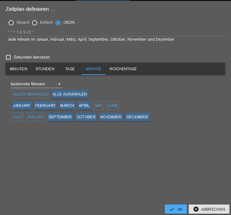

          Ein Frage habe ich noch.
          Denn ich bekomme den Zeitplan so nicht hin.
          Entweder bekomme ich zur Auswahl : Wizard , Einfach . CRON
          Wenn ich CRON Auswähle bekomme ich :
          Wie komme ich auf deine Einstellung?
            paul53 @ioBrokerMike last edited by paul53
            @iobrokermike sagte: Wie komme ich auf deine Einstellung?
            Uhrzeit und Wochentage sind schon ausgewählt. Nun noch den Tab "Monate" (links neben "Wochentage") selektieren und die Monate September bis April auswählen.

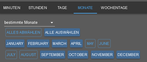

              • DJMarc75
                DJMarc75 @ioBrokerMike last edited by
                @iobrokermike sagte in Zeituhr Script | Korrektur lesen wenn möglich:
                Finde einfach links daneben nicht.

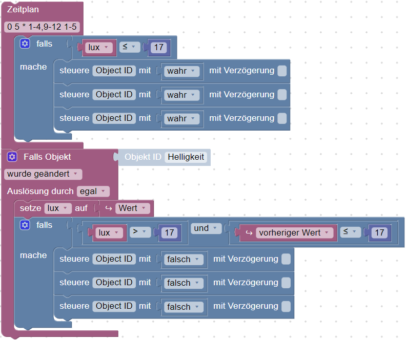

                    @iobrokermike
                    CRON
                     <variables>
                       <variable id="X:Ka{9hE@kokx5Iuy;gA">lux</variable>
                     </variables>
                     <block type="schedule" id="/|{#(jKv5vZ.Zn/f-:vU" x="-31" y="-858">
                       <field name="SCHEDULE">0 5 * 1-4,9-12 1-5</field>
                         <block type="controls_if" id="/OUv.o??P/3DmBk3Y?2g">
                             <block type="logic_compare" id="s!/$+N[thVQ@,_*S-r,@">
                               <field name="OP">LTE</field>
                                 <block type="variables_get" id="yc6hm|ilmN(C(]8-){iw">
                                   <field name="VAR" id="X:Ka{9hE@kokx5Iuy;gA">lux</field>
                                 <block type="math_number" id="WRq*Gp:lAtVtddS5J})i">
                                   <field name="NUM">17</field>
                             <block type="control" id="K;#6[`!r2bkj9@`rZ)DS">
                               <field name="OID">hm-rpc.0.0001D3C99C2D31.2.STATE</field>
                                 <block type="logic_boolean" id="6GV~WA1U~{kkbK%8P9C0">
                                 <block type="control" id="V^2K?,u^-fdJlBV,K?:!">
                                   <field name="OID">hm-rpc.0.0001D3C99C2CF1.3.STATE</field>
                                     <block type="logic_boolean" id="i^iAlt}JsDg@/fjnuY6a">
                                     <block type="control" id="FitaMn/+U?-T(+:T3ZEs">
                                       <field name="OID">hm-rpc.0.0001D3C99CBF6E.2.STATE</field>
                                         <block type="logic_boolean" id="iIEpim!8/yr8ow8@3DOQ">

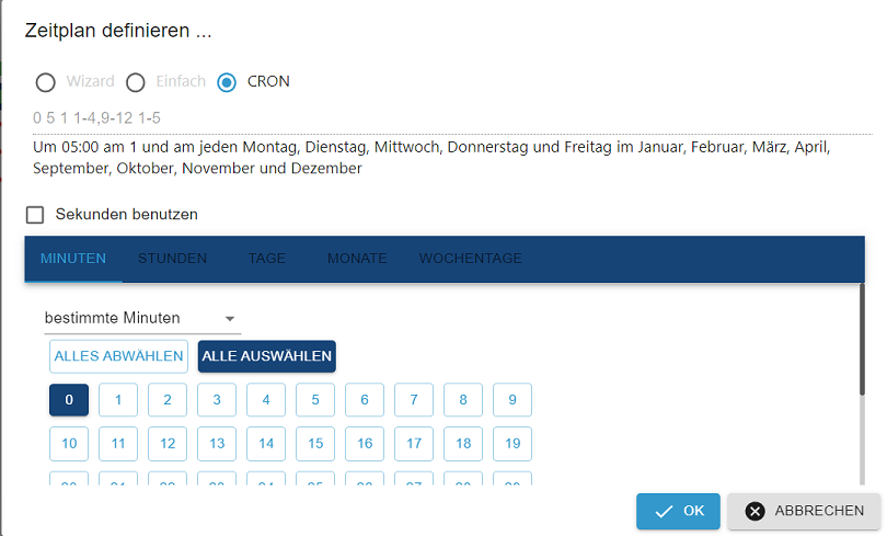

                    • DJMarc75
                      DJMarc75 @ioBrokerMike last edited by DJMarc75
                      Habe ich einen falschen Zeitplan?
                      In Deinem Skript schon.
                      Dein Bild habe ich nicht
                      Natürlich hast Du das wenn Du "wie oben" auch auf CRON umstellst:
                      • I
                        ioBrokerMike @DJMarc75 last edited by
                        @djmarc75 sagte in Zeituhr Script | Korrektur lesen wenn möglich:
                        Vielen Dank, jetzt ist der Groschen gefallen.
