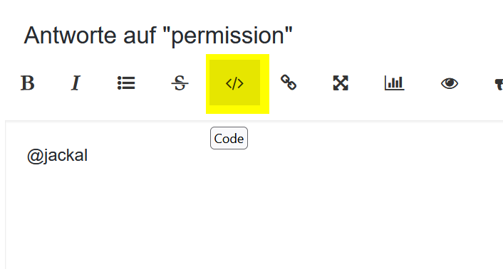

                              CodeTags verwenden.
                                Jackal @Thomas Braun last edited by
                                @thomas-braun Sorry, aber was sind CodeTags? 🙄
                                  Thomas Braun Most Active @Jackal last edited by
                                  @jackal
                                    @jackal
