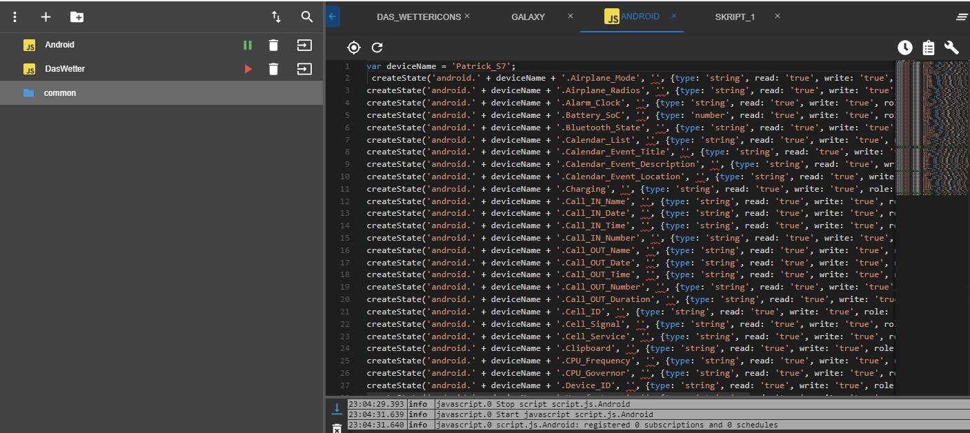

      • Skript zum erästellen der Datenpunkte in ioBroker
      • simpleAPI Adapter installiert und Aktiviert
      - die App States to ioBroker
      var deviceName = 'Tab2';
       createState('android.' + deviceName + '.Airplane_Mode', '', {type: 'string', read: 'true', write: 'true', role: 'indicator.state'});
      createState('android.' + deviceName + '.Airplane_Radios', '', {type: 'string', read: 'true', write: 'true', role: 'text'});
      createState('android.' + deviceName + '.Alarm_Clock', '', {type: 'string', read: 'true', write: 'true', role: 'text'});
      createState('android.' + deviceName + '.Battery_SoC', '', {type: 'number', read: 'true', write: 'true', role: 'indicator.battery'});
      createState('android.' + deviceName + '.Bluetooth_State', '', {type: 'string', read: 'true', write: 'true', role: 'indicator.state'});
      createState('android.' + deviceName + '.Calendar_List', '', {type: 'string', read: 'true', write: 'true', role: 'text'});
      createState('android.' + deviceName + '.Calendar_Event_Title', '', {type: 'string', read: 'true', write: 'true', role: 'indicator.state'});
      createState('android.' + deviceName + '.Calendar_Event_Description', '', {type: 'string', read: 'true', write: 'true', role: 'indicator.state'});
      createState('android.' + deviceName + '.Calendar_Event_Location', '', {type: 'string', read: 'true', write: 'true', role: 'indicator.state'});
      createState('android.' + deviceName + '.Charging', '', {type: 'string', read: 'true', write: 'true', role: 'indicator.battery'});
      createState('android.' + deviceName + '.Call_IN_Name', '', {type: 'string', read: 'true', write: 'true', role: 'text'});
      createState('android.' + deviceName + '.Call_IN_Date', '', {type: 'string', read: 'true', write: 'true', role: 'text'});
      createState('android.' + deviceName + '.Call_IN_Time', '', {type: 'string', read: 'true', write: 'true', role: 'text'});
      createState('android.' + deviceName + '.Call_IN_Number', '', {type: 'string', read: 'true', write: 'true', role: 'text'});
      createState('android.' + deviceName + '.Call_OUT_Name', '', {type: 'string', read: 'true', write: 'true', role: 'text'});
      createState('android.' + deviceName + '.Call_OUT_Date', '', {type: 'string', read: 'true', write: 'true', role: 'text'});
      createState('android.' + deviceName + '.Call_OUT_Time', '', {type: 'string', read: 'true', write: 'true', role: 'text'});
      createState('android.' + deviceName + '.Call_OUT_Number', '', {type: 'string', read: 'true', write: 'true', role: 'text'});
      createState('android.' + deviceName + '.Call_OUT_Duration', '', {type: 'string', read: 'true', write: 'true', role: 'text'})
      createState('android.' + deviceName + '.Cell_ID', '', {type: 'string', read: 'true', write: 'true', role: 'text'});
      createState('android.' + deviceName + '.Cell_Signal', '', {type: 'string', read: 'true', write: 'true', role: 'text'});
      createState('android.' + deviceName + '.Cell_Service', '', {type: 'string', read: 'true', write: 'true', role: 'text'});
      createState('android.' + deviceName + '.Clipboard', '', {type: 'string', read: 'true', write: 'true', role: 'text'});
      createState('android.' + deviceName + '.CPU_Frequency', '', {type: 'string', read: 'true', write: 'true', role: 'text'});
      createState('android.' + deviceName + '.CPU_Governor', '', {type: 'string', read: 'true', write: 'true', role: 'text'});
      createState('android.' + deviceName + '.Device_ID', '', {type: 'string', read: 'true', write: 'true', role: 'text'});
      createState('android.' + deviceName + '.Manufacturer', '', {type: 'string', read: 'true', write: 'true', role: 'text'});
      createState('android.' + deviceName + '.Model', '', {type: 'string', read: 'true', write: 'true', role: 'text'});
      createState('android.' + deviceName + '.Product', '', {type: 'string', read: 'true', write: 'true', role: 'text'});
      createState('android.' + deviceName + '.Phone_ID', '', {type: 'string', read: 'true', write: 'true', role: 'text'});
      createState('android.' + deviceName + '.Display_Brightness', '', {type: 'number', read: 'true', write: 'true', role: 'inidcator.state'});
      createState('android.' + deviceName + '.Display_Timeout', '', {type: 'number', read: 'true', write: 'true', role: 'indicator.state'});
      createState('android.' + deviceName + '.Email_From', '', {type: 'string', read: 'true', write: 'true', role: 'indicator.state'});
      createState('android.' + deviceName + '.Email_CC', '', {type: 'string', read: 'true', write: 'true', role: 'indicator.state'});
      createState('android.' + deviceName + '.Email_Subject', '', {type: 'string', read: 'true', write: 'true', role: 'indicator.state'});
      createState('android.' + deviceName + '.Email_Date', '', {type: 'string', read: 'true', write: 'true', role: 'indicator.state'});
      createState('android.' + deviceName + '.Email_Time', '', {type: 'string', read: 'true', write: 'true', role: 'indicator.state'});
      createState('android.' + deviceName + '.Free_Memory', '', {type: 'number', read: 'true', write: 'true', role: 'indicator.state'});
      createState('android.' + deviceName + '.GPS_Status', '', {type: 'string', read: 'true', write: 'true', role: 'indicator.state'});
      createState('android.' + deviceName + '.Heart_Rate', '', {type: 'string', read: 'true', write: 'true', role: 'indicator.state'});
      createState('android.' + deviceName + '.Input_Method', '', {type: 'string', read: 'true', write: 'true', role: 'indicator.state'});
      createState('android.' + deviceName + '.Interrupt_Mode', '', {type: 'string', read: 'true', write: 'true', role: 'indicator.state'});
      createState('android.' + deviceName + '.Keyguard', '', {type: 'string', read: 'true', write: 'true', role: 'indicator.state'});
      createState('android.' + deviceName + '.Last_App', '', {type: 'string', read: 'true', write: 'true', role: 'indicator.state'});
      createState('android.' + deviceName + '.Last_Photo', '', {type: 'string', read: 'true', write: 'true', role: 'indicator.state'});
      createState('android.' + deviceName + '.Light_Level', '', {type: 'string', read: 'true', write: 'true', role: 'indicator.state'});
      createState('android.' + deviceName + '.Location', '', {type: 'string', read: 'true', write: 'true', role: 'indicator.state'});
      createState('android.' + deviceName + '.Location_Accuracy', '', {type: 'string', read: 'true', write: 'true', role: 'indicator.state'});
      createState('android.' + deviceName + '.Location_Altitude', '', {type: 'string', read: 'true', write: 'true', role: 'indicator.state'});
      createState('android.' + deviceName + '.Location_Speed', '', {type: 'string', read: 'true', write: 'true', role: 'indicator.state'});
      createState('android.' + deviceName + '.Location_Fix_Time', '', {type: 'string', read: 'true', write: 'true', role: 'indicator.state'});
      createState('android.' + deviceName + '.Location_Network', '', {type: 'string', read: 'true', write: 'true', role: 'indicator.state'});
      createState('android.' + deviceName + '.Location_Accuracy_Network', '', {type: 'string', read: 'true', write: 'true', role: 'indicator.state'});
      createState('android.' + deviceName + '.Location_Fix_Time_Network', '', {type: 'string', read: 'true', write: 'true', role: 'indicator.state'});
      createState('android.' + deviceName + '.Magnetic_Field_Strength', '', {type: 'string', read: 'true', write: 'true', role: 'indicator.state'});
      createState('android.' + deviceName + '.Music_Track', '', {type: 'string', read: 'true', write: 'true', role: 'indicator.state'});
      createState('android.' + deviceName + '.Muted', '', {type: 'string', read: 'true', write: 'true', role: 'indicator.state'});
      createState('android.' + deviceName + '.Night_Mode', '', {type: 'string', read: 'true', write: 'true', role: 'indicator.state'});
      createState('android.' + deviceName + '.Notification_Title', '', {type: 'string', read: 'true', write: 'true', role: 'indicator.state'});
      createState('android.' + deviceName + '.Phone_Number', '', {type: 'string', read: 'true', write: 'true', role: 'indicator.state'});
      createState('android.' + deviceName + '.Pressure', '', {type: 'string', read: 'true', write: 'true', role: 'indicator.state'});
      //createState('android.' + deviceName + '.Profiles_Active', '', {type: 'string', read: 'true', write: 'true', role: 'indicator.state'});
      //createState('android.' + deviceName + '.Profiles_Enabled', '', {type: 'string', read: 'true', write: 'true', role: 'indicator.state'});
      createState('android.' + deviceName + '.Roaming', '', {type: 'string', read: 'true', write: 'true', role: 'indicator.state'});
      createState('android.' + deviceName + '.Root_Available', '', {type: 'string', read: 'true', write: 'true', role: 'indicator.state'});
      createState('android.' + deviceName + '.Screen', '', {type: 'string', read: 'true', write: 'true', role: 'indicator.state'});
      createState('android.' + deviceName + '.SDK_Version', '', {type: 'string', read: 'true', write: 'true', role: 'indicator.state'});
      createState('android.' + deviceName + '.Silent_Mode', '', {type: 'string', read: 'true', write: 'true', role: 'indicator.state'});
      createState('android.' + deviceName + '.SIM_Serial_Number', '', {type: 'string', read: 'true', write: 'true', role: 'indicator.state'});
      createState('android.' + deviceName + '.SIM_State', '', {type: 'string', read: 'true', write: 'true', role: 'indicator.state'});
      createState('android.' + deviceName + '.SMS_From', '', {type: 'string', read: 'true', write: 'true', role: 'indicator.state'});
      createState('android.' + deviceName + '.SMS_Name', '', {type: 'string', read: 'true', write: 'true', role: 'indicator.state'});
      createState('android.' + deviceName + '.SMS_Date', '', {type: 'string', read: 'true', write: 'true', role: 'indicator.state'});
      createState('android.' + deviceName + '.SMS_Time', '', {type: 'string', read: 'true', write: 'true', role: 'indicator.state'});
      createState('android.' + deviceName + '.SMS_Subject', '', {type: 'string', read: 'true', write: 'true', role: 'indicator.state'});
      createState('android.' + deviceName + '.SMS_Text', '', {type: 'string', read: 'true', write: 'true', role: 'indicator.state'});
      createState('android.' + deviceName + '.MMS_Text', '', {type: 'string', read: 'true', write: 'true', role: 'indicator.state'});
      createState('android.' + deviceName + '.Speakerphone', '', {type: 'string', read: 'true', write: 'true', role: 'indicator.state'});
      createState('android.' + deviceName + '.Speech', '', {type: 'string', read: 'true', write: 'true', role: 'indicator.state'});
      //createState('android.' + deviceName + '.Tasks_Running', '', {type: 'string', read: 'true', write: 'true', role: 'indicator.state'});
      createState('android.' + deviceName + '.Tel_state', '', {type: 'string', read: 'true', write: 'true', role: 'indicator.state'});
      createState('android.' + deviceName + '.Telephone_Network', '', {type: 'string', read: 'true', write: 'true', role: 'indicator.state'});
      createState('android.' + deviceName + '.Temperature', '', {type: 'string', read: 'true', write: 'true', role: 'indicator.state'});
      createState('android.' + deviceName + '.Tether', '', {type: 'string', read: 'true', write: 'true', role: 'indicator.state'});
      createState('android.' + deviceName + '.UI_Mode', '', {type: 'string', read: 'true', write: 'true', role: 'indicator.state'});
      createState('android.' + deviceName + '.Uptime_Seconds', '', {type: 'string', read: 'true', write: 'true', role: 'indicator.state'});
      createState('android.' + deviceName + '.Volume_Alarm', '', {type: 'string', read: 'true', write: 'true', role: 'indicator.state'});
      createState('android.' + deviceName + '.Volume_Call', '', {type: 'string', read: 'true', write: 'true', role: 'indicator.state'});
      createState('android.' + deviceName + '.Volume_DTMF', '', {type: 'string', read: 'true', write: 'true', role: 'indicator.state'});
      createState('android.' + deviceName + '.Volume_Media', '', {type: 'string', read: 'true', write: 'true', role: 'indicator.state'});
      createState('android.' + deviceName + '.Volume_Notification', '', {type: 'string', read: 'true', write: 'true', role: 'indicator.state'});
      createState('android.' + deviceName + '.Volume_Ringer', '', {type: 'string', read: 'true', write: 'true', role: 'indicator.state'});
      createState('android.' + deviceName + '.Volume_System', '', {type: 'string', read: 'true', write: 'true', role: 'indicator.state'});
      createState('android.' + deviceName + '.Wifi_Info', '', {type: 'string', read: 'true', write: 'true', role: 'indicator.state'});
      createState('android.' + deviceName + '.Wifi_Status', '', {type: 'string', read: 'true', write: 'true', role: 'indicator.state'});
      //createState('android.' + deviceName + '.Wimax_Status', '', {type: 'string', read: 'true', write: 'true', role: 'indicator.state'});
      createState('android.' + deviceName + '.Window_Label', '', {type: 'string', read: 'true', write: 'true', role: 'indicator.state'});

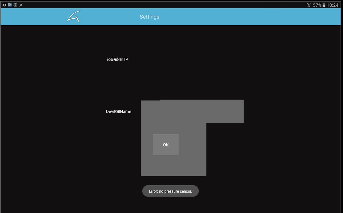

        Leider kann ich in der App die Einstellung nicht vornehmen, Eingabemaske total verschoben.
        Samsung Tab A 10.1
        Logischerweise auch Fehlereinblendungen bezüglich der fehlenden Sensoren.
        Es sollte in der App auswählbar sein, welche Sensoren aktiv sein sollen.

          Allerdings hat mein OP3T keinen Drucksensor, Deine geplante Möglichkeit, Sensoren abzuschalten ist eine gute Idee. So kommt alle paar Sekunden eine nervige Meldung, dass es keinen Drucksensor gibt.

              @andyb:
              Leider kann ich in der App die Einstellung nicht vornehmen, Eingabemaske total verschoben. `
              Im Hochformat sollte es klappen. Da muss ich noch nach einer Lösung suchen, damit es auch im Querformat klappt.

                andyb last edited by
                Hab mein Haus auf die Seite geklappt das Wandtablet auf Hochformat gewechselt hat, dann gings [emoji12]
                Die Fehlermeldungen auf dem Display zwecks fehlender Sensoren sind halt recht unschön.

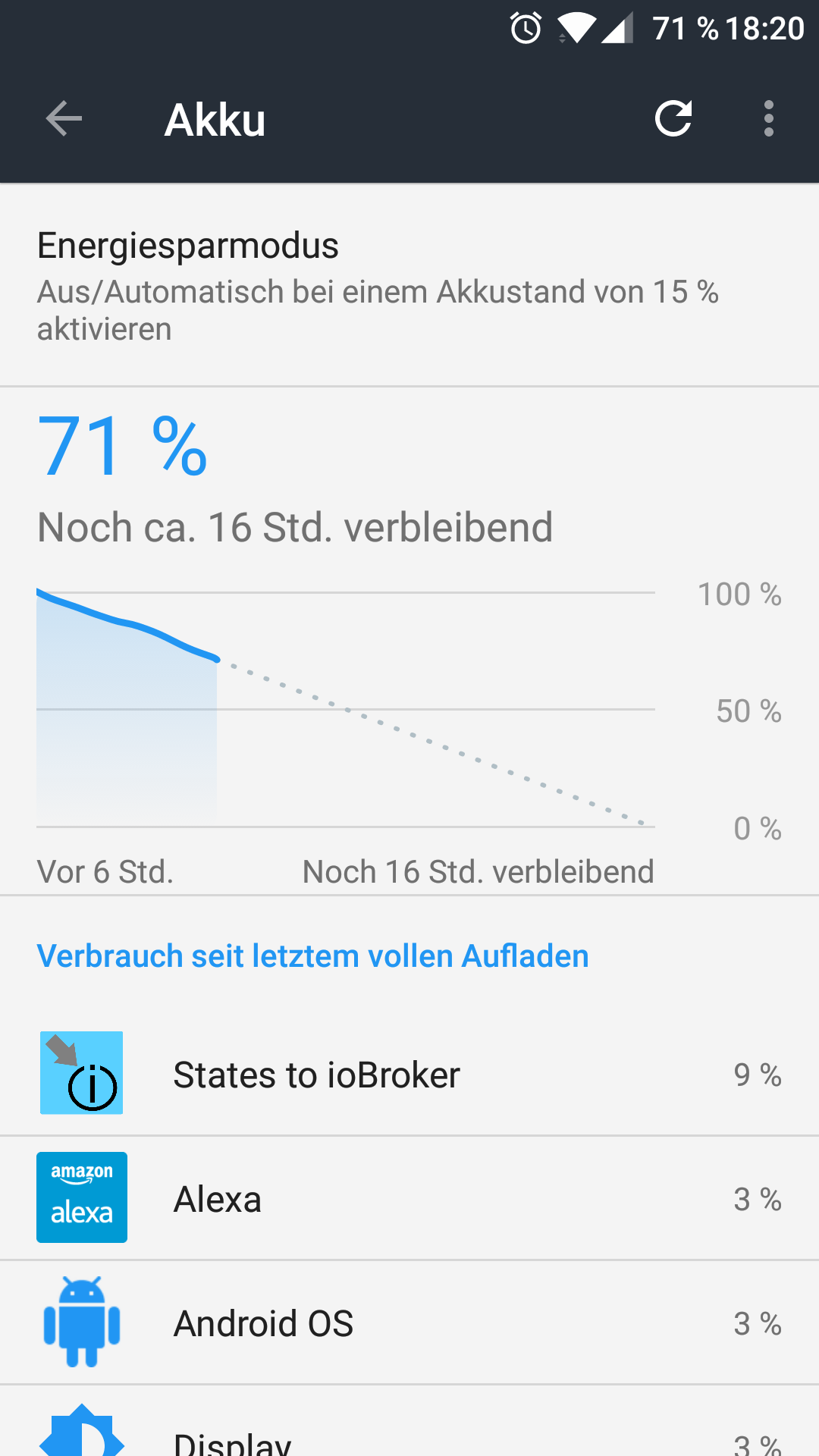

                                          Ich hab noch nicht geupdatet, aber was auffällt ist der hohe Akkuverbrauch. Bei euch auch?
                                            Kann ich leider bestätigen. 😞
                                            Enrico
