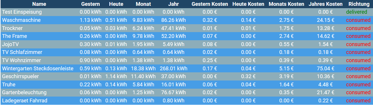

      wie zugesagt ein json-erzeugungs-script für sourceanalytics

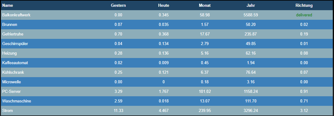

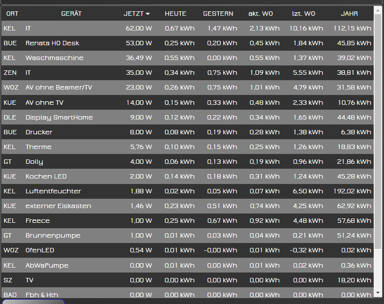

      schaut dann so aus:
      hier das script:

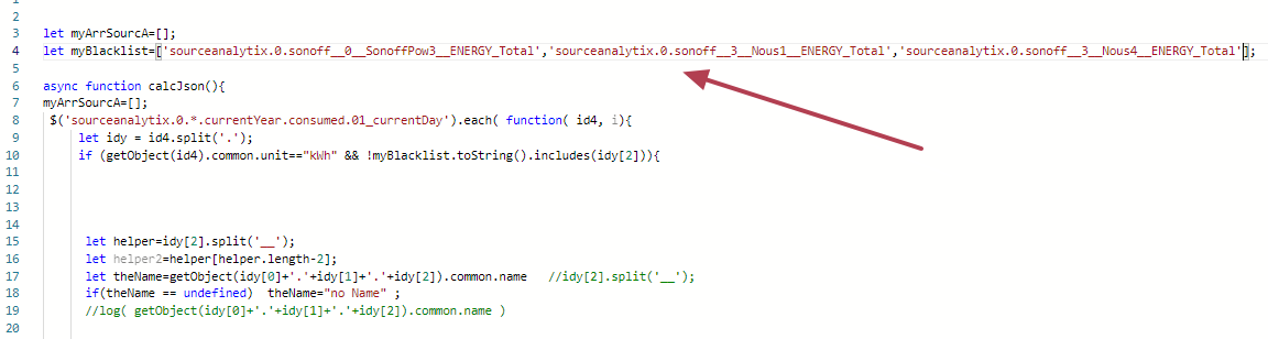

      let myArrSourcA=[];
      let myBlacklist=[];
      // Beispiel Blacklist: ['sourceanalytix.0.sonoff__0__SonoffPow3__ENERGY_Total','sourceanalytix.0.sonoff__3__Nous1__ENERGY_Total']

      hier das widget: inventwo widgets müssen installiert sein
      [{"tpl":"i-vis-jsontable","data":{"g_fixed":false,"g_visibility":false,"g_css_font_text":true,"g_css_background":false,"g_css_shadow_padding":false,"g_css_border":false,"g_gestures":false,"g_signals":false,"g_last_change":false,"visibility-cond":"==","visibility-val":1,"visibility-groups-action":"hide","iTblRowLimit":"20","iTableRefreshRate":"0","iTblSortOrder":"asc","iColCount":"9","iColShow1":"true","iTblHeadTextAlign1":"left","iTblTextAlign1":"left","iTblCellFormat1":"normal","iTblCellImageSize1":"200","iTblCellBooleanCheckbox1":"false","iTblCellBooleanColorFalse1":"#ff0000","iTblCellBooleanColorTrue1":"#00ff00","iTblCellNumberDecimals1":"2","iTblCellNumberDecimalSeperator1":".","iTblCellNumberThousandSeperator1":",","iTblCellThresholdsDp1":"","iTblCellThresholdsText1":"","iOpacityAll":"1","iTblRowEvenColor":"#479de6","iTblRowUnevenColor":"#8dadb9","iTblHeaderColor":"#204565","iRowSpacing":"2.8","iTblRowEvenTextColor":"#ffffff","iTblRowUnevenTextColor":"#ffffff","iTblHeaderTextColor":"#ffffff","iBorderSize":"0","iBorderStyleLeft":"none","iBorderStyleRight":"none","iBorderStyleUp":"none","iBorderStyleDown":"none","iBorderColor":"#ffffff","signals-cond-0":"==","signals-val-0":true,"signals-icon-0":"/vis/signals/lowbattery.png","signals-icon-size-0":0,"signals-blink-0":false,"signals-horz-0":0,"signals-vert-0":0,"signals-hide-edit-0":false,"signals-cond-1":"==","signals-val-1":true,"signals-icon-1":"/vis/signals/lowbattery.png","signals-icon-size-1":0,"signals-blink-1":false,"signals-horz-1":0,"signals-vert-1":0,"signals-hide-edit-1":false,"signals-cond-2":"==","signals-val-2":true,"signals-icon-2":"/vis/signals/lowbattery.png","signals-icon-size-2":0,"signals-blink-2":false,"signals-horz-2":0,"signals-vert-2":0,"signals-hide-edit-2":false,"lc-type":"last-change","lc-is-interval":true,"lc-is-moment":false,"lc-format":"","lc-position-vert":"top","lc-position-horz":"right","lc-offset-vert":0,"lc-offset-horz":0,"lc-font-size":"12px","lc-font-family":"","lc-font-style":"","lc-bkg-color":"","lc-color":"","lc-border-width":"0","lc-border-style":"","lc-border-color":"","lc-border-radius":10,"lc-zindex":0,"oid":"0_userdata.0.StromJson.StromJson","iTblShowHead":true,"iColShow2":"true","iTblHeadTextAlign2":"center","iTblTextAlign2":"center","iTblCellFormat2":"normal","iTblCellImageSize2":"200","iTblCellBooleanCheckbox2":"false","iTblCellBooleanColorFalse2":"#ff0000","iTblCellBooleanColorTrue2":"#00ff00","iTblCellNumberDecimals2":"2","iTblCellNumberDecimalSeperator2":".","iTblCellNumberThousandSeperator2":",","iTblCellThresholdsDp2":"","iTblCellThresholdsText2":"","iColShow3":"true","iTblHeadTextAlign3":"center","iTblTextAlign3":"center","iTblCellFormat3":"normal","iTblCellImageSize3":"200","iTblCellBooleanCheckbox3":"false","iTblCellBooleanColorFalse3":"#ff0000","iTblCellBooleanColorTrue3":"#00ff00","iTblCellNumberDecimals3":"2","iTblCellNumberDecimalSeperator3":".","iTblCellNumberThousandSeperator3":",","iTblCellThresholdsDp3":"","iTblCellThresholdsText3":"","iColShow4":"true","iTblHeadTextAlign4":"center","iTblTextAlign4":"center","iTblCellFormat4":"normal","iTblCellImageSize4":"200","iTblCellBooleanCheckbox4":"false","iTblCellBooleanColorFalse4":"#ff0000","iTblCellBooleanColorTrue4":"#00ff00","iTblCellNumberDecimals4":"2","iTblCellNumberDecimalSeperator4":".","iTblCellNumberThousandSeperator4":",","iTblCellThresholdsDp4":"","iTblCellThresholdsText4":"","iColShow5":"true","iTblHeadTextAlign5":"center","iTblTextAlign5":"center","iTblCellFormat5":"normal","iTblCellImageSize5":"200","iTblCellBooleanCheckbox5":"false","iTblCellBooleanColorFalse5":"#ff0000","iTblCellBooleanColorTrue5":"#00ff00","iTblCellNumberDecimals5":"2","iTblCellNumberDecimalSeperator5":".","iTblCellNumberThousandSeperator5":",","iTblCellThresholdsDp5":"","iTblCellThresholdsText5":"","iColShow6":"true","iTblHeadTextAlign6":"center","iTblTextAlign6":"center","iTblCellFormat6":"normal","iTblCellImageSize6":"200","iTblCellBooleanCheckbox6":"false","iTblCellBooleanColorFalse6":"#ff0000","iTblCellBooleanColorTrue6":"#00ff00","iTblCellNumberDecimals6":"2","iTblCellNumberDecimalSeperator6":".","iTblCellNumberThousandSeperator6":",","iTblCellThresholdsDp6":"","iTblCellThresholdsText6":"","iColShow7":"true","iTblHeadTextAlign7":"center","iTblTextAlign7":"center","iTblCellFormat7":"normal","iTblCellImageSize7":"200","iTblCellBooleanCheckbox7":"false","iTblCellBooleanColorFalse7":"#ff0000","iTblCellBooleanColorTrue7":"#00ff00","iTblCellNumberDecimals7":"2","iTblCellNumberDecimalSeperator7":".","iTblCellNumberThousandSeperator7":",","iTblCellThresholdsDp7":"","iTblCellThresholdsText7":"","iColShow8":"true","iTblHeadTextAlign8":"center","iTblTextAlign8":"center","iTblCellFormat8":"normal","iTblCellImageSize8":"200","iTblCellBooleanCheckbox8":"false","iTblCellBooleanColorFalse8":"#ff0000","iTblCellBooleanColorTrue8":"#00ff00","iTblCellNumberDecimals8":"2","iTblCellNumberDecimalSeperator8":".","iTblCellNumberThousandSeperator8":",","iTblCellThresholdsDp8":"","iTblCellThresholdsText8":"","iColShow9":"true","iTblHeadTextAlign9":"center","iTblTextAlign9":"center","iTblCellFormat9":"normal","iTblCellImageSize9":"200","iTblCellBooleanCheckbox9":"false","iTblCellBooleanColorFalse9":"#ff0000","iTblCellBooleanColorTrue9":"#00ff00","iTblCellNumberDecimals9":"2","iTblCellNumberDecimalSeperator9":".","iTblCellNumberThousandSeperator9":",","iTblCellThresholdsDp9":"","iTblCellThresholdsText9":"","iTblFixedHead":true,"iTblSortAttr":"","iColAfterText1":"","iColName2":"","iColAfterText2":" kWh","iColAfterText3":" kWh","iColAfterText4":" kWh","iColAfterText5":" kWh","iColAfterText6":" €","iColAfterText7":" €","iColAfterText8":" €","iColAfterText9":" €"},"style":{"left":"46px","top":"539px","width":"1069px","height":"259px","font-size":"small","overflow-y":"scroll"},"widgetSet":"vis-inventwo"}]
      crunchip N 3 Replies Last reply Reply Quote 4

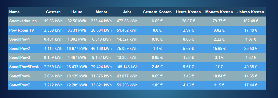

        crunchip Forum Testing Most Active @liv-in-sky last edited by
        @liv-in-sky sieht ja sehr schön aus, mal sehen ob ich das bei mir auch mit rein pack, hab das ja bisher alles über Grafana laufen.
        (allerdings würde ich bei dem Stromverbrauch ein paar Echo`s abschalten😂 )

          @crunchip sourcanalytics läuft garnicht - das sind alte daten, da ich den adapter nur stillgelegt habe
          die erste zeile war irgendein versuch daten zusammenzufassen - hat zum glück keine richtigen werte 🙂

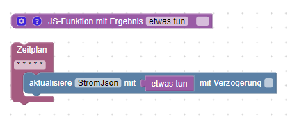

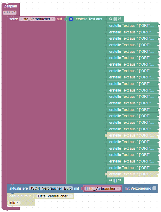

              nur zur info - das script liest nur einmal beim start die dp - es gibt noch keinen zeit-trigger oder einen trigger bei änderung der dp !!
              wer eher blockly mag, könnte das script als function block in ein blockly einbinden und dort einen z.b. cron trigger nehmen

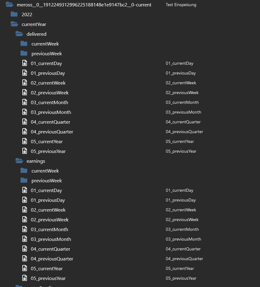

                  @liv-in-sky sagte in Json für SourceAnalytics:
                  möglich wäre noch
                  nicht nur Ausgaben und Verbrauch, sondern auch Einnahmen😜

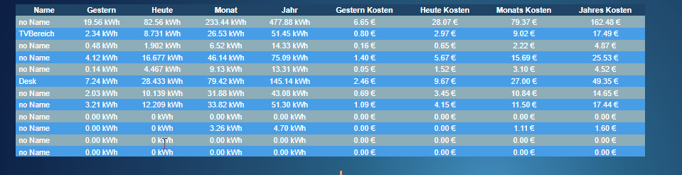

                  evtl problem:
                  ja mit dem Namen

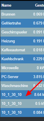

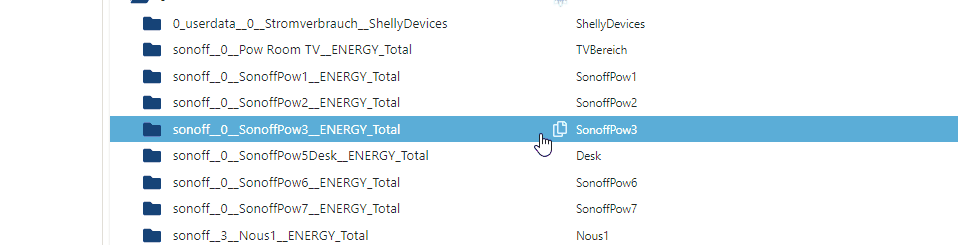

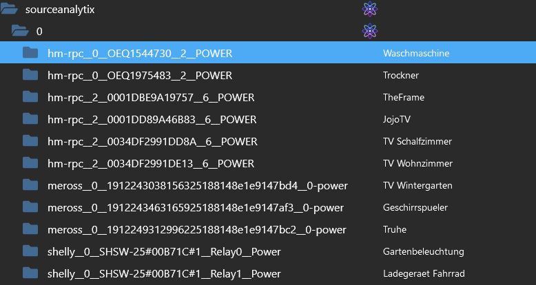

                  6a522c91-dad0-45eb-9e2c-46b8dbe89b64-image.png 17545e31-2f69-4bc5-b606-97c058869ef8-image.png
                  • N
                    Nordischerjung @liv-in-sky last edited by
                    evtl problem:
                    • die namen der devices funtionieren hier bei meinen sonoff geräten - mit zb. hm-rpc müßte die namensgebung wahrscheinlich nochmal gecheckt werden

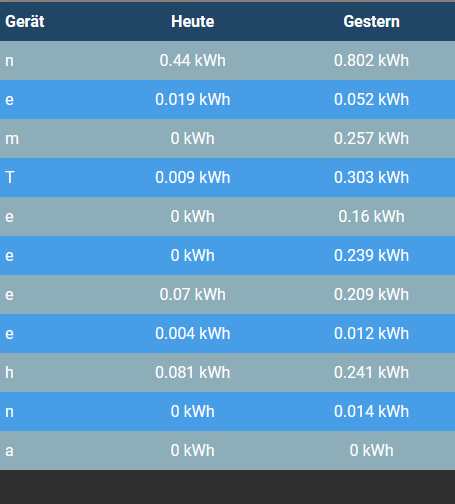

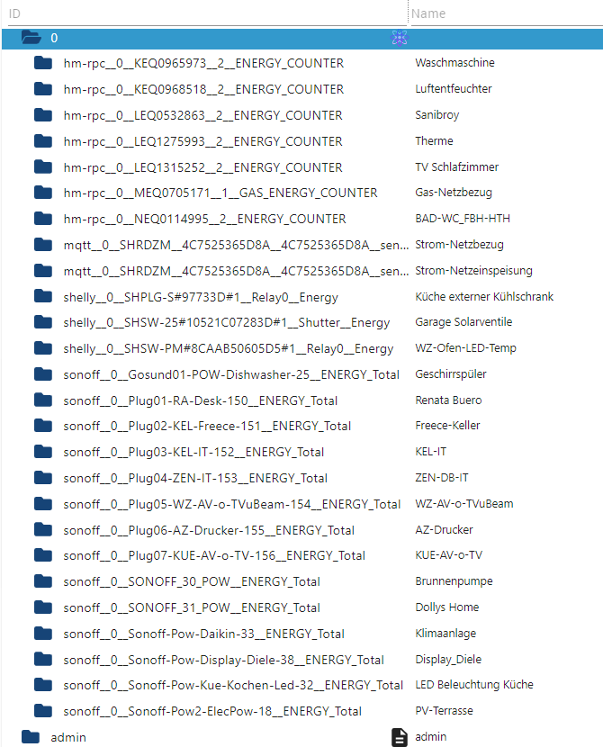

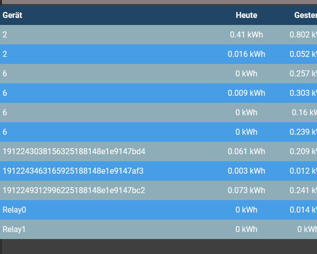

                    Moin, mit den Namen habe ich auch Probleme.
                    das ist im Adapter
                    liv-in-sky 3 Replies Last reply Reply Quote 0

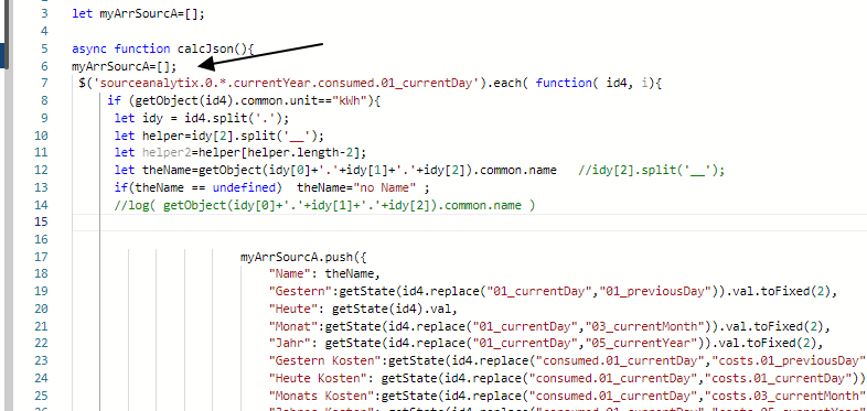

                        @nordischerjung
                        bitte mal das hier testen
                        let myArrSourcA=[];
                        async function calcJson(){
                        $('sourceanalytix.0.*.currentYear.consumed.01_currentDay').each( function( id4, i){
                             let idy = id4.split('.');
                             let theName=getObject(idy[0]+'.'+idy[1]+'.'+idy[2]).common.name//idy[2].split('__');
                             if(theName == undefined)  theName="no Name" ;
                             //log( getObject(idy[0]+'.'+idy[1]+'.'+idy[2]).common.name )
                                               myArrSourcA.push({
                                                   "Name": theName,
                                                   "Gestern":getState(id4.replace("01_currentDay","01_previousDay")).val+" kWh",
                                                   "Heute": getState(id4).val+" kWh",
                                                   "Monat":getState(id4.replace("01_currentDay","03_currentMonth")).val+" kWh",
                                                   "Jahr": getState(id4.replace("01_currentDay","05_currentYear")).val+" kWh",
                                                   "Gestern Kosten":getState(id4.replace("consumed.01_currentDay","costs.01_previousDay")).val+" €",
                                                   "Heute Kosten": getState(id4.replace("consumed.01_currentDay","costs.01_currentDay")).val+" €",
                                                   "Monats Kosten":getState(id4.replace("consumed.01_currentDay","costs.03_currentMonth")).val+" €",
                                                   "Jahres Kosten": getState(id4.replace("consumed.01_currentDay","costs.05_currentYear")).val+" €"
                        //log(JSON.stringify(myArrSourcA))
                        return myArrSourcA;
                        async function writeDatapoint(){
                        if (!(await existsStateAsync('0_userdata.0.StromJson.StromJson'))) {
                               await createStateAsync('0_userdata.0.StromJson.StromJson', "",{type: "string", name: "JSON SourcAnalytics", role: "value", read: true, write: true, } ); }
                        // log(JSON.stringify(await calcJson()))
                        setState('0_userdata.0.StromJson.StromJson',JSON.stringify(await calcJson()));
                        writeDatapoint();
                        • N
                          @liv-in-sky Jetzt so

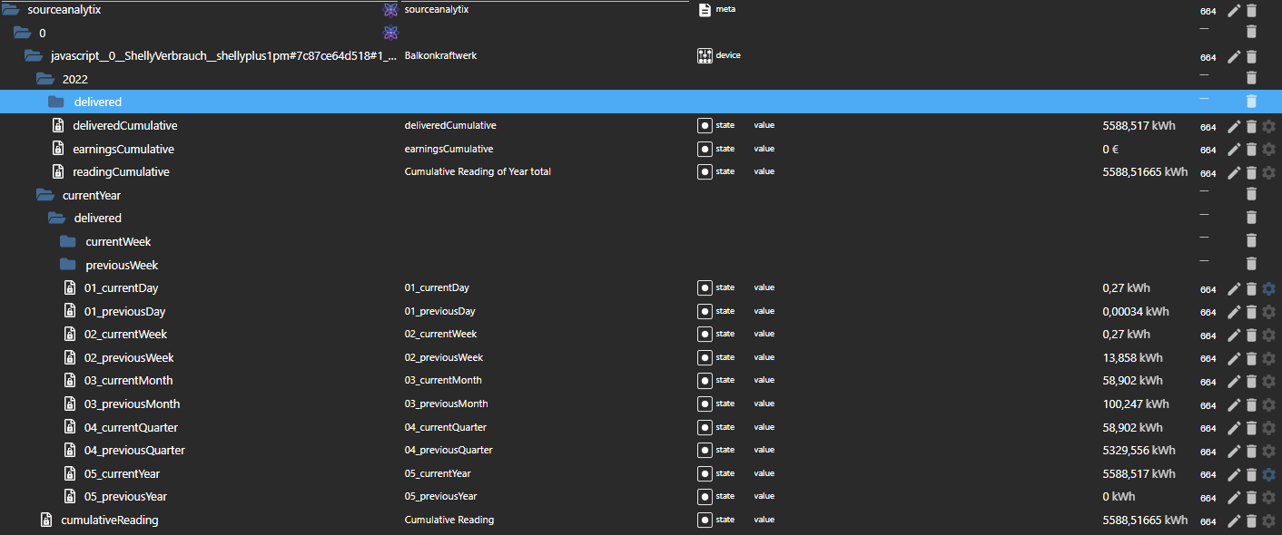

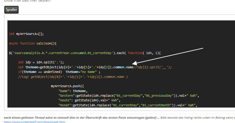

                            @liv-in-sky kann man nicht "common name" abrufen anstatt der ID?
                            • liv-in-sky
                              liv-in-sky @crunchip last edited by
                              @crunchip
                              • liv-in-sky
                                liv-in-sky @Nordischerjung last edited by
                                @nordischerjung ich glaube, ich habe was gesehen - ich mach nochmal
                                • crunchip
                                  @liv-in-sky ah ok, hatte ich nicht weiter geguckt, bin grad aufn Sprung
                                  • liv-in-sky
                                    @crunchip kein problem - die zusammenstellung der id ist wohl falsch um den common.name zu bekommen

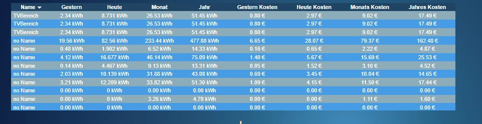

                                      @nordischerjung

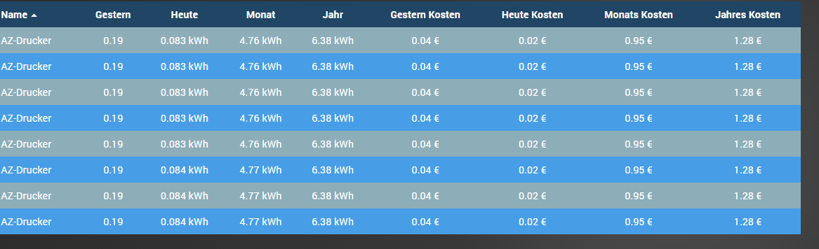

                                      bin verwirrt - sollte eigentlich so funktionieren - bei mir tut es das
                                      kannst du mal bitte den inhalt des datenpunktes posten 0_userdata.0.StromJson.StromJson
                                      siehe chat !
                                      N metaxa 2 Replies Last reply Reply Quote 0
                                      • N

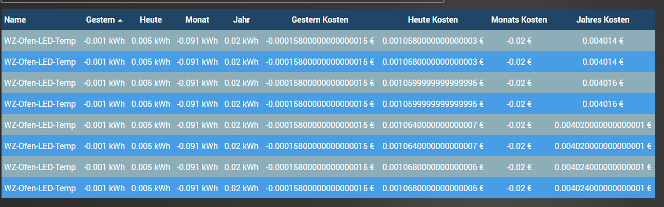

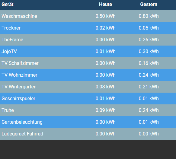

                                        @liv-in-sky So schnell nochmal Probiert, Sorry war mein Fehler. Funktioniert doch. Und dabei sehe ich, das Schlafzimmer wohl bei mir falsch geschrieben ist 😀
                                        Ich habe das schon geändert, habe 2 getrennte Widges einmal für Verbrauch und einmal Kosten. Das Ganze auch noch gleich gerundet, da der Adapter zB 0,002343524515 € ausspuckt
                                        • liv-in-sky
                                          @nordischerjung
                                          dann paßt ja alles (hab schon an meinen coderfähigkeiten gezweifelt 🙂 )- brauchst du noch einen trigger - wir könnten einen schedule alle 10 min einfügen ?
