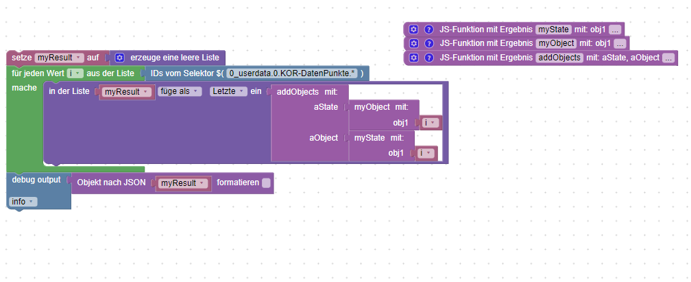

        @warhammer73 bin mir nicht sicher, ob ich dich richtig verstanden habe
        aber als beispiel mal, wie du ein json (object) bekommst von einer datenstruktur:
         <variables>
           <variable id="(mbM.}pb*o)hnP%n?KpO">myResult</variable>
           <variable id="uNrmRi0)?Yzo7?:aoRR{">obj1</variable>
           <variable id="8LreGt2Rb,6#/T{HBSDH">aState</variable>
           <variable id="O2gOJpw3.*t]LA@xz|75">aObject</variable>
           <variable id="-H5Gkjb11!0lD-#vTf`y">i</variable>
         </variables>
         <block type="procedures_defcustomreturn" id="_7aF-!Dbk9i)y^3/_G?t" x="737" y="162">
           <mutation statements="false">
             <arg name="obj1" varid="uNrmRi0)?Yzo7?:aoRR{"></arg>
           </mutation>
           <field name="NAME">myState</field>
           <field name="SCRIPT">cmV0dXJuIGdldFN0YXRlQXN5bmMob2JqMSk7</field>
         <block type="variables_set" id="QX#+$||Ay4kFW=08]+z$" x="38" y="212">
           <field name="VAR" id="(mbM.}pb*o)hnP%n?KpO">myResult</field>
             <block type="lists_create_with" id="j:gf00*=ep#g%Y-DcMi~">
             <block type="controls_forEach" id="ASvuYrF.8zuD8i4Qd9;K">
               <field name="VAR" id="-H5Gkjb11!0lD-#vTf`y">i</field>
               <value name="LIST">
                 <block type="selector" id="U}5VE0mWT-ryXhIV%1tO">
                   <field name="TEXT">0_userdata.0.KOR-DatenPunkte.*</field>
               <statement name="DO">
                 <block type="lists_setIndex" id="q7!2_^C|iLQTmI2cU|Bh">
                   <mutation at="false"></mutation>
                   <field name="WHERE">LAST</field>
                   <value name="LIST">
                     <block type="variables_get" id="j5c(W`Nz0oT7dCCM}=f]">
                   <value name="TO">
                     <block type="procedures_callcustomreturn" id="1u)ZIj%,i]@RXGC@kL2s">
                       <mutation name="addObjects">
                         <arg name="aState"></arg>
                         <arg name="aObject"></arg>
                       </mutation>
                       <value name="ARG0">
                         <block type="procedures_callcustomreturn" id="+|xg23d8Br6-|d#=MM,)">
                           <mutation name="myObject">
                             <arg name="obj1"></arg>
                           </mutation>
                           <value name="ARG0">
                             <block type="variables_get" id="1O,$Ab7koM{BEei-}aW0">
                       <value name="ARG1">
                         <block type="procedures_callcustomreturn" id="}8V7,O6+NvdS)JRdy]fK">
                           <mutation name="myState">
                           </mutation>
                           <value name="ARG0">
                             <block type="variables_get" id="bu~G%c7XH;xri~N?bP}g">
                     <block type="debug" id="[-Wn/wQ*OSwn)/f95PKX" disabled="true">
                       <value name="TEXT">
                         <shadow type="text" id="a:[0d^^i2P$uWD$iBQ/P">
                         <block type="procedures_callcustomreturn" id="W*oh?GN3h^Jpk]qra5M-">
                           </mutation>
                           <value name="ARG0">
                             <block type="procedures_callcustomreturn" id="bAYAWohIa=N-f:dBg`/E">
                               </mutation>
                               <value name="ARG0">
                                 <block type="variables_get" id="%MIMVZ8Qp^MQd-Y?,UUm">
                           <value name="ARG1">
                             <block type="procedures_callcustomreturn" id="8p6L(:lCw9bz[@~BE:4#">
                               </mutation>
                               <value name="ARG0">
                                 <block type="variables_get" id="mfyPY@hjr2s])qSC1xh1">
                 <block type="debug" id="MpTC=A6b7}SG3;{Q6S/y">
                   <value name="TEXT">
                     <shadow type="text" id="+j%zw#BF(h51`p{Mk=)X">
                     <block type="convert_object2json" id="W|a!-w]2n|^z@f7aXION">
                       <field name="PRETTIFY">FALSE</field>
                         <block type="variables_get" id="*,t//]c1(sO+1b@3m5FP">
         <block type="procedures_defcustomreturn" id="-j04hnD:N:~/4[Jt1Yo," x="738" y="187">
           </mutation>
           <field name="NAME">myObject</field>
           <field name="SCRIPT">cmV0dXJuIGdldE9iamVjdEFzeW5jKG9iajEpOw==</field>
         <block type="procedures_defcustomreturn" id="ub+Rlu_Vho9F],gt!Uxp" x="738" y="212">
             <arg name="aState" varid="8LreGt2Rb,6#/T{HBSDH"></arg>
             <arg name="aObject" varid="O2gOJpw3.*t]LA@xz|75"></arg>
           </mutation>
           <field name="NAME">addObjects</field>
           <field name="SCRIPT">DQoNCmxldCB0b2dldGhlck9iaj0oew0KICAgICJPYmplY3QiOmFPYmplY3QsDQogICAgICJTdGF0ZSI6YVN0YXRlDQogICAgIA0KDQp9KQ0KDQpyZXR1cm4gdG9nZXRoZXJPYmo7</field>

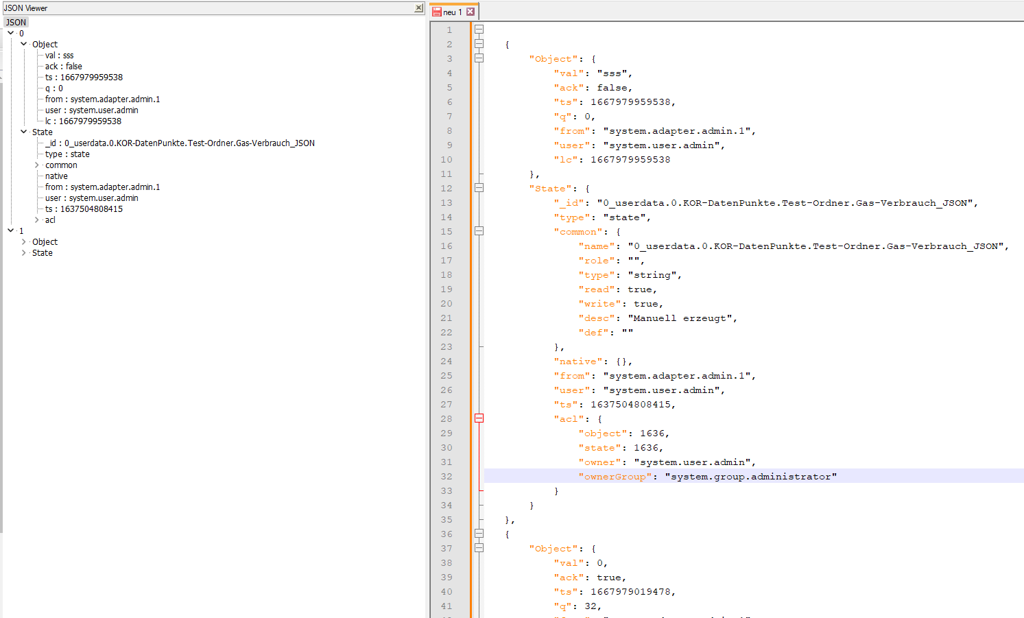

        schaut dann so aus und kann wiederum in einen dp gespeichert werden:
           	"Object": {
           		"val": "sss",
           		"ack": false,
           		"ts": 1667979959538,
           		"q": 0,
           		"from": "system.adapter.admin.1",
           		"user": "system.user.admin",
           		"lc": 1667979959538
           	"State": {
           		"_id": "0_userdata.0.KOR-DatenPunkte.Test-Ordner.Gas-Verbrauch_JSON",
           		"type": "state",
           		"common": {
           			"name": "0_userdata.0.KOR-DatenPunkte.Test-Ordner.Gas-Verbrauch_JSON",
           			"role": "",
           			"type": "string",
           			"read": true,
           			"write": true,
           			"desc": "Manuell erzeugt",
           			"def": ""
           		"native": {},
           		"ts": 1637504808415,
           		"acl": {
           			"object": 1636,
           			"state": 1636,
           			"owner": "system.user.admin",
           	"Object": {
           		"val": 0,
           		"ack": true,
           		"ts": 1667979019478,
           		"q": 32,
           		"lc": 1667979019478
           	"State": {
           		"common": {
           			"name": "number",
           			"role": "state",
           			"type": "number",
           			"read": true,
           			"write": true,
           			"def": 0
           		"type": "state",
           		"native": {},
           		"ts": 1667979019468,
           		"_id": "0_userdata.0.KOR-DatenPunkte.Test-Ordner2.number",
           		"acl": {
           			"object": 1636,
           			"state": 1636,
