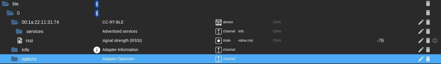

                Chris 1 @Rushmed last edited by
