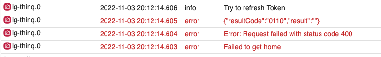

      Since a couple of weeks this io-broker adapter doesn't work any more.
      The running instance is throwing hundreds of errors that there is something wrong either with the login or an token.
      Based on the fact, that this adapter doesn't have anything to refresh a token, I guess that there is now something wrong with the login process coded. (most probably LG changed something at the login)
      My credentials are definitely right, because the LG App as well as the LG web-platform works fine and the login in both cases are working as well.

          Lucky_ESA Developer Most Active last edited by
          ResultCode 0110 bedeutet, dass die AGB`s in der APP akzeptiert werden müssen.
          Gruß//Lucky
