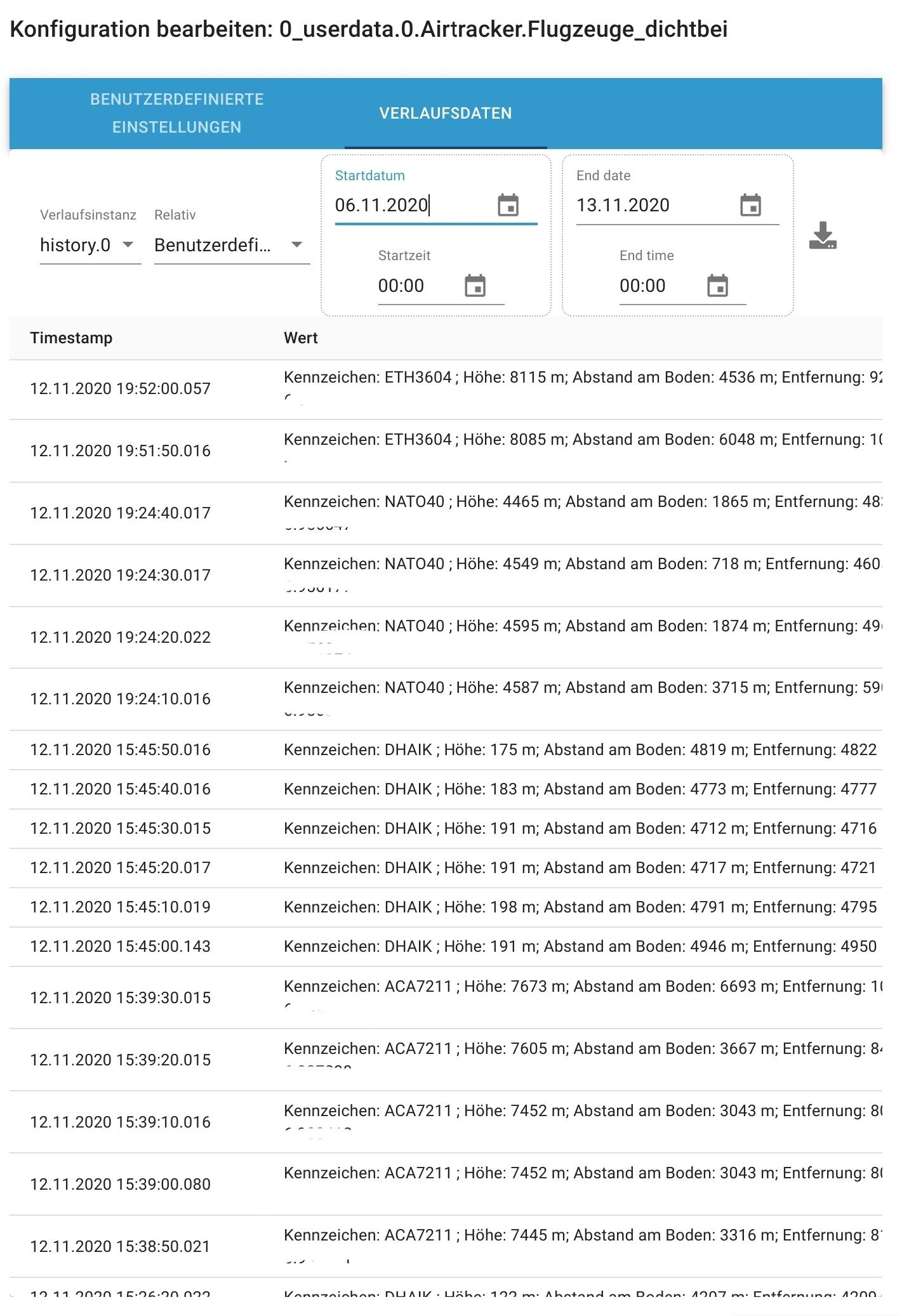

        der Variablenname soll dynamisch sein, also statt Flugnummer1 -> varRYR123
        und der sollen dann die Liste mit den JSON (timestamp, flugnummer, lat, long, height) zu dem Flug zugeordnet werden.
        die Variable wird eine Lebensdauer von wenigen Minuten (Überflugzeit) haben.

                  { "now" : 1668369287.4, "messages" : 4842861, "aircraft" : [ {"hex":"406b0a","mlat":[],"tisb":[],"messages":9,"seen":13.0,"rssi":-26.7}, {"hex":"3c49ee","flight":"CFG069 ","alt_baro":9075,"alt_geom":9375,"gs":307.0,"ias":250,"tas":286,"mach":0.444,"track":259.7,"track_rate":0.00,"roll":0.7,"mag_heading":257.2,"baro_rate":-1568,"geom_rate":-1600,"squawk":"1000","nav_qnh":1013.3,"nav_altitude_mcp":7008,"lat":51.176225,"lon":7.089844,"nic":6,"rc":926,"seen_pos":2.2,"version":0,"nac_p":6,"nac_v":0,"sil":2,"sil_type":"unknown","mlat":[],"tisb":[],"messages":155,"seen":0.1,"rssi":-24.7}, {"hex":"44006c","flight":"AUA3SV ","alt_baro":31575,"alt_geom":32575,"gs":433.0,"ias":291,"tas":466,"mach":0.792,"track":124.9,"track_rate":0.00,"roll":0.0,"mag_heading":122.5,"baro_rate":1216,"geom_rate":1184,"squawk":"1000","category":"A3","nav_qnh":1012.8,"nav_altitude_mcp":35008,"lat":51.361771,"lon":7.286979,"nic":8,"rc":186,"seen_pos":16.6,"version":2,"nic_baro":1,"nac_p":9,"nac_v":1,"sil":3,"sil_type":"perhour","gva":2,"sda":2,"mlat":[],"tisb":[],"messages":1705,"seen":12.9,"rssi":-26.0}, {"hex":"3c4d68","flight":"DLH2MT ","alt_baro":34200,"alt_geom":35250,"gs":425.0,"ias":275,"tas":462,"mach":0.792,"track":135.7,"track_rate":0.00,"roll":0.2,"mag_heading":132.9,"baro_rate":736,"geom_rate":832,"squawk":"1000","category":"A3","nav_qnh":1012.8,"nav_altitude_mcp":36992,"nav_heading":132.2,"lat":51.045319,"lon":7.311773,"nic":8,"rc":186,"seen_pos":0.4,"version":2,"nic_baro":1,"nac_p":9,"nac_v":1,"sil":3,"sil_type":"perhour","gva":2,"sda":2,"mlat":[],"tisb":[],"messages":1170,"seen":0.0,"rssi":-21.1}, {"hex":"4ca27f","version":0,"sil_type":"unknown","mlat":[],"tisb":[],"messages":48,"seen":129.3,"rssi":-26.8}, {"hex":"4aca69","flight":"SAS51B ","alt_baro":35000,"alt_geom":36025,"gs":438.2,"ias":265,"tas":452,"mach":0.780,"track":40.7,"track_rate":0.03,"roll":-0.2,"mag_heading":46.1,"baro_rate":-64,"geom_rate":-64,"squawk":"5515","emergency":"none","category":"A3","nav_qnh":1013.6,"nav_altitude_mcp":35008,"nav_altitude_fms":35008,"nav_modes":["autopilot","vnav","tcas"],"lat":51.066036,"lon":6.481018,"nic":8,"rc":186,"seen_pos":2.2,"version":2,"nic_baro":1,"nac_p":10,"nac_v":2,"sil":3,"sil_type":"perhour","gva":2,"sda":2,"mlat":[],"tisb":[],"messages":3819,"seen":0.5,"rssi":-24.9}, {"hex":"89610a","category":"A5","version":2,"sil_type":"perhour","mlat":[],"tisb":[],"messages":382,"seen":49.8,"rssi":-26.6}, {"hex":"4cad39","category":"A3","version":2,"sil_type":"perhour","mlat":[],"tisb":[],"messages":705,"seen":111.8,"rssi":-27.0}, {"hex":"4d22e7","mlat":[],"tisb":[],"messages":28,"seen":212.1,"rssi":-28.3}, {"hex":"44034b","alt_baro":38025,"ias":247,"mach":0.780,"mag_heading":333.8,"baro_rate":128,"geom_rate":160,"version":0,"nac_p":8,"sil":2,"sil_type":"unknown","mlat":[],"tisb":[],"messages":82,"seen":0.1,"rssi":-26.8}, {"hex":"407cd4","version":2,"sil_type":"perhour","mlat":[],"tisb":[],"messages":631,"seen":193.6,"rssi":-26.6}, {"hex":"3c65d9","category":"A3","version":2,"sil_type":"perhour","mlat":[],"tisb":[],"messages":826,"seen":106.4,"rssi":-26.7}, {"hex":"4a0661","version":0,"sil_type":"unknown","mlat":[],"tisb":[],"messages":220,"seen":263.1,"rssi":-27.5}, {"hex":"4072ea","version":0,"sil_type":"unknown","mlat":[],"tisb":[],"messages":74,"seen":107.2,"rssi":-26.4}, {"hex":"4b1807","flight":"SWR70T ","alt_baro":35000,"alt_geom":36000,"gs":423.3,"ias":268,"tas":456,"mach":0.788,"track":149.3,"track_rate":0.00,"roll":-0.7,"mag_heading":143.1,"baro_rate":32,"geom_rate":-64,"squawk":"1000","category":"A3","nav_qnh":1012.8,"nav_altitude_mcp":35008,"nav_heading":143.4,"lat":50.553030,"lon":7.289800,"nic":8,"rc":186,"seen_pos":0.3,"version":2,"nic_baro":1,"nac_p":11,"nac_v":1,"sil":3,"sil_type":"perhour","gva":2,"sda":2,"mlat":[],"tisb":[],"messages":4456,"seen":0.0,"rssi":-23.0}, {"hex":"3964ec","flight":"TVF7449 ","alt_baro":38000,"alt_geom":38950,"gs":459.3,"ias":247,"tas":444,"mach":0.780,"track":218.2,"track_rate":0.00,"roll":-0.4,"mag_heading":211.3,"baro_rate":0,"geom_rate":0,"squawk":"3527","category":"A3","nav_qnh":1013.6,"nav_altitude_mcp":36992,"nav_altitude_fms":38000,"nav_heading":210.9,"lat":50.559586,"lon":6.376696,"nic":8,"rc":186,"seen_pos":12.8,"version":2,"nic_baro":1,"nac_p":9,"nac_v":1,"sil":3,"sil_type":"perhour","gva":2,"sda":2,"mlat":[],"tisb":[],"messages":6761,"seen":10.5,"rssi":-26.2}, {"hex":"471fa2","category":"A3","version":2,"sil_type":"perhour","mlat":[],"tisb":[],"messages":279,"seen":51.8,"rssi":-27.2}, {"hex":"471f6c","category":"A3","version":2,"sil_type":"perhour","mlat":[],"tisb":[],"messages":1540,"seen":201.5,"rssi":-26.6}, {"hex":"47c1f7","category":"A3","version":2,"sil_type":"perhour","mlat":[],"tisb":[],"messages":5932,"seen":83.6,"rssi":-25.8}, {"hex":"3c5ee1","alt_baro":14525,"alt_geom":15575,"gs":339.1,"track":150.1,"baro_rate":-960,"squawk":"3417","category":"A3","nav_qnh":1012.8,"nav_altitude_mcp":10016,"lat":50.638081,"lon":7.644332,"nic":8,"rc":186,"seen_pos":43.4,"version":2,"nic_baro":1,"nac_p":9,"nac_v":1,"sil":3,"sil_type":"perhour","mlat":[],"tisb":[],"messages":4361,"seen":10.3,"rssi":-26.9}, {"hex":"c027d1","flight":"ACA7211 ","alt_baro":30000,"alt_geom":30850,"gs":502.5,"ias":296,"tas":462,"mach":0.780,"track":292.0,"track_rate":0.00,"roll":-0.2,"mag_heading":290.7,"baro_rate":0,"geom_rate":0,"squawk":"2501","emergency":"none","category":"A5","nav_qnh":1013.6,"nav_altitude_mcp":30016,"nav_altitude_fms":30000,"nav_heading":291.1,"lat":51.033263,"lon":6.121445,"nic":8,"rc":186,"seen_pos":33.7,"version":2,"nic_baro":1,"nac_p":11,"nac_v":2,"sil":3,"sil_type":"perhour","gva":2,"sda":2,"mlat":[],"tisb":[],"messages":8930,"seen":0.9,"rssi":-26.5}, {"hex":"06a2e2","category":"A5","version":2,"sil_type":"perhour","mlat":[],"tisb":[],"messages":1410,"seen":237.1,"rssi":-25.1}, {"hex":"471f51","category":"A3","version":2,"sil_type":"perhour","mlat":[],"tisb":[],"messages":1032,"seen":287.4,"rssi":-22.6}, {"hex":"3c55c3","category":"A3","version":2,"sil_type":"perhour","mlat":[],"tisb":[],"messages":1134,"seen":276.4,"rssi":-26.6}, {"hex":"471f96","category":"A3","version":2,"sil_type":"perhour","mlat":[],"tisb":[],"messages":3065,"seen":295.1,"rssi":-26.2}, {"hex":"400942","category":"A3","version":2,"sil_type":"perhour","mlat":[],"tisb":[],"messages":1542,"seen":174.5,"rssi":-26.0}, {"hex":"4ca569","category":"A3","version":2,"sil_type":"perhour","mlat":[],"tisb":[],"messages":1605,"seen":126.2,"rssi":-26.5}, {"hex":"a826e9","category":"A5","version":2,"sil_type":"perhour","mlat":[],"tisb":[],"messages":3619,"seen":162.4,"rssi":-24.2} ] }
                  daraus extrahiere und berechne ich
                      "Kennung": "BPO140  ",
                      "Hoehe": 419,
                      "Bodenabstand": 4397,
                      "Entfernung": 4417,
                      "Position": "50.xyz44,7.abc498"

                        @oliverio im Moment bekomme ich alle 10 Sekunden einen Datensatz (ggf. zwei oder drei, wenn sich z.b. noch so ein Polizeihubschrauber im Auswahlbereich befindet).
                        diese logge und konseviere ich. Ist aber zu viel.
                        daher möchte ich nur den Datensatz (je Flug) in den DP schreiben, bei dem sich der Flieger am dichtesten bei mir befindet. um Flugnumner, Höhe und Timestamp zu dokumentieren.
                        dafür schreibe ich (wollte ich schreiben) diese Datensätze in ein Array je Flug.
                        Das kann dann nach der Auswertung verworfen werden.
                        so mein Plan.
