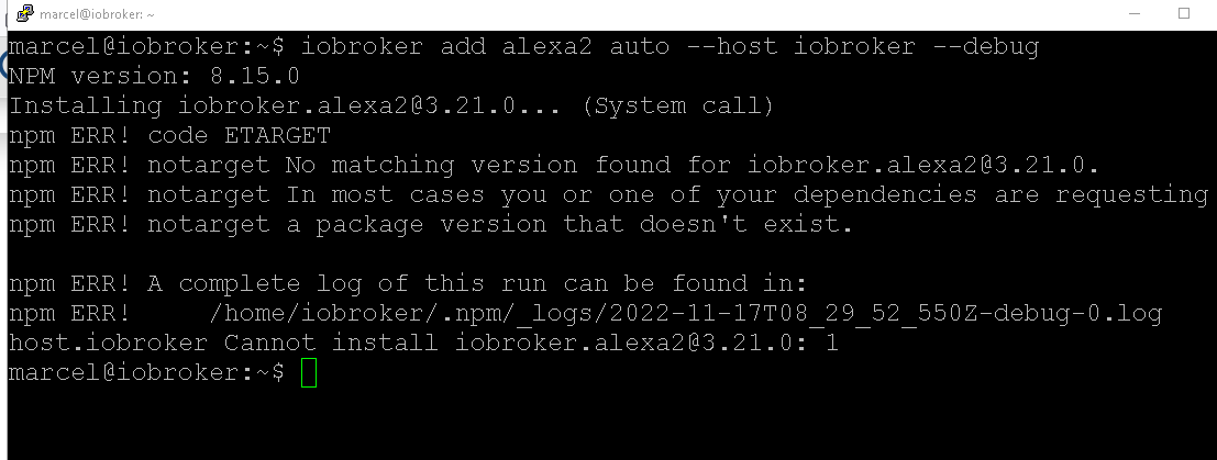

      folgedne Fehlermelung erhalte ich im iOBroker bei der Installation:
      $ iobroker add alexa2 auto --host iobroker --debug
      NPM version: 8.15.0
      Installing iobroker.alexa2@3.21.0... (System call)
      **npm ERR! code ETARGET
      host.iobroker Cannot install iobroker.alexa2@3.21.0: 1
      ERROR: Process exited with code 25**

            Thomas Braun Most Active @Guest last edited by Thomas Braun
            @marcel-drzal
            In einem richtigen Terminal ausführen:
            Und deine nodeJS-Installation prüfen, das ist nicht die aktuelle v.16 da bei dir.

                                        A Former User @Thomas Braun last edited by
                                        @thomas-braun
                                        was kann ich da machen? Habe schon Fix versucht. geht auch nicht
                                        marcel@iobroker:/opt/iobroker$ iob upgrade self
                                        Server Configured backup period 120 is larger than the supported maximum of 35791 minutes. Defaulting to 120 minutes.
                                        Host    "iobroker"       is up to date.
                                        marcel@iobroker:/opt/iobroker$ iob start
                                        marcel@iobroker:/opt/iobroker$ sudo apt update
                                        [sudo] password for marcel:
                                        Err:1 http://security.debian.org/debian-security bullseye-security InRelease
                                          Temporary failure resolving 'security.debian.org'
                                        Err:2 https://repos.influxdata.com/debian buster InRelease
                                          Temporary failure resolving 'repos.influxdata.com'
                                        Err:3 https://deb.nodesource.com/node_16.x bullseye InRelease
                                          Temporary failure resolving 'deb.nodesource.com'
                                        Err:4 https://dl.yarnpkg.com/debian stable InRelease
                                          Temporary failure resolving 'dl.yarnpkg.com'
                                        Err:5 http://deb.debian.org/debian bullseye InRelease
                                          Temporary failure resolving 'deb.debian.org'
                                        Err:6 http://deb.debian.org/debian bullseye-updates InRelease
                                        Reading package lists... Done
                                        Building dependency tree... Done
                                        Reading state information... Done
                                        All packages are up to date.
                                        W: Failed to fetch http://deb.debian.org/debian/dists/bullseye/InRelease  Temporary failure resolving 'deb.debian.org'
                                        W: Failed to fetch http://deb.debian.org/debian/dists/bullseye-updates/InRelease  Temporary failure resolving 'deb.debian.org'
                                        W: Failed to fetch http://security.debian.org/debian-security/dists/bullseye-security/InRelease  Temporary failure resolving 'security.debian.org'
                                        W: Failed to fetch https://repos.influxdata.com/debian/dists/buster/InRelease  Temporary failure resolving 'repos.influxdata.com'
                                        W: Failed to fetch https://deb.nodesource.com/node_16.x/dists/bullseye/InRelease  Temporary failure resolving 'deb.nodesource.com'
                                        W: Failed to fetch https://dl.yarnpkg.com/debian/dists/stable/InRelease  Temporary failure resolving 'dl.yarnpkg.com'
                                        W: Some index files failed to download. They have been ignored, or old ones used instead.
                                        marcel@iobroker:/opt/iobroker$ uname -m && test -f /opt/scripts/.docker_config/.thisisdocker && echo "Docker-Installation" || echo "Kein Docker" && type -P nodejs node npm && nodejs -v && node -v && npm -v && iob -v && whoami && groups && echo $XDG_SESSION_TYPE && echo $DESKTOP_SESSION && pwd && sudo apt update &> /dev/null && sudo apt update && apt policy nodejs
                                        x86_64
                                        Kein Docker
                                        /usr/bin/nodejs
                                        /usr/bin/node
                                        /usr/bin/npm
                                        v16.17.1
                                        v16.17.1
                                        8.15.0
                                        4.0.23
                                        marcel
                                        marcel sudo iobroker
                                        tty
                                        /opt/iobroker
                                        Err:4 http://deb.debian.org/debian bullseye InRelease
                                        Err:5 https://dl.yarnpkg.com/debian stable InRelease
                                        nodejs:
                                          Installed: 16.17.1-deb-1nodesource1
                                          Candidate: 16.17.1-deb-1nodesource1
                                          Version table:
                                         *** 16.17.1-deb-1nodesource1 500
                                                500 https://deb.nodesource.com/node_16.x bullseye/main amd64 Packages
                                                100 /var/lib/dpkg/status
                                             12.22.12~dfsg-1~deb11u1 500
                                                500 http://security.debian.org/debian-security bullseye-security/main amd64 Packages
                                             12.22.5~dfsg-2~11u1 500
                                                500 http://deb.debian.org/debian bullseye/main amd64 Packages
