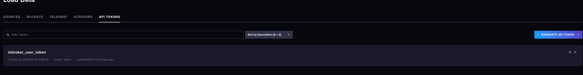

                • keksn
                  keksn @simatec last edited by
