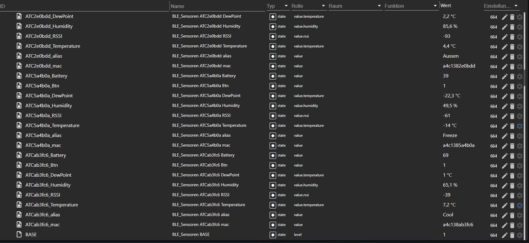

      • Chaot
        Chaot @Jörg_ last edited by Chaot
        @jörg-w Ich verwende den Sonoff Adapter. Da ist das alles schon zerlegt.sensor.jpg

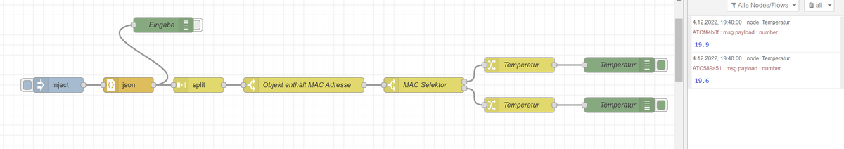

          @jörg-w Ist zwar ein komischer EingabeString. Aber Du musst den String in einzelne Objekte zerlegen:
                 "id": "13e50b962ea4b4ec",
                 "type": "debug",
                 "z": "180b7e98628a2a9b",
                 "name": "Temperatur",
                 "active": true,
                 "tosidebar": true,
                 "console": false,
                 "tostatus": false,
                 "complete": "payload",
                 "targetType": "msg",
                 "statusVal": "",
                 "statusType": "auto",
                 "x": 1290,
                 "y": 340,
                 "wires": []
                 "id": "47e53c63b917864e",
                 "type": "inject",
                 "name": "",
                 "props": [
                         "p": "payload"
                 "repeat": "",
                 "crontab": "",
                 "once": false,
                 "onceDelay": 0.1,
                 "topic": "",
                 "payload": "{\"Time\":\"2022-12-04T13:44:13\",\"ATCf44b8f\":{\"mac\":\"a4c138f44b8f\",\"Temperature\":19.9,\"Humidity\":51,\"DewPoint\":9.5,\"Btn\":1,\"Battery\":68,\"RSSI\":-42},\"ATC589a51\":{\"mac\":\"a4c138589a51\",\"Temperature\":19.6,\"Humidity\":51.8,\"DewPoint\":9.4,\"Btn\":1,\"Battery\":70,\"RSSI\":-60},\"TempUnit\":\"C\"}",
                 "payloadType": "str",
                 "x": 170,
                 "y": 380,
                 "wires": [
                         "a5a4c266b13a0cca"
                 "id": "a43792495de3a27b",
                 "type": "debug",
                 "name": "Eingabe",
                 "active": false,
                 "tosidebar": true,
                 "console": false,
                 "tostatus": false,
                 "statusVal": "",
                 "x": 380,
                 "y": 260,
                 "wires": []
                 "id": "a5a4c266b13a0cca",
                 "type": "json",
                 "name": "",
                 "property": "payload",
                 "action": "",
                 "pretty": true,
                 "x": 310,
                 "y": 380,
                 "wires": [
                         "a43792495de3a27b",
                         "afd48379794b7589"
                 "id": "afd48379794b7589",
                 "type": "split",
                 "name": "",
                 "splt": "\\n",
                 "spltType": "str",
                 "arraySplt": 1,
                 "arraySpltType": "len",
                 "stream": false,
                 "addname": "topic",
                 "x": 450,
                 "y": 380,
                 "wires": [
                         "e4298053724078c1"
                 "id": "22cdf6ba3b189c5a",
                 "type": "switch",
                 "name": "MAC Selektor",
                 "property": "payload.mac",
                 "propertyType": "msg",
                 "rules": [
                         "t": "eq",
                         "v": "a4c138f44b8f",
                         "vt": "str"
                         "t": "eq",
                         "v": "a4c138589a51",
                         "vt": "str"
                 "checkall": "true",
                 "repair": false,
                 "outputs": 2,
                 "x": 900,
                 "y": 380,
                 "wires": [
                         "d71445fc881d262d"
                         "483b49ba0a0bc7bd"
                 "id": "d71445fc881d262d",
                 "type": "change",
                 "rules": [
                         "t": "set",
                         "p": "payload",
                         "pt": "msg",
                         "to": "payload.Temperature",
                         "tot": "msg"
                 "action": "",
                 "property": "",
                 "from": "",
                 "to": "",
                 "reg": false,
                 "x": 1090,
                 "y": 340,
                 "wires": [
                         "13e50b962ea4b4ec"
                 "id": "483b49ba0a0bc7bd",
                 "type": "change",
                 "rules": [
                         "t": "set",
                         "p": "payload",
                         "pt": "msg",
                         "tot": "msg"
                 "action": "",
                 "property": "",
                 "from": "",
                 "to": "",
                 "reg": false,
                 "x": 1090,
                 "y": 420,
                 "wires": [
                         "30fabc8007870f62"
                 "id": "30fabc8007870f62",
                 "type": "debug",
                 "active": true,
                 "tosidebar": true,
                 "console": false,
                 "tostatus": false,
                 "statusVal": "",
                 "x": 1290,
                 "y": 420,
                 "wires": []
                 "id": "e4298053724078c1",
                 "type": "switch",
                 "name": "Objekt enthält MAC Adresse",
                 "rules": [
                         "t": "nnull"
                 "checkall": "true",
                 "repair": false,
                 "outputs": 1,
                 "x": 660,
                 "y": 380,
                 "wires": [
                         "22cdf6ba3b189c5a"
          Wenn Du einzelne Datenpunkte aus Deinen JSONs haben willst, dann schau Dir mal meinen Flow an:
          https://forum.iobroker.net/topic/43856/json-oder-javascript-objekt-in-iobroker-datenpunkte-zerlegen
          Andere Adapter braucht es dafür nicht. Im Gegenteil, wenn Du auch noch andere MQTT-Kommunikation nutzen willst, stört der nur.

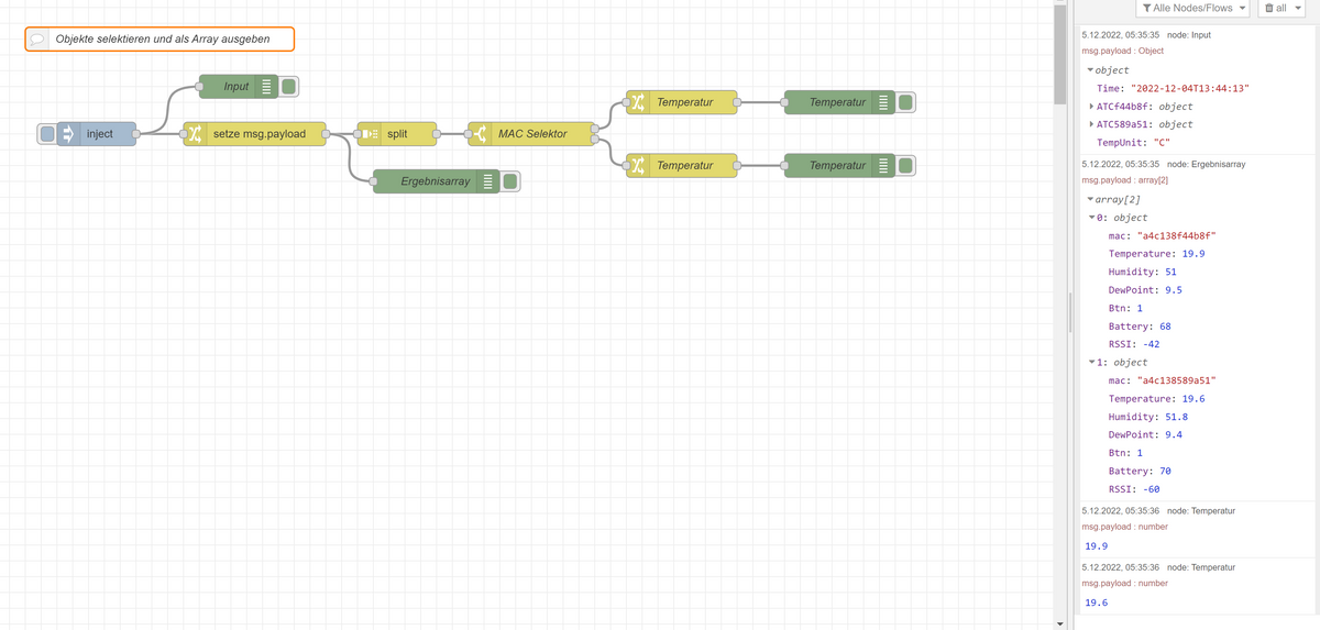

            Hier noch eine einfachere Lösung mit JSONATA - (da muss ich aber auch immer erst probieren).
            Damit spart man sich den switch und selectiert nur die Objekte, die eine mac Adresse haben:
                    "id": "c19076460e052cbe",
                    "type": "inject",
                    "z": "289f539dcc33814e",
                    "name": "",
                    "props": [
                            "p": "payload"
                    "repeat": "",
                    "crontab": "",
                    "once": false,
                    "onceDelay": 0.1,
                    "topic": "",
                    "payloadType": "json",
                    "x": 190,
                    "y": 180,
                    "wires": [
                            "9ee4e3eabd877e79",
                            "a739f00f949d5b6a"
                    "id": "9ee4e3eabd877e79",
                    "type": "change",
                    "name": "",
                    "rules": [
                            "t": "set",
                            "p": "payload",
                            "pt": "msg",
                            "to": "payload.*[mac]",
                            "tot": "jsonata"
                    "action": "",
                    "property": "",
                    "from": "",
                    "to": "",
                    "reg": false,
                    "x": 390,
                    "y": 180,
                    "wires": [
                            "9d293f1fc9c7c077",
                            "1117c4f5f591bdd7"
                    "id": "9d293f1fc9c7c077",
                    "type": "split",
                    "name": "",
                    "splt": "\\n",
                    "spltType": "str",
                    "arraySplt": 1,
                    "stream": false,
                    "addname": "",
                    "x": 570,
                    "y": 180,
                    "wires": [
                            "4fa63fbcc9b634fe"
                    "id": "fbeaa56747a92be4",
                    "type": "debug",
                    "active": true,
                    "tosidebar": true,
                    "console": false,
                    "tostatus": false,
                    "statusVal": "",
                    "x": 1130,
                    "y": 140,
                    "wires": []
                    "id": "4fa63fbcc9b634fe",
                    "type": "switch",
                    "rules": [
                            "t": "eq",
                            "vt": "str"
                            "t": "eq",
                            "vt": "str"
                    "checkall": "true",

            Dein Objekt
            {"Time":"2022-12-04T13:44:13","ATCf44b8f":{"mac":"a4c138f44b8f","Temperature":19.9,"Humidity":51,"DewPoint":9.5,"Btn":1,"Battery":68,"RSSI":-42},"ATC589a51":{"mac":"a4c138589a51","Temperature":19.6,"Humidity":51.8,"DewPoint":9.4,"Btn":1,"Battery":70,"RSSI":-60},"TempUnit":"C"}
            wird mit folgendem JSONATA ein Array mit Objekten (die einen Textschlüssel mit Eigenschaft "mac" - geht nur bei Typ Text - bei Zahlen benötigt man numerische Vergleiche) reduziert.
            payload.*[mac]
            will man im Übrigen auf Eigenschaften mit Zahlen als Wert selektieren, benötigt man die $exists() Funktion
            *[$exists(Temperature)]
            selektiert alle Objekte, die eine Eigenschaft Temperature enthalten.
            das Ergebnisarray kann dann einfach mit einer split Node in einzelne Nachrichten aufgeteilt werden:
            [{"mac":"a4c138f44b8f","Temperature":19.9,"Humidity":51,"DewPoint":9.5,"Btn":1,"Battery":68,"RSSI":-42},{"mac":"a4c138589a51","Temperature":19.6,"Humidity":51.8,"DewPoint":9.4,"Btn":1,"Battery":70,"RSSI":-60}]
            Jörg_ 1 Reply Last reply Reply Quote 1
            • Jörg_
              Jörg_ @mickym last edited by Jörg_
              @mickym
              ging ja schneller als gedacht 🙂
              peferkt besten Dank läuft jetzt wie gewüscht 😉 !!!
