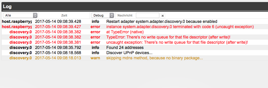

        Was sagt das log? Irgend ein Fehler?!
        • Skudderon
          Skudderon last edited by
          Oh mein Gott … Asche auf mein Haupt ... ioBroker hat ein Log 😞 ... ich hab echt nicht dran gedacht
          Ich hab das Log mal drangehangen

                ja, kann ich … vielen Dank für deine Hilfe ... hier ist das Ergebnis:
                Received "browse" event
                skipping mdns method, because no binary package...
                ping: 0%, devices - 0
                serial: 100%, devices - 1
                Discover UPnP devices...
                upnp: 0%, devices - 0
                found 192.168.2.1
                found 192.168.2.20
                UPNP Answer from 192.168.2.1
                found {"_addr":"192.168.2.1","_name":"fritz.box","_data":{"names":["fritz.box"]}}
                found {"_addr":"192.168.2.20","_name":"Henriks-MBP.fritz.box","_data":{"names":["Henriks-MBP.fritz.box"]}}
                UPNP Answer from 192.168.2.33
                UPNP Answer from 192.168.2.22
                UPNP Answer from 192.168.2.32
                UPNP Answer from 192.168.2.35
                UPNP Answer from 192.168.2.34
                ping: 8%, devices - 2
                found 192.168.2.22
                found 192.168.2.23
                found 192.168.2.27
                found 192.168.2.31
                found 192.168.2.32
                found 192.168.2.33
                found 192.168.2.34
                found 192.168.2.35
                found 192.168.2.36
                found {"_addr":"192.168.2.22","_name":"SonosZB.fritz.box","_data":{"names":["SonosZB.fritz.box"]}}
                found {"_addr":"192.168.2.23","_name":"tc.fritz.box","_data":{"names":["tc.fritz.box"]}}
                found {"_addr":"192.168.2.27","_name":"Henriks-iPad-2.fritz.box","_data":{"names":["Henriks-iPad-2.fritz.box"]}}
                found {"_addr":"192.168.2.31","_name":"192.168.2.31"}
                found {"_addr":"192.168.2.32","_name":"SonosZP.fritz.box","_data":{"names":["SonosZP.fritz.box"]}}
                found {"_addr":"192.168.2.33","_name":"SonosZP.fritz.box","_data":{"names":["SonosZP.fritz.box"]}}
                found {"_addr":"192.168.2.34","_name":"SonosZP.fritz.box","_data":{"names":["SonosZP.fritz.box"]}}
                found {"_addr":"192.168.2.35","_name":"SonosZP.fritz.box","_data":{"names":["SonosZP.fritz.box"]}}
                found {"_addr":"192.168.2.36","_name":"192.168.2.36"}
                UPNP Answer from 192.168.2.124
                upnp: 10%, devices - 7
                ping: 15%, devices - 11
                upnp: 20%, devices - 7
                ping: 23%, devices - 11
                upnp: 30%, devices - 7
                ping: 31%, devices - 11
                found 192.168.2.101
                found {"_addr":"192.168.2.101","_name":"Zigarenbox.fritz.box","_data":{"names":["Zigarenbox.fritz.box"]}}
                upnp: 40%, devices - 7
                ping: 38%, devices - 12
                found 192.168.2.115
                found {"_addr":"192.168.2.115","_name":"Danidrucker.fritz.box","_data":{"names":["Danidrucker.fritz.box"]}}
                upnp: 50%, devices - 7
                ping: 46%, devices - 13
                found 192.168.2.124
                found {"_addr":"192.168.2.124","_name":"WDMyCloud.fritz.box","_data":{"names":["WDMyCloud.fritz.box"]}}
                upnp: 60%, devices - 7
                ping: 54%, devices - 14
                upnp: 70%, devices - 7
                ping: 62%, devices - 14
                ping: 69%, devices - 14
                upnp: 80%, devices - 7
                upnp: 90%, devices - 7
                ping: 77%, devices - 14
                ping: 85%, devices - 14
                upnp: 100%, devices - 7
                ping: 92%, devices - 14
                ping: 100%, devices - undefined
                Found 22 addresses
                Test 192.168.2.23 chromecast
                Test 192.168.2.23 daikin
                Test 192.168.2.23 fronius
                Test 192.168.2.23 hm-rpc
                Test 192.168.2.23 hue
                Test 192.168.2.23 influxdb
                Test 192.168.2.23 landroid
                Test 192.168.2.23 lightify
                Test 192.168.2.23 megad
                Test 192.168.2.23 miele
                Test 192.168.2.23 nut
                Test 192.168.2.23 ping
                Test 192.168.2.23 ping DETECTED!
                Test 192.168.2.23 samsung
                Test 192.168.2.23 sonos
                Test 192.168.2.23 sql
                Test 192.168.2.23 tr-064
                Test 192.168.2.23 upnp
                Test 192.168.2.23 yamaha
                Send UDP discovery package
                Not found
                Test 192.168.2.23 hm-rega
                Test /dev/ttyAMA0 mysensors
                [TypeError: There's no write queue for that file descriptor (after write)!]
                terminating

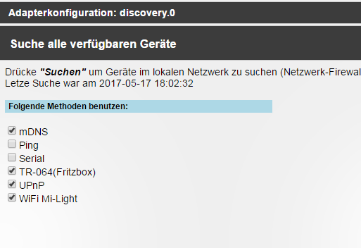

                • Bluefox
                  Bluefox last edited by
                  @Skudderon:
                  ! Received "browse" event skipping mdns method, because no binary package... ping: 0%, devices - 0 serial: 100%, devices - 1 Discover UPnP devices... upnp: 0%, devices - 0 found 192.168.2.1 found 192.168.2.20 UPNP Answer from 192.168.2.1 found {"_addr":"192.168.2.1","_name":"fritz.box","_data":{"names":["fritz.box"]}} found {"_addr":"192.168.2.20","_name":"Henriks-MBP.fritz.box","_data":{"names":["Henriks-MBP.fritz.box"]}} UPNP Answer from 192.168.2.33 UPNP Answer from 192.168.2.22 UPNP Answer from 192.168.2.32 UPNP Answer from 192.168.2.35 UPNP Answer from 192.168.2.34 ping: 8%, devices - 2 found 192.168.2.22 found 192.168.2.23 found 192.168.2.27 found 192.168.2.31 found 192.168.2.32 found 192.168.2.33 found 192.168.2.34 found 192.168.2.35 found 192.168.2.36 found {"_addr":"192.168.2.22","_name":"SonosZB.fritz.box","_data":{"names":["SonosZB.fritz.box"]}} found {"_addr":"192.168.2.23","_name":"tc.fritz.box","_data":{"names":["tc.fritz.box"]}} found {"_addr":"192.168.2.27","_name":"Henriks-iPad-2.fritz.box","_data":{"names":["Henriks-iPad-2.fritz.box"]}} found {"_addr":"192.168.2.31","_name":"192.168.2.31"} found {"_addr":"192.168.2.32","_name":"SonosZP.fritz.box","_data":{"names":["SonosZP.fritz.box"]}} found {"_addr":"192.168.2.33","_name":"SonosZP.fritz.box","_data":{"names":["SonosZP.fritz.box"]}} found {"_addr":"192.168.2.34","_name":"SonosZP.fritz.box","_data":{"names":["SonosZP.fritz.box"]}} found {"_addr":"192.168.2.35","_name":"SonosZP.fritz.box","_data":{"names":["SonosZP.fritz.box"]}} found {"_addr":"192.168.2.36","_name":"192.168.2.36"} UPNP Answer from 192.168.2.124 upnp: 10%, devices - 7 ping: 15%, devices - 11 upnp: 20%, devices - 7 ping: 23%, devices - 11 upnp: 30%, devices - 7 ping: 31%, devices - 11 found 192.168.2.101 found {"_addr":"192.168.2.101","_name":"Zigarenbox.fritz.box","_data":{"names":["Zigarenbox.fritz.box"]}} upnp: 40%, devices - 7 ping: 38%, devices - 12 found 192.168.2.115 found {"_addr":"192.168.2.115","_name":"Danidrucker.fritz.box","_data":{"names":["Danidrucker.fritz.box"]}} upnp: 50%, devices - 7 ping: 46%, devices - 13 found 192.168.2.124 found {"_addr":"192.168.2.124","_name":"WDMyCloud.fritz.box","_data":{"names":["WDMyCloud.fritz.box"]}} upnp: 60%, devices - 7 ping: 54%, devices - 14 upnp: 70%, devices - 7 ping: 62%, devices - 14 ping: 69%, devices - 14 upnp: 80%, devices - 7 upnp: 90%, devices - 7 ping: 77%, devices - 14 ping: 85%, devices - 14 upnp: 100%, devices - 7 ping: 92%, devices - 14 ping: 100%, devices - undefined Found 22 addresses Test 192.168.2.23 chromecast Test 192.168.2.23 daikin Test 192.168.2.23 fronius Test 192.168.2.23 hm-rpc Test 192.168.2.23 hue Test 192.168.2.23 influxdb Test 192.168.2.23 landroid Test 192.168.2.23 lightify Test 192.168.2.23 megad Test 192.168.2.23 miele Test 192.168.2.23 nut Test 192.168.2.23 ping Test 192.168.2.23 ping DETECTED! Test 192.168.2.23 samsung Test 192.168.2.23 sonos Test 192.168.2.23 sql Test 192.168.2.23 tr-064 Test 192.168.2.23 upnp Test 192.168.2.23 yamaha Send UDP discovery package Not found Test 192.168.2.23 hm-rega Test /dev/ttyAMA0 mysensors [TypeError: There's no write queue for that file descriptor (after write)!] terminating `
                  bitte diese Datei Löschen. Dann kannst du mindestens discovery nutzen.
                  /opt/iobroker/node_modiles/iobroker.discovery/lib/methods/serial.js
                  Ich kann momentan nicht erkennen, wo der Fehler liegt.
                  Ist das Linux oder Windows (Raspi, OSX, ….)?
                  discovery version?
                  node.js version?

                    • Skudderon
                      Vielen Dank @bluefox! Das hat das Problem behoben und der Assistent lief durch.
                      Um deine Frage noch zu beantworten:
                      ioBroker auf Raspi 3.
                      Node 4.8.3
                      discovery 0.2.3
