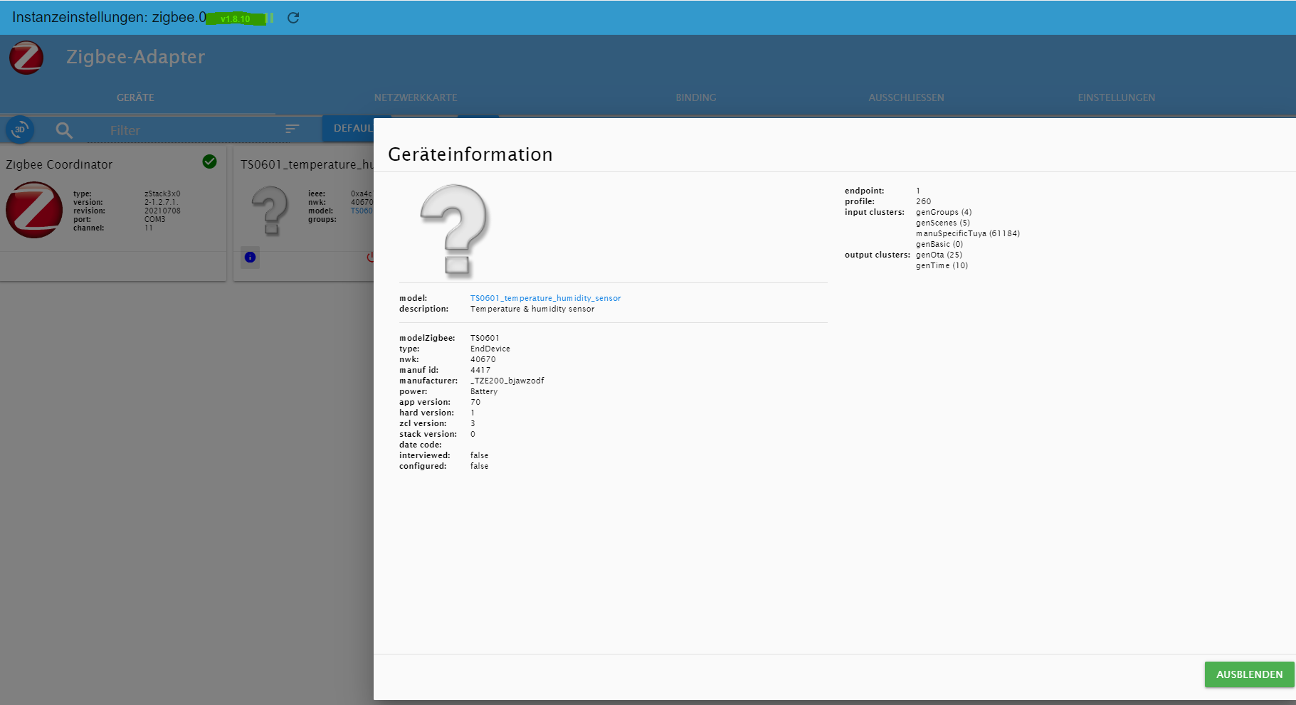

      Ausschließen funktioniert auch nicht.

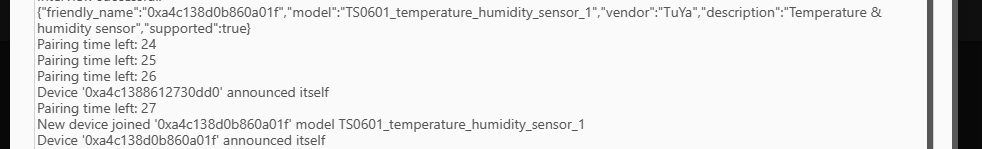

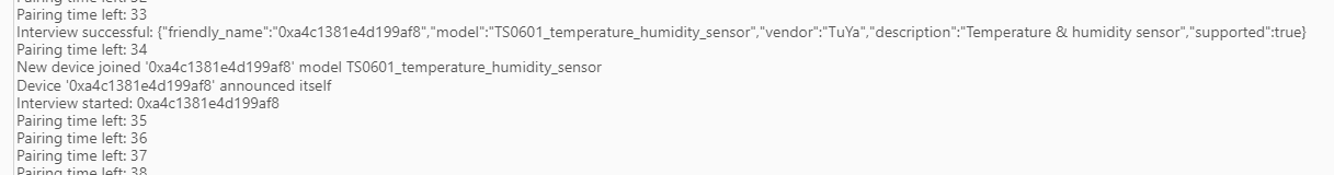

              Log Zigbee Pairing
              Interview successful: {"friendly_name":"0xa4c1381e4d199af8","model":"TS0601_temperature_humidity_sensor","vendor":"TuYa","description":"Temperature & humidity sensor","supported":true}
              Pairing time left: 42
              New device joined '0xa4c1381e4d199af8' model TS0601_temperature_humidity_sensor
              Device '0xa4c1381e4d199af8' announced itself
              Interview started: 0xa4c1381e4d199af8
              Log Admin Protokolle:
              2022-12-27 14:38:44.384 - info: zigbee.0 (17660) List of port: [{"path":"COM3","manufacturer":"Silicon Labs","serialNumber":"0001","pnpId":"USB\\VID_10C4&PID_EA60\\0001","locationId":"Port_#0004.Hub_#0003","friendlyName":"Silicon Labs CP210x USB to UART Bridge (COM3)","vendorId":"10C4","productId":"EA60"},{"path":"COM1","manufacturer":"(Standardanschlusstypen)","pnpId":"ACPI\\PNP0501\\0","friendlyName":"Kommunikationsanschluss (COM1)"}]
              2022-12-27 14:38:52.641 - info: zigbee.0 (17660) Zigbee: allowing new devices to join.
              2022-12-27 14:39:11.335 - info: zigbee.0 (17660) Starting interview of '0xa4c1381e4d199af8'
              2022-12-27 14:39:11.408 - warn: zigbee.0 (17660) Device '0xa4c1381e4d199af8' announced itself
              2022-12-27 14:39:12.341 - info: zigbee.0 (17660) Successfully interviewed '0xa4c1381e4d199af8', device has successfully been paired
              2022-12-27 14:39:12.341 - info: zigbee.0 (17660) Device '0xa4c1381e4d199af8' is supported, identified as: TuYa Temperature & humidity sensor (TS0601_temperature_humidity_sensor)
              2022-12-27 14:39:54.430 - info: zigbee.0 (17660) Zigbee: stop joining

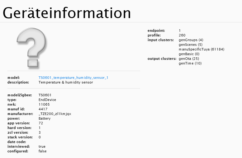

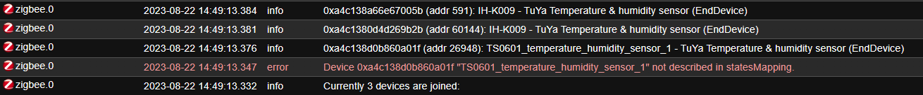

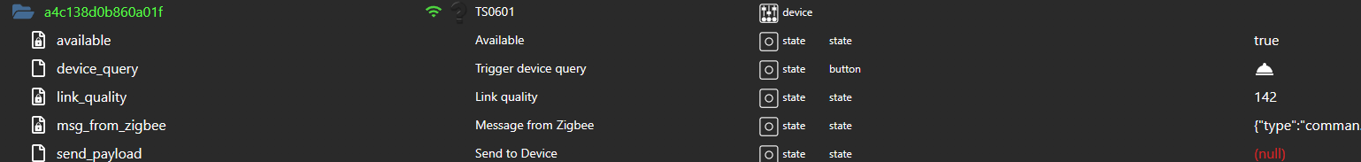

                      Nach pairen tauchen die Sensoren so auf:

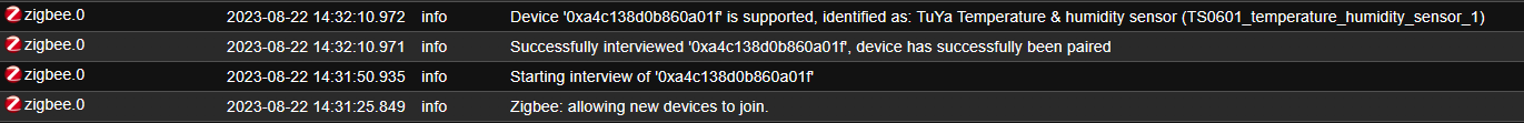

                      Log beim pairen:

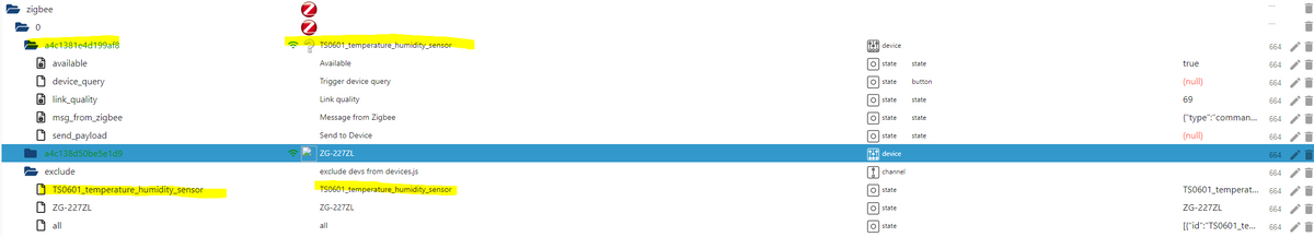

                      Objektbaum sieht dann so aus:
                      arteck H 2 Replies Last reply Reply Quote 0
                        arteck Developer Most Active @rocky753 last edited by
                        @rocky753 nö komplett was anderes.. schau dir mal deine Modell bezeichnung an und seine.. das sidn 2 total verschiedene Geräte..ja auch wenn diese GENAU so aussehen...
                        willkommen in der Tuya Welt.

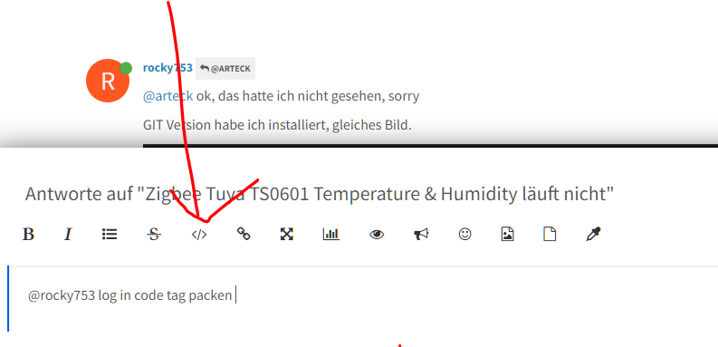

                            @rocky753 log in code tag packen

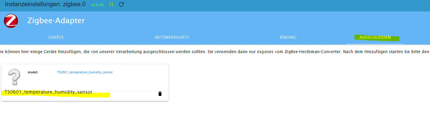

                                  @rocky753 sagte in Zigbee Tuya TS0601 Temperature & Humidity läuft nicht:
                                  2023-08-22 22:06:50.989 error Device 0xa4c138d0b860a01f "TS0601_temperature_humidity_sensor_1" not described in statesMapping.
                                  pack den mal unter ausschliesen rein
                                    rocky753 @arteck last edited by
                                    @arteck
                                    ist jetzt unter ausschliessen drin. danach adapter Neustart.
                                    Log:

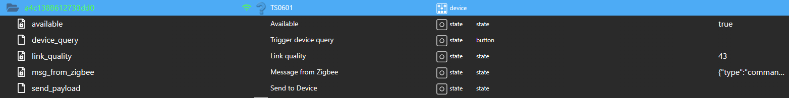

                                        @arteck
                                        hmm, ich glaub ich steht aufm Schlauch. Ich sehe keinen Unterschied zu vorher. Im Objektbaum sind weiterhin keine Temp. u. Feuchtigkeit. Oder muss ich noch was machen damit die jetzt auftauchen?

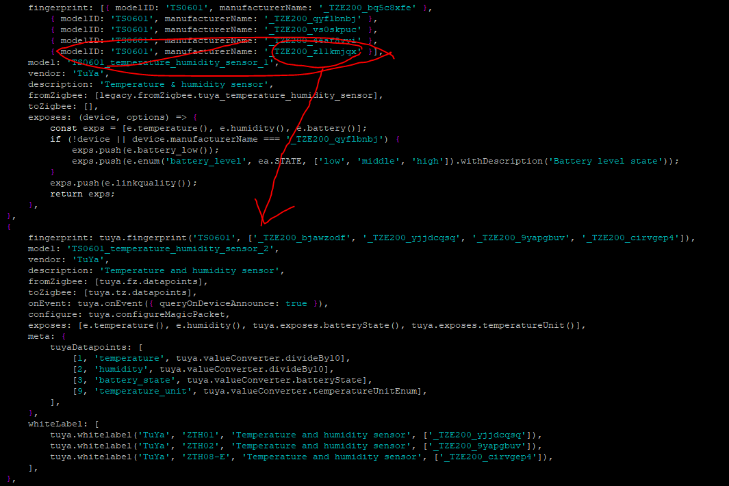

                                          @rocky753 ich seh geadre wir haben ein Problem mit dem model...da scheint was zu fehlen..
                                            arteck Developer Most Active @arteck last edited by
                                            @arteck installier mal jetzt den Adapter von git und schau nochmal.. musst aber nochmal neu anlernen
