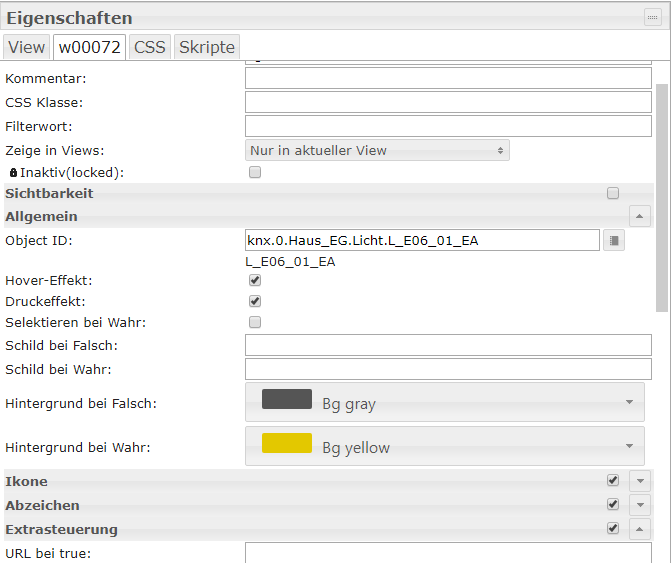

          Poste bitte mal einen Screenshot der Widget-Konfig (den Teil, wo Du die Objekt-ID eingetragen hast bitte vollständig).
          Gruß,
          Eric
          Von unterwegs getippert
            steeffan last edited by
            Hier ein Screenshot und die gesamte config.
            Das Objekt "knx.0.Haus.EG.Licht_1" heißt in diesem Fall "knx.0.Haus_EG.Licht.L_E06_01_EA"
            > [{"tpl":"tplMetroTileToggle","data":{"oid":"knx.0.Haus_EG.Licht.L_E06_01_EA","g_fixed":true,"g_visibility":false,"g_css_font_text":false,"g_css_background":false,"g_css_shadow_padding":false,"g_css_border":true,"g_gestures":false,"g_signals":false,"visibility-cond":"==","visibility-val":1,"visibility-groups-action":"hide","hover":"true","transform":"true","bg_class_false":"bg-gray","bg_class_true":"bg-yellow","icon_class_false":"","icon_class_true":"","icon_badge_false":"","icon_badge_true":"","badge_bg_class_false":"","badge_bg_class_true":"","brand_bg_class_false":"","brand_bg_class_true":"","badge_top":"0","badge_left":"0","signals-cond-0":"==","signals-val-0":true,"signals-icon-0":"/vis/signals/lowbattery.png","signals-icon-size-0":0,"signals-blink-0":false,"signals-horz-0":0,"signals-vert-0":0,"signals-hide-edit-0":false,"signals-cond-1":"==","signals-val-1":true,"signals-icon-1":"/vis/signals/lowbattery.png","signals-icon-size-1":0,"signals-blink-1":false,"signals-horz-1":0,"signals-vert-1":0,"signals-hide-edit-1":false,"signals-cond-2":"==","signals-val-2":true,"signals-icon-2":"/vis/signals/lowbattery.png","signals-icon-size-2":0,"signals-blink-2":false,"signals-horz-2":0,"signals-vert-2":0,"signals-hide-edit-2":false,"label_false":"","icon_false":"/icons-mfd-svg/light_light.svg","icon_true":"/icons-mfd-svg/light_light_dim_100.svg","name":"lightCtrl_onoff_wohnzimmer","g_ccontrol":true},"style":{"left":"370px","top":"530px","width":"76px","height":"87px","border-width":"1px","border-color":"#4a4a4a","border-style":"solid","border-radius":"10px"},"widgetSet":"metro"}]
            • eric2905
              eric2905 last edited by
              @steeffan:
              Folgendes Vorgehen: KNX Taster betätigen. Objekt "knx.0.Haus.EG.Licht_1" wird getoggelt. `
              im Screenshot ist aber ein anderer Datenpunkt eingetragen.
              Sicher, das Du den richtigen DP im Widget eingetragen hast?
              Gruß,
              Eric
                ja, das war der richtige Datenpunkt. Das Problem hat sich gerade gelöst:
                Ich habe in ETS versehentlich ein Leerzeichen in dem Variablennamen verwendet. In iobroker wird ein Leerzeichen durch ein "_" ersetzt, deswegen ist das nicht sofort aufgefallen. Nachdem ich jetzt das Leerzeichen in dem Variablennamen entfernt habe, funktioniert auch die Aktualisierung in vis super. Danke.
