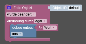

      Flori @Thomas Braun last edited by
      @thomas-braun
      Ich habe eben die Debug Meldungen als Error ausgeben lassen das ich sie besser heraus lesen kann.

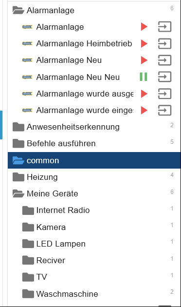

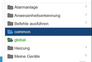

        Liegt da irgendwas an skripten in 'global'?
          @thomas-braun
          Nein so wie ich das sehe ist der blaue Ordner leer wenn du diesen meinst.
            Thomas Braun Most Active @Flori last edited by
            @flori
            Nein, ich meine das Verzeichnis 'global'. Sieht man nur im Experten-Modus.
              @thomas-braun
              Nein absolut leer

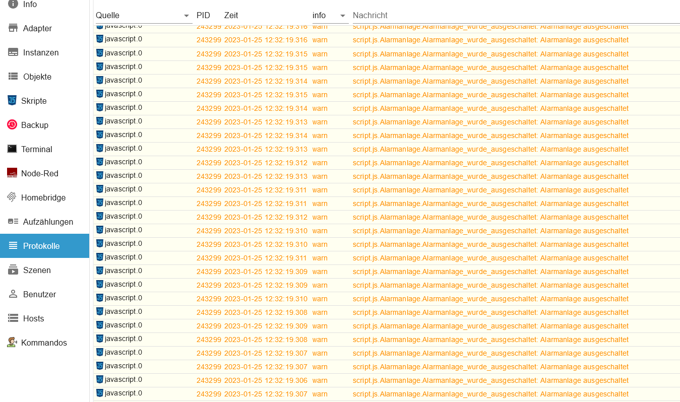

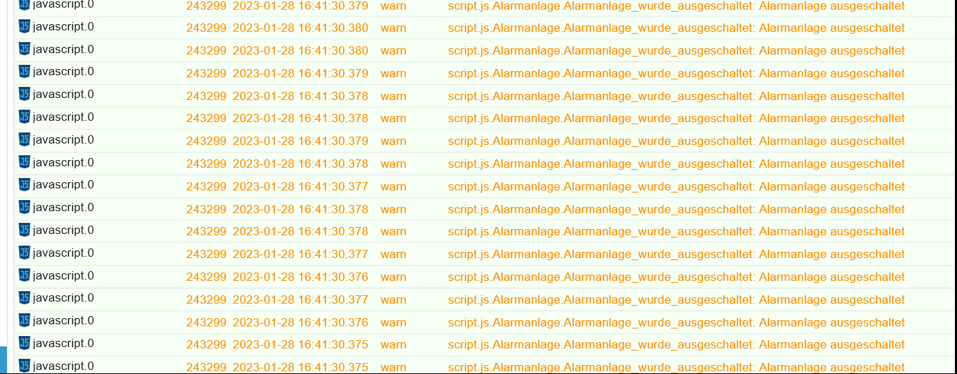

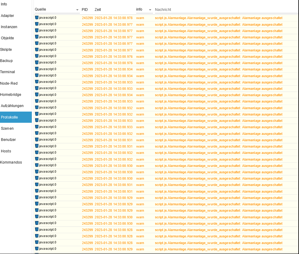

                Flori @DJMarc75 last edited by
                @djmarc75
                So jetzt noch einmal mit genau deinem Programm. Erst das davor vor den 100000 gleichen Einträgen
                2023-01-28 18:02:31.211 - info: admin.0 (243242) ==> Connected system.user.admin from ::ffff:192.168.178.69
                2023-01-28 18:02:40.393 - info: admin.0 (243242) <== Disconnect system.user.admin from ::ffff:192.168.178.69 javascript
                2023-01-28 18:03:01.808 - info: admin.0 (243242) ==> Connected system.user.admin from ::ffff:192.168.178.69
                2023-01-28 18:03:28.880 - info: javascript.0 (243299) script.js.Alarmanlage.Neu_für_DJ: 1
                2023-01-28 18:03:31.019 - info: admin.0 (243242) <== Disconnect system.user.admin from ::ffff:192.168.178.69 javascript
                2023-01-28 18:03:49.503 - info: fritzdect.0 (492214) State value to set for "fritzdect.0.DECT_099950115643.windowopenactiveendtime" has to be type "number" but received type "string"
                2023-01-28 18:03:49.504 - info: fritzdect.0 (492214) State value to set for "fritzdect.0.DECT_099950115643.boostactiveendtime" has to be type "number" but received type "string"
                2023-01-28 18:03:49.505 - info: fritzdect.0 (492214) State value to set for "fritzdect.0.DECT_099950115643.endperiod" has to be type "number" but received type "string"
                2023-01-28 18:03:49.549 - info: fritzdect.0 (492214) State value to set for "fritzdect.0.DECT_099950116517.windowopenactiveendtime" has to be type "number" but received type "string"
                2023-01-28 18:03:49.551 - info: fritzdect.0 (492214) State value to set for "fritzdect.0.DECT_099950116517.boostactiveendtime" has to be type "number" but received type "string"
                2023-01-28 18:03:49.553 - info: fritzdect.0 (492214) State value to set for "fritzdect.0.DECT_099950116517.endperiod" has to be type "number" but received type "string"
                2023-01-28 18:03:49.628 - info: fritzdect.0 (492214) State value to set for "fritzdect.0.DECT_099950116240.windowopenactiveendtime" has to be type "number" but received type "string"
                2023-01-28 18:03:49.629 - info: fritzdect.0 (492214) State value to set for "fritzdect.0.DECT_099950116240.boostactiveendtime" has to be type "number" but received type "string"
                2023-01-28 18:03:49.629 - info: fritzdect.0 (492214) State value to set for "fritzdect.0.DECT_099950116240.endperiod" has to be type "number" but received type "string"
                2023-01-28 18:03:49.669 - info: fritzdect.0 (492214) State value to set for "fritzdect.0.DECT_099950135395.windowopenactiveendtime" has to be type "number" but received type "string"
                2023-01-28 18:03:49.670 - info: fritzdect.0 (492214) State value to set for "fritzdect.0.DECT_099950135395.boostactiveendtime" has to be type "number" but received type "string"
                2023-01-28 18:03:49.685 - info: fritzdect.0 (492214) State value to set for "fritzdect.0.DECT_099950135395.endperiod" has to be type "number" but received type "string"
                2023-01-28 18:03:29.471 - info: javascript.0 (243299) script.js.Alarmanlage.Neu_für_DJ: 3
                2023-01-28 18:03:59.464 - warn: javascript.0 (243299) script.js.Alarmanlage.Alarmanlage_wurde_ausgeschaltet: Alarmanlage ausgeschaltet
                2023-01-28 18:03:59.465 - warn: javascript.0 (243299) script.js.Alarmanlage.Alarmanlage_wurde_ausgeschaltet: Alarmanlage ausgeschaltet
                2023-01-28 18:03:59.466 - warn: javascript.0 (243299) script.js.Alarmanlage.Alarmanlage_wurde_ausgeschaltet: Alarmanlage ausgeschaltet
                2023-01-28 18:03:59.467 - warn: javascript.0 (243299) script.js.Alarmanlage.Alarmanlage_wurde_ausgeschaltet: Alarmanlage ausgeschaltet
                2023-01-28 18:03:59.468 - warn: javascript.0 (243299) script.js.Alarmanlage.Alarmanlage_wurde_ausgeschaltet: Alarmanlage ausgeschaltet
                2023-01-28 18:03:59.469 - warn: javascript.0 (243299) script.js.Alarmanlage.Alarmanlage_wurde_ausgeschaltet: Alarmanlage ausgeschaltet

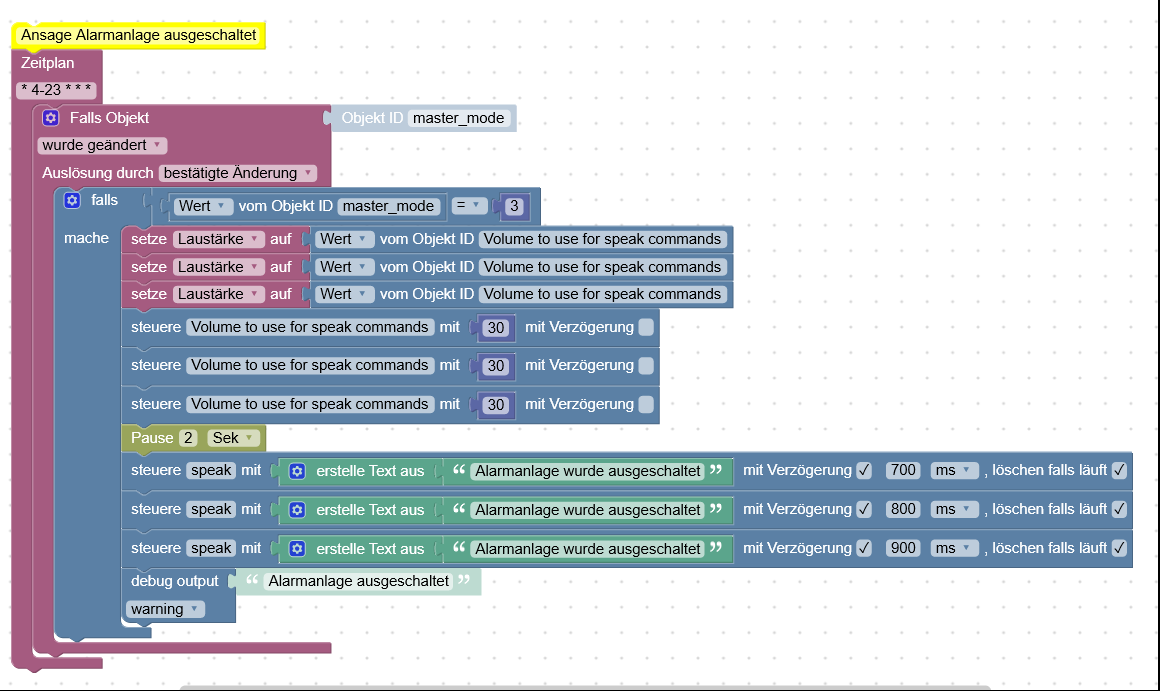

                  @flori sagte in Alexa erzählt etwas anderes als sie soll:
                  Poste doch mal das Skript
                    @djmarc75

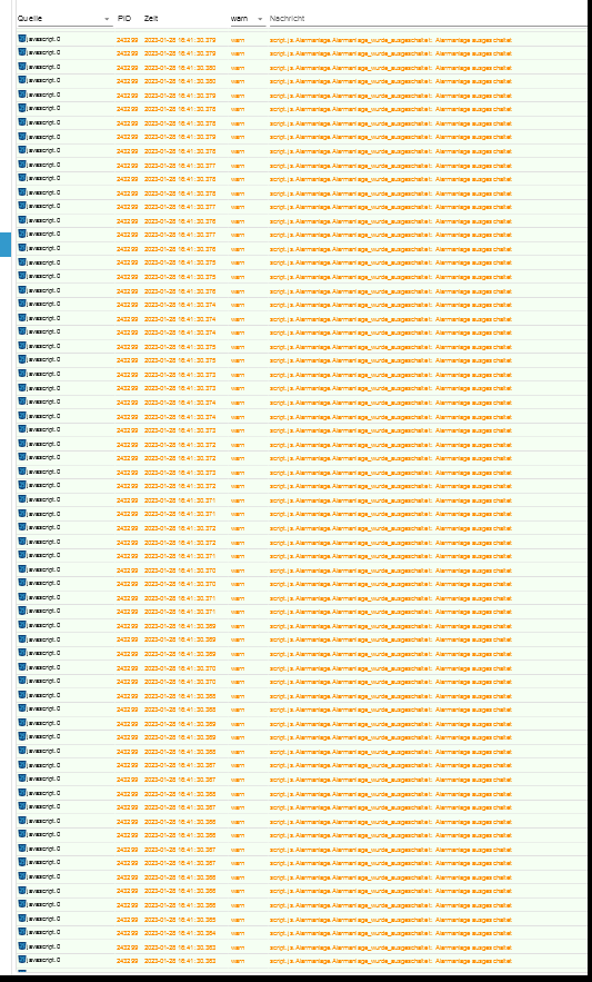

                    Und noch einmal das danach. Mit den unzähligen Ansagen. Das berühmte Sätzchen kommt übrigens auch wieder auch ohne Sprachaktivierung. 😉
                    2023-01-28 18:04:06.149 - warn: javascript.0 (243299) script.js.Alarmanlage.Alarmanlage_wurde_ausgeschaltet: Alarmanlage ausgeschaltet
                    2023-01-28 18:04:06.150 - warn: javascript.0 (243299) script.js.Alarmanlage.Alarmanlage_wurde_ausgeschaltet: Alarmanlage ausgeschaltet
                    2023-01-28 18:04:06.152 - warn: javascript.0 (243299) script.js.Alarmanlage.Alarmanlage_wurde_ausgeschaltet: Alarmanlage ausgeschaltet
                    2023-01-28 18:04:06.154 - warn: javascript.0 (243299) script.js.Alarmanlage.Alarmanlage_wurde_ausgeschaltet: Alarmanlage ausgeschaltet
                    2023-01-28 18:04:06.169 - warn: javascript.0 (243299) script.js.Alarmanlage.Alarmanlage_wurde_ausgeschaltet: Alarmanlage ausgeschaltet
                    2023-01-28 18:04:06.171 - warn: javascript.0 (243299) script.js.Alarmanlage.Alarmanlage_wurde_ausgeschaltet: Alarmanlage ausgeschaltet
                    2023-01-28 18:04:06.172 - warn: javascript.0 (243299) script.js.Alarmanlage.Alarmanlage_wurde_ausgeschaltet: Alarmanlage ausgeschaltet
                    2023-01-28 18:04:06.562 - info: admin.0 (243242) ==> Connected system.user.admin from ::ffff:192.168.178.69
                    2023-01-28 18:04:11.149 - info: tuya.0 (243444) 02654020840d8e804331: Error on Reconnect (5): connection timed out
                    2023-01-28 18:04:48.208 - info: admin.0 (243242) <== Disconnect system.user.admin from ::ffff:192.168.178.69 javascript
                    2023-01-28 18:04:23.541 - info: javascript.0 (243299) script.js.Alarmanlage.Neu_für_DJ: 1
                        @thomas-braun
                        Dieses Skript läuft aber im Moment überhaupt nicht weil da noch die Sachen mit drinne sind die ich dann bei den neuen Script komplett heraus genommen habe. Sprich Trigger in Trigger so wie das mit der Zeit.
