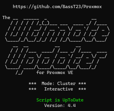

          v4.1 released
          !! Because of name and directory changing, you need an restart of the node, after update !!
          Extras:
          • name changing ("Proxmox Updater" is now "The Ultimate Updater for Proxmox VE")
          • disable/enable Snapshots and Backups in config file
          • set, how many snapshots will be keep, in config file
          • delete old (Update_) snapshots
          • move program to correct folder system
          • edit config file, for better usage
          • update-check can now be better set (in config file)
          • support Docker Compose v1 and v2
          Fixed:
          • bug fixing
          • Bass-T
            Bass-T last edited by
            v4.2 released
            Extras:
            • rebuild waiting for VM start (could now be set in config file)
            Fixed:
            • VM Template error
            • Unifi-Controller Container
            • FreeBSD VM error
            • docker compose
            • node hopping without welcome screen installed
            • Bass-T
              v4.3 released
              https://github.com/BassT23/Proxmox
              • add freebsd VM (QEMU and SSH Connection)
              • add non root user update in VMs
              • add autoclean for debian based systems
              • add filesystem trim for ext4 systems
              • add curl for internet check
              • add env settings for arch in config file
              • add kernel kleaning (disabled by default in config file)
              • fix run for only one LXC/VM with update <ID>
              • fix ioBroker Upgrade
              • fix arch upgrade
              • fix START/STOP/WAITING for stopped VMs
              • fix compatibility with "old" ssh connection
              • fix IP output by nodes
              • fix fedora autoremove
              • fix missing kernel infos
              • fix template detection
              • fix internet check
              • modify config file - checker settings now on the buttom
              • modify version check - check now all branches
              • code cleaning

                        Mit dem neuen Update ist jetzt auch ein "Error-Hopping" drin.
                        Das Script bricht nun bei error nicht mehr ab, sondern bricht nur die LXC/VM ab und macht beim nächsten weiter.
                        Am Ende bekommst du ein log mit Fehlern.
                        Diese fehlerhaften dann am besten mit "update <ID>" nochmal separat updaten. Immer nur einen. Somit kommen auch interactive abfragen 😉
                        Viel spass beim Updaten 🙂
