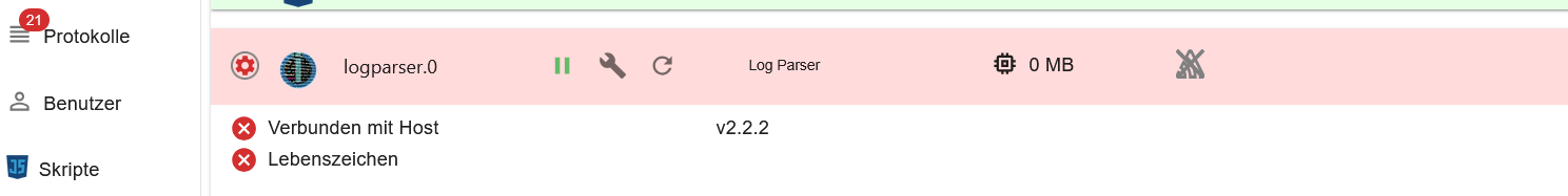

      Hi, benutze den logparser seit längerer Zeit, seit kurzem habe ich folgende Fehlermeldung:
      Komme da nicht wirklich weiter.
      VG AFi

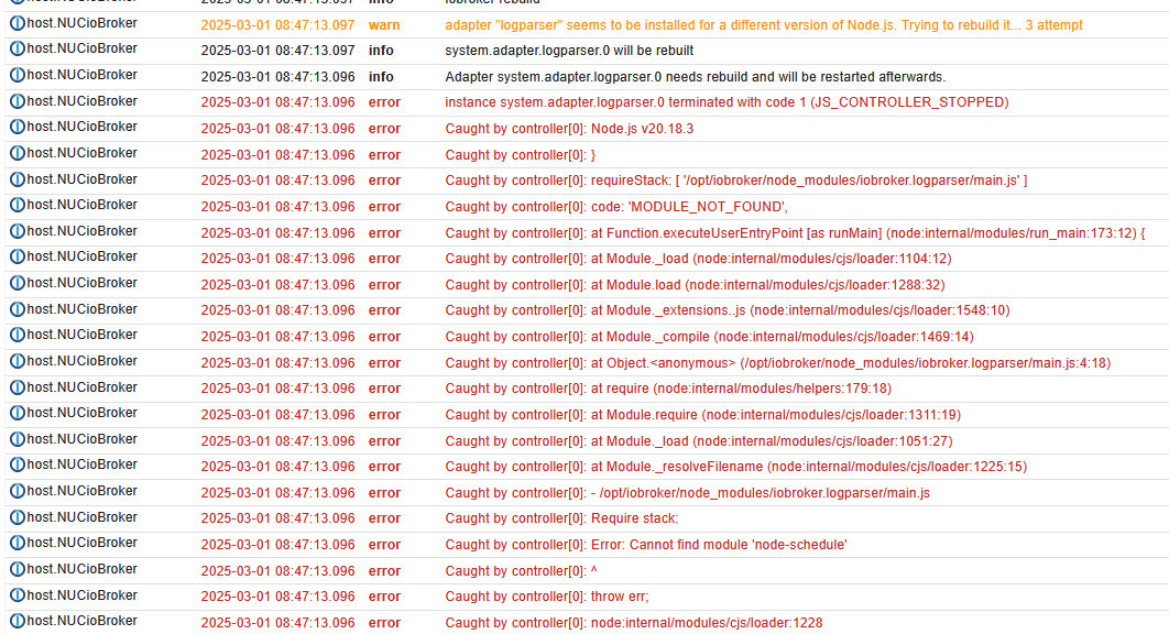

                    @thomas-braun Hi Thomas, ich komme da nicht wirklich weiter, habe den Adapter nochmals frisch installiert, anbei nochmals die Fehlermeldung.
                    Irgend wie glaube ich, dass es mit node.js und der neuesten Version zutun hat.
                    VG Axel
                    2025-03-01 18:21:13.208 - error: host.NUCioBroker Caught by controller[0]: node:internal/modules/cjs/loader:1228
                    2025-03-01 18:21:13.208 - error: host.NUCioBroker Caught by controller[0]: throw err;
                    2025-03-01 18:21:13.208 - error: host.NUCioBroker Caught by controller[0]: ^
                    2025-03-01 18:21:13.208 - error: host.NUCioBroker Caught by controller[0]: Error: Cannot find module 'node-schedule'
                    2025-03-01 18:21:13.208 - error: host.NUCioBroker Caught by controller[0]: Require stack:
                    2025-03-01 18:21:13.208 - error: host.NUCioBroker Caught by controller[0]: - /opt/iobroker/node_modules/iobroker.logparser/main.js
                    2025-03-01 18:21:13.208 - error: host.NUCioBroker Caught by controller[0]: at Module._resolveFilename (node:internal/modules/cjs/loader:1225:15)
                    2025-03-01 18:21:13.208 - error: host.NUCioBroker Caught by controller[0]: at Module._load (node:internal/modules/cjs/loader:1051:27)
                    2025-03-01 18:21:13.208 - error: host.NUCioBroker Caught by controller[0]: at Module.require (node:internal/modules/cjs/loader:1311:19)
                    2025-03-01 18:21:13.208 - error: host.NUCioBroker Caught by controller[0]: at require (node:internal/modules/helpers:179:18)
                    2025-03-01 18:21:13.208 - error: host.NUCioBroker Caught by controller[0]: at Object. (/opt/iobroker/node_modules/iobroker.logparser/main.js:4:18)
                    2025-03-01 18:21:13.208 - error: host.NUCioBroker Caught by controller[0]: at Module._compile (node:internal/modules/cjs/loader:1469:14)
                    2025-03-01 18:21:13.208 - error: host.NUCioBroker Caught by controller[0]: at Module._extensions..js (node:internal/modules/cjs/loader:1548:10)
                    2025-03-01 18:21:13.208 - error: host.NUCioBroker Caught by controller[0]: at Module.load (node:internal/modules/cjs/loader:1288:32)
                    2025-03-01 18:21:13.208 - error: host.NUCioBroker Caught by controller[0]: at Module._load (node:internal/modules/cjs/loader:1104:12)
                    2025-03-01 18:21:13.208 - error: host.NUCioBroker Caught by controller[0]: at Function.executeUserEntryPoint [as runMain] (node:internal/modules/run_main:173:12) {
                    2025-03-01 18:21:13.208 - error: host.NUCioBroker Caught by controller[0]: code: 'MODULE_NOT_FOUND',
                    2025-03-01 18:21:13.208 - error: host.NUCioBroker Caught by controller[0]: requireStack: [ '/opt/iobroker/node_modules/iobroker.logparser/main.js' ]
                    2025-03-01 18:21:13.208 - error: host.NUCioBroker Caught by controller[0]: }
                    2025-03-01 18:21:13.208 - error: host.NUCioBroker Caught by controller[0]: Node.js v20.18.3
                    2025-03-01 18:21:13.208 - error: host.NUCioBroker instance system.adapter.logparser.0 terminated with code 1 (JS_CONTROLLER_STOPPED)
                    2025-03-01 18:21:13.208 - info: host.NUCioBroker Adapter system.adapter.logparser.0 needs rebuild and will be restarted afterwards.
                    2025-03-01 18:21:13.208 - info: host.NUCioBroker system.adapter.logparser.0 will be rebuilt
                    2025-03-01 18:21:13.208 - warn: host.NUCioBroker adapter "logparser" seems to be installed for a different version of Node.js. Trying to rebuild it... 2 attempt
                    AFi 1 Reply Last reply Reply Quote 0

                            @thomas-braun Nach Update Fehlermeldungen
                            host.NUCioBroker
                            	2025-03-01 19:12:30.089	error	instance system.adapter.logparser.0 terminated with code 1 (JS_CONTROLLER_STOPPED)
                            host.NUCioBroker
                            	2025-03-01 19:12:30.089	error	Caught by controller[0]: Node.js v20.18.3
                            host.NUCioBroker
                            	2025-03-01 19:12:30.089	error	Caught by controller[0]: }
                            host.NUCioBroker
                            	2025-03-01 19:12:30.089	error	Caught by controller[0]: requireStack: [ '/opt/iobroker/node_modules/iobroker.logparser/main.js' ]
                            host.NUCioBroker
                            	2025-03-01 19:12:30.089	error	Caught by controller[0]: code: 'MODULE_NOT_FOUND',
                            host.NUCioBroker
                            	2025-03-01 19:12:30.089	error	Caught by controller[0]: at Function.executeUserEntryPoint [as runMain] (node:internal/modules/run_main:173:12) {
                            host.NUCioBroker
                            	2025-03-01 19:12:30.089	error	Caught by controller[0]: at Module._load (node:internal/modules/cjs/loader:1104:12)
                            host.NUCioBroker
                            	2025-03-01 19:12:30.089	error	Caught by controller[0]: at Module.load (node:internal/modules/cjs/loader:1288:32)
                            host.NUCioBroker
                            	2025-03-01 19:12:30.089	error	Caught by controller[0]: at Module._extensions..js (node:internal/modules/cjs/loader:1548:10)
                            host.NUCioBroker
                            	2025-03-01 19:12:30.089	error	Caught by controller[0]: at Module._compile (node:internal/modules/cjs/loader:1469:14)
                            host.NUCioBroker
                            	2025-03-01 19:12:30.089	error	Caught by controller[0]: at Object.<anonymous> (/opt/iobroker/node_modules/iobroker.logparser/main.js:4:18)
                            host.NUCioBroker
                            	2025-03-01 19:12:30.089	error	Caught by controller[0]: at require (node:internal/modules/helpers:179:18)
                            host.NUCioBroker
                            	2025-03-01 19:12:30.089	error	Caught by controller[0]: at Module.require (node:internal/modules/cjs/loader:1311:19)
                            host.NUCioBroker
                            	2025-03-01 19:12:30.089	error	Caught by controller[0]: at Module._load (node:internal/modules/cjs/loader:1051:27)
                            host.NUCioBroker
                            	2025-03-01 19:12:30.089	error	Caught by controller[0]: at Module._resolveFilename (node:internal/modules/cjs/loader:1225:15)
                            host.NUCioBroker
                            	2025-03-01 19:12:30.089	error	Caught by controller[0]: - /opt/iobroker/node_modules/iobroker.logparser/main.js
                            host.NUCioBroker
                            	2025-03-01 19:12:30.089	error	Caught by controller[0]: Require stack:
                            host.NUCioBroker
                            	2025-03-01 19:12:30.089	error	Caught by controller[0]: Error: Cannot find module 'node-schedule'
                            host.NUCioBroker
                            	2025-03-01 19:12:30.089	error	Caught by controller[0]: ^
                            host.NUCioBroker
                            	2025-03-01 19:12:30.089	error	Caught by controller[0]: throw err;
                            host.NUCioBroker
                            	2025-03-01 19:12:30.089	error	Caught by controller[0]: node:internal/modules/cjs/loader:1228
                            host.NUCioBroker
                            	2025-03-01 19:10:31.314	error	instance system.adapter.logparser.0 terminated with code 1 (JS_CONTROLLER_STOPPED)
                            host.NUCioBroker
                            	2025-03-01 19:10:31.314	error	Caught by controller[0]: Node.js v20.18.3
                            host.NUCioBroker
                            	2025-03-01 19:10:31.314	error	Caught by controller[0]: }
                            host.NUCioBroker
                            	2025-03-01 19:10:31.314	error	Caught by controller[0]: requireStack: [ '/opt/iobroker/node_modules/iobroker.logparser/main.js' ]
                            host.NUCioBroker
                            	2025-03-01 19:10:31.314	error	Caught by controller[0]: code: 'MODULE_NOT_FOUND',
                            host.NUCioBroker
                            	2025-03-01 19:10:31.314	error	Caught by controller[0]: at Function.executeUserEntryPoint [as runMain] (node:internal/modules/run_main:173:12) {
                            host.NUCioBroker
                            	2025-03-01 19:10:31.314	error	Caught by controller[0]: at Module._load (node:internal/modules/cjs/loader:1104:12)
                            host.NUCioBroker
                            	2025-03-01 19:10:31.314	error	Caught by controller[0]: at Module.load (node:internal/modules/cjs/loader:1288:32)
                            host.NUCioBroker
                            	2025-03-01 19:10:31.314	error	Caught by controller[0]: at Module._extensions..js (node:internal/modules/cjs/loader:1548:10)
                            host.NUCioBroker
                            	2025-03-01 19:10:31.314	error	Caught by controller[0]: at Module._compile (node:internal/modules/cjs/loader:1469:14)
                            host.NUCioBroker
                            	2025-03-01 19:10:31.314	error	Caught by controller[0]: at Object.<anonymous> (/opt/iobroker/node_modules/iobroker.logparser/main.js:4:18)
                            host.NUCioBroker
                            	2025-03-01 19:10:31.314	error	Caught by controller[0]: at require (node:internal/modules/helpers:179:18)
                            host.NUCioBroker
                            	2025-03-01 19:10:31.314	error	Caught by controller[0]: at Module.require (node:internal/modules/cjs/loader:1311:19)
                            host.NUCioBroker
                            	2025-03-01 19:10:31.314	error	Caught by controller[0]: at Module._load (node:internal/modules/cjs/loader:1051:27)
                            host.NUCioBroker
                            	2025-03-01 19:10:31.314	error	Caught by controller[0]: at Module._resolveFilename (node:internal/modules/cjs/loader:1225:15)
                            host.NUCioBroker
                            	2025-03-01 19:10:31.314	error	Caught by controller[0]: - /opt/iobroker/node_modules/iobroker.logparser/main.js
                            host.NUCioBroker
                            	2025-03-01 19:10:31.314	error	Caught by controller[0]: Require stack:
                            host.NUCioBroker
                            	2025-03-01 19:10:31.314	error	Caught by controller[0]: Error: Cannot find module 'node-schedule'
                            host.NUCioBroker
                            	2025-03-01 19:10:31.314	error	Caught by controller[0]: ^
                            host.NUCioBroker
                            	2025-03-01 19:10:31.314	error	Caught by controller[0]: throw err;
                            host.NUCioBroker
                            	2025-03-01 19:10:31.314	error	Caught by controller[0]: node:internal/modules/cjs/loader:1228
                            Die Diag in Langversion bekomme ich leider nicht hier her, wie ich das kopiere ist mir leider nicht klar. Wenn Du eine bestimmte Frage hast, kann ich ja schauen.
                            VG Axel
