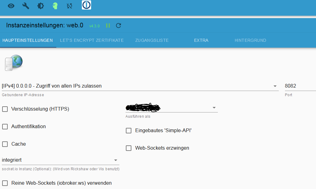

                            Albert K @WolfgangFB last edited by Albert K
                              Andersmacher @WolfgangFB last edited by
