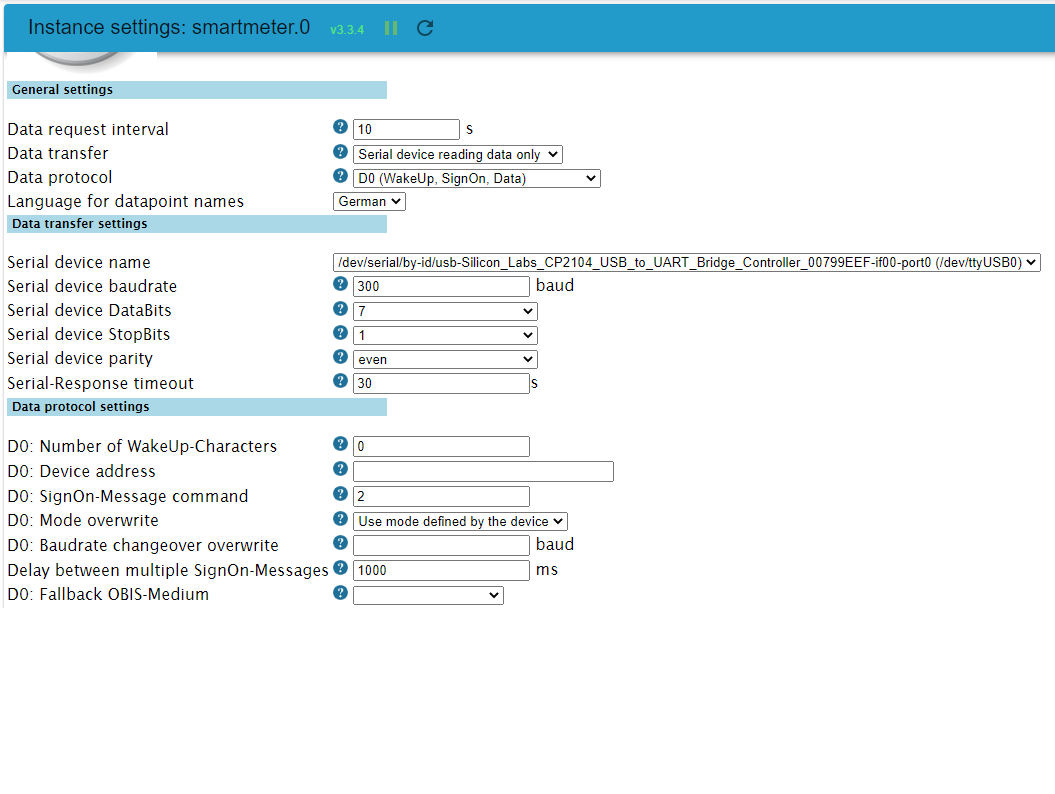

      Die smartmeter instanz hatte anfangs in der dropdown List nur /dev/ttyUSB0, damit sah der debug output grundsätzlich so aus:

              Wenn man alle serverseitigen Ursachen ausschließen kann, brauchen wir deine Konfiguration

                                  @petlaw sagte in Smartmeter Elster AS1440:
                                  sudo iobroker restart
                                  Und pack niemals das Kommando 'iobroker' zusammen mit 'sudo' an.
                                  iob stop
                                  iob fix
                                  iob start
                                  iob diag
                                  Ausgaben von iob diag bitte posten.
                                    petlaw @Thomas Braun last edited by petlaw
                                    @thomas-braun said in Smartmeter Elster AS1440:
                                    Sir, jawohl, Sir 😉
                                    iob stop
                                    iob fix
                                    iob start
                                    iob diag

                                    2023-05-11 11:47:42.529  - debug: smartmeter.0 (10177) SERIALPORT CLOSE
                                    2023-05-11 11:47:42.530  - debug: smartmeter.0 (10177) SCHEDULE NEXT RUN IN 30s
                                    2023-05-11 11:48:12.531  - debug: smartmeter.0 (10177) CREATE SERIALPORT: 300 7 1 even
                                    2023-05-11 11:48:12.534  - debug: smartmeter.0 (10177) SERIALPORT OPEN
                                    2023-05-11 11:48:12.536  - debug: smartmeter.0 (10177) SET MESSAGE TIMEOUT TIMER: 30000
                                    2023-05-11 11:48:42.537  - debug: smartmeter.0 (10177) MESSAGE TIMEOUT TRIGGERED
                                    2023-05-11 11:48:42.538  - debug: smartmeter.0 (10177) Error: No or too long answer from Serial Device after last request.
                                    2023-05-11 11:48:42.538  - warn: smartmeter.0 (10177) No or too long answer from Serial Device after last request.
                                    2023-05-11 11:48:42.539  - debug: smartmeter.0 (10177) Transport Reset!! Restart = true
                                    2023-05-11 11:48:42.541  - debug: smartmeter.0 (10177) SERIALPORT CLOSE
                                    2023-05-11 11:48:42.542  - debug: smartmeter.0 (10177) SCHEDULE NEXT RUN IN 30s
                                    2023-05-11 11:49:12.543  - debug: smartmeter.0 (10177) CREATE SERIALPORT: 300 7 1 even
                                    2023-05-11 11:49:12.545  - debug: smartmeter.0 (10177) SERIALPORT OPEN
                                    2023-05-11 11:49:12.547  - debug: smartmeter.0 (10177) SET MESSAGE TIMEOUT TIMER: 30000
                                    2023-05-11 11:49:42.547  - debug: smartmeter.0 (10177) MESSAGE TIMEOUT TRIGGERED
                                    2023-05-11 11:49:42.548  - debug: smartmeter.0 (10177) Error: No or too long answer from Serial Device after last request.
                                    2023-05-11 11:49:42.548  - warn: smartmeter.0 (10177) No or too long answer from Serial Device after last request.
                                    2023-05-11 11:49:42.549  - debug: smartmeter.0 (10177) Error: No or too long answer from Serial Device after last request.

                                      Thomas Braun Most Active @petlaw last edited by
                                      Setz den user 'peter' in die Gruppe 'adm' rein, dann kann der auch logs lesen und du brauchst da keine root-Rechte.
                                      Schalt den Desktop/X-Server aus.
                                      Hit:7 https://repos.influxdata.com/debian stable InRelease
                                      Da ist eine Doublette, vermutich hast du zwei .list-Files zu influx in /etc/apt/sources.list.d/ liegen. Lösche die mit dem Eintrag 'stable'.
                                      Zu deinem eigentlichen Problem mit dem SerialPort fällt mir aber nix ein.
                                        Erledigt.

                                        Im gegensatz zu socat:
                                        stat("/dev/ttyUSB0", {st_mode=S_IFCHR|0777, st_rdev=makedev(0xbc, 0), ...}) = 0
                                        openat(AT_FDCWD, "/dev/ttyUSB0", O_RDWR|O_APPEND) = 5
                                          Homoran Global Moderator Administrators @petlaw last edited by
                                          dann hat socat die noch nicht freigegeben
                                          oder die Konfiguration im Adapter passt nicht
                                            petlaw @Homoran last edited by
                                            @homoran said in Smartmeter Elster AS1440:
                                            Der Adapter versucht es ja noch nicht einmal.
                                            Es gibt keinen system call open auf irgendwas unterhalb von /dev, weder ttyUSB0 noch den unter /dev/serial/by-id
                                            Wenn da was schief wäre müsste er ja wenigstens einen Versuch (mit einem falschen Device namen oä) machen, oder ?
