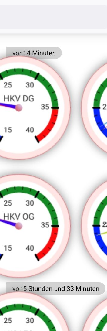

          Sieht dann z,b. so aus

            Ich hab das so noch nie probiert. Ist aber genau das, was ich gesucht hab - auch wenn das Format nicht das ist was ich mir vorgestellt hab.
            statt "vor 39 Minuten" hätte ich gerne "seit 00:39 Std" oder auch nur "00:39" - aber das wird wohl nicht gehen, oder habt ihr hierfür auch eine Lösung?

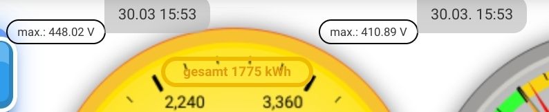

              ich glaube du könntest noch den Timestamp anzeigen, ist aber doch erst recht nicht was du wolltest.

                @rtwl sowas z.b.
                widget
                [{"tpl":"tplValueLastchange","data":{"oid":"zigbee.0.00158d00052da0d3.opened","g_fixed":false,"g_visibility":false,"g_css_font_text":true,"g_css_background":true,"g_css_shadow_padding":true,"g_css_border":true,"g_gestures":false,"g_signals":false,"g_last_change":false,"visibility-cond":"==","visibility-val":1,"visibility-groups-action":"hide","signals-cond-0":"==","signals-val-0":true,"signals-icon-0":"/vis/signals/lowbattery.png","signals-icon-size-0":0,"signals-blink-0":false,"signals-horz-0":0,"signals-vert-0":0,"signals-hide-edit-0":false,"signals-cond-1":"==","signals-val-1":true,"signals-icon-1":"/vis/signals/lowbattery.png","signals-icon-size-1":0,"signals-blink-1":false,"signals-horz-1":0,"signals-vert-1":0,"signals-hide-edit-1":false,"signals-cond-2":"==","signals-val-2":true,"signals-icon-2":"/vis/signals/lowbattery.png","signals-icon-size-2":0,"signals-blink-2":false,"signals-horz-2":0,"signals-vert-2":0,"signals-hide-edit-2":false,"lc-type":"last-change","lc-is-interval":true,"lc-is-moment":false,"lc-format":"","lc-position-vert":"top","lc-position-horz":"right","lc-offset-vert":0,"lc-offset-horz":0,"lc-font-size":"12px","lc-font-family":"","lc-font-style":"","lc-bkg-color":"","lc-color":"","lc-border-width":"0","lc-border-style":"","lc-border-color":"","lc-border-radius":10,"lc-zindex":0,"format_date":"DD.MM.YYYY - hh:mm:ss Uhr","html_prepend":"Fenster zuletzt geöffnet am &nbsp","html_append":""},"style":{"left":"769px","top":"176px","z-index":"10","width":"454px","height":"30px","color":"","font-family":"Jura-DemiBold","text-align":"right","line-height":"2","background":"","background-color":"","border-width":"","border-style":"","border-radius":"","border-color":"","box-shadow":""},"widgetSet":"basic"}]
