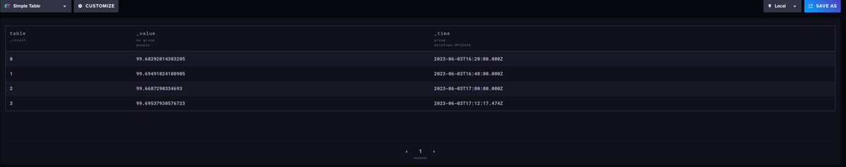

        Dann kommen diese Werte raus,
        Wenn ich den Mittelwert einfüge,
        from(bucket: "oss_metrics")
          |> range(start: v.timeRangeStart, stop: v.timeRangeStop)
          |> filter(fn: (r) => r["_measurement"] == "cpu")
          |> filter(fn: (r) => r["_field"] == "usage_idle")
          |> filter(fn: (r) => r["cpu"] == "cpu0" or r["cpu"] == "cpu1" or r["cpu"] == "cpu2" or r["cpu"] == "cpu3")
          |> aggregateWindow(every: 20m, fn: median, createEmpty: false)
          //|> yield(name: "mean")
          |> group(columns: ["_time"])
          |> mean(column: "_value")              //mit mittelwert
        Dann bekomme ich,
