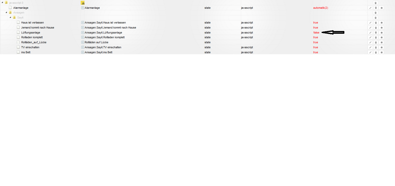

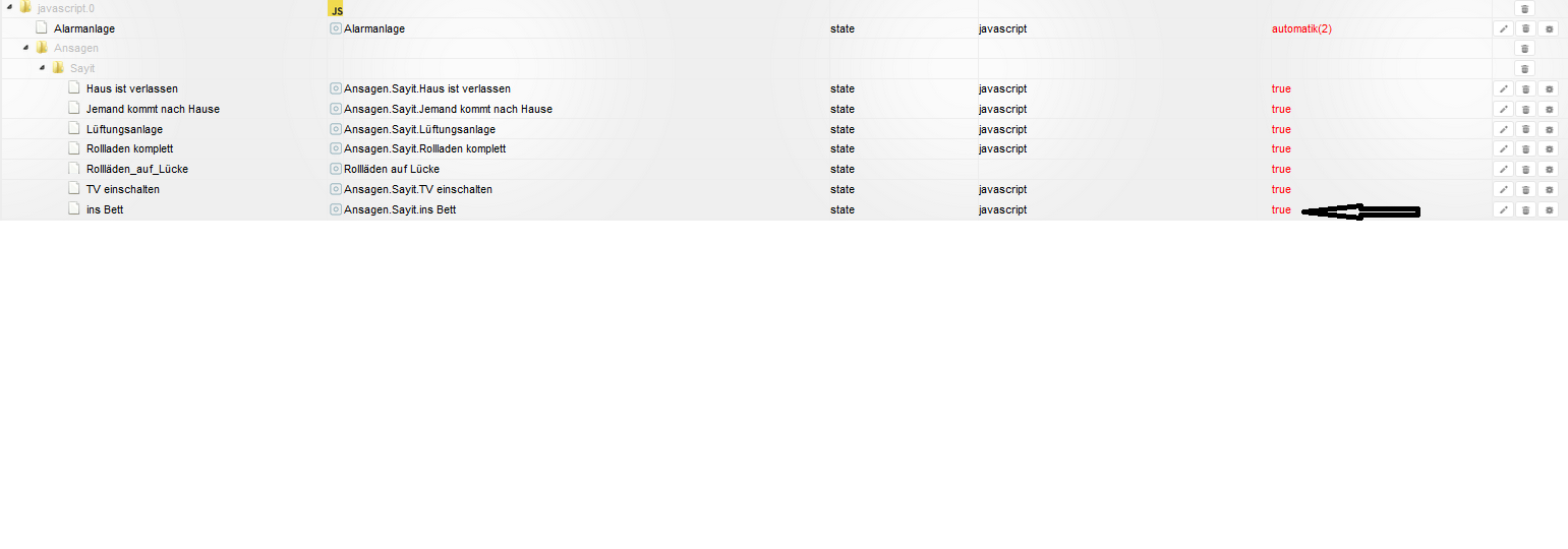

      Dieses funktioniert leider aber nur teilweise. Wenn ich den Button "ab ins Bett" unter Ansagen auf "aus" stelle, ändert sich die Variable leider nicht mit.
      (Hier der Button der keine Funktion auslöst!)
      (keine Änderung der Varaible egal ob Button an/aus)
      Und nun das komische ein genau gleich konfigurierter Button "Lüftung" funktioniert einwandfrei.
      (Hier der Button der einwandfrei funktioniert)

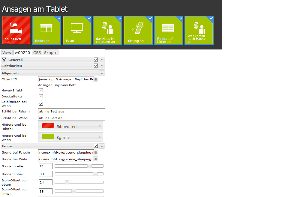

      Hier noch der Code von Widget "ab ins Bett"
      [{"tpl":"tplMetroTileToggle","data":{"hm_id":65535,"digits":"","factor":1,"min":0,"max":1,"step":0.01,"hover":"true","transform":"true","icon_class_true":"","icon_class_false":"","icon_badge_true":"","icon_badge_false":"","bg_class_true":"bg-lime","bg_class_false":"ribbed-red","badge_bg_class_true":"","badge_bg_class_false":"","brand_bg_class_true":"","brand_bg_class_false":"","label_true":"ab ins Bett an","label_false":"ab ins Bett aus","icon_false":"/icons-mfd-svg/scene_sleeping.svg","icon_true":"/icons-mfd-svg/scene_sleeping.svg","select_on_true":true,"toggle_oid":"200002","visibility-cond":"==","visibility-val":1,"oid":"javascript.0.Ansagen.Sayit.ins Bett","icon_width":"71","icon_height":"83","icon_top":"24","icon_left":"38","badge_top":"0","badge_left":"0","signals-cond-0":"==","signals-val-0":true,"signals-icon-0":"/vis/signals/lowbattery.png","signals-icon-size-0":0,"signals-blink-0":false,"signals-horz-0":0,"signals-vert-0":0,"signals-hide-edit-0":false,"signals-cond-1":"==","signals-val-1":true,"signals-icon-1":"/vis/signals/lowbattery.png","signals-icon-size-1":0,"signals-blink-1":false,"signals-horz-1":0,"signals-vert-1":0,"signals-hide-edit-1":false,"signals-cond-2":"==","signals-val-2":true,"signals-icon-2":"/vis/signals/lowbattery.png","signals-icon-size-2":0,"signals-blink-2":false,"signals-horz-2":0,"signals-vert-2":0,"signals-hide-edit-2":false,"visibility-groups-action":"hide","visibility-oid":""},"style":{"left":"148px","top":"170px","width":"115px","height":"115px"},"widgetSet":"metro"}]
      Hier noch der Code von Widget "Lüftung"
      [{"tpl":"tplMetroTileToggle","data":{"hm_id":65535,"digits":"","factor":1,"min":0,"max":1,"step":0.01,"hover":"true","transform":"true","icon_class_true":"","icon_class_false":"","icon_badge_true":"","icon_badge_false":"","bg_class_true":"bg-lime","bg_class_false":"ribbed-red","badge_bg_class_true":"","badge_bg_class_false":"","brand_bg_class_true":"","brand_bg_class_false":"","label_true":"Lüftung an","label_false":"Lüftung aus","icon_false":"/icons-mfd-svg/vent_air_filter.svg","icon_true":"/icons-mfd-svg/vent_air_filter.svg","select_on_true":true,"toggle_oid":"200002","visibility-cond":"==","visibility-val":1,"oid":"javascript.0.Ansagen.Sayit.Lüftungsanlage","icon_width":"71","icon_height":"83","icon_top":"24","icon_left":"38","badge_top":"0","badge_left":"0","signals-cond-0":"==","signals-val-0":true,"signals-icon-0":"/vis/signals/lowbattery.png","signals-icon-size-0":0,"signals-blink-0":false,"signals-horz-0":0,"signals-vert-0":0,"signals-hide-edit-0":false,"signals-cond-1":"==","signals-val-1":true,"signals-icon-1":"/vis/signals/lowbattery.png","signals-icon-size-1":0,"signals-blink-1":false,"signals-horz-1":0,"signals-vert-1":0,"signals-hide-edit-1":false,"signals-cond-2":"==","signals-val-2":true,"signals-icon-2":"/vis/signals/lowbattery.png","signals-icon-size-2":0,"signals-blink-2":false,"signals-horz-2":0,"signals-vert-2":0,"signals-hide-edit-2":false,"visibility-groups-action":"hide","visibility-oid":""},"style":{"left":"656px","top":"170px","width":"115px","height":"115px"},"widgetSet":"metro"}]

        es ist nicht gleich konfiguriert wie Lüftung
        ins Bett
        mach bitte folgendes ..
        erzeuge die Variable neu aber so ins_Bett ( also ohne Leerzeichen mit Unterstrich)
