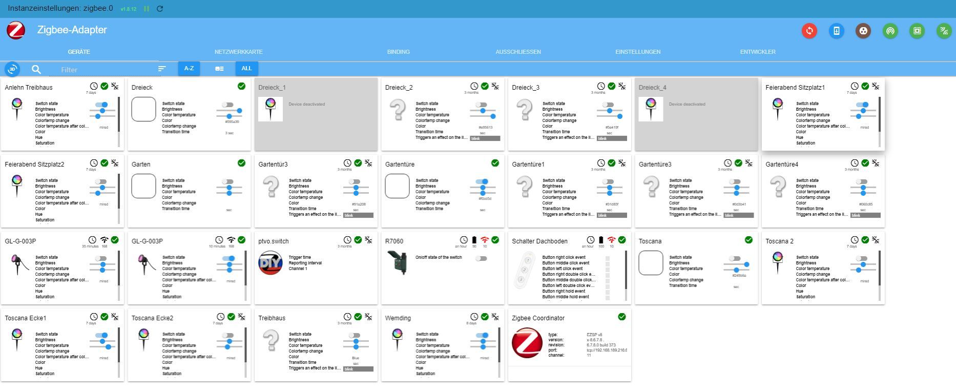

                          HelmutLinner last edited by HelmutLinner
                          @arteck
                          das steht in der shepherd.db
                          {"id":1,"type":"Coordinator","ieeeAddr":"0x84b4dbfffee344a4","nwkAddr":0,"manufId":0,"epList":[1,242],"endpoints":{"1":{"profId":260,"epId":1,"devId":48879,"inClusterList":[0,3,6,10,25,26,768],"outClusterList":[0,3,4,5,6,8,32,768,1024,1026,1029,1030,1280,2817,2819,2820,1794,4096,64513,64514],"clusters":{},"binds":[],"configuredReportings":[],"meta":{}},"242":{"profId":41440,"epId":242,"devId":97,"inClusterList":[],"outClusterList":[33],"clusters":{},"binds":[],"configuredReportings":[],"meta":{}}},"interviewCompleted":true,"meta":{},"lastSeen":1688373790062,"defaultSendRequestWhen":"immediate"}
                          {"id":2,"type":"Group","groupID":3,"members":[],"meta":{}}
                          {"id":3,"type":"Group","groupID":2,"members":[],"meta":{}}
                          {"id":4,"type":"Router","ieeeAddr":"0x540f57fffe96bd34","nwkAddr":33076,"manufId":4687,"manufName":"GLEDOPTO","powerSource":"Mains (single phase)","modelId":"GL-G-003P","epList":[11,242],"endpoints":{"11":{"profId":260,"epId":11,"devId":269,"inClusterList":[0,3,4,5,6,8,768,4096],"outClusterList":[25],"clusters":{"genBasic":{"attributes":{"modelId":"GL-G-003P","manufacturerName":"GLEDOPTO","powerSource":0,"zclVersion":3,"appVersion":0,"stackVersion":0,"hwVersion":2,"dateCode":"20221220","swBuildId":"11376801"}},"lightingColorCtrl":{"attributes":{"colorCapabilities":31,"colorTempPhysicalMin":158,"colorTempPhysicalMax":495}},"genOnOff":{"attributes":{"onOff":1}}},"binds":[],"configuredReportings":[],"meta":{}},"242":{"profId":41440,"epId":242,"devId":97,"inClusterList":[],"outClusterList":[33],"clusters":{},"binds":[],"configuredReportings":[],"meta":{}}},"appVersion":0,"stackVersion":0,"hwVersion":2,"dateCode":"20221220","swBuildId":"11376801","zclVersion":3,"interviewCompleted":true,"meta":{"configured":88764544},"lastSeen":1688373695063,"defaultSendRequestWhen":"immediate"}
                          {"id":5,"type":"Group","groupID":1,"members":[],"meta":{}}
                          {"id":6,"type":"Router","ieeeAddr":"0x540f57fffe96bd40","nwkAddr":36214,"manufId":4687,"manufName":"GLEDOPTO","powerSource":"Mains (single phase)","modelId":"GL-G-003P","epList":[11,242],"endpoints":{"11":{"profId":260,"epId":11,"devId":269,"inClusterList":[0,3,4,5,6,8,768,4096],"outClusterList":[25],"clusters":{"genBasic":{"attributes":{"modelId":"GL-G-003P","manufacturerName":"GLEDOPTO","powerSource":0,"zclVersion":3,"appVersion":0,"stackVersion":0,"hwVersion":2,"dateCode":"20221220","swBuildId":"11376801"}},"lightingColorCtrl":{"attributes":{"colorCapabilities":31,"colorTempPhysicalMin":158,"colorTempPhysicalMax":495}},"genOnOff":{"attributes":{"onOff":0}}},"binds":[],"configuredReportings":[],"meta":{}},"242":{"profId":41440,"epId":242,"devId":97,"inClusterList":[],"outClusterList":[33],"clusters":{},"binds":[],"configuredReportings":[],"meta":{}}},"appVersion":0,"stackVersion":0,"hwVersion":2,"dateCode":"20221220","swBuildId":"11376801","zclVersion":3,"interviewCompleted":true,"meta":{"configured":88764544},"lastSeen":1688373696601,"defaultSendRequestWhen":"immediate"}
                          {"id":7,"type":"EndDevice","ieeeAddr":"0x003c84fffe09bd3e","nwkAddr":7235,"manufId":4098,"manufName":"_TZ3210_eymunffl","powerSource":"Battery","modelId":"TS0101","epList":[1],"endpoints":{"1":{"profId":260,"epId":1,"devId":81,"inClusterList":[0,4,5,6,61184,1],"outClusterList":[25,10],"clusters":{"genBasic":{"attributes":{"65534":0,"modelId":"TS0101","manufacturerName":"_TZ3210_eymunffl","powerSource":3,"zclVersion":3,"appVersion":69,"stackVersion":0,"hwVersion":1,"dateCode":""}},"genOnOff":{"attributes":{"onOff":0,"offWaitTime":0,"onTime":0}}},"binds":[],"configuredReportings":[],"meta":{}}},"appVersion":69,"stackVersion":0,"hwVersion":1,"dateCode":"","zclVersion":3,"interviewCompleted":true,"meta":{"configured":-708457359},"lastSeen":1688368812322,"defaultSendRequestWhen":"immediate"}
                          {"id":8,"type":"EndDevice","ieeeAddr":"0x943469fffebad813","nwkAddr":50679,"manufId":4098,"manufName":"_TZ3000_gbm10jnj","powerSource":"Battery","modelId":"TS0043","epList":[1,2,3],"endpoints":{"1":{"profId":260,"epId":1,"devId":0,"inClusterList":[0,1,6],"outClusterList":[25,10],"clusters":{"genBasic":{"attributes":{"65503":"\u0000\u0000\u0000\u0000\u0012�<3,\u0012","65506":31,"65508":0,"65534":0,"modelId":"TS0043","manufacturerName":"_TZ3000_gbm10jnj","powerSource":3,"zclVersion":3,"stackVersion":0,"hwVersion":1,"dateCode":"","appVersion":66}},"genPowerCfg":{"attributes":{"batteryPercentageRemaining":200,"batteryVoltage":30}}},"binds":[],"configuredReportings":[],"meta":{}},"2":{"profId":260,"epId":2,"devId":0,"inClusterList":[1,6],"outClusterList":[],"clusters":{},"binds":[],"configuredReportings":[],"meta":{}},"3":{"profId":260,"epId":3,"devId":0,"inClusterList":[1,6],"outClusterList":[],"clusters":{},"binds":[],"configuredReportings":[],"meta":{}}},"appVersion":66,"stackVersion":0,"hwVersion":1,"dateCode":"","zclVersion":3,"interviewCompleted":true,"meta":{"configured":-708457359},"lastSeen":1688348249457,"defaultSendRequestWhen":"immediate"}
                          Das sind die Zigbee Geräte dazu
                            arteck Developer Most Active @HelmutLinner last edited by arteck
                            @helmutlinner 84b4dbfffee344a4 ist der koordinator....ach das ist so ein ezsp..
                            muss ich mal schauen das der erkannt wird..
                            es knalt schon mal nicht ...das ist schon mal gut

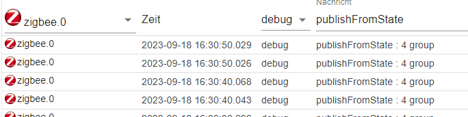

                            kannst du mal den adapter auf debug stellen und im Log nach
                            publishFromState
                            suchen und mir mal posten
                              HelmutLinner @arteck last edited by
                              @arteck im log steht publishFromState : 3 group
                              Zeile 111

                                  HelmutLinner @arteck last edited by HelmutLinner
                                  @arteck ich hab die einige Male bekommen und jedes Mal stand publishFromState : 3 group
                                  wenn ich nach publishfromstate filtere im log kommt:
                                  zigbee.0
                                  2023-07-05 13:42:20.041	debug	publishFromState : 3 group
                                  zigbee.0
                                  2023-07-05 13:42:10.065	debug	publishFromState : 3 group
                                  zigbee.0
                                  2023-07-05 13:42:00.583	debug	publishFromState : 3 group
                                  zigbee.0
                                  2023-07-05 13:41:50.072	debug	publishFromState : 3 group
                                  zigbee.0
                                  2023-07-05 13:41:40.083	debug	publishFromState : 3 group
                                  zigbee.0
                                  2023-07-05 13:41:30.593	debug	publishFromState : 3 group
                                  zigbee.0
                                  2023-07-05 13:41:20.026	debug	publishFromState : 3 group
                                  zigbee.0
                                  2023-07-05 13:41:10.045	debug	publishFromState : 3 group
                                  zigbee.0
                                  2023-07-05 13:41:00.287	debug	publishFromState : 3 group
                                  zigbee.0
                                  2023-07-05 13:40:50.737	debug	publishFromState : 3 group
                                  zigbee.0
                                  2023-07-05 13:40:40.033	debug	publishFromState : 3 group
                                  zigbee.0
                                  2023-07-05 13:40:30.093	debug	publishFromState : 3 group
                                  zigbee.0
                                  2023-07-05 13:40:20.081	debug	publishFromState : 3 group
                                  zigbee.0
                                  2023-07-05 13:40:10.070	debug	publishFromState : 3 group
                                  zigbee.0
                                  2023-07-05 13:40:00.159	debug	publishFromState : 3 group
                                  zigbee.0
                                  2023-07-05 13:39:50.037	debug	publishFromState : 3 group
                                  zigbee.0
                                  2023-07-05 13:39:40.040	debug	publishFromState : 3 group
                                  zigbee.0
                                  2023-07-05 13:39:30.243	debug	publishFromState : 3 group
                                  zigbee.0
                                  2023-07-05 13:39:20.025	debug	publishFromState : 3 group
                                    @arteck
                                    die Meldung kommt öfter aber immer gleicher text
                                    836
