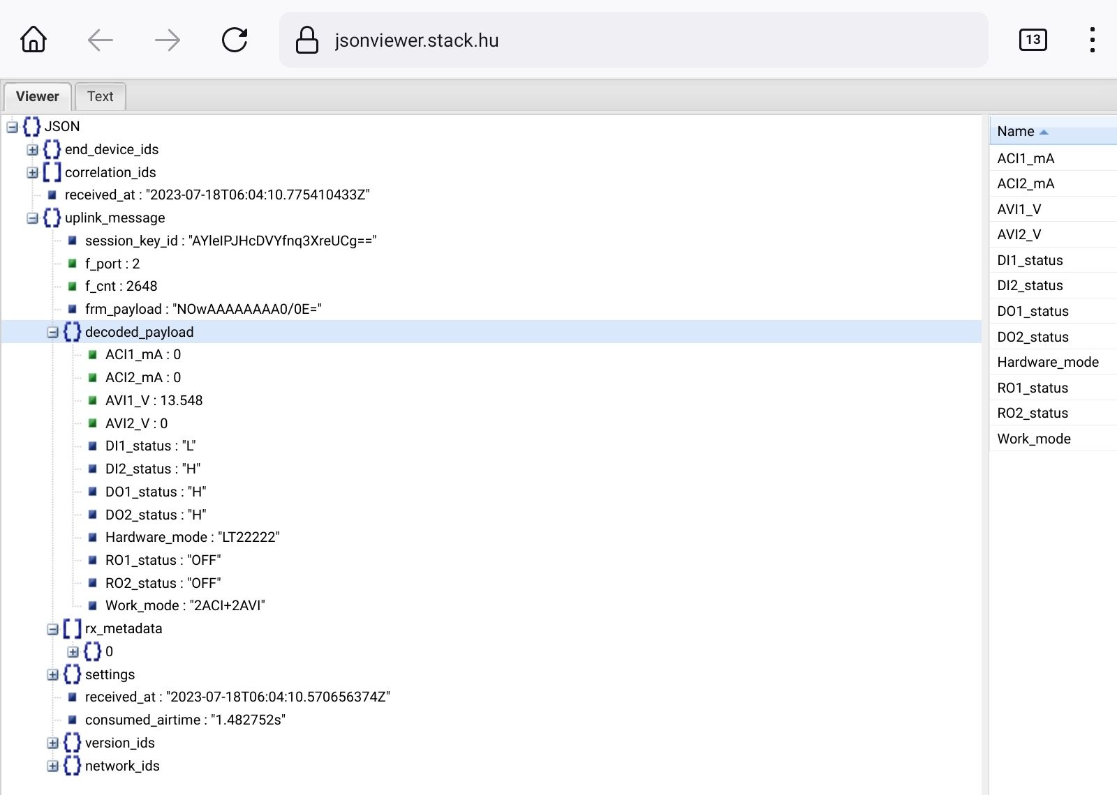

      ich habe nun mein LoRaWan erfolgreich in Betrieb genommen.
      Folgendes Payload bekomme ich vom Gateway:
       ... /HandleUplink:01H5FA9TDQNKAJE50A140RA48P"],"received_at":"2023-07-16T12:20:13.367814098Z","uplink_message":{"session_key_id":"AYleIPJHcDVYfnq3XreUCg==","f_port":2,"f_cnt":144,"frm_payload":"NdgAAAAAAAA0/0E=","decoded_payload":{"ACI1_mA":0, "ACI2_mA":0, "AVI1_V":13.784, "AVI2_V":0, "DI1_status":"L", "DI2_status":"H", "DO1_status":"H", "DO2_status":"H", "Hardware_mode":"LT22222", "%(#ff0000)[RO1_status":"OFF", "RO2_status":"OFF]", "Work_mode":"2ACI+2AVI"},"rx_metadata":[{"gateway_ids":{"gateway_id":"eui-7076ff0056080b0f","eui":"7076FF0056080B0F"},"time":"2023-07-16T12:20:13.072Z","timestamp":3188114652,"rssi":cl:
      Wie kann ich die Daten nach ACI1 ACI2 AVI1 AVI2 DI1 DI2 usw. in Blockly aufschlüsseln und in Variablen schreiben?
      Ausserdem benötige hierzu noch den Timestamp.
      JS kann ich leider nicht.

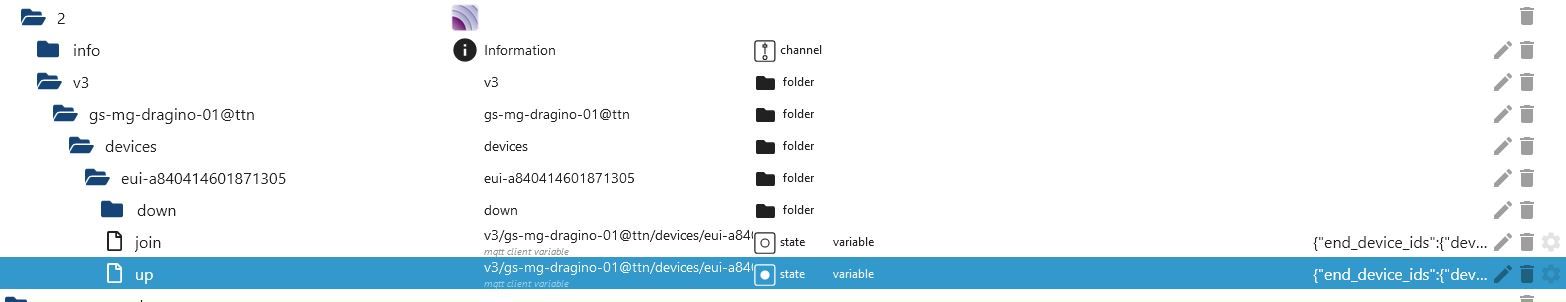

        Homoran Global Moderator Administrators @GregorS last edited by
        @gregors sagte in Payload Daten in Objekte schreiben:
        ist das vollständig?
        wo kommt das hin? Liegt es in einem Datenpunkt?

          • GregorS
            GregorS @Homoran last edited by
            Nein, ist nicht vollständig. Habe nur die relevanten Infos rauskopiert.
            Sie liegt in einem JSON-File.

                  Hier das komplette JSON:
                  {"end_device_ids":{"device_id":"eui-xxxxxxxxxxxxxxxxxxx","application_ids":{"application_id":"gs-mg-dragino-01"},"dev_eui":"xxxxxxxxxxxxxxxxxxx","join_eui":"yyyyyyyyyyyyyyyyyyy","dev_addr":"zzzzzzzzz"},"correlation_ids":["as:up:01H5KSJPMRECPFW9X31X3RZVV2","gs:conn:01H4KAYPR4MRPH50CJE9DZ7YHC","gs:up:host:01H4KAYPRB2CYT22K4H1T83DQS","gs:uplink:01H5KSJPE94D98RBTM11WVQ1SY","ns:uplink:01H5KSJPEA3KC8FPJJSHNZ1QQX","rpc:/ttn.lorawan.v3.GsNs/HandleUplink:01H5KSJPEAS7598TVH1ZPW5BJ8","rpc:/ttn.lorawan.v3.NsAs/HandleUplink:01H5KSJPMQT2K85MP8BY0FY6SN"],"received_at":"2023-07-18T06:04:10.775410433Z","uplink_message":{"session_key_id":"AYleIPJHcDVYfnq3XreUCg==","f_port":2,"f_cnt":2648,"frm_payload":"NOwAAAAAAAA0/0E=","decoded_payload":{"ACI1_mA":0, "ACI2_mA":0, "AVI1_V":13.548, "AVI2_V":0, "DI1_status":"L", "DI2_status":"H", "DO1_status":"H", "DO2_status":"H", "Hardware_mode":"LT22222", "RO1_status":"OFF", "RO2_status":"OFF", "Work_mode":"2ACI+2AVI"},"rx_metadata":[{"gateway_ids":{"gateway_id":"eui-7076ff0056080b0f","eui":"7076FF0056080B0F"},"time":"2023-07-18T06:04:10.444Z","timestamp":3101631076,"rssi":-116,"channel_rssi":-116,"snr":-9.5,"uplink_token":"CiIKIAoUZXVpLTcwNzZmZjAwNTYwODBiMGYSCHB2/wBWCAsPEOTE/MYLGgwI2tbYpQYQk7fJjwIgoK35vKLj9wEqDAja1tilBhCAztvTAQ==","channel_index":7,"gps_time":"2023-07-18T06:04:10.444Z","received_at":"2023-07-18T06:04:10.277432218Z"}],"settings":{"data_rate":{"lora":{"bandwidth":125000, "spreading_factor":12, "coding_rate":"4/5"}}, "frequency":"868500000", "timestamp":3101631076, "time":"2023-07-18T06:04:10.444Z"},"received_at":"2023-07-18T06:04:10.570656374Z","consumed_airtime":"1.482752s","version_ids":{"brand_id":"dragino", "model_id":"lt22222-l", "hardware_version":"_unknown_hw_version_", "firmware_version":"1.5.6", "band_id":"EU_863_870"},"network_ids":{"net_id":"000013","tenant_id":"ttn","cluster_id":"eu1","cluster_address":"eu1.cloud.thethings.network"}}}
                  Bei jeder neuen Meldung kommt ein neues JSON-File mit aktualisierten Daten.

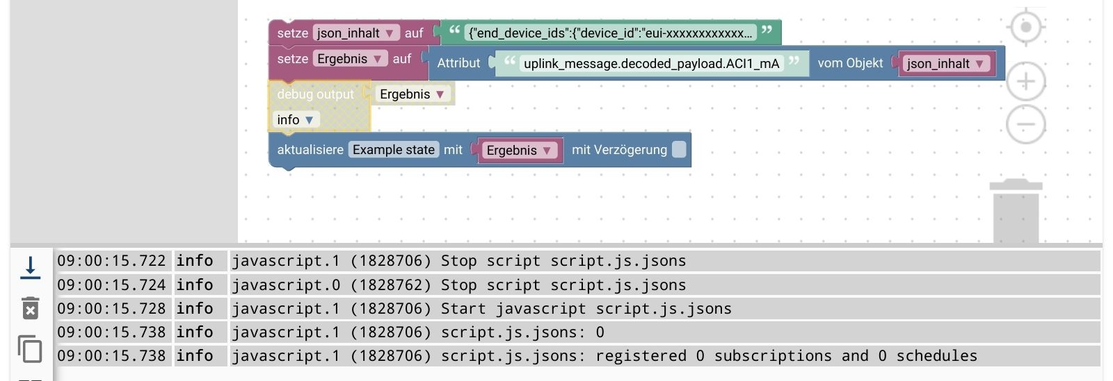

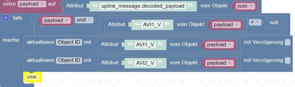

                        Homoran Global Moderator Administrators @Homoran last edited by Homoran
                        @homoran sagte in Payload Daten in Objekte schreiben:
                        wenn ja, triggerst du auf diesen DP bei Änderung.
                        Zerlegst den Inhalt des DP mit Attribut von.. und dem "Pfad zum Wert", z.b. uplink_message.decoded_payload.ACI1_mA
                        das schreibst du dann in deinen selbst angelegten Datenpunkt.
                        ich habe hier das json als Text eingefügt und das Ergebnis als debug ausgegeben.
                        du müsstest mit dem Wert des JSON DP arbeiten und unten die ID des DP für di ACI1 einsetzen

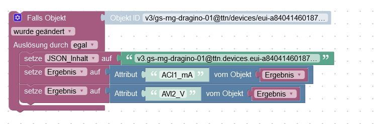

                                  Leider hat es nicht funktioniert.
                                  Beim Blockly kommen folgende Fehlermeldungen:
                                  avascript.0
                                  	2023-07-20 18:55:46.674	error	script.js.LoRaWAN_DEV_1: Cannot get AVI2_V of null
                                  javascript.0
                                  	2023-07-20 18:55:46.674	error	script.js.LoRaWAN_DEV_1: Cannot get ACI1_mA of undefined
                                  javascript.0
                                  	2023-07-20 18:53:46.292	error	script.js.LoRaWAN_DEV_1: Cannot get AVI2_V of null
                                  javascript.0
                                  	2023-07-20 18:53:46.292	error	script.js.LoRaWAN_DEV_1: Cannot get ACI1_mA of null
                                  javascript.0
                                  	2023-07-20 18:52:46.262	error	script.js.LoRaWAN_DEV_1: Cannot get AVI2_V of null
                                  javascript.0
                                  	2023-07-20 18:52:46.261	error	script.js.LoRaWAN_DEV_1: Cannot get ACI1_mA of undefined
                                    Hast du die Überprüfung, ob der Inhalt existiert nicht umgesetzt?

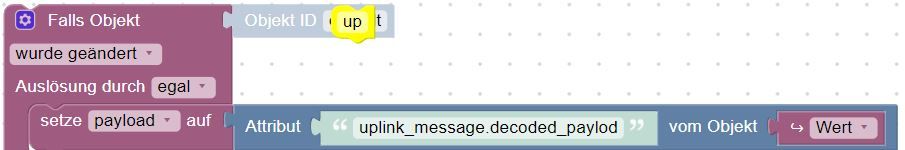

                                      Komme mit mit Blockly nicht klar.
                                      Muss ich die Variablen "payload","jason" vorher erstellen? Wo?
                                      Muss ich im Attribut "uplink_message...." den Pfad zu meinem Objekt reinkopieren?
                                      So sieht meine Struktur aus:
                                      Ich sende keine Befehle, sondern empfange nur welche von LoRaWan.
                                      Muss ich trotzdem die Abfrage machen?
                                      Irgendwie bin ich dazu zu blöd.
                                        paul53 @GregorS last edited by paul53
                                        @gregors sagte: Muss ich die Variablen "payload","jason" vorher erstellen? Wo?
                                        Die Variable payload muss unter "Variablen" erstellt werden.
                                        Der Datenpunkt "up" dient als Trigger:
                                        Wert findet man unter "Trigger".

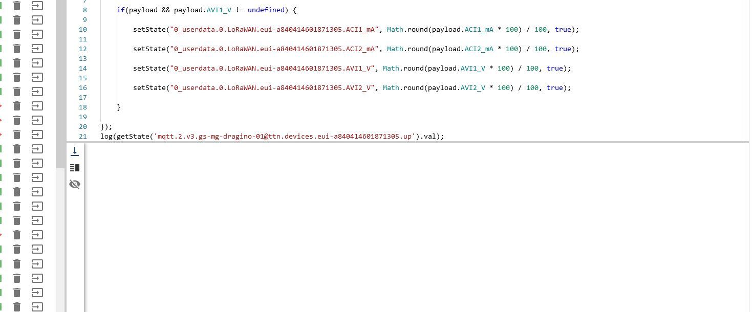

                                          @gregors sagte: Brauche da wohl ein bisschen Nachilfe.
                                          const idUp = 'mqtt.2.v3.gs-mg-dragino-01@ttn.devices.eui-a840414601871305.up'/*v3/gs-mg-dragino-01@ttn/devices/eui-a840414601871305/up*/;
                                          on(idUp, function (dp) {
                                              let payload = JSON.parse(dp.state.val).uplink_message.decoded_paylod;
                                              if(payload && payload.AVI1_V != undefined) {
                                                  setState("0_userdata.0.LoRaWAN.eui-a840414601871305.ACI_1", Math.round(payload.ACI1_mA * 100) / 100, true);
                                                  setState("0_userdata.0.LoRaWAN.eui-a840414601871305.ACI_2", Math.round(payload.ACI2_mA * 100) / 100, true);
                                                  setState("0_userdata.0.LoRaWAN.eui-a840414601871305.AVI_1", Math.round(payload.AVI1_V * 100) / 100, true);
                                                  setState("0_userdata.0.LoRaWAN.eui-a840414601871305.AVI_2", Math.round(payload.AVI2_V * 100) / 100, true);
                                          Zum Triggern muss die DP-ID - nicht der DP-Name - verwendet werden.

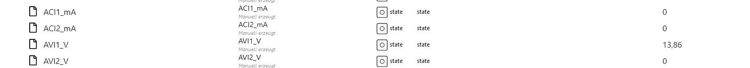

                                          • GregorS
                                            Habe ich ausprobiert.
                                            Keine Fehler mehr, aber es wird nichts in die Objekte geschrieben.
