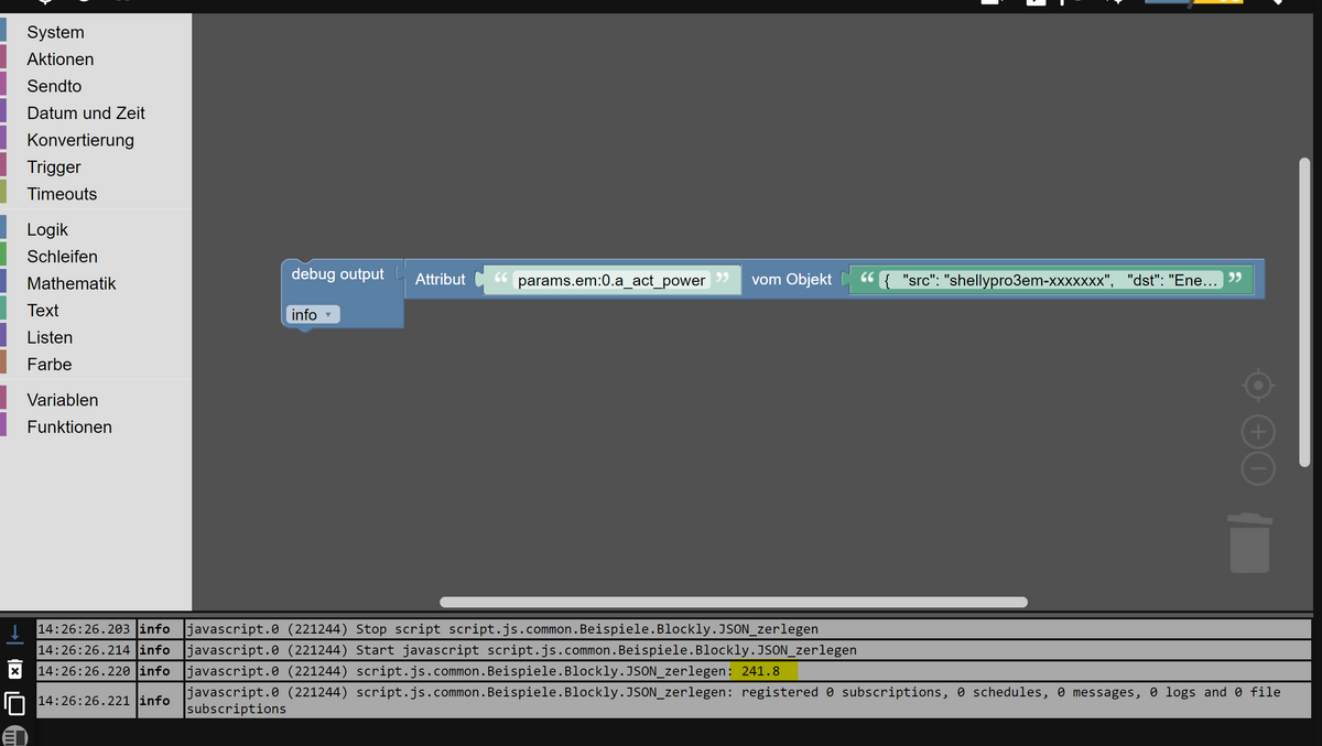

        @jkret sagte in JSON Datenpunkt auslesen - Problem : Doppelpunkt im Namen:
                                                                                                                                    {                                                                                                                                                                              "src": "shellypro3em-xxxxxxx",                                                                                                                                                                              "dst": "EnergieSP3/events",                                                                                                                                                                              "method": "NotifyStatus",                                                                                                                                                                              "params": {                                                                                                                                                                                "ts": 1690027815.41,                                                                                                                                                                                "em:0": {                                                                                                                                                                                  "id": 0,                                                                                                                                                                                  "a_act_power": 241.8,                                                                                                                                                                                  "a_aprt_power": 378.2,                                                                                                                                                                                  "a_current": 1.607,                                                                                                                                                                                  "a_pf": -0.73,                                                                                                                                                                                  "a_voltage": 235.5,                                                                                                                                                                                  "b_act_power": 168.9,                                                                                                                                                                                  "b_aprt_power": 262.1,                                                                                                                                                                                  "b_current": 1.113,                                                                                                                                                                                  "b_pf": -0.74,                                                                                                                                                                                  "b_voltage": 235.5,                                                                                                                                                                                  "c_act_power": 71,                                                                                                                                                                                  "c_aprt_power": 107.7,                                                                                                                                                                                  "c_current": 0.458,                                                                                                                                                                                  "c_pf": -0.74,                                                                                                                                                                                  "c_voltage": 235.5,                                                                                                                                                                                  "n_current": null,                                                                                                                                                                                  "total_act_power": 481.782,                                                                                                                                                                                  "total_aprt_power": 748.067,                                                                                                                                                                                  "total_current": 3.178                                                                                                                                                                                }                                                                                                                                                                              }                                                                                                                                                                            }
        Ich seh da kein Problem:
         <block type="debug" id="r_zY,-uZU^OSh0R/rwYX" x="-437" y="-37">
           <value name="TEXT">
             <shadow type="text" id="v/|{u#jP[]v|Z2WLllU#">
               <field name="TEXT">{   "src": "shellypro3em-xxxxxxx",   "dst": "EnergieSP3/events",   "method": "NotifyStatus",   "params": {     "ts": 1690027815.41,     "em:0": {       "id": 0,       "a_act_power": 241.8,       "a_aprt_power": 378.2,       "a_current": 1.607,       "a_pf": -0.73,       "a_voltage": 235.5,       "b_act_power": 168.9,       "b_aprt_power": 262.1,       "b_current": 1.113,       "b_pf": -0.74,       "b_voltage": 235.5,       "c_act_power": 71,       "c_aprt_power": 107.7,       "c_current": 0.458,       "c_pf": -0.74,       "c_voltage": 235.5,       "n_current": null,       "total_act_power": 481.782,       "total_aprt_power": 748.067,       "total_current": 3.178     }   } }</field>
             <block type="get_attr" id="4)-$aDqD{Z0s,RoV`cty">
               <value name="PATH">
                 <shadow type="text" id="Z86fekT+Ir_b0;_Z5A8)">
                   <field name="TEXT">params.em:0.a_act_power</field>
               <value name="OBJECT">
                 <block type="text" id="EaaF;,Dr9|!|(ekOs|zZ">

              @mickym : Ich hatte den JSON-Baustein drin, damit ging es nicht. Das es auch ohne geht, hätte ich nicht gedacht.
              @paul53: Dein Variante klappt auch, den JSON aufzuteilen. Danke.
