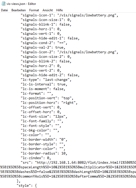

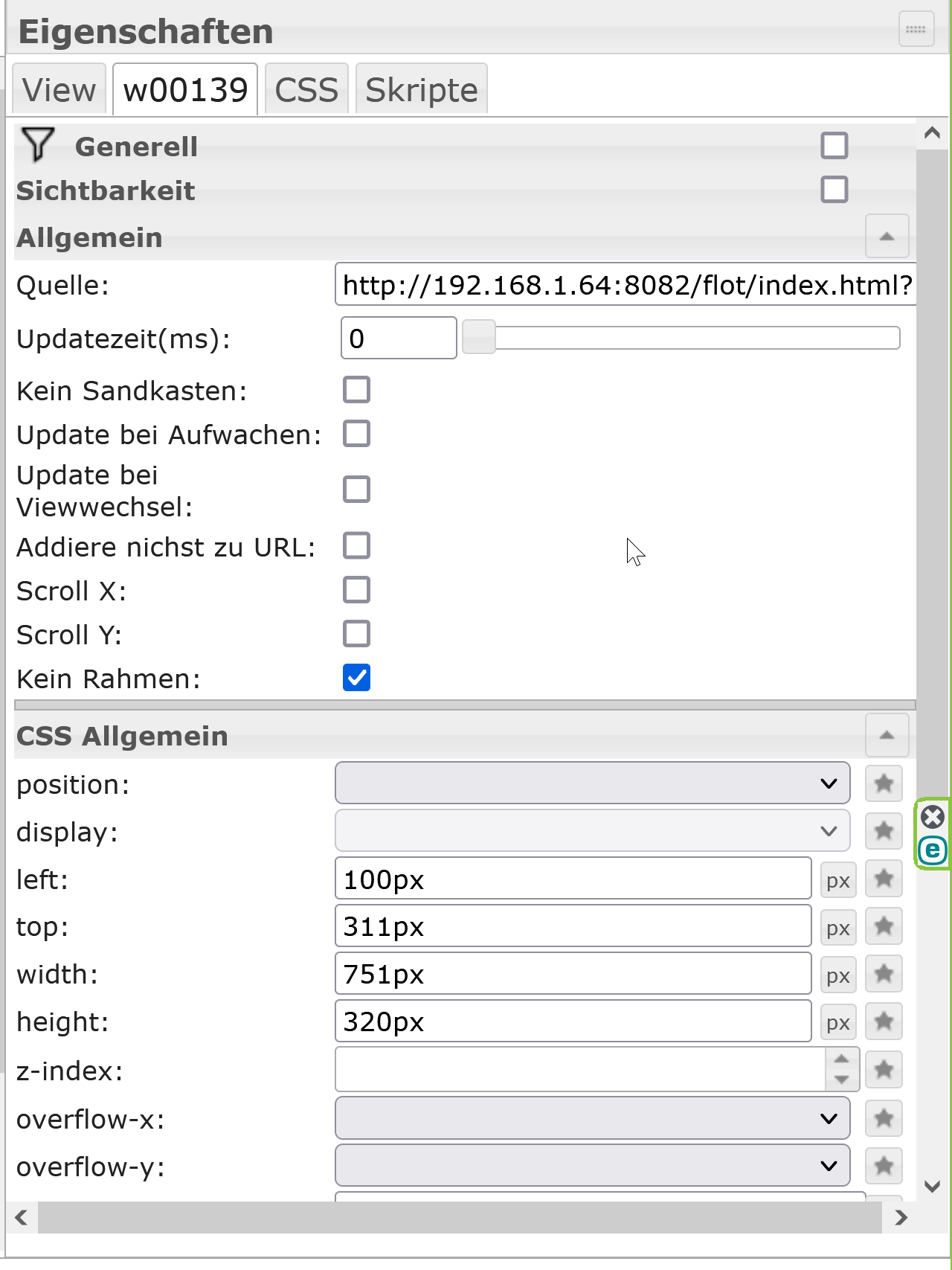

            MCU @Norwegen60 last edited by
            @norwegen60 Zeig mal bitte die Einstellungen zum iFrame.
            Norwegen60 1 Reply Last reply Reply Quote 0
            • Norwegen60
              Norwegen60 @MCU last edited by
              @mcu Meinst du das
              oder den kompletten Export
              [{"tpl":"tplIFrame","data":{"g_fixed":false,"g_visibility":false,"g_css_font_text":false,"g_css_background":false,"g_css_shadow_padding":false,"g_css_border":false,"g_gestures":false,"g_signals":false,"g_last_change":false,"visibility-cond":"==","visibility-val":1,"visibility-groups-action":"hide","refreshInterval":"0","seamless":"true","signals-cond-0":"==","signals-val-0":true,"signals-icon-0":"/vis/signals/lowbattery.png","signals-icon-size-0":0,"signals-blink-0":false,"signals-horz-0":0,"signals-vert-0":0,"signals-hide-edit-0":false,"signals-cond-1":"==","signals-val-1":true,"signals-icon-1":"/vis/signals/lowbattery.png","signals-icon-size-1":0,"signals-blink-1":false,"signals-horz-1":0,"signals-vert-1":0,"signals-hide-edit-1":false,"signals-cond-2":"==","signals-val-2":true,"signals-icon-2":"/vis/signals/lowbattery.png","signals-icon-size-2":0,"signals-blink-2":false,"signals-horz-2":0,"signals-vert-2":0,"signals-hide-edit-2":false,"lc-type":"last-change","lc-is-interval":true,"lc-is-moment":false,"lc-format":"","lc-position-vert":"top","lc-position-horz":"right","lc-offset-vert":0,"lc-offset-horz":0,"lc-font-size":"12px","lc-font-family":"","lc-font-style":"","lc-bkg-color":"","lc-color":"","lc-border-width":"0","lc-border-style":"","lc-border-color":"","lc-border-radius":10,"lc-zindex":0,"src":"http://192.168.1.64:8082/flot/index.html?l%5B0%5D%5Bid%5D=0_userdata.0.PV.rPV_Power_MPPT1&l%5B0%5D%5Binstance%5D=sql.0&l%5B0%5D%5Boffset%5D=0&l%5B0%5D%5Baggregate%5D=minmax&l%5B0%5D%5Bcolor%5D=%23ffd300&l%5B0%5D%5Bthickness%5D=1&l%5B0%5D%5Bshadowsize%5D=0&l%5B0%5D%5Bunit%5D=W&l%5B0%5D%5Bname%5D=PV+Power+Ost&l%5B0%5D%5Bxmove%5D=0&l%5B0%5D%5BcommonYAxis%5D=1&l%5B0%5D%5BignoreNull%5D=false&l%5B0%5D%5BafterComma%5D=2&l%5B0%5D%5Bdashes%5D=false&l%5B0%5D%5BdashLength%5D=10&l%5B0%5D%5BspaceLength%5D=10&l%5B0%5D%5Bmultiplicator%5D=1&l%5B0%5D%5Byaxe%5D=left&l%5B0%5D%5Bsmoothing%5D=1&l%5B1%5D%5Bid%5D=0_userdata.0.PV.rPV_Power_MPPT2&l%5B1%5D%5Binstance%5D=sql.0&l%5B1%5D%5Boffset%5D=0&l%5B1%5D%5Baggregate%5D=minmax&l%5B1%5D%5Bcolor%5D=%23ffca00&l%5B1%5D%5Bthickness%5D=1&l%5B1%5D%5Bshadowsize%5D=0&l%5B1%5D%5Bunit%5D=W&l%5B1%5D%5Bname%5D=PV+Power+West&l%5B1%5D%5Bxmove%5D=0&l%5B1%5D%5Byaxe%5D=off&l%5B1%5D%5BcommonYAxis%5D=1&l%5B1%5D%5BafterComma%5D=2&l%5B1%5D%5Bdashes%5D=false&l%5B1%5D%5BdashLength%5D=10&l%5B1%5D%5BspaceLength%5D=10&l%5B1%5D%5Bmultiplicator%5D=1&l%5B1%5D%5Bxaxe%5D=off&l%5B1%5D%5Bsmoothing%5D=1&l%5B2%5D%5Bid%5D=0_userdata.0.PV.rPV_Power_Total&l%5B2%5D%5Binstance%5D=sql.0&l%5B2%5D%5Boffset%5D=0&l%5B2%5D%5Baggregate%5D=minmax&l%5B2%5D%5Bcolor%5D=%23ff9600&l%5B2%5D%5Bthickness%5D=1&l%5B2%5D%5Bshadowsize%5D=3&l%5B2%5D%5Bunit%5D=W&l%5B2%5D%5Bname%5D=PV+Power+Total&l%5B2%5D%5Bxmove%5D=0&l%5B2%5D%5Byaxe%5D=off&l%5B2%5D%5BcommonYAxis%5D=1&l%5B2%5D%5BafterComma%5D=2&l%5B2%5D%5Bdashes%5D=false&l%5B2%5D%5BdashLength%5D=10&l%5B2%5D%5BspaceLength%5D=10&l%5B2%5D%5Bmultiplicator%5D=1&l%5B2%5D%5Bxaxe%5D=off&l%5B2%5D%5Bfill%5D=0.2&l%5B2%5D%5Bsmoothing%5D=2&l%5B3%5D%5Bid%5D=0_userdata.0.PV.rExport_Power_Signed&l%5B3%5D%5Boffset%5D=0&l%5B3%5D%5Baggregate%5D=minmax&l%5B3%5D%5Bcolor%5D=%23009cff&l%5B3%5D%5Bthickness%5D=1&l%5B3%5D%5Bshadowsize%5D=3&l%5B3%5D%5Bunit%5D=W&l%5B3%5D%5Bname%5D=Netz&l%5B3%5D%5Bxmove%5D=0&l%5B3%5D%5Byaxe%5D=off&l%5B3%5D%5Bxaxe%5D=off&l%5B3%5D%5BcommonYAxis%5D=1&l%5B3%5D%5BafterComma%5D=2&l%5B3%5D%5Bdashes%5D=false&l%5B3%5D%5BdashLength%5D=10&l%5B3%5D%5BspaceLength%5D=10&l%5B3%5D%5Bmultiplicator%5D=1&l%5B3%5D%5Bfill%5D=0.2&l%5B3%5D%5Binstance%5D=sql.0&l%5B4%5D%5Bid%5D=0_userdata.0.PV.rBattery_Power_Signed&l%5B4%5D%5Boffset%5D=0&l%5B4%5D%5Baggregate%5D=minmax&l%5B4%5D%5Bcolor%5D=%237aff00&l%5B4%5D%5Bthickness%5D=1&l%5B4%5D%5Bshadowsize%5D=3&l%5B4%5D%5Bunit%5D=W&l%5B4%5D%5Bname%5D=Batterie&l%5B4%5D%5Bxmove%5D=0&l%5B4%5D%5Byaxe%5D=off&l%5B4%5D%5Bxaxe%5D=off&l%5B4%5D%5BcommonYAxis%5D=1&l%5B4%5D%5BafterComma%5D=2&l%5B4%5D%5Bdashes%5D=false&l%5B4%5D%5BdashLength%5D=10&l%5B4%5D%5BspaceLength%5D=10&l%5B4%5D%5Bmultiplicator%5D=1&l%5B4%5D%5Bfill%5D=0.2&l%5B4%5D%5Binstance%5D=sql.0&l%5B5%5D%5Bid%5D=0_userdata.0.PV.rLoad_Power&l%5B5%5D%5Binstance%5D=sql.0&l%5B5%5D%5Boffset%5D=0&l%5B5%5D%5Baggregate%5D=minmax&l%5B5%5D%5Bcolor%5D=%23da041b&l%5B5%5D%5Bthickness%5D=1&l%5B5%5D%5Bshadowsize%5D=2&l%5B5%5D%5Bunit%5D=W&l%5B5%5D%5Bname%5D=Verbrauch&l%5B5%5D%5Bxmove%5D=0&l%5B5%5D%5Byaxe%5D=off&l%5B5%5D%5Bxaxe%5D=off&l%5B5%5D%5BcommonYAxis%5D=1&l%5B5%5D%5BafterComma%5D=2&l%5B5%5D%5Bdashes%5D=false&l%5B5%5D%5BdashLength%5D=10&l%5B5%5D%5BspaceLength%5D=10&l%5B5%5D%5Bmultiplicator%5D=1&l%5B5%5D%5Bsmoothing%5D=0&l%5B5%5D%5Bfill%5D=0.2&l%5B5%5D%5Bpoints%5D=false&l%5B6%5D%5Bid%5D=0_userdata.0.PV.rBattery_Level&l%5B6%5D%5Binstance%5D=sql.0&l%5B6%5D%5Boffset%5D=0&l%5B6%5D%5Baggregate%5D=minmax&l%5B6%5D%5Bcolor%5D=%23800000&l%5B6%5D%5Bthickness%5D=2&l%5B6%5D%5Bshadowsize%5D=3&l%5B6%5D%5Bunit%5D=%25&l%5B6%5D%5Bname%5D=Ladezustand&l%5B6%5D%5Bxmove%5D=0&l%5B6%5D%5Byaxe%5D=right&l%5B6%5D%5BignoreNull%5D=&l%5B6%5D%5BafterComma%5D=2&l%5B6%5D%5Bdashes%5D=false&l%5B6%5D%5BdashLength%5D=10&l%5B6%5D%5BspaceLength%5D=10&l%5B6%5D%5Bmultiplicator%5D=1&l%5B6%5D%5Bxaxe%5D=off&timeType=static&relativeEnd=now&range=180&aggregateType=count&aggregateSpan=3000&hoverDetail=true&useComma=false&zoom=true&noedit=false&animation=0&live=5&legend=ne&start=2023-08-27&start_time=00%3A00&end=2023-08-28&end_time=00%3A00&window_bg=%23ffffff&bg=0"},"style":{"left":"100px","top":"311px","width":"751px","height":"320px"},"widgetSet":"basic"}]
                MCU @Norwegen60 last edited by MCU
                @norwegen60
                Also man kann die Daten (Parameter) von VIS nur auf Dateiebene ändern.
                • man muss also erst jedesmal vor einer Änderung die Datei lesen
                • die src in der Datei suchen
                • die src anpassen und die Datei speichern
                Dann weiß ich aber noch nicht, ob dann das Frontend (VIS) dadurch direkt upgedatet wird.
                Also mir erscheint die andere Möglichkeit mit eCharts wesentlich einfacher, da man dort die Änderungen auf Objektebene vollzieht.
                Du kannst ja mal testen, ob eine Änderung auf Dateiebene, also in Deinem VIS-Projekt, dann das Frontend geändert wird?
