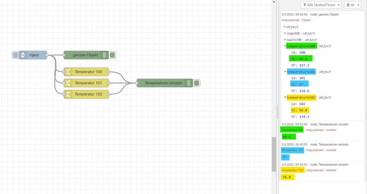

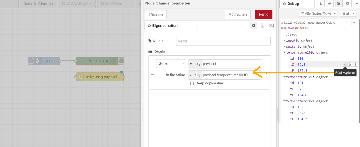

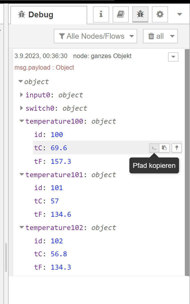

        @peguschwein Entweder Du nimmst meinen Flow der löst Dir alles auf, ansonsten musst Du einfach im Debug den Pfad kopieren und die payload auf den neuen Pfad setzen.
        Wenn Du also die Temperatur dieser Objekte haben willst kopierst Du den Pfad raus:
        und setzt die payload entsprechend.
               "id": "26a7bf2354ba8d2a",
               "type": "inject",
               "z": "7e6af0015415146d",
               "name": "",
               "props": [
                       "p": "payload"
               "repeat": "",
               "crontab": "",
               "once": false,
               "onceDelay": 0.1,
               "topic": "",
               "payload": "{\"input0\":{\"id\":0,\"state\":false},\"switch0\":{\"id\":0,\"source\":\"init\",\"output\":false,\"apower\":0,\"voltage\":236.3,\"current\":0,\"aenergy\":{\"total\":0,\"by_minute\":[0,0,0],\"minute_ts\":1693687978},\"temperature\":{\"tC\":57.5,\"tF\":135.5}},\"temperature100\":{\"id\":100,\"tC\":69.6,\"tF\":157.3},\"temperature101\":{\"id\":101,\"tC\":57,\"tF\":134.6},\"temperature102\":{\"id\":102,\"tC\":56.8,\"tF\":134.3}}",
               "payloadType": "json",
               "x": 550,
               "y": 3300,
               "wires": [
                       "a403bf28516f14af",
                       "59d56d2f51c5c982",
                       "8e64df682a66ef89",
                       "10e711912413ba2a"
               "id": "a403bf28516f14af",
               "type": "debug",
               "name": "ganzes Objekt",
               "active": true,
               "tosidebar": true,
               "console": false,
               "tostatus": false,
               "complete": "payload",
               "targetType": "msg",
               "statusVal": "",
               "statusType": "auto",
               "x": 740,
               "y": 3300,
               "wires": []
               "id": "59d56d2f51c5c982",
               "type": "change",
               "name": "Temperatur 100",
               "rules": [
                       "t": "set",
                       "p": "payload",
                       "pt": "msg",
                       "to": "payload.temperature100.tC",
                       "tot": "msg"
                       "t": "set",
                       "p": "topic",
                       "pt": "msg",
                       "to": "Temperatur 100",
                       "tot": "str"
               "action": "",
               "property": "",
               "from": "",
               "to": "",
               "reg": false,
               "x": 740,
               "y": 3360,
               "wires": [
                       "8daea126e5d2ec00"
               "id": "8e64df682a66ef89",
               "type": "change",
               "name": "Temperatur 101",
               "rules": [
                       "t": "set",
                       "p": "payload",
                       "pt": "msg",
                       "to": "payload.temperature101.tC",
                       "tot": "msg"
                       "t": "set",
                       "p": "topic",
                       "pt": "msg",
                       "to": "Temperatur 101",
                       "tot": "str"
               "action": "",
               "property": "",
               "from": "",
               "to": "",
               "reg": false,
               "x": 740,
               "y": 3400,
               "wires": [
                       "8daea126e5d2ec00"
               "id": "10e711912413ba2a",
               "type": "change",
               "name": "Temperatur 102",
               "rules": [
                       "t": "set",
                       "p": "payload",
                       "pt": "msg",
                       "to": "payload.temperature102.tC",
                       "tot": "msg"
                       "t": "set",
                       "p": "topic",
                       "pt": "msg",
                       "to": "Temperatur 102",
                       "tot": "str"
               "action": "",
               "property": "",
               "from": "",
               "to": "",
               "reg": false,
               "x": 740,
               "y": 3440,
               "wires": [
                       "8daea126e5d2ec00"
               "id": "8daea126e5d2ec00",
               "type": "debug",
               "name": "Temperaturen einzeln",
               "active": true,
               "tosidebar": true,
               "console": false,
               "tostatus": false,
               "statusVal": "",
               "x": 1020,
               "y": 3400,
               "wires": []

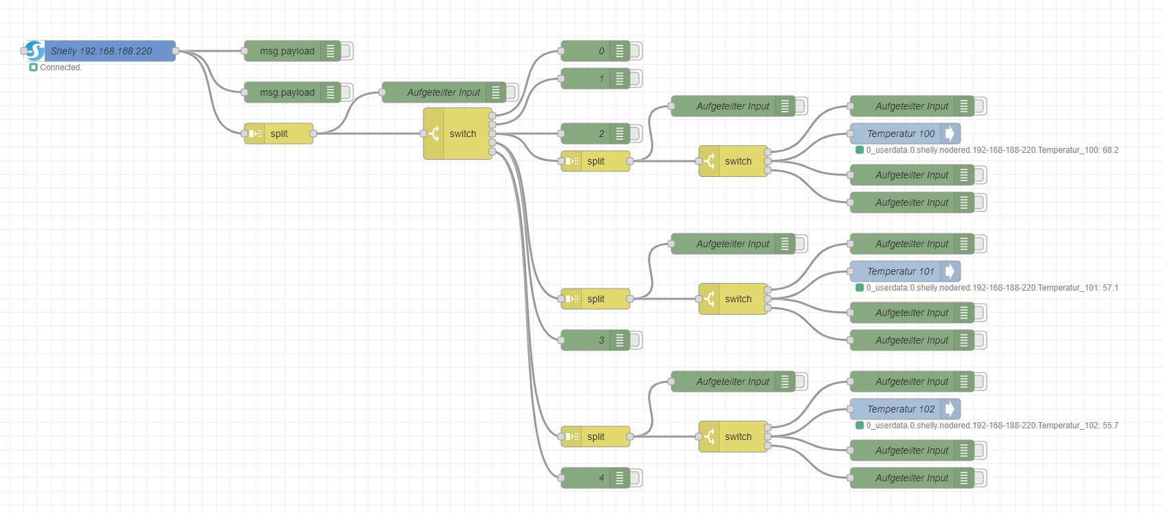

          Peguschwein last edited by
          @mickym Danke für deinen Input werde ich mir gerne ansehen. Habe es unterdessen auch geschafft mein Code ist aber ein bisschen grösser geworden aber funktioniert auch
