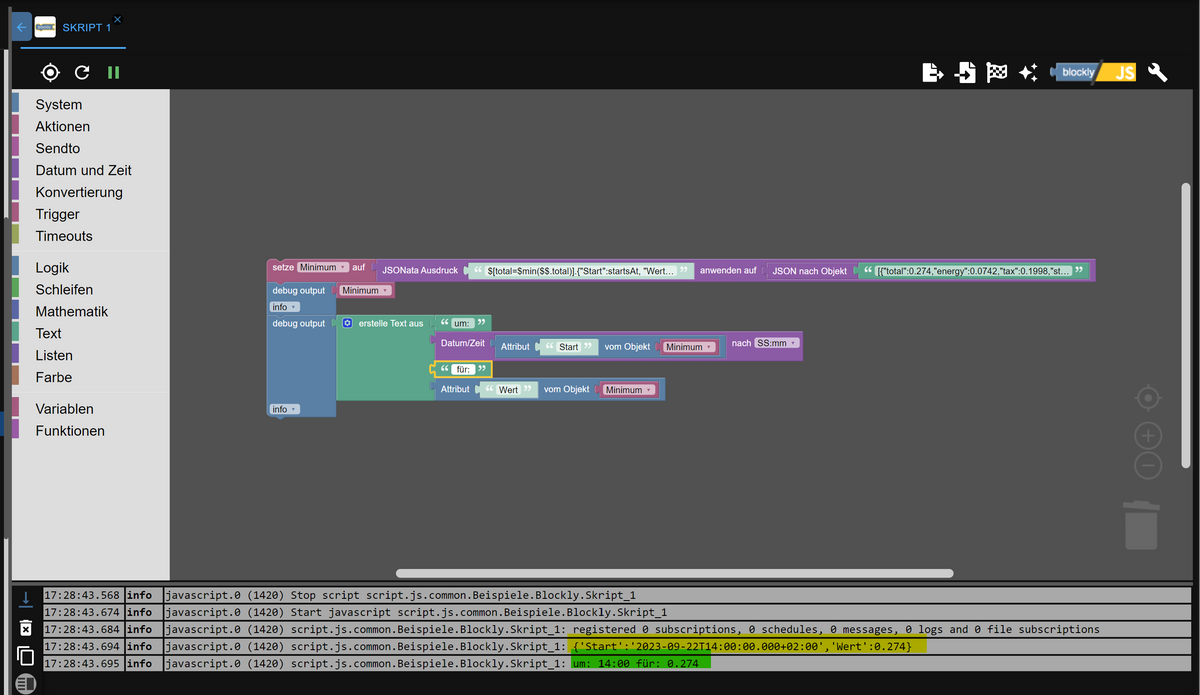

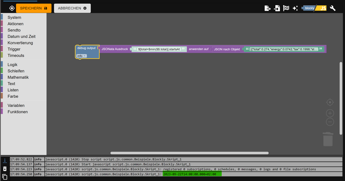

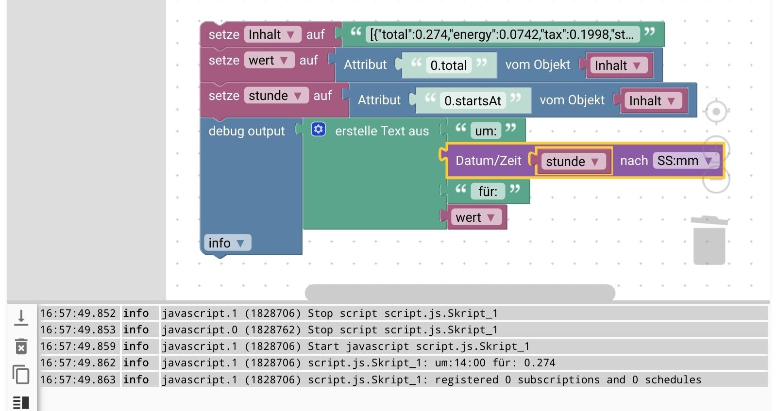

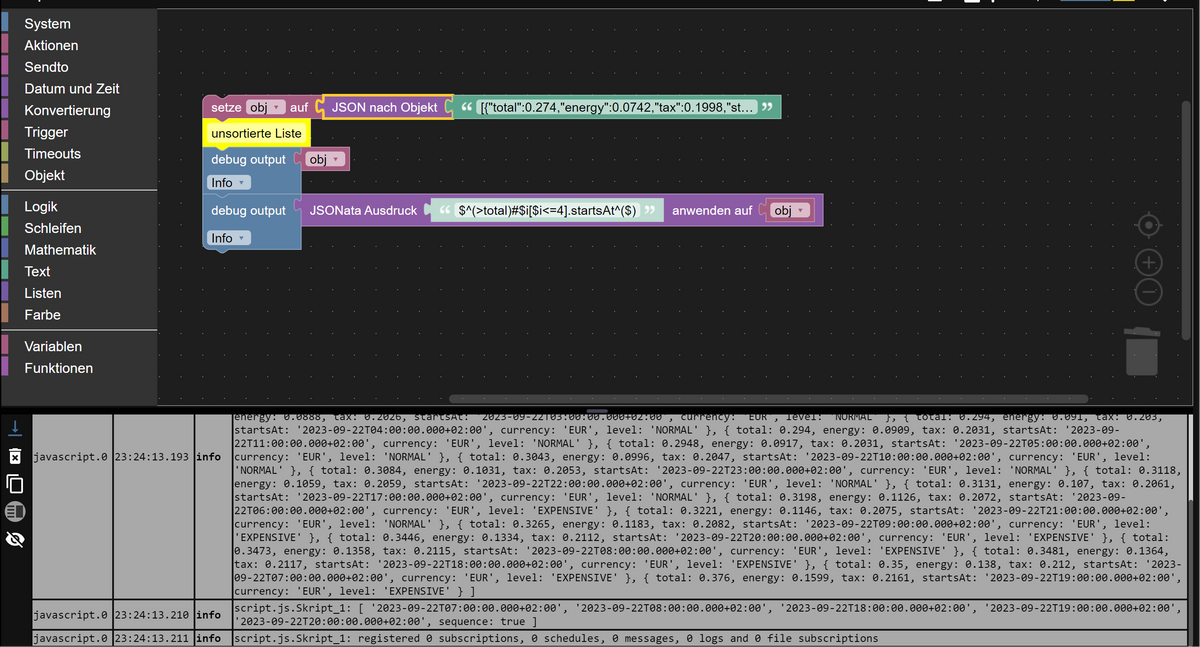

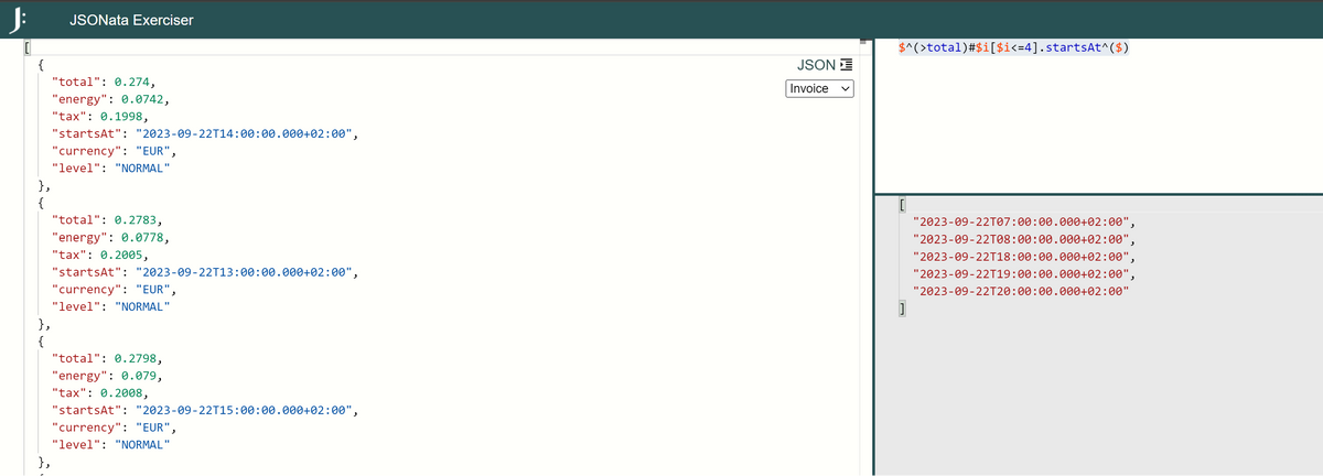

          • mickym
            mickym Most Active last edited by mickym
            Ich würde sowas mit JSONATA lösen.#
            $[total=$min($$.total)].startsAt
             <block type="debug" id="c=0Ev,.Lf2VL/]$u@;:|" x="-613" y="-162">
               <value name="TEXT">
                 <shadow type="text" id="^HBfRb,DeK,*xX.uG[4T">
                 <block type="convert_jsonata" id="4Q?i99iF+3X?6j0Uh.mi">
                   <value name="EXPRESSION">
                     <shadow type="text" id="`Al=UMroj;tMS~u=*cfJ">
                       <field name="TEXT">$[total=$min($$.total)].startsAt</field>
                   <value name="TARGET">
                     <block type="convert_json2object" id="kzz^-zfHR4IH44F.Q=nO">
                         <block type="text" id="])oGXSKIO5c~Q:JvFBz6">
                           <field name="TEXT">[{"total":0.274,"energy":0.0742,"tax":0.1998,"startsAt":"2023-09-22T14:00:00.000+02:00","currency":"EUR","level":"NORMAL"},{"total":0.2783,"energy":0.0778,"tax":0.2005,"startsAt":"2023-09-22T13:00:00.000+02:00","currency":"EUR","level":"NORMAL"},{"total":0.2798,"energy":0.079,"tax":0.2008,"startsAt":"2023-09-22T15:00:00.000+02:00","currency":"EUR","level":"NORMAL"},{"total":0.2877,"energy":0.0856,"tax":0.2021,"startsAt":"2023-09-22T12:00:00.000+02:00","currency":"EUR","level":"NORMAL"},{"total":0.2895,"energy":0.0872,"tax":0.2023,"startsAt":"2023-09-22T01:00:00.000+02:00","currency":"EUR","level":"NORMAL"},{"total":0.2905,"energy":0.088,"tax":0.2025,"startsAt":"2023-09-22T02:00:00.000+02:00","currency":"EUR","level":"NORMAL"},{"total":0.2908,"energy":0.0883,"tax":0.2025,"startsAt":"2023-09-22T00:00:00.000+02:00","currency":"EUR","level":"NORMAL"},{"total":0.2908,"energy":0.0882,"tax":0.2026,"startsAt":"2023-09-22T16:00:00.000+02:00","currency":"EUR","level":"NORMAL"},{"total":0.2914,"energy":0.0888,"tax":0.2026,"startsAt":"2023-09-22T03:00:00.000+02:00","currency":"EUR","level":"NORMAL"},{"total":0.294,"energy":0.091,"tax":0.203,"startsAt":"2023-09-22T04:00:00.000+02:00","currency":"EUR","level":"NORMAL"},{"total":0.294,"energy":0.0909,"tax":0.2031,"startsAt":"2023-09-22T11:00:00.000+02:00","currency":"EUR","level":"NORMAL"},{"total":0.2948,"energy":0.0917,"tax":0.2031,"startsAt":"2023-09-22T05:00:00.000+02:00","currency":"EUR","level":"NORMAL"},{"total":0.3043,"energy":0.0996,"tax":0.2047,"startsAt":"2023-09-22T10:00:00.000+02:00","currency":"EUR","level":"NORMAL"},{"total":0.3084,"energy":0.1031,"tax":0.2053,"startsAt":"2023-09-22T23:00:00.000+02:00","currency":"EUR","level":"NORMAL"},{"total":0.3118,"energy":0.1059,"tax":0.2059,"startsAt":"2023-09-22T22:00:00.000+02:00","currency":"EUR","level":"NORMAL"},{"total":0.3131,"energy":0.107,"tax":0.2061,"startsAt":"2023-09-22T17:00:00.000+02:00","currency":"EUR","level":"NORMAL"},{"total":0.3198,"energy":0.1126,"tax":0.2072,"startsAt":"2023-09-22T06:00:00.000+02:00","currency":"EUR","level":"EXPENSIVE"},{"total":0.3221,"energy":0.1146,"tax":0.2075,"startsAt":"2023-09-22T21:00:00.000+02:00","currency":"EUR","level":"NORMAL"},{"total":0.3265,"energy":0.1183,"tax":0.2082,"startsAt":"2023-09-22T09:00:00.000+02:00","currency":"EUR","level":"EXPENSIVE"},{"total":0.3446,"energy":0.1334,"tax":0.2112,"startsAt":"2023-09-22T20:00:00.000+02:00","currency":"EUR","level":"EXPENSIVE"},{"total":0.3473,"energy":0.1358,"tax":0.2115,"startsAt":"2023-09-22T08:00:00.000+02:00","currency":"EUR","level":"EXPENSIVE"},{"total":0.3481,"energy":0.1364,"tax":0.2117,"startsAt":"2023-09-22T18:00:00.000+02:00","currency":"EUR","level":"EXPENSIVE"},{"total":0.35,"energy":0.138,"tax":0.212,"startsAt":"2023-09-22T07:00:00.000+02:00","currency":"EUR","level":"EXPENSIVE"},{"total":0.376,"energy":0.1599,"tax":0.2161,"startsAt":"2023-09-22T19:00:00.000+02:00","currency":"EUR","level":"EXPENSIVE"}]</field>
            Mit NodeRed halt entsprechend.
            Wenn man will kann man dann ein eigenes Objekt erstellen (gelb markiert)
            $[total=$min($$.total)].{"Start":startsAt, "Wert":total}
            und dieses dann im Blockly nach Belieben weiter zu verarbeiten um die gleiche interpretierte Ausgabe wie @Homoran zu erhalten:
             <variables>
               <variable id="k29Ksrg0bbjP1^[uaDHZ">Minimum</variable>
             </variables>
             <block type="variables_set" id="+ed2p;s6]-q!Kd%cN7V8" x="-662" y="-162">
               <field name="VAR" id="k29Ksrg0bbjP1^[uaDHZ">Minimum</field>
                       <field name="TEXT">$[total=$min($$.total)].{"Start":startsAt, "Wert":total}</field>
                 <block type="debug" id="c=0Ev,.Lf2VL/]$u@;:|">
                   <value name="TEXT">
                     <block type="variables_get" id="sp5ksx4nXb7y`qZRh;}6">
                     <block type="debug" id="QKZA(K`S7T(xd~/*2;yP">
                       <value name="TEXT">
                         <shadow type="text" id="VPEE_H1;WnTjag1u2EK6">
                         <block type="text_join" id="eeCizGy~Yip(Bo@s~::c">
                           <mutation items="4"></mutation>
                           <value name="ADD0">
                             <block type="text" id="}12kw4*Z%{3dN7LX2/Ia">
                               <field name="TEXT">um: </field>
                           <value name="ADD1">
                             <block type="convert_from_date" id="6clf}@oVM~xII?,9C/!n">
                               <field name="OPTION">hh:mm</field>
                                 <block type="get_attr" id="Sei-Lh#B[,#`^g.#UAiP">
                                   <value name="PATH">
                                     <shadow type="text" id="GZa@0Dd~]a{qo3xuQGSL">
                                       <field name="TEXT">Start</field>
                                   <value name="OBJECT">
                                     <block type="variables_get" id="zD!=tW/S3.!1g*?=l/Bs">
                           <value name="ADD2">
                             <block type="text" id="}L;_GK5`POZ)+Y%D{9+4">
                               <field name="TEXT"> für: </field>
                           <value name="ADD3">
                             <block type="get_attr" id="e4*+TKkxrfL}i{=(L`mo">
                               <value name="PATH">
                                 <shadow type="text" id="qVSAYyQjQotkKZ_W4@As">
                                   <field name="TEXT">Wert</field>
                                 <block type="variables_get" id="Be_jowB61ndEPNngwyT;">
              lemuba last edited by lemuba

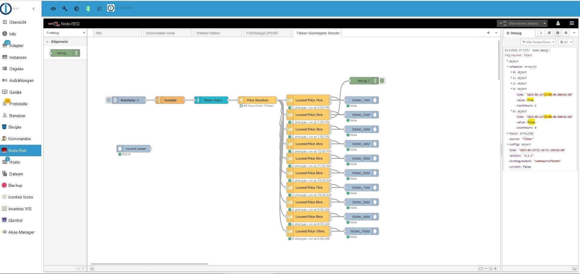

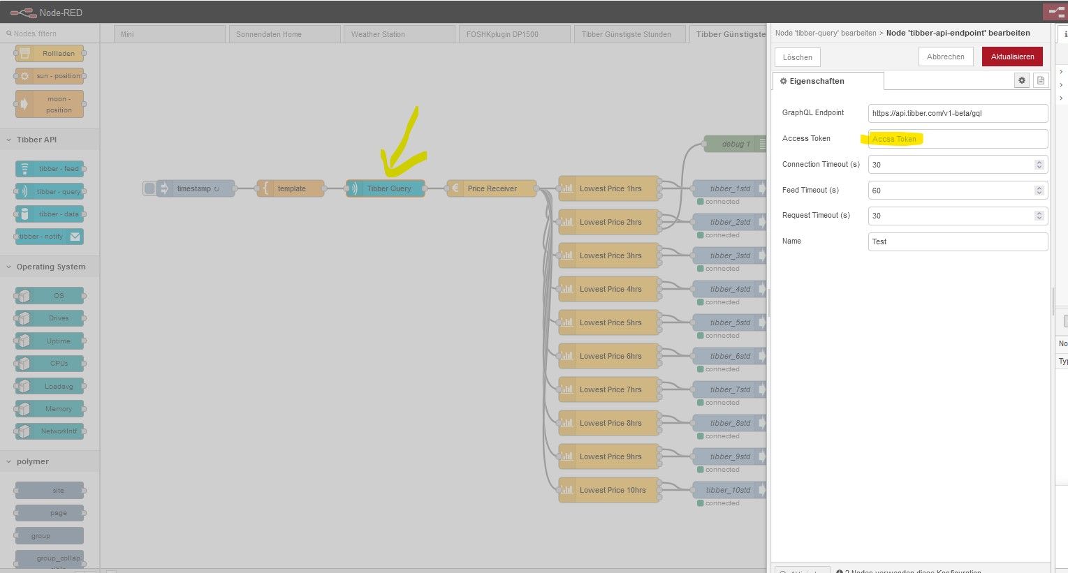

              @Crazy-Com Ich habe das ganz anders gelöst und erledige das nun im IoBroker unter NodeRed nach dieser Anleitung:
              https://www.youtube.com/watch?v=dmmdUPjTopI
              Letzendlich schaut dann mein NodeRed Flow im Iobroker so aus:
              Der Flow erzeugt dann auch 10 Datenpunkte unter Objekte/nodered im Iobroker, welche je nach Anzahl der benötigten Stunden True oder False sind.

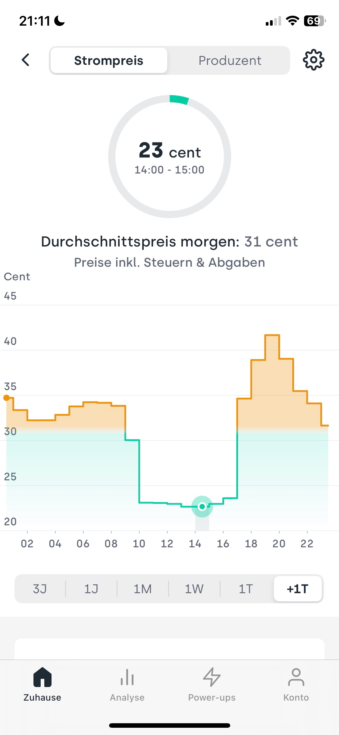

              Am Beispiel, siehe Debug gelb markiert für die günstigsten 2 Stunden morgen am 24.9. wäre dann der Datenpunkt "tibber_2std" morgen in der Zeit von 13:00 Uhr bis 15:00 Uhr auf "true".
              Passt dann auch mit der Tibber App Vorhersage für morgen:

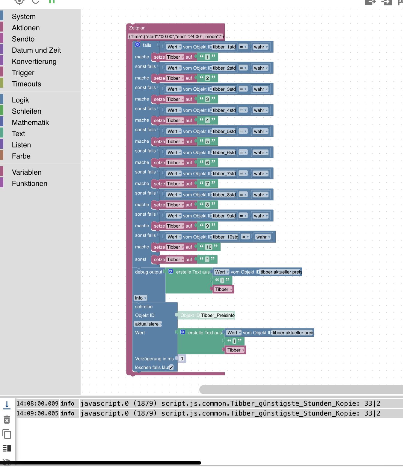

              Hier mal mein Flow zum möglichen Import (ohne meinen Tibber Token) 😉 :

              Der eigene Tibber Token müsste dann noch hier eingefügt werden:
              Ggf. viel Spaß beim Testen...

                  lemuba @Crazy Com last edited by lemuba
                  @crazy-com
                  Ausgehend von meinen NodeRed 10 günstigsten Std. Datenpunkten, hatte ich nun auch noch ein kleines Blockly geschrieben, welches mir auf meinem Ulanzi Matrix Display unter anderem den Std. aktuellen Strompreis in Cent ausgibt und dahinter die Einordnung welche der günstigsten Stunden das ist (1-10). Nicht schön aber funktioniert.
                  Jetzt um 14:15 Uhr 33 Cent und eine der 2 günstigsten Tagesstunden.

                    • vowill
                      vowill @Crazy Com last edited by vowill
                      @crazy-com
                      Vielleicht noch ein Ansatz: Um den Verlauf der Tibberpreise über die jeweils 24h von heute und morgen grafisch mit ECharts darzustellen, habe ich ein Skript verfasst (siehe im Forum hier). Dort sind die Werte (val) dann mit Zeitstempel (ts) in der Form "{"ts": 1701644400000, "val": 0.2566}" als JSON-String abgelegt, können also relativ leicht ausgewertet werden.
                      Nachtrag 25.12.2023: Hier ein Foto des zugehörigen Pop-up-Views in vis:

                        @mickym said in JSON-Liste - günstigste Tibber-Stunde herausfinden:
                           <value name="TEXT">

                          @mic4rd Du kannst immer den JSONATA Exerciser nehmen. Ich habe mal aus dem 1. Posting diese Quelle und sortiere wieder nach total diesesmal absteigend, um die teuersten zuerst zu haben. Anschliessend nehme ich nur die ersten 5 Objekte.
                          Hier kannst Du das selbst ausprobieren: https://try.jsonata.org/iupoLlhhu
                          $^(>total)#$i[$i<=4]
                          Also alles nach total sortiert und dann die ersten 5 Elemente genommen ($i von 0 bis 4, also die ersten 5 Elemente).
                          Will man dann nur die Uhrzeiten haben, dann einfach selektieren:
                          $^(>total)#$i[$i<=4].startsAt
                          Will man diese dann auch noch sortieren, dann einfach den order Operator verwenden
                          $^(>total)#$i[$i<=4].startsAt^($)
                          Um zu zeigen, dass dies auch in Blockly funktioniert, hier der Beweis :
                          Hier zum Import:
                           <variables>
                             <variable id="EOJ4*0:|Gac4$sNJ6F}z">obj</variable>
                           </variables>
                           <block type="variables_set" id="{c.GD@;*Xg1KFL,@Ul2`" x="63" y="138">
                             <field name="VAR" id="EOJ4*0:|Gac4$sNJ6F}z">obj</field>
                               <block type="convert_json2object" id="4|VOw$XSSXKL6zfI;WEJ">
                                   <block type="text" id="Eb(AvJLhHnCv2d-|4ZTJ">
                               <block type="comment" id="+j10:AzTj,${aq@Hg%+V">
                                 <field name="COMMENT">unsortierte Liste</field>
                                   <block type="debug" id="2ptRFlCYIJ|DzcK7)5`S">
                                     <field name="Severity">info</field>
                                     <value name="TEXT">
                                       <shadow type="text" id="LDl/3!S6+ucYjHHQQ#s1">
                                       <block type="variables_get" id="ZRH=pb?,N%+N`DUbp-L%">
                                       <block type="debug" id="[xZ@b#8D:N2rm=K5n^sy">
                                         <value name="TEXT">
                                           <shadow type="text" id="43@*K5pW258a^X6LYa~/">
                                           <block type="convert_jsonata" id="PIP7}Nr-b^ptWp@BpLw)">
                                               <shadow type="text" id="*ck`*6zg8[wjRyJ`8^y(">
                                                 <field name="TEXT">$^(&gt;total)#$i[$i&lt;=4].startsAt^($)</field>
                                               <block type="variables_get" id="xjb9LXDEdnor26?:zL?T">
                          Das sequence: true kommt irgendwie vom Blockly. Dann muss man halt die Liste ohne das letzte element nehmen. Das ist wohl eine Blockly Eigenart.
                            mic4rd @mickym last edited by
                            @mickym Wow vielen Dank, das ist ja der Oberhammer wie einfach das funktioniert!
                            Muss mich glaub einfach noch ein bisschen mehr in JSONata einlesen, das muss man unbedingt können. Hast mir eine großartige Starthilfe gegeben!
                            • mickym
                              mickym Most Active @mic4rd last edited by mickym
                              @mic4rd sagte in JSON-Liste - günstigste Tibber-Stunde herausfinden:
                              Der Vorteil von dem Exerciser ist, dass Du siehst, wie man Schritt für Schritt das Ganze entwickelt. Ausserdem kannst Du halt sofort ausprobieren und siehst das Ergebnis. Also ich schreib das auch nicht einfach immer so hin, sondern verwende den Exerciser zum Entwickeln der Ausdrücke. Damit kontrolliere ich dann halt auch immer, ob sich das auch so umsetzen läßt, wie ich es mir denke.
