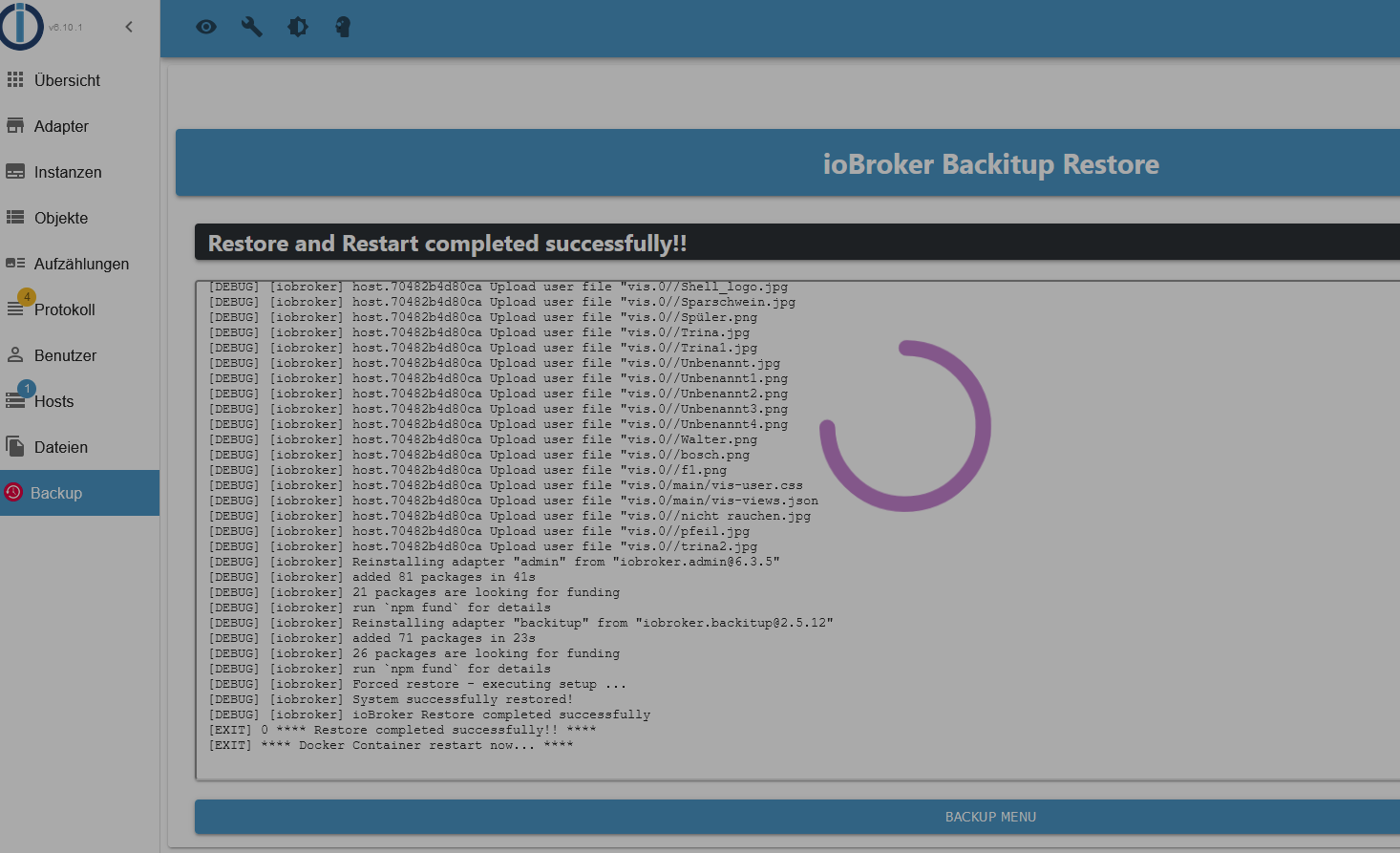

      Danach mit Backitup das Backuo von heute Nacht eingespielt.
      Hat auch soweit geklappt.
      Jetzt läuft aber die Eieruhr und ioBroker startet nicht mehr. Kann da jemand helfen ?

                                @wildbill ```
                                connection to databases possible, restart
                                2023-09-29 17:27:59.105  - info: host.2edb3017894a iobroker _restart
                                2023-09-29 17:28:04.560  - info: host.2edb3017894a iobroker.js-controller version 4.0.24 js-controller starting
                                2023-09-29 17:28:04.567  - info: host.2edb3017894a Copyright (c) 2014-2022 bluefox, 2014 hobbyquaker
                                2023-09-29 17:28:04.569  - info: host.2edb3017894a hostname: 2edb3017894a, node: v18.17.0
                                2023-09-29 17:28:04.569  - info: host.2edb3017894a ip addresses: 192.168.178.125
                                2023-09-29 17:28:06.620  - info: host.2edb3017894a-Server  Error inMem-objects listening on port 9001: Error: listen EADDRINUSE: address already in use 127.0.0.1:9001
                                2023-09-29 17:28:34.595  - error: host.2edb3017894a No connection to databases possible, restart
                                2023-09-29 17:28:34.603  - info: host.2edb3017894a iobroker _restart
                                2023-09-29 17:28:40.543  - info: host.2edb3017894a iobroker.js-controller version 4.0.24 js-controller starting
                                2023-09-29 17:28:40.553  - info: host.2edb3017894a Copyright (c) 2014-2022 bluefox, 2014 hobbyquaker
                                2023-09-29 17:28:40.554  - info: host.2edb3017894a hostname: 2edb3017894a, node: v18.17.0
                                2023-09-29 17:28:40.555  - info: host.2edb3017894a ip addresses: 192.168.178.125
                                2023-09-29 17:28:42.321  - info: host.2edb3017894a-Server  Error inMem-objects listening on port 9001: Error: listen EADDRINUSE: address already in use 127.0.0.1:9001
                                2023-09-29 17:29:10.583  - error: host.2edb3017894a No connection to databases possible, restart
                                2023-09-29 17:29:10.589  - info: host.2edb3017894a iobroker _restart
                                2023-09-29 17:29:15.957  - info: host.2edb3017894a iobroker.js-controller version 4.0.24 js-controller starting
                                2023-09-29 17:29:15.969  - info: host.2edb3017894a Copyright (c) 2014-2022 bluefox, 2014 hobbyquaker
                                2023-09-29 17:29:15.970  - info: host.2edb3017894a hostname: 2edb3017894a, node: v18.17.0
                                2023-09-29 17:29:15.971  - info: host.2edb3017894a ip addresses: 192.168.178.125
                                2023-09-29 17:29:18.424  - info: host.2edb3017894a-Server  Error inMem-objects listening on port 9001: Error: listen EADDRINUSE: address already in use 127.0.0.1:9001
                                2023-09-29 17:29:46.001  - error: host.2edb3017894a No connection to databases possible, restart
                                2023-09-29 17:29:46.011  - info: host.2edb3017894a iobroker _restart
                                2023-09-29 17:29:52.667  - info: host.2edb3017894a iobroker.js-controller version 4.0.24 js-controller starting
                                2023-09-29 17:29:52.676  - info: host.2edb3017894a Copyright (c) 2014-2022 bluefox, 2014 hobbyquaker
                                2023-09-29 17:29:52.678  - info: host.2edb3017894a hostname: 2edb3017894a, node: v18.17.0
                                2023-09-29 17:29:52.679  - info: host.2edb3017894a ip addresses: 192.168.178.125
                                2023-09-29 17:29:54.314  - info: host.2edb3017894a-Server  Error inMem-objects listening on port 9001: Error: listen EADDRINUSE: address already in use 127.0.0.1:9001
                                2023-09-29 17:30:22.711  - error: host.2edb3017894a No connection to databases possible, restart
                                2023-09-29 17:30:22.726  - info: host.2edb3017894a iobroker _restart
                                2023-09-29 17:30:30.771  - info: host.2edb3017894a iobroker.js-controller version 4.0.24 js-controller starting
                                2023-09-29 17:30:30.782  - info: host.2edb3017894a Copyright (c) 2014-2022 bluefox, 2014 hobbyquaker
                                2023-09-29 17:30:30.784  - info: host.2edb3017894a hostname: 2edb3017894a, node: v18.17.0

                                  mario.blass @mario.blass last edited by
                                  @mario-blass Aber wo kommt diese Adresse her (127.0.0.1:9001)
                                  • W
                                    Wildbill @mario.blass last edited by Wildbill
                                    @mario-blass Entweder läuft auf Deinem Docker-Host schon ein anderer Container, der 9001 belegt, der Port ist durch einen Dienst des Host selbst belegt, oder im iobroker-Container hängt was. Hast Du den mal neu gestartet?
                                    Gruss, Jürgen
                                    127.0.0.1 ist der localhost, also genau dieses Gerät. Wobei ich nicht weiss, ob da bei Docker der Host auch als localhost sichtbar ist.
                                      Thomas Braun Most Active @mario.blass last edited by
                                      @mario-blass sagte in io broker startet nicht nach backitup:
                                      127.0.0.1
                                      Ist der 'local host', also die Maschine selber. 9001 ist der Port der Datenbank. Da läuft also schon was.
                                      M W 2 Replies Last reply Reply Quote 0
                                        mario.blass @Thomas Braun last edited by mario.blass
                                        @thomas-braun
                                        Ich habe noch den "Alten" Broker in einem Container laufen mit der alten node Version. Liegt es daran ?
                                        • W
                                          Wildbill @Thomas Braun last edited by
                                          @thomas-braun Wieso schreibst Du immer das, was ich auch schreibe, nur eine Sekunde vor mir? 😊
                                          • W
                                            @thomas-braun
                                            Ich habe noch den "Alten" Broker in einem Container laufen mit der alten node VErson. Liegt es daran ?
                                            Der belegt dann ziemlich sicher den Port, da hast Du die Antwort.
