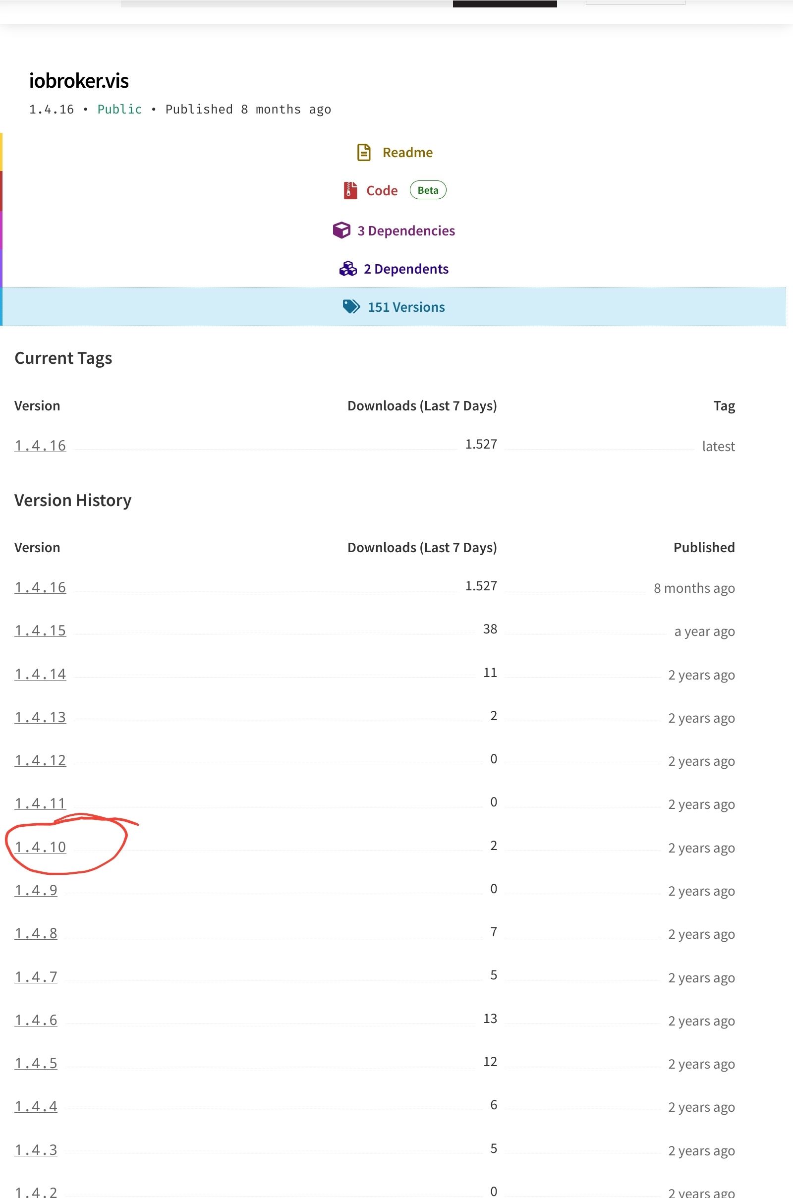

                      Thomas Braun Most Active @LJSven last edited by
                      @ljsven
                      Dann mach das.
                      iob install vis@1.14.0
                      Muss eine intakte Vorversion sein, ich weiß nicht ob 1.14.0 funktioniert (oder ob es die überhaupt gibt...) Schau dir eine Version aus.
                        @thomas-braun sagte in VIS: Keine gültige Lizenz gefunden:
                        1.14.10
                          Dann war ich ja knapp dran.
                            Homoran Global Moderator Administrators @LJSven last edited by
                            @ljsven sorry, hab mich von Thomas in die Irre leiten lassen
                            1.4.10 natürlich

                                          2023-10-01 21:12:08.633  - info: vis.0 (4034) vis license is OK.
                                          2023-10-01 21:12:09.054  - error: vis.0 (4034) Unhandled promise rejection. This error originated either by throwing inside of an async function without a catch block, or by rejecting a promise which was not handled with .catch().
                                          2023-10-01 21:12:09.055  - error: vis.0 (4034) unhandled promise rejection: Not exists
                                          2023-10-01 21:12:09.058  - error: vis.0 (4034) Error: Not exists
                                              at ObjectsInRedisClient._readFile (/opt/iobroker/node_modules/@iobroker/db-objects-redis/build/lib/objects/objectsInRedisClient.js:854:19)
                                              at Immediate.<anonymous> (/opt/iobroker/node_modules/@iobroker/db-objects-redis/build/lib/objects/objectsInRedisClient.js:891:59)
                                              at process.processImmediate (node:internal/timers:478:21)
                                          2023-10-01 21:12:09.059  - error: vis.0 (4034) Not exists
                                          2023-10-01 21:12:09.566  - info: vis.0 (4034) terminating
                                          2023-10-01 21:12:09.568  - warn: vis.0 (4034) Terminated (UNCAUGHT_EXCEPTION): Without reason
                                          2023-10-01 21:15:00.073  - info: host.tinkerboard instance system.adapter.ical.0 started with pid 4046
                                          2023-10-01 21:15:13.374  - info: host.tinkerboard instance system.adapter.ical.0 terminated with code 0 (NO_ERROR)
                                          2023-10-01 21:18:44.560  - info: javascript.0 (1331) script.js.common.Sonstige.EG_Aussenbeleuchtung_Haustuer: HT - Beleuchtung über BWM
                                          2023-10-01 21:23:36.091  - info: vis.0 (4140) Sets unsupported
                                          2023-10-01 21:23:36.873  - info: vis.0 (4140) starting. Version 1.4.10 in /opt/iobroker/node_modules/iobroker.vis, node: v18.17.1, js-controller: 5.0.12
                                          2023-10-01 21:23:37.196  - info: vis.0 (4140) vis license is OK.
                                          2023-10-01 21:23:37.599  - error: vis.0 (4140) Unhandled promise rejection. This error originated either by throwing inside of an async function without a catch block, or by rejecting a promise which was not handled with .catch().
                                          2023-10-01 21:23:37.600  - error: vis.0 (4140) unhandled promise rejection: Not exists
                                          2023-10-01 21:23:37.603  - error: vis.0 (4140) Error: Not exists
                                          2023-10-01 21:23:37.604  - error: vis.0 (4140) Not exists
                                          2023-10-01 21:23:38.111  - info: vis.0 (4140) terminating
                                          2023-10-01 21:23:38.112  - warn: vis.0 (4140) Terminated (UNCAUGHT_EXCEPTION): Without reason
                                            Homoran Global Moderator Administrators @LJSven last edited by Homoran
                                            @ljsven sagte in kann vis nicht installieren:
                                            system.adapter.vis.0 : vis : tinkerboard
                                            ist installiert!
                                            also mit
                                            @thomas-braun sagte in kann vis nicht installieren:
                                            @ljsven sagte in VIS: Keine gültige Lizenz gefunden:
                                            iob upgrade vis@1.4.10
                                            downgraden, dann per admin wieder upgraden
                                            danach könntest du den node-fix drüberjagen.
