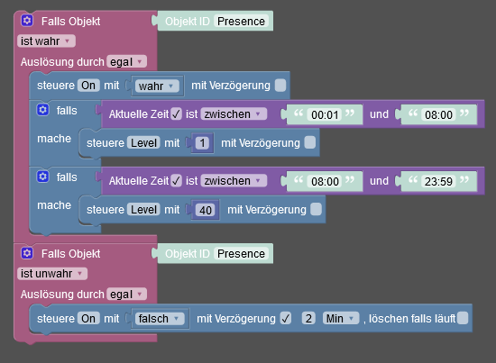

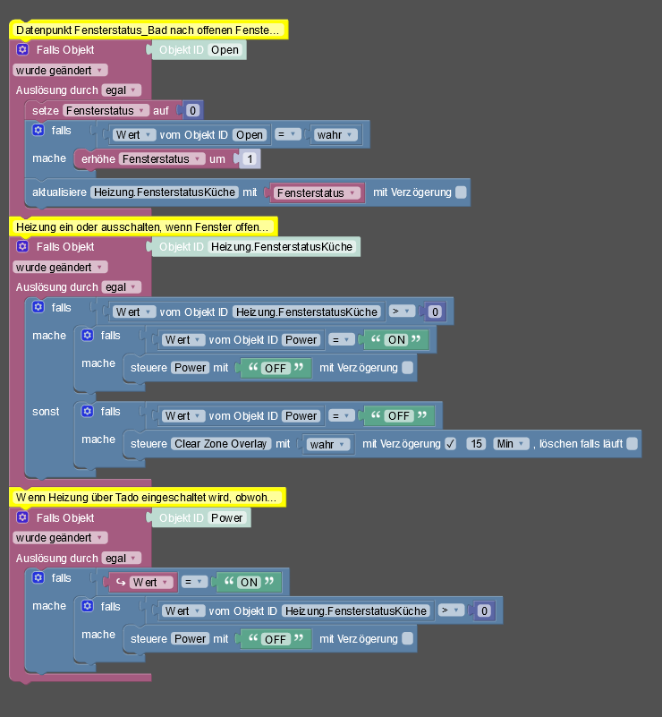

      Allerdings funktionieren meine Blockly-Scripte nicht mehr.
      Ein mal ne simple Bewegungssteuerung und einmal Heizungssteeurung mit einem Fensterkontakt.
      Beide schmeißen mir Fehler aus.

      Licht Blockly
      Licht Script
      on({ id: [].concat(['deconz.1.sensors.00158d0004663765.presence']), val: true }, async (obj) => {
        let value = obj.state.val;
        setState('deconz.1.lights.842e14fffe14ce4f.on' /* On */, true);
        if (compareTime('00:01', '08:00', 'between', null)) {
          setState('deconz.1.lights.842e14fffe14ce4f.level' /* Level */, 1);
        if (compareTime('08:00', '23:59', 'between', null)) {
          setState('deconz.1.lights.842e14fffe14ce4f.level' /* Level */, 40);
      on({ id: [].concat(['deconz.1.sensors.00158d0004663765.presence']), val: false }, async (obj) => {
        setStateDelayed('deconz.1.lights.842e14fffe14ce4f.on' /* On */, false, 120000, false);
      //JTNDeG1sJTIweG1sbnMlM0QlMjJodHRwcyUzQSUyRiUyRmRldmVsb3BlcnMuZ29vZ2xlLmNvbSUyRmJsb2NrbHklMkZ4bWwlMjIlM0UlM0NibG9jayUyMHR5cGUlM0QlMjJvbl9leHQlMjIlMjBpZCUzRCUyMmYlN0IpVmRtNSFzOHltJTJCJTVFa1k5Ni5CJTIyJTIweCUzRCUyMjEzOCUyMiUyMHklM0QlMjItNDEyJTIyJTNFJTNDbXV0YXRpb24lMjB4bWxucyUzRCUyMmh0dHAlM0ElMkYlMkZ3d3cudzMub3JnJTJGMTk5OSUyRnhodG1sJTIyJTIwaXRlbXMlM0QlMjIxJTIyJTNFJTNDJTJGbXV0YXRpb24lM0UlM0NmaWVsZCUyMG5hbWUlM0QlMjJDT05ESVRJT04lMjIlM0V0cnVlJTNDJTJGZmllbGQlM0UlM0NmaWVsZCUyMG5hbWUlM0QlMjJBQ0tfQ09ORElUSU9OJTIyJTNFJTNDJTJGZmllbGQlM0UlM0N2YWx1ZSUyMG5hbWUlM0QlMjJPSUQwJTIyJTNFJTNDc2hhZG93JTIwdHlwZSUzRCUyMmZpZWxkX29pZCUyMiUyMGlkJTNEJTIyJTJGTFJ0cmMwd35ZTXZ5cSUyNEpybkY4JTIyJTNFJTNDZmllbGQlMjBuYW1lJTNEJTIyb2lkJTIyJTNFZGVjb256LjEuc2Vuc29ycy4wMDE1OGQwMDA0NjYzNzY1LnByZXNlbmNlJTNDJTJGZmllbGQlM0UlM0MlMkZzaGFkb3clM0UlM0MlMkZ2YWx1ZSUzRSUzQ3N0YXRlbWVudCUyMG5hbWUlM0QlMjJTVEFURU1FTlQlMjIlM0UlM0NibG9jayUyMHR5cGUlM0QlMjJjb250cm9sJTIyJTIwaWQlM0QlMjIlN0ItITExJTIzVSUzQSUyQ0tWJTNGLiU2MERZbl9KayUyMiUzRSUzQ211dGF0aW9uJTIweG1sbnMlM0QlMjJodHRwJTNBJTJGJTJGd3d3LnczLm9yZyUyRjE5OTklMkZ4aHRtbCUyMiUyMGRlbGF5X2lucHV0JTNEJTIyZmFsc2UlMjIlM0UlM0MlMkZtdXRhdGlvbiUzRSUzQ2ZpZWxkJTIwbmFtZSUzRCUyMk9JRCUyMiUzRWRlY29uei4xLmxpZ2h0cy44NDJlMTRmZmZlMTRjZTRmLm9uJTNDJTJGZmllbGQlM0UlM0NmaWVsZCUyMG5hbWUlM0QlMjJXSVRIX0RFTEFZJTIyJTNFRkFMU0UlM0MlMkZmaWVsZCUzRSUzQ3ZhbHVlJTIwbmFtZSUzRCUyMlZBTFVFJTIyJTNFJTNDYmxvY2slMjB0eXBlJTNEJTIybG9naWNfYm9vbGVhbiUyMiUyMGlkJTNEJTIyJTI1REhjTiU1Qih3VUxTN0pwMEVLN0FTJTIyJTNFJTNDZmllbGQlMjBuYW1lJTNEJTIyQk9PTCUyMiUzRVRSVUUlM0MlMkZmaWVsZCUzRSUzQyUyRmJsb2NrJTNFJTNDJTJGdmFsdWUlM0UlM0NuZXh0JTNFJTNDYmxvY2slMjB0eXBlJTNEJTIyY29udHJvbHNfaWYlMjIlMjBpZCUzRCUyMjglNURLNV8zJTNGUWtvX2ZMRFFTVXhkNSUyMiUzRSUzQ3ZhbHVlJTIwbmFtZSUzRCUyMklGMCUyMiUzRSUzQ2Jsb2NrJTIwdHlwZSUzRCUyMnRpbWVfY29tcGFyZV9leCUyMiUyMGlkJTNEJTIycCUyM2lBcyUyQjMlNUIlN0JRV3clMkJiSyU1RC41biUyQiUyMiUzRSUzQ211dGF0aW9uJTIweG1sbnMlM0QlMjJodHRwJTNBJTJGJTJGd3d3LnczLm9yZyUyRjE5OTklMkZ4aHRtbCUyMiUyMGVuZF90aW1lJTNEJTIydHJ1ZSUyMiUyMGFjdHVhbF90aW1lJTNEJTIydHJ1ZSUyMiUzRSUzQyUyRm11dGF0aW9uJTNFJTNDZmllbGQlMjBuYW1lJTNEJTIyVVNFX0FDVFVBTF9USU1FJTIyJTNFVFJVRSUzQyUyRmZpZWxkJTNFJTNDZmllbGQlMjBuYW1lJTNEJTIyT1BUSU9OJTIyJTNFYmV0d2VlbiUzQyUyRmZpZWxkJTNFJTNDdmFsdWUlMjBuYW1lJTNEJTIyU1RBUlRfVElNRSUyMiUzRSUzQ3NoYWRvdyUyMHR5cGUlM0QlMjJ0ZXh0JTIyJTIwaWQlM0QlMjJuJTNEKCpTKCUyNXRLJTNCKC4wUiUyRiU1RXMlMjUpTiUyMiUzRSUzQ2ZpZWxkJTIwbmFtZSUzRCUyMlRFWFQlMjIlM0UwMCUzQTAxJTNDJTJGZmllbGQlM0UlM0MlMkZzaGFkb3clM0UlM0MlMkZ2YWx1ZSUzRSUzQ3ZhbHVlJTIwbmFtZSUzRCUyMkVORF9USU1FJTIyJTNFJTNDc2hhZG93JTIwdHlwZSUzRCUyMnRleHQlMjIlMjBpZCUzRCUyMiU1RSUzQkRYcHApWnJ5XzVtQVglMkMlNURQWlclMjIlM0UlM0NmaWVsZCUyMG5hbWUlM0QlMjJURVhUJTIyJTNFMDglM0EwMCUzQyUyRmZpZWxkJTNFJTNDJTJGc2hhZG93JTNFJTNDJTJGdmFsdWUlM0UlM0MlMkZibG9jayUzRSUzQyUyRnZhbHVlJTNFJTNDc3RhdGVtZW50JTIwbmFtZSUzRCUyMkRPMCUyMiUzRSUzQ2Jsb2NrJTIwdHlwZSUzRCUyMmNvbnRyb2wlMjIlMjBpZCUzRCUyMmdfViUzQmNPSEZqJTdENGklNjAwZkohJTNELUslMjIlM0UlM0NtdXRhdGlvbiUyMHhtbG5zJTNEJTIyaHR0cCUzQSUyRiUyRnd3dy53My5vcmclMkYxOTk5JTJGeGh0bWwlMjIlMjBkZWxheV9pbnB1dCUzRCUyMmZhbHNlJTIyJTNFJTNDJTJGbXV0YXRpb24lM0UlM0NmaWVsZCUyMG5hbWUlM0QlMjJPSUQlMjIlM0VkZWNvbnouMS5saWdodHMuODQyZTE0ZmZmZTE0Y2U0Zi5sZXZlbCUzQyUyRmZpZWxkJTNFJTNDZmllbGQlMjBuYW1lJTNEJTIyV0lUSF9ERUxBWSUyMiUzRUZBTFNFJTNDJTJGZmllbGQlM0UlM0N2YWx1ZSUyMG5hbWUlM0QlMjJWQUxVRSUyMiUzRSUzQ2Jsb2NrJTIwdHlwZSUzRCUyMm1hdGhfbnVtYmVyJTIyJTIwaWQlM0QlMjJGR3lpayU3QiUyRmslM0FXciEwJTVFMmNQZmZjJTIyJTNFJTNDZmllbGQlMjBuYW1lJTNEJTIyTlVNJTIyJTNFMSUzQyUyRmZpZWxkJTNFJTNDJTJGYmxvY2slM0UlM0MlMkZ2YWx1ZSUzRSUzQyUyRmJsb2NrJTNFJTNDJTJGc3RhdGVtZW50JTNFJTNDbmV4dCUzRSUzQ2Jsb2NrJTIwdHlwZSUzRCUyMmNvbnRyb2xzX2lmJTIyJTIwaWQlM0QlMjIqSTZlTmNhNiolNDAzT0d4VlclN0QlNjBaQiUyMiUzRSUzQ3ZhbHVlJTIwbmFtZSUzRCUyMklGMCUyMiUzRSUzQ2Jsb2NrJTIwdHlwZSUzRCUyMnRpbWVfY29tcGFyZV9leCUyMiUyMGlkJTNEJTIyOHpsemdOJTdCeSU0MGpjX3UlM0F2JTNCJTVFY1MlMjQlMjIlM0UlM0NtdXRhdGlvbiUyMHhtbG5zJTNEJTIyaHR0cCUzQSUyRiUyRnd3dy53My5vcmclMkYxOTk5JTJGeGh0bWwlMjIlMjBlbmRfdGltZSUzRCUyMnRydWUlMjIlMjBhY3R1YWxfdGltZSUzRCUyMnRydWUlMjIlM0UlM0MlMkZtdXRhdGlvbiUzRSUzQ2ZpZWxkJTIwbmFtZSUzRCUyMlVTRV9BQ1RVQUxfVElNRSUyMiUzRVRSVUUlM0MlMkZmaWVsZCUzRSUzQ2ZpZWxkJTIwbmFtZSUzRCUyMk9QVElPTiUyMiUzRWJldHdlZW4lM0MlMkZmaWVsZCUzRSUzQ3ZhbHVlJTIwbmFtZSUzRCUyMlNUQVJUX1RJTUUlMjIlM0UlM0NzaGFkb3clMjB0eXBlJTNEJTIydGV4dCUyMiUyMGlkJTNEJTIyN05SQUoyJTIzLVpfNEJmJTYwZSU3Q3k3aSU3QyUyMiUzRSUzQ2ZpZWxkJTIwbmFtZSUzRCUyMlRFWFQlMjIlM0UwOCUzQTAwJTNDJTJGZmllbGQlM0UlM0MlMkZzaGFkb3clM0UlM0MlMkZ2YWx1ZSUzRSUzQ3ZhbHVlJTIwbmFtZSUzRCUyMkVORF9USU1FJTIyJTNFJTNDc2hhZG93JTIwdHlwZSUzRCUyMnRleHQlMjIlMjBpZCUzRCUyMiUyQksySVVTeiU3QyUzRHpGciUzRnVqVSUyNG1LXyUyMiUzRSUzQ2ZpZWxkJTIwbmFtZSUzRCUyMlRFWFQlMjIlM0UyMyUzQTU5JTNDJTJGZmllbGQlM0UlM0MlMkZzaGFkb3clM0UlM0MlMkZ2YWx1ZSUzRSUzQyUyRmJsb2NrJTNFJTNDJTJGdmFsdWUlM0UlM0NzdGF0ZW1lbnQlMjBuYW1lJTNEJTIyRE8wJTIyJTNFJTNDYmxvY2slMjB0eXBlJTNEJTIyY29udHJvbCUyMiUyMGlkJTNEJTIyVnhZWGUub0tacGclMjUlNUUlM0QlMjNJTkE3JTJGJTIyJTNFJTNDbXV0YXRpb24lMjB4bWxucyUzRCUyMmh0dHAlM0ElMkYlMkZ3d3cudzMub3JnJTJGMTk5OSUyRnhodG1sJTIyJTIwZGVsYXlfaW5wdXQlM0QlMjJmYWxzZSUyMiUzRSUzQyUyRm11dGF0aW9uJTNFJTNDZmllbGQlMjBuYW1lJTNEJTIyT0lEJTIyJTNFZGVjb256LjEubGlnaHRzLjg0MmUxNGZmZmUxNGNlNGYubGV2ZWwlM0MlMkZmaWVsZCUzRSUzQ2ZpZWxkJTIwbmFtZSUzRCUyMldJVEhfREVMQVklMjIlM0VGQUxTRSUzQyUyRmZpZWxkJTNFJTNDdmFsdWUlMjBuYW1lJTNEJTIyVkFMVUUlMjIlM0UlM0NibG9jayUyMHR5cGUlM0QlMjJtYXRoX251bWJlciUyMiUyMGlkJTNEJTIyUjFDX29WZ2sxJTNCJTdDKiUyQiF0SCUzQlRLZCUyMiUzRSUzQ2ZpZWxkJTIwbmFtZSUzRCUyMk5VTSUyMiUzRTQwJTNDJTJGZmllbGQlM0UlM0MlMkZibG9jayUzRSUzQyUyRnZhbHVlJTNFJTNDJTJGYmxvY2slM0UlM0MlMkZzdGF0ZW1lbnQlM0UlM0MlMkZibG9jayUzRSUzQyUyRm5leHQlM0UlM0MlMkZibG9jayUzRSUzQyUyRm5leHQlM0UlM0MlMkZibG9jayUzRSUzQyUyRnN0YXRlbWVudCUzRSUzQ25leHQlM0UlM0NibG9jayUyMHR5cGUlM0QlMjJvbl9leHQlMjIlMjBpZCUzRCUyMlM0YXJ0TyhhZyUzRGclM0QhSC0lM0QlNUIlN0J4bCUyMiUzRSUzQ211dGF0aW9uJTIweG1sbnMlM0QlMjJodHRwJTNBJTJGJTJGd3d3LnczLm9yZyUyRjE5OTklMkZ4aHRtbCUyMiUyMGl0ZW1zJTNEJTIyMSUyMiUzRSUzQyUyRm11dGF0aW9uJTNFJTNDZmllbGQlMjBuYW1lJTNEJTIyQ09ORElUSU9OJTIyJTNFZmFsc2UlM0MlMkZmaWVsZCUzRSUzQ2ZpZWxkJTIwbmFtZSUzRCUyMkFDS19DT05ESVRJT04lMjIlM0UlM0MlMkZmaWVsZCUzRSUzQ3ZhbHVlJTIwbmFtZSUzRCUyMk9JRDAlMjIlM0UlM0NzaGFkb3clMjB0eXBlJTNEJTIyZmllbGRfb2lkJTIyJTIwaWQlM0QlMjJDbSglNDAlM0EqdkJZN2duKFN0ciU0MCU2MHElNUUlMjIlM0UlM0NmaWVsZCUyMG5hbWUlM0QlMjJvaWQlMjIlM0VkZWNvbnouMS5zZW5zb3JzLjAwMTU4ZDAwMDQ2NjM3NjUucHJlc2VuY2UlM0MlMkZmaWVsZCUzRSUzQyUyRnNoYWRvdyUzRSUzQyUyRnZhbHVlJTNFJTNDc3RhdGVtZW50JTIwbmFtZSUzRCUyMlNUQVRFTUVOVCUyMiUzRSUzQ2Jsb2NrJTIwdHlwZSUzRCUyMmNvbnRyb2wlMjIlMjBpZCUzRCUyMiUyNCU3RDRUKUclNjB0WGolNUVORmZlbyUyQnAlNjB+JTIyJTNFJTNDbXV0YXRpb24lMjB4bWxucyUzRCUyMmh0dHAlM0ElMkYlMkZ3d3cudzMub3JnJTJGMTk5OSUyRnhodG1sJTIyJTIwZGVsYXlfaW5wdXQlM0QlMjJ0cnVlJTIyJTNFJTNDJTJGbXV0YXRpb24lM0UlM0NmaWVsZCUyMG5hbWUlM0QlMjJPSUQlMjIlM0VkZWNvbnouMS5saWdodHMuODQyZTE0ZmZmZTE0Y2U0Zi5vbiUzQyUyRmZpZWxkJTNFJTNDZmllbGQlMjBuYW1lJTNEJTIyV0lUSF9ERUxBWSUyMiUzRVRSVUUlM0MlMkZmaWVsZCUzRSUzQ2ZpZWxkJTIwbmFtZSUzRCUyMkRFTEFZX01TJTIyJTNFMiUzQyUyRmZpZWxkJTNFJTNDZmllbGQlMjBuYW1lJTNEJTIyVU5JVCUyMiUzRW1pbiUzQyUyRmZpZWxkJTNFJTNDZmllbGQlMjBuYW1lJTNEJTIyQ0xFQVJfUlVOTklORyUyMiUzRUZBTFNFJTNDJTJGZmllbGQlM0UlM0N2YWx1ZSUyMG5hbWUlM0QlMjJWQUxVRSUyMiUzRSUzQ2Jsb2NrJTIwdHlwZSUzRCUyMmxvZ2ljX2Jvb2xlYW4lMjIlMjBpZCUzRCUyMkFTJTNBVTFBYSUzRCUyQjQtLU5hYmJPYlA5JTIyJTNFJTNDZmllbGQlMjBuYW1lJTNEJTIyQk9PTCUyMiUzRUZBTFNFJTNDJTJGZmllbGQlM0UlM0MlMkZibG9jayUzRSUzQyUyRnZhbHVlJTNFJTNDJTJGYmxvY2slM0UlM0MlMkZzdGF0ZW1lbnQlM0UlM0MlMkZibG9jayUzRSUzQyUyRm5leHQlM0UlM0MlMkZibG9jayUzRSUzQyUyRnhtbCUzRQ==
      Licht Protokoll
      18.10.2023, 18:58:30.969	[info ]: javascript.0 (1084) script.js.Licht.TOI: setForeignState(id=deconz.1.lights.842e14fffe14ce4f.on, state={"val":true,"ack":false,"ts":1697648310969,"q":0,"from":"system.adapter.javascript.0","lc":1697645822172,"c":"script.js.Licht.TOI"})
      18.10.2023, 18:58:30.969	[warn ]: javascript.0 (1084) script.js.Licht.TOI: setForeignState(id=deconz.1.lights.842e14fffe14ce4f.on, state={"val":true,"ack":false,"ts":1697648310969,"q":0,"from":"system.adapter.javascript.0","lc":1697645822172,"c":"script.js.Licht.TOI"}) - wurde nicht ausgeführt, während der Debug-Modus aktiv ist
      18.10.2023, 18:58:30.970	[info ]: javascript.0 (1084) script.js.Licht.TOI: setForeignState(id=deconz.1.lights.842e14fffe14ce4f.level, state={"val":40,"ack":false,"ts":1697648310970,"q":0,"from":"system.adapter.javascript.0","lc":1697648310970,"c":"script.js.Licht.TOI"})
      18.10.2023, 18:58:30.970	[warn ]: javascript.0 (1084) script.js.Licht.TOI: setForeignState(id=deconz.1.lights.842e14fffe14ce4f.level, state={"val":40,"ack":false,"ts":1697648310970,"q":0,"from":"system.adapter.javascript.0","lc":1697648310970,"c":"script.js.Licht.TOI"}) - wurde nicht ausgeführt, während der Debug-Modus aktiv ist
      Heizen Blockly
      Heizen Script
      var Fensterstatus;
      // Datenpunkt Fensterstatus_Bad nach offenen Fenstern steuern
      on({ id: [].concat(['deconz.1.sensors.00158d00044f4e5b.open']), change: 'ne' }, async (obj) => {
        Fensterstatus = 0;
        if (getState('deconz.1.sensors.00158d00044f4e5b.open').val == true) {
          Fensterstatus = (typeof Fensterstatus === 'number' ? Fensterstatus : 0) + 1;
        setState('javascript.0.Heizung.FensterstatusKüche' /* Heizung.FensterstatusKüche */, Fensterstatus, true);
      // Heizung ein oder ausschalten, wenn Fenster offen oder zu
      on({ id: [].concat(['javascript.0.Heizung.FensterstatusKüche']), change: 'ne' }, async (obj) => {
        if (getState('javascript.0.Heizung.FensterstatusKüche').val > 0) {
          if (getState('tado.0.569521.Rooms.5.setting.power').val == 'ON') {
            setState('tado.0.569521.Rooms.5.setting.power' /* Power */, 'OFF');
        } else {
          if (getState('tado.0.569521.Rooms.5.setting.power').val == 'OFF') {
            setStateDelayed('tado.0.569521.Rooms.5.overlayClearZone' /* Clear Zone Overlay */, true, 900000, false);
      // Wenn Heizung über Tado eingeschaltet wird, obwohl Fenster offen, dann wieder ausschalten
      on({ id: [].concat(['tado.0.569521.Rooms.5.setting.power']), change: 'ne' }, async (obj) => {
        if ((obj.state ? obj.state.val : "") == 'ON') {
      //JTNDeG1sJTIweG1sbnMlM0QlMjJodHRwcyUzQSUyRiUyRmRldmVsb3BlcnMuZ29vZ2xlLmNvbSUyRmJsb2NrbHklMkZ4bWwlMjIlM0UlM0N2YXJpYWJsZXMlM0UlM0N2YXJpYWJsZSUyMGlkJTNEJTIyRWZ5JTQweS1yT1BVNCUzRjMlMjUlMjNXbHIoJTdEJTIyJTNFRmVuc3RlcnN0YXR1cyUzQyUyRnZhcmlhYmxlJTNFJTNDJTJGdmFyaWFibGVzJTNFJTNDYmxvY2slMjB0eXBlJTNEJTIyY29tbWVudCUyMiUyMGlkJTNEJTIyaGNKdiU3QiglM0QlMkIlM0JScnlYcTg0anhMMSUyMiUyMHglM0QlMjItNjMlMjIlMjB5JTNEJTIyLTQxMyUyMiUzRSUzQ2ZpZWxkJTIwbmFtZSUzRCUyMkNPTU1FTlQlMjIlM0VEYXRlbnB1bmt0JTIwRmVuc3RlcnN0YXR1c19CYWQlMjBuYWNoJTIwb2ZmZW5lbiUyMEZlbnN0ZXJuJTIwc3RldWVybiUzQyUyRmZpZWxkJTNFJTNDbmV4dCUzRSUzQ2Jsb2NrJTIwdHlwZSUzRCUyMm9uX2V4dCUyMiUyMGlkJTNEJTIybiElMjU1eiUyQkt6KCUyMyU3Q2s1dSpXbEZuJTVFJTIyJTNFJTNDbXV0YXRpb24lMjB4bWxucyUzRCUyMmh0dHAlM0ElMkYlMkZ3d3cudzMub3JnJTJGMTk5OSUyRnhodG1sJTIyJTIwaXRlbXMlM0QlMjIxJTIyJTNFJTNDJTJGbXV0YXRpb24lM0UlM0NmaWVsZCUyMG5hbWUlM0QlMjJDT05ESVRJT04lMjIlM0VuZSUzQyUyRmZpZWxkJTNFJTNDZmllbGQlMjBuYW1lJTNEJTIyQUNLX0NPTkRJVElPTiUyMiUzRSUzQyUyRmZpZWxkJTNFJTNDdmFsdWUlMjBuYW1lJTNEJTIyT0lEMCUyMiUzRSUzQ3NoYWRvdyUyMHR5cGUlM0QlMjJmaWVsZF9vaWQlMjIlMjBpZCUzRCUyMigqWGc2RE02SmJtMGQlNUQ3JTVFJTNCJTJDT1MlMjIlM0UlM0NmaWVsZCUyMG5hbWUlM0QlMjJvaWQlMjIlM0VkZWNvbnouMS5zZW5zb3JzLjAwMTU4ZDAwMDQ0ZjRlNWIub3BlbiUzQyUyRmZpZWxkJTNFJTNDJTJGc2hhZG93JTNFJTNDJTJGdmFsdWUlM0UlM0NzdGF0ZW1lbnQlMjBuYW1lJTNEJTIyU1RBVEVNRU5UJTIyJTNFJTNDYmxvY2slMjB0eXBlJTNEJTIydmFyaWFibGVzX3NldCUyMiUyMGlkJTNEJTIySVVUaSUyMyUzRFhiV04lMkZqeiUyNXpLZksybCUyMiUzRSUzQ2ZpZWxkJTIwbmFtZSUzRCUyMlZBUiUyMiUyMGlkJTNEJTIyRWZ5JTQweS1yT1BVNCUzRjMlMjUlMjNXbHIoJTdEJTIyJTNFRmVuc3RlcnN0YXR1cyUzQyUyRmZpZWxkJTNFJTNDdmFsdWUlMjBuYW1lJTNEJTIyVkFMVUUlMjIlM0UlM0NibG9jayUyMHR5cGUlM0QlMjJtYXRoX251bWJlciUyMiUyMGlkJTNEJTIyciUzREIhcDN6JTVCRCU3QnFKTyUyQiU3REU4N3ZlJTIyJTNFJTNDZmllbGQlMjBuYW1lJTNEJTIyTlVNJTIyJTNFMCUzQyUyRmZpZWxkJTNFJTNDJTJGYmxvY2slM0UlM0MlMkZ2YWx1ZSUzRSUzQ25leHQlM0UlM0NibG9jayUyMHR5cGUlM0QlMjJjb250cm9sc19pZiUyMiUyMGlkJTNEJTIyazk4STlHWiU3QnZwQUwlNURGJTdEMGRlMyklMjIlM0UlM0N2YWx1ZSUyMG5hbWUlM0QlMjJJRjAlMjIlM0UlM0NibG9jayUyMHR5cGUlM0QlMjJsb2dpY19jb21wYXJlJTIyJTIwaWQlM0QlMjIlMjRYJTJGTGYlMkJOX3NHMndhemp+Z1JkJTdDJTIyJTNFJTNDZmllbGQlMjBuYW1lJTNEJTIyT1AlMjIlM0VFUSUzQyUyRmZpZWxkJTNFJTNDdmFsdWUlMjBuYW1lJTNEJTIyQSUyMiUzRSUzQ2Jsb2NrJTIwdHlwZSUzRCUyMmdldF92YWx1ZSUyMiUyMGlkJTNEJTIyc28lNjB6VmdRUFFqMmlhVW4lNDBTWm1mJTIyJTNFJTNDZmllbGQlMjBuYW1lJTNEJTIyQVRUUiUyMiUzRXZhbCUzQyUyRmZpZWxkJTNFJTNDZmllbGQlMjBuYW1lJTNEJTIyT0lEJTIyJTNFZGVjb256LjEuc2Vuc29ycy4wMDE1OGQwMDA0NGY0ZTViLm9wZW4lM0MlMkZmaWVsZCUzRSUzQyUyRmJsb2NrJTNFJTNDJTJGdmFsdWUlM0UlM0N2YWx1ZSUyMG5hbWUlM0QlMjJCJTIyJTNFJTNDYmxvY2slMjB0eXBlJTNEJTIybG9naWNfYm9vbGVhbiUyMiUyMGlkJTNEJTIyMWdwJTdDJTdDQy1QLTdBRFklMkNHblJhVHMlMjIlM0UlM0NmaWVsZCUyMG5hbWUlM0QlMjJCT09MJTIyJTNFVFJVRSUzQyUyRmZpZWxkJTNFJTNDJTJGYmxvY2slM0UlM0MlMkZ2YWx1ZSUzRSUzQyUyRmJsb2NrJTNFJTNDJTJGdmFsdWUlM0UlM0NzdGF0ZW1lbnQlMjBuYW1lJTNEJTIyRE8wJTIyJTNFJTNDYmxvY2slMjB0eXBlJTNEJTIybWF0aF9jaGFuZ2UlMjIlMjBpZCUzRCUyMk0lMjQ1JTNCVCUyRipUNyUyNSolN0JtZmprNiklM0Z5JTIyJTNFJTNDZmllbGQlMjBuYW1lJTNEJTIyVkFSJTIyJTIwaWQlM0QlMjJFZnklNDB5LXJPUFU0JTNGMyUyNSUyM1dsciglN0QlMjIlM0VGZW5zdGVyc3RhdHVzJTNDJTJGZmllbGQlM0UlM0N2YWx1ZSUyMG5hbWUlM0QlMjJERUxUQSUyMiUzRSUzQ3NoYWRvdyUyMHR5cGUlM0QlMjJtYXRoX251bWJlciUyMiUyMGlkJTNEJTIyVkQ2Q2R4dzlwX2Z3JTJGYWNDWS0lNjAtJTIyJTNFJTNDZmllbGQlMjBuYW1lJTNEJTIyTlVNJTIyJTNFMSUzQyUyRmZpZWxkJTNFJTNDJTJGc2hhZG93JTNFJTNDJTJGdmFsdWUlM0UlM0MlMkZibG9jayUzRSUzQyUyRnN0YXRlbWVudCUzRSUzQ25leHQlM0UlM0NibG9jayUyMHR5cGUlM0QlMjJ1cGRhdGUlMjIlMjBpZCUzRCUyMmtJJTYwcTIzM0U0VCl0cVlaX2I4QlElMjIlM0UlM0NtdXRhdGlvbiUyMHhtbG5zJTNEJTIyaHR0cCUzQSUyRiUyRnd3dy53My5vcmclMkYxOTk5JTJGeGh0bWwlMjIlMjBkZWxheV9pbnB1dCUzRCUyMmZhbHNlJTIyJTNFJTNDJTJGbXV0YXRpb24lM0UlM0NmaWVsZCUyMG5hbWUlM0QlMjJPSUQlMjIlM0VqYXZhc2NyaXB0LjAuSGVpenVuZy5GZW5zdGVyc3RhdHVzSyVDMyVCQ2NoZSUzQyUyRmZpZWxkJTNFJTNDZmllbGQlMjBuYW1lJTNEJTIyV0lUSF9ERUxBWSUyMiUzRUZBTFNFJTNDJTJGZmllbGQlM0UlM0N2YWx1ZSUyMG5hbWUlM0QlMjJWQUxVRSUyMiUzRSUzQ2Jsb2NrJTIwdHlwZSUzRCUyMnZhcmlhYmxlc19nZXQlMjIlMjBpZCUzRCUyMnYlMkJTJTJDSCUyNShnKSUyNUd4USUzQkhQZiUzQWFzJTIyJTNFJTNDZmllbGQlMjBuYW1lJTNEJTIyVkFSJTIyJTIwaWQlM0QlMjJFZnklNDB5LXJPUFU0JTNGMyUyNSUyM1dsciglN0QlMjIlM0VGZW5zdGVyc3RhdHVzJTNDJTJGZmllbGQlM0UlM0MlMkZibG9jayUzRSUzQyUyRnZhbHVlJTNFJTNDJTJGYmxvY2slM0UlM0MlMkZuZXh0JTNFJTNDJTJGYmxvY2slM0UlM0MlMkZuZXh0JTNFJTNDJTJGYmxvY2slM0UlM0MlMkZzdGF0ZW1lbnQlM0UlM0NuZXh0JTNFJTNDYmxvY2slMjB0eXBlJTNEJTIyY29tbWVudCUyMiUyMGlkJTNEJTIyJTNCbyU2MCopb2tzblZtJTJDJTJGbCU1QlMqd0RtJTIyJTNFJTNDZmllbGQlMjBuYW1lJTNEJTIyQ09NTUVOVCUyMiUzRUhlaXp1bmclMjBlaW4lMjBvZGVyJTIwYXVzc2NoYWx0ZW4lMkMlMjB3ZW5uJTIwRmVuc3RlciUyMG9mZmVuJTIwb2RlciUyMHp1JTNDJTJGZmllbGQlM0UlM0NuZXh0JTNFJTNDYmxvY2slMjB0eXBlJTNEJTIyb25fZXh0JTIyJTIwaWQlM0QlMjIyOEJUU3clM0FZJTI1VXJQLXQqdzNqTmolMjIlM0UlM0NtdXRhdGlvbiUyMHhtbG5zJTNEJTIyaHR0cCUzQSUyRiUyRnd3dy53My5vcmclMkYxOTk5JTJGeGh0bWwlMjIlMjBpdGVtcyUzRCUyMjElMjIlM0UlM0MlMkZtdXRhdGlvbiUzRSUzQ2ZpZWxkJTIwbmFtZSUzRCUyMkNPTkRJVElPTiUyMiUzRW5lJTNDJTJGZmllbGQlM0UlM0NmaWVsZCUyMG5hbWUlM0QlMjJBQ0tfQ09ORElUSU9OJTIyJTNFJTNDJTJGZmllbGQlM0UlM0N2YWx1ZSUyMG5hbWUlM0QlMjJPSUQwJTIyJTNFJTNDc2hhZG93JTIwdHlwZSUzRCUyMmZpZWxkX29pZCUyMiUyMGlkJTNEJTIyMyUyQmtYSiFPKVMhbDYlMkIlM0YlN0IlNUVkfkRyJTIyJTNFJTNDZmllbGQlMjBuYW1lJTNEJTIyb2lkJTIyJTNFamF2YXNjcmlwdC4wLkhlaXp1bmcuRmVuc3RlcnN0YXR1c0slQzMlQkNjaGUlM0MlMkZmaWVsZCUzRSUzQyUyRnNoYWRvdyUzRSUzQyUyRnZhbHVlJTNFJTNDc3RhdGVtZW50JTIwbmFtZSUzRCUyMlNUQVRFTUVOVCUyMiUzRSUzQ2Jsb2NrJTIwdHlwZSUzRCUyMmNvbnRyb2xzX2lmJTIyJTIwaWQlM0QlMjJNJTVFdyUzQmlvNSU3QyU2MCU1QiUzQlRDa1o3V2dGcCUyMiUzRSUzQ211dGF0aW9uJTIwZWxzZSUzRCUyMjElMjIlM0UlM0MlMkZtdXRhdGlvbiUzRSUzQ3ZhbHVlJTIwbmFtZSUzRCUyMklGMCUyMiUzRSUzQ2Jsb2NrJTIwdHlwZSUzRCUyMmxvZ2ljX2NvbXBhcmUlMjIlMjBpZCUzRCUyMiUzRCUyRiFUYnZsNUZpYiklN0J+JTI1ZyhmViUyNSUyMiUzRSUzQ2ZpZWxkJTIwbmFtZSUzRCUyMk9QJTIyJTNFR1QlM0MlMkZmaWVsZCUzRSUzQ3ZhbHVlJTIwbmFtZSUzRCUyMkElMjIlM0UlM0NibG9jayUyMHR5cGUlM0QlMjJnZXRfdmFsdWUlMjIlMjBpZCUzRCUyMiUzQiUzQUZIJTJCKiU1RGFndXBOOTIwd0YlN0IqMCUyMiUzRSUzQ2ZpZWxkJTIwbmFtZSUzRCUyMkFUVFIlMjIlM0V2YWwlM0MlMkZmaWVsZCUzRSUzQ2ZpZWxkJTIwbmFtZSUzRCUyMk9JRCUyMiUzRWphdmFzY3JpcHQuMC5IZWl6dW5nLkZlbnN0ZXJzdGF0dXNLJUMzJUJDY2hlJTNDJTJGZmllbGQlM0UlM0MlMkZibG9jayUzRSUzQyUyRnZhbHVlJTNFJTNDdmFsdWUlMjBuYW1lJTNEJTIyQiUyMiUzRSUzQ2Jsb2NrJTIwdHlwZSUzRCUyMm1hdGhfbnVtYmVyJTIyJTIwaWQlM0QlMjJZdGclNUUlN0N3NlZCWHQtLn5reEMzJTQwJTVEJTIyJTNFJTNDZmllbGQlMjBuYW1lJTNEJTIyTlVNJTIyJTNFMCUzQyUyRmZpZWxkJTNFJTNDJTJGYmxvY2slM0UlM0MlMkZ2YWx1ZSUzRSUzQyUyRmJsb2NrJTNFJTNDJTJGdmFsdWUlM0UlM0NzdGF0ZW1lbnQlMjBuYW1lJTNEJTIyRE8wJTIyJTNFJTNDYmxvY2slMjB0eXBlJTNEJTIyY29udHJvbHNfaWYlMjIlMjBpZCUzRCUyMlh+QiU0MCUzQWstWilMSH5za0YlN0IlNUVfXyUzQSUyMiUzRSUzQ3ZhbHVlJTIwbmFtZSUzRCUyMklGMCUyMiUzRSUzQ2Jsb2NrJTIwdHlwZSUzRCUyMmxvZ2ljX2NvbXBhcmUlMjIlMjBpZCUzRCUyMiUyM3dtSERNJTJDWCU1RSU1RWElM0JQJTdDb0dnJTI0MkUlMjIlM0UlM0NmaWVsZCUyMG5hbWUlM0QlMjJPUCUyMiUzRUVRJTNDJTJGZmllbGQlM0UlM0N2YWx1ZSUyMG5hbWUlM0QlMjJBJTIyJTNFJTNDYmxvY2slMjB0eXBlJTNEJTIyZ2V0X3ZhbHVlJTIyJTIwaWQlM0QlMjJBZlIlN0RhJTNCWiUzRkc2QyU1QiUyRlglNUVsQW1zJTI0JTIyJTNFJTNDZmllbGQlMjBuYW1lJTNEJTIyQVRUUiUyMiUzRXZhbCUzQyUyRmZpZWxkJTNFJTNDZmllbGQlMjBuYW1lJTNEJTIyT0lEJTIyJTNFdGFkby4wLjU2OTUyMS5Sb29tcy41LnNldHRpbmcucG93ZXIlM0MlMkZmaWVsZCUzRSUzQyUyRmJsb2NrJTNFJTNDJTJGdmFsdWUlM0UlM0N2YWx1ZSUyMG5hbWUlM0QlMjJCJTIyJTNFJTNDYmxvY2slMjB0eXBlJTNEJTIydGV4dCUyMiUyMGlkJTNEJTIyamklNUVRWSUyM28xczVFbklIQkU0eEtMJTIyJTNFJTNDZmllbGQlMjBuYW1lJTNEJTIyVEVYVCUyMiUzRU9OJTNDJTJGZmllbGQlM0UlM0MlMkZibG9jayUzRSUzQyUyRnZhbHVlJTNFJTNDJTJGYmxvY2slM0UlM0MlMkZ2YWx1ZSUzRSUzQ3N0YXRlbWVudCUyMG5hbWUlM0QlMjJETzAlMjIlM0UlM0NibG9jayUyMHR5cGUlM0QlMjJjb250cm9sJTIyJTIwaWQlM0QlMjJBRCUyRkowLmglNjAlM0IlMkIwNSUyNSU3Q2l1U3d1WSUyMiUzRSUzQ211dGF0aW9uJTIweG1sbnMlM0QlMjJodHRwJTNBJTJGJTJGd3d3LnczLm9yZyUyRjE5OTklMkZ4aHRtbCUyMiUyMGRlbGF5X2lucHV0JTNEJTIyZmFsc2UlMjIlM0UlM0MlMkZtdXRhdGlvbiUzRSUzQ2ZpZWxkJTIwbmFtZSUzRCUyMk9JRCUyMiUzRXRhZG8uMC41Njk1MjEuUm9vbXMuNS5zZXR0aW5nLnBvd2VyJTNDJTJGZmllbGQlM0UlM0NmaWVsZCUyMG5hbWUlM0QlMjJXSVRIX0RFTEFZJTIyJTNFRkFMU0UlM0MlMkZmaWVsZCUzRSUzQ3ZhbHVlJTIwbmFtZSUzRCUyMlZBTFVFJTIyJTNFJTNDYmxvY2slMjB0eXBlJTNEJTIydGV4dCUyMiUyMGlkJTNEJTIyJTVEVSU1QkNqQlhZdyF+eXFHSjEybXlDJTIyJTNFJTNDZmllbGQlMjBuYW1lJTNEJTIyVEVYVCUyMiUzRU9GRiUzQyUyRmZpZWxkJTNFJTNDJTJGYmxvY2slM0UlM0MlMkZ2YWx1ZSUzRSUzQyUyRmJsb2NrJTNFJTNDJTJGc3RhdGVtZW50JTNFJTNDJTJGYmxvY2slM0UlM0MlMkZzdGF0ZW1lbnQlM0UlM0NzdGF0ZW1lbnQlMjBuYW1lJTNEJTIyRUxTRSUyMiUzRSUzQ2Jsb2NrJTIwdHlwZSUzRCUyMmNvbnRyb2xzX2lmJTIyJTIwaWQlM0QlMjJ2RiUyQkhSKEg1ZyU1RDYqKjJCa2YlN0NiViUyMiUzRSUzQ3ZhbHVlJTIwbmFtZSUzRCUyMklGMCUyMiUzRSUzQ2Jsb2NrJTIwdHlwZSUzRCUyMmxvZ2ljX2NvbXBhcmUlMjIlMjBpZCUzRCUyMmUzb1pMbiU2MDJrMm5YaUh0ZkMzJTVFMyUyMiUzRSUzQ2ZpZWxkJTIwbmFtZSUzRCUyMk9QJTIyJTNFRVElM0MlMkZmaWVsZCUzRSUzQ3ZhbHVlJTIwbmFtZSUzRCUyMkElMjIlM0UlM0NibG9jayUyMHR5cGUlM0QlMjJnZXRfdmFsdWUlMjIlMjBpZCUzRCUyMmNLd19oKCUyM1klN0JfWWs1ZyUyQ3gqLS1KJTIyJTNFJTNDZmllbGQlMjBuYW1lJTNEJTIyQVRUUiUyMiUzRXZhbCUzQyUyRmZpZWxkJTNFJTNDZmllbGQlMjBuYW1lJTNEJTIyT0lEJTIyJTNFdGFkby4wLjU2OTUyMS5Sb29tcy41LnNldHRpbmcucG93ZXIlM0MlMkZmaWVsZCUzRSUzQyUyRmJsb2NrJTNFJTNDJTJGdmFsdWUlM0UlM0N2YWx1ZSUyMG5hbWUlM0QlMjJCJTIyJTNFJTNDYmxvY2slMjB0eXBlJTNEJTIydGV4dCUyMiUyMGlkJTNEJTIyQVVDeSU3Q2VTZlJpU211cGQhdV9rSiUyMiUzRSUzQ2ZpZWxkJTIwbmFtZSUzRCUyMlRFWFQlMjIlM0VPRkYlM0MlMkZmaWVsZCUzRSUzQyUyRmJsb2NrJTNFJTNDJTJGdmFsdWUlM0UlM0MlMkZibG9jayUzRSUzQyUyRnZhbHVlJTNFJTNDc3RhdGVtZW50JTIwbmFtZSUzRCUyMkRPMCUyMiUzRSUzQ2Jsb2NrJTIwdHlwZSUzRCUyMmNvbnRyb2wlMjIlMjBpZCUzRCUyMlFIcV9mJTdDflZpdXUlMjUodSUyQm52YnQlN0IlMjIlM0UlM0NtdXRhdGlvbiUyMHhtbG5zJTNEJTIyaHR0cCUzQSUyRiUyRnd3dy53My5vcmclMkYxOTk5JTJGeGh0bWwlMjIlMjBkZWxheV9pbnB1dCUzRCUyMnRydWUlMjIlM0UlM0MlMkZtdXRhdGlvbiUzRSUzQ2ZpZWxkJTIwbmFtZSUzRCUyMk9JRCUyMiUzRXRhZG8uMC41Njk1MjEuUm9vbXMuNS5vdmVybGF5Q2xlYXJab25lJTNDJTJGZmllbGQlM0UlM0NmaWVsZCUyMG5hbWUlM0QlMjJXSVRIX0RFTEFZJTIyJTNFVFJVRSUzQyUyRmZpZWxkJTNFJTNDZmllbGQlMjBuYW1lJTNEJTIyREVMQVlfTVMlMjIlM0UxNSUzQyUyRmZpZWxkJTNFJTNDZmllbGQlMjBuYW1lJTNEJTIyVU5JVCUyMiUzRW1pbiUzQyUyRmZpZWxkJTNFJTNDZmllbGQlMjBuYW1lJTNEJTIyQ0xFQVJfUlVOTklORyUyMiUzRUZBTFNFJTNDJTJGZmllbGQlM0UlM0N2YWx1ZSUyMG5hbWUlM0QlMjJWQUxVRSUyMiUzRSUzQ2Jsb2NrJTIwdHlwZSUzRCUyMmxvZ2ljX2Jvb2xlYW4lMjIlMjBpZCUzRCUyMjBNZi4qaWVxen4lNUVlbiU1RSUzRjUhNGdJJTIyJTNFJTNDZmllbGQlMjBuYW1lJTNEJTIyQk9PTCUyMiUzRVRSVUUlM0MlMkZmaWVsZCUzRSUzQyUyRmJsb2NrJTNFJTNDJTJGdmFsdWUlM0UlM0MlMkZibG9jayUzRSUzQyUyRnN0YXRlbWVudCUzRSUzQyUyRmJsb2NrJTNFJTNDJTJGc3RhdGVtZW50JTNFJTNDJTJGYmxvY2slM0UlM0MlMkZzdGF0ZW1lbnQlM0UlM0NuZXh0JTNFJTNDYmxvY2slMjB0eXBlJTNEJTIyY29tbWVudCUyMiUyMGlkJTNEJTIyLU4hbSUyRlVxd04lMjRrUGR+SSUyNTdHKkslMjIlM0UlM0NmaWVsZCUyMG5hbWUlM0QlMjJDT01NRU5UJTIyJTNFV2VubiUyMEhlaXp1bmclMjAlQzMlQkNiZXIlMjBUYWRvJTIwZWluZ2VzY2hhbHRldCUyMHdpcmQlMkMlMjBvYndvaGwlMjBGZW5zdGVyJTIwb2ZmZW4lMkMlMjBkYW5uJTIwd2llZGVyJTIwYXVzc2NoYWx0ZW4lM0MlMkZmaWVsZCUzRSUzQ25leHQlM0UlM0NibG9jayUyMHR5cGUlM0QlMjJvbl9leHQlMjIlMjBpZCUzRCUyMiU1QjFScU9ZJTI1X2ElMkMlMkNLNyU3QndQaHdobCUyMiUzRSUzQ211dGF0aW9uJTIweG1sbnMlM0QlMjJodHRwJTNBJTJGJTJGd3d3LnczLm9yZyUyRjE5OTklMkZ4aHRtbCUyMiUyMGl0ZW1zJTNEJTIyMSUyMiUzRSUzQyUyRm11dGF0aW9uJTNFJTNDZmllbGQlMjBuYW1lJTNEJTIyQ09ORElUSU9OJTIyJTNFbmUlM0MlMkZmaWVsZCUzRSUzQ2ZpZWxkJTIwbmFtZSUzRCUyMkFDS19DT05ESVRJT04lMjIlM0UlM0MlMkZmaWVsZCUzRSUzQ3ZhbHVlJTIwbmFtZSUzRCUyMk9JRDAlMjIlM0UlM0NzaGFkb3clMjB0eXBlJTNEJTIyZmllbGRfb2lkJTIyJTIwaWQlM0QlMjJRJTJCYWJ2KiU2MCElN0IlM0ZZJTNCaGxlLW1KSTclMjIlM0UlM0NmaWVsZCUyMG5hbWUlM0QlMjJvaWQlMjIlM0V0YWRvLjAuNTY5NTIxLlJvb21zLjUuc2V0dGluZy5wb3dlciUzQyUyRmZpZWxkJTNFJTNDJTJGc2hhZG93JTNFJTNDJTJGdmFsdWUlM0UlM0NzdGF0ZW1lbnQlMjBuYW1lJTNEJTIyU1RBVEVNRU5UJTIyJTNFJTNDYmxvY2slMjB0eXBlJTNEJTIyY29udHJvbHNfaWYlMjIlMjBpZCUzRCUyMjFWdWpqWkElNURTQ0VVJTJGRmUlM0QuV1pDJTIyJTNFJTNDdmFsdWUlMjBuYW1lJTNEJTIySUYwJTIyJTNFJTNDYmxvY2slMjB0eXBlJTNEJTIybG9naWNfY29tcGFyZSUyMiUyMGlkJTNEJTIyQUVPJTI0NSUzRCU1RUpDN3J0ciUyM2hGdnVpJTVCJTIyJTNFJTNDZmllbGQlMjBuYW1lJTNEJTIyT1AlMjIlM0VFUSUzQyUyRmZpZWxkJTNFJTNDdmFsdWUlMjBuYW1lJTNEJTIyQSUyMiUzRSUzQ2Jsb2NrJTIwdHlwZSUzRCUyMm9uX3NvdXJjZSUyMiUyMGlkJTNEJTIySG84Sn50RGF6JTNEVHVrQ2FZdXJ1OSUyMiUzRSUzQ2ZpZWxkJTIwbmFtZSUzRCUyMkFUVFIlMjIlM0VzdGF0ZS52YWwlM0MlMkZmaWVsZCUzRSUzQyUyRmJsb2NrJTNFJTNDJTJGdmFsdWUlM0UlM0N2YWx1ZSUyMG5hbWUlM0QlMjJCJTIyJTNFJTNDYmxvY2slMjB0eXBlJTNEJTIydGV4dCUyMiUyMGlkJTNEJTIyfiElM0JLZHAlMkJpYjUlMkNmZEFGJTQwJTVEN1dMJTIyJTNFJTNDZmllbGQlMjBuYW1lJTNEJTIyVEVYVCUyMiUzRU9OJTNDJTJGZmllbGQlM0UlM0MlMkZibG9jayUzRSUzQyUyRnZhbHVlJTNFJTNDJTJGYmxvY2slM0UlM0MlMkZ2YWx1ZSUzRSUzQ3N0YXRlbWVudCUyMG5hbWUlM0QlMjJETzAlMjIlM0UlM0NibG9jayUyMHR5cGUlM0QlMjJjb250cm9sc19pZiUyMiUyMGlkJTNEJTIyTXNXV1klN0JOOVYpQVZDQWMyXzNsSiUyMiUzRSUzQ3ZhbHVlJTIwbmFtZSUzRCUyMklGMCUyMiUzRSUzQ2Jsb2NrJTIwdHlwZSUzRCUyMmxvZ2ljX2NvbXBhcmUlMjIlMjBpZCUzRCUyMjN4cSU0MHZNYzclMkIlNjAlM0E3fiU1QmpRJTJGQi1XJTIyJTNFJTNDZmllbGQlMjBuYW1lJTNEJTIyT1AlMjIlM0VHVCUzQyUyRmZpZWxkJTNFJTNDdmFsdWUlMjBuYW1lJTNEJTIyQSUyMiUzRSUzQ2Jsb2NrJTIwdHlwZSUzRCUyMmdldF92YWx1ZSUyMiUyMGlkJTNEJTIyWWpLYSU0MFVqJTdEJTJCSlM3SU5jJTJCSChCLSUyMiUzRSUzQ2ZpZWxkJTIwbmFtZSUzRCUyMkFUVFIlMjIlM0V2YWwlM0MlMkZmaWVsZCUzRSUzQ2ZpZWxkJTIwbmFtZSUzRCUyMk9JRCUyMiUzRWphdmFzY3JpcHQuMC5IZWl6dW5nLkZlbnN0ZXJzdGF0dXNLJUMzJUJDY2hlJTNDJTJGZmllbGQlM0UlM0MlMkZibG9jayUzRSUzQyUyRnZhbHVlJTNFJTNDdmFsdWUlMjBuYW1lJTNEJTIyQiUyMiUzRSUzQ2Jsb2NrJTIwdHlwZSUzRCUyMm1hdGhfbnVtYmVyJTIyJTIwaWQlM0QlMjJCRSUyNSU3RGklNUVyUiU1RSU1RDF1RUY4KCUyQ25yLSUyMiUzRSUzQ2ZpZWxkJTIwbmFtZSUzRCUyMk5VTSUyMiUzRTAlM0MlMkZmaWVsZCUzRSUzQyUyRmJsb2NrJTNFJTNDJTJGdmFsdWUlM0UlM0MlMkZibG9jayUzRSUzQyUyRnZhbHVlJTNFJTNDc3RhdGVtZW50JTIwbmFtZSUzRCUyMkRPMCUyMiUzRSUzQ2Jsb2NrJTIwdHlwZSUzRCUyMmNvbnRyb2wlMjIlMjBpZCUzRCUyMiUyQ3QtKWd2JTJDJTI0ajhPMEhHMVd0NWFkJTIyJTNFJTNDbXV0YXRpb24lMjB4bWxucyUzRCUyMmh0dHAlM0ElMkYlMkZ3d3cudzMub3JnJTJGMTk5OSUyRnhodG1sJTIyJTIwZGVsYXlfaW5wdXQlM0QlMjJmYWxzZSUyMiUzRSUzQyUyRm11dGF0aW9uJTNFJTNDZmllbGQlMjBuYW1lJTNEJTIyT0lEJTIyJTNFdGFkby4wLjU2OTUyMS5Sb29tcy41LnNldHRpbmcucG93ZXIlM0MlMkZmaWVsZCUzRSUzQ2ZpZWxkJTIwbmFtZSUzRCUyMldJVEhfREVMQVklMjIlM0VGQUxTRSUzQyUyRmZpZWxkJTNFJTNDdmFsdWUlMjBuYW1lJTNEJTIyVkFMVUUlMjIlM0UlM0NibG9jayUyMHR5cGUlM0QlMjJ0ZXh0JTIyJTIwaWQlM0QlMjJyKVBrVCl2dmkwJTdDaUMoQyUzQXROJTVCMSUyMiUzRSUzQ2ZpZWxkJTIwbmFtZSUzRCUyMlRFWFQlMjIlM0VPRkYlM0MlMkZmaWVsZCUzRSUzQyUyRmJsb2NrJTNFJTNDJTJGdmFsdWUlM0UlM0MlMkZibG9jayUzRSUzQyUyRnN0YXRlbWVudCUzRSUzQyUyRmJsb2NrJTNFJTNDJTJGc3RhdGVtZW50JTNFJTNDJTJGYmxvY2slM0UlM0MlMkZzdGF0ZW1lbnQlM0UlM0MlMkZibG9jayUzRSUzQyUyRm5leHQlM0UlM0MlMkZibG9jayUzRSUzQyUyRm5leHQlM0UlM0MlMkZibG9jayUzRSUzQyUyRm5leHQlM0UlM0MlMkZibG9jayUzRSUzQyUyRm5leHQlM0UlM0MlMkZibG9jayUzRSUzQyUyRm5leHQlM0UlM0MlMkZibG9jayUzRSUzQyUyRnhtbCUzRQ==
      Heizen Protokol
      18.10.2023, 19:15:30.040	[info ]: javascript.0 (1084) script.js.Heizen.WRK_TFK_neu: getState(id=deconz.1.sensors.00158d00044f4e5b.open, timerId=undefined) => {"val":true,"ack":true,"ts":1697649330039,"q":0,"from":"system.adapter.deconz.1","user":"system.user.admin","lc":1697649330039}
      18.10.2023, 19:15:30.041	[info ]: javascript.0 (1084) script.js.Heizen.WRK_TFK_neu: setForeignState(id=javascript.0.Heizung.FensterstatusKüche, state={"val":1,"ack":true,"ts":1697649330041,"q":0,"from":"system.adapter.javascript.0","lc":1697649330041,"c":"script.js.Heizen.WRK_TFK_neu"})
      18.10.2023, 19:15:30.042	[warn ]: javascript.0 (1084) script.js.Heizen.WRK_TFK_neu: setForeignState(id=javascript.0.Heizung.FensterstatusKüche, state={"val":1,"ack":true,"ts":1697649330041,"q":0,"from":"system.adapter.javascript.0","lc":1697649330041,"c":"script.js.Heizen.WRK_TFK_neu"}) - wurde nicht ausgeführt, während der Debug-Modus aktiv ist
      18.10.2023, 19:15:32.317	[info ]: javascript.0 (1084) script.js.Heizen.WRK_TFK_neu: getState(id=deconz.1.sensors.00158d00044f4e5b.open, timerId=undefined) => {"val":false,"ack":true,"ts":1697649332316,"q":0,"from":"system.adapter.deconz.1","user":"system.user.admin","lc":1697649332316}
      18.10.2023, 19:15:32.317	[info ]: javascript.0 (1084) script.js.Heizen.WRK_TFK_neu: setForeignState(id=javascript.0.Heizung.FensterstatusKüche, state={"val":0,"ack":true,"ts":1697649332317,"q":0,"from":"system.adapter.javascript.0","lc":1697448227356,"c":"script.js.Heizen.WRK_TFK_neu"})
      18.10.2023, 19:15:32.317	[warn ]: javascript.0 (1084) script.js.Heizen.WRK_TFK_neu: setForeignState(id=javascript.0.Heizung.FensterstatusKüche, state={"val":0,"ack":true,"ts":1697649332317,"q":0,"from":"system.adapter.javascript.0","lc":1697448227356,"c":"script.js.Heizen.WRK_TFK_neu"}) - wurde nicht ausgeführt, während der Debug-Modus aktiv ist

        Wildbill @Phil Ipp last edited by
        @phil-ipp Mir scheint, Du hast im Javascript-Adapter den Debug-Modus eingeschalotet. Dann werden Befehle nur virtuell ausgeführt, kommen aber nicht beim Adapter an. Kannst Du im Javascript-Editor oben rechts beim Schraubenschlüssel wieder ausschalten.
        Gruss, Jürgen
        Phil Ipp 1 Reply Last reply Reply Quote 0
        • Phil Ipp
          Phil Ipp @Wildbill last edited by
          Danke für Deine AW @wildbill!
          Da hast Du recht und das war mir tatsächlich nicht bewusst.
          Ich habe diesen allerdings vorhin nur angehagt, um eventuell mehr Infos bei der Fehlersuche zu bekommen, als die Scripte nicht liefen.
          Aber was soll ich sagen. Ausgeschaltet + Script neugestartet: es läuft wieder.
