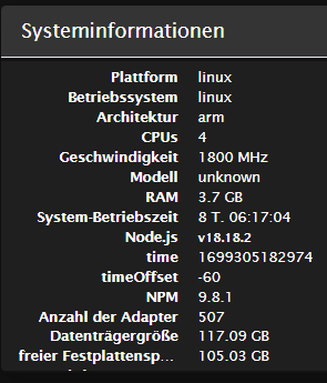

              *** FILESYSTEM ***
              /dev/root      ext4      118G   13G  101G  11% /
              devtmpfs       devtmpfs  1.6G     0  1.6G   0% /dev
              tmpfs          tmpfs     1.9G  3.5M  1.9G   1% /dev/shm
              tmpfs          tmpfs     759M  880K  758M   1% /run
              /dev/sda1      vfat      253M   52M  201M  21% /boot
              tmpfs          tmpfs     380M     0  380M   0% /run/user/999
              tmpfs          tmpfs     380M     0  380M   0% /run/user/1000
