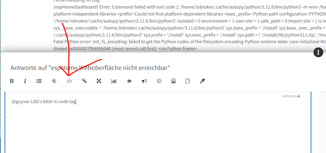

        arteck Developer Most Active @Guyver last edited by
        @guyver LOG's bitte in code tag
