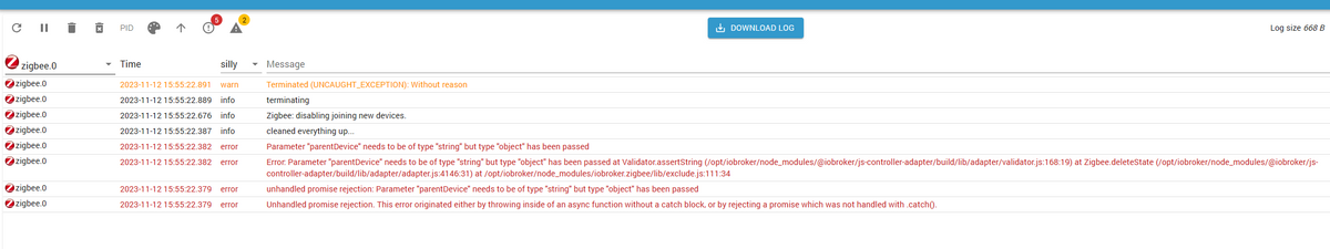

          @thomas-braun ok, hier mit etwas mehr Geräusch:
          Thomas Braun arteck 2 Replies Last reply Reply Quote 0

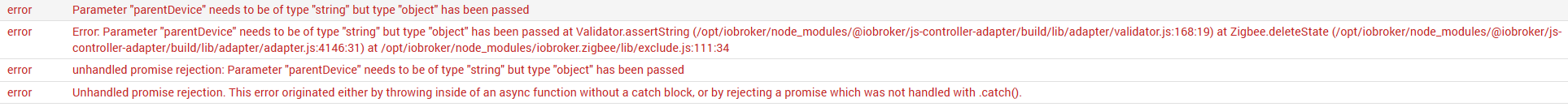

              	2023-11-12 15:55:58.350	info	Starting Zigbee npm ...
              zigbee.0
              2023-11-12 15:55:58.348	info	delete old Backup files. keep only last 10
              zigbee.0
              2023-11-12 15:55:58.201	info	starting. Version 1.8.24 in /opt/iobroker/node_modules/iobroker.zigbee, node: v18.17.1, js-controller: 5.0.12
              zigbee.0
              2023-11-12 15:55:22.891	warn	Terminated (UNCAUGHT_EXCEPTION): Without reason
              zigbee.0
              2023-11-12 15:55:22.889	info	terminating
              zigbee.0
              2023-11-12 15:55:22.676	info	Zigbee: disabling joining new devices.
              zigbee.0
              2023-11-12 15:55:22.387	info	cleaned everything up...
              zigbee.0
              2023-11-12 15:55:22.382	error	Parameter "parentDevice" needs to be of type "string" but type "object" has been passed
              zigbee.0
              2023-11-12 15:55:22.382	error	Error: Parameter "parentDevice" needs to be of type "string" but type "object" has been passed at Validator.assertString (/opt/iobroker/node_modules/@iobroker/js-controller-adapter/build/lib/adapter/validator.js:168:19) at Zigbee.deleteState (/opt/iobroker/node_modules/@iobroker/js-controller-adapter/build/lib/adapter/adapter.js:4146:31) at /opt/iobroker/node_modules/iobroker.zigbee/lib/exclude.js:111:34
              zigbee.0
              2023-11-12 15:55:22.379	error	unhandled promise rejection: Parameter "parentDevice" needs to be of type "string" but type "object" has been passed
              zigbee.0
              2023-11-12 15:55:22.379	error	Unhandled promise rejection. This error originated either by throwing inside of an async function without a catch block, or by rejecting a promise which was not handled with .catch().
                arteck Developer Most Active @ccbuddy last edited by
                @ccbuddy hmm.. der Fehler sollte schon behoben sein ..im GIT...

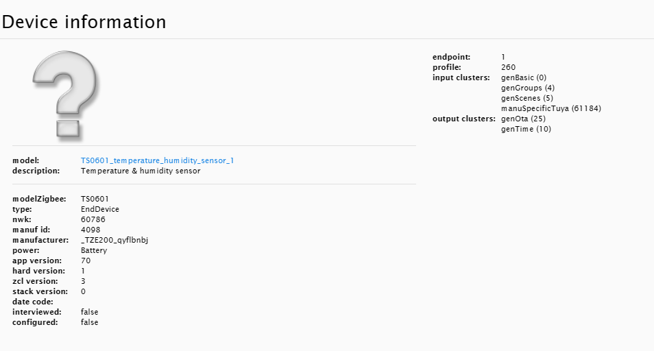

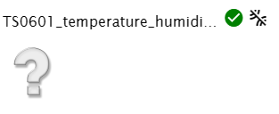

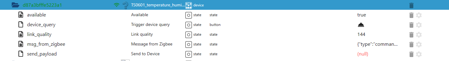

                      ich habe das Problem gelöst indem ich alle möglichen Thermometer in /opt/iobroker/node_modules/zigbee-herdsman-converters/devices/tuya.js durchprobiert habe
                      Wenn ich am Modell ZG-227ZL den Fingerprint meines Thermometers ('_TZE200_qyflbnbj') hinten dran hänge, so wie hier:
                          fingerprint: tuya.fingerprint('TS0601', ['_TZE200_qoy0ekbd', '_TZE200_znbl8dj5', '_TZE200_a8sdabtg',        '_TZE200_qyflbnbj'         ]),
                          model: 'ZG-227ZL',
                      dann kann ich die Datenpunkte:
                      [1, 'temperature'
                      [2, 'humidity'
                      [4, 'battery'
                      im Object Tree verwenden
                      (den derzeitigen Match unter
                          fingerprint: [{ modelID: 'TS0601', manufacturerName: '_TZE200_bq5c8xfe' },
                              { modelID: 'TS0601', manufacturerName: '_TZE200_bjawzodf' },
                              //{ modelID: 'TS0601', manufacturerName: '_TZE200_qyflbnbj' },
                              { modelID: 'TS0601', manufacturerName: '_TZE200_vs0skpuc' },
                              { modelID: 'TS0601', manufacturerName: '_TZE200_44af8vyi' },
                              { modelID: 'TS0601', manufacturerName: '_TZE200_zl1kmjqx' }],
                          model: 'TS0601_temperature_humidity_sensor_1',
                      habe ich auskommentiert, damit es keine Überlappungen gibt
                      Leider bin ich nicht so recht der Guru im ZigBee Adapter Code. Aber falls sich jemand angesprochen fühlt, darf er das gerne im GIT einchecken sodass ich diese Änderung nicht mehr bei jedem Update des Zigbbe Adapter manuell machen muss
                      Für mich funktioniert dies erst mal

                          @arteck ja,ja, schon richtig; hat aber halt nicht funktioniert; genau deshalb habe ich den thread ja aufgemacht.
                          So wie es für mich aussieht, liefer mein Thermometer die Daten etwas anders verpackt als in dem Handler angenommen. Der Converter für ZG-227ZL
                              fingerprint: tuya.fingerprint('TS0601', ['_TZE200_qoy0ekbd', '_TZE200_znbl8dj5', '_TZE200_a8sdabtg', '_TZE200_dikkika5']),
                              model: 'ZG-227ZL',
                              vendor: 'TuYa',
                              description: 'Temperature & humidity LCD sensor',
                              fromZigbee: [tuya.fz.datapoints],
                              toZigbee: [tuya.tz.datapoints],
                              configure: tuya.configureMagicPacket,
                              exposes: [e.temperature(), e.humidity(), tuya.exposes.temperatureUnit(), tuya.exposes.temperatureCalibration(),
                                  tuya.exposes.humidityCalibration(), e.battery()],
                              whiteLabel: [
                                  tuya.whitelabel('TuYa', 'ZG-227Z', 'Temperature and humidity sensor', ['_TZE200_a8sdabtg']),
                                  tuya.whitelabel('KOJIMA', 'KOJIMA-THS-ZG-LCD', 'Temperature and humidity sensor', ['_TZE200_dikkika5']),
                              meta: {
                                  tuyaDatapoints: [
                                      [1, 'temperature', tuya.valueConverter.divideBy10],
                                      [2, 'humidity', tuya.valueConverter.raw],
                                      [4, 'battery', tuya.valueConverter.raw],
                                      [9, 'temperature_unit', tuya.valueConverter.temperatureUnit],
                                      [23, 'temperature_calibration', tuya.valueConverter.divideBy10],
                                      [24, 'humidity_calibration', tuya.valueConverter.raw],
                          mapped die Datenpunkte anders; siehe meta:...
                          im "msg_from_zigbee" Datensatz aus dem Object Tree liefert er z.B. auch :
                          {"type":"commandDataResponse","data":{"seq":63232,"dpValues":[{"dp":1,"datatype":2,"data":{"type":"Buffer","data":[0,0,0,210]}}]},"linkquality":63,"groupID":0,"cluster":"manuSpecificTuya","meta":{"zclTransactionSequenceNumber":95,"manufacturerCode":null,"frameControl":{"frameType":1,"manufacturerSpecific":false,"direction":1,"disableDefaultResponse":false,"reservedBits":0}},"endpoint_id":1}
                          Die Temperatur ist 21,0°C; die dp 1 ist für Temperatur, 2 wäre für Humidity
