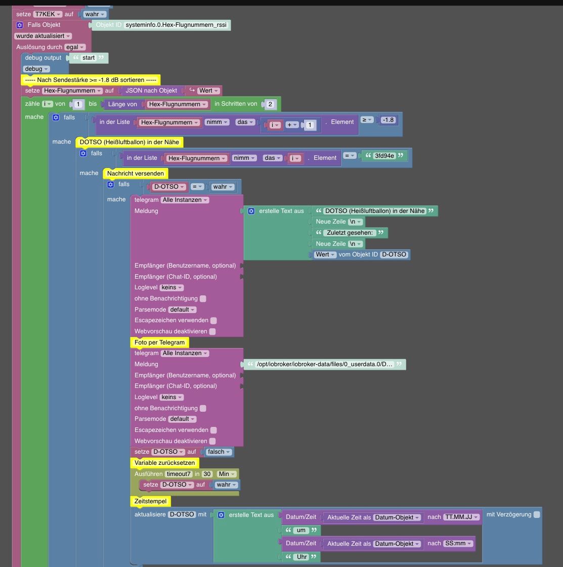

      Das hier gemacht:
      ["479a3a",-22.6,"3d9b57",-25.9,"3ddddc",-24.9,"3db388",-17.5,"3c49cb",-9.5,"780d8f",-23.9,"4aca83",-18.9,"3c66e6",-23.5,"346156",-26.5,"3c55c5",-25.4,"a247a2",-13.6,"3c4d66",-26.5,"3d2a59",-15.2,"502d3f",-26.3,"4ca263",-22.7,"3ea048",-22.8,"010243",-25.4,"7816be",-22.8,"342059",-23.4,"3c1cb9",-23.3,"461fa7",-16.8,"4d03ce",-21.6,"4d2093",-17.5,"4d225a",-25.8,"a14bf6",-24.3,"345692",-24.1,"3ce600",-19.6,"4bb147",-23.7,"740735",-22.4,"44cdc8",-7.7,"48c127",-21.1,"3d2802",-21.6,"3d250b",-25.3,"486491",-27,"3d09fe",-23.5,"486258",-26,"486482",-20.1,"484c1b",-24.9,"4d24a6",-18.6,"480c44",-16.4,"4d236b",-24.7,"485206",-3.5,"4d2127",-10.3,"3d2b7a",-25.3,"461e21",-5.8,"485207",-12.1,"484fdf",-12,"4bb194",-14,"3d1c25",-24.8,"ac3da6",-20.9,"484c9b",-7.4,"89408e",-21.3,"4864ef",-25,"4bcdd6",-4.1,"4ca660",-9.4,"48418a",-4.9,"78140f",-12.1,"4d2449",-10.3,"47a097",-26.3,"47c0fd",-24.7,"45ac2f",-10.8,"461e17",-11.4,"484ee4",-21.3,"3eab7d",-23.7,"507c39",-23.7,"3d05d9",-2.6,"4aca81",-16.4,"4791a0",-25.8,"3c65d8",-25,"4075fd",-22.2,"3c10aa",-23.4,"4cae49",-23.4,"4cac86",-23.8,"3c6670",-11,"3c4b45",-19.7,"4ca620",-8.1,"485873",-23.9,"400a5b",-26.5,"48af02",-20.5,"3e27ac",-25,"341646",-24.9,"3d100a",-24.5,"3e28b8",-20]
      Das konnte ich dann auswerten.

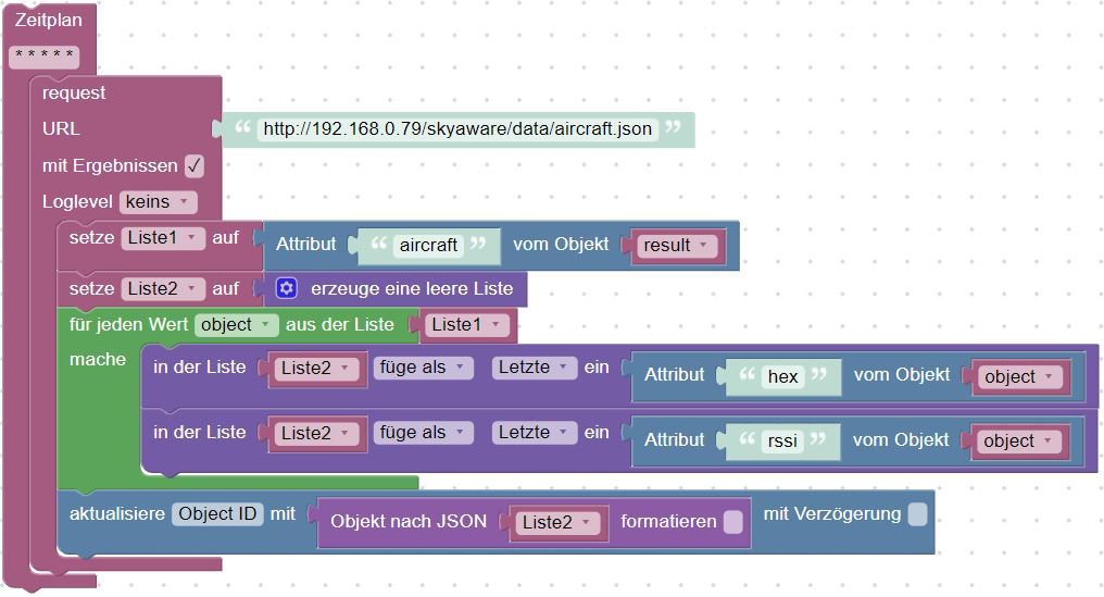

            @capitaenz sagte: Das hier gemacht:
            Versuche es mal so:
            capitaenz 2 Replies Last reply Reply Quote 0
            • capitaenz
              capitaenz @paul53 last edited by
              Hey DANKE! 😃
              Hab es nur kurz getestet und es schaut gut aus!
