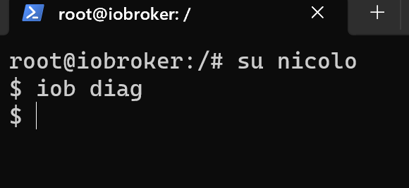

            • Nicoloma
              Nicoloma @Thomas Braun last edited by
                Thomas Braun Most Active @Nicoloma last edited by Thomas Braun
                @nicoloma
                Und jetzt alle im Chor...
                Wir melden uns NICHT als root an und kaspern damit über das System...

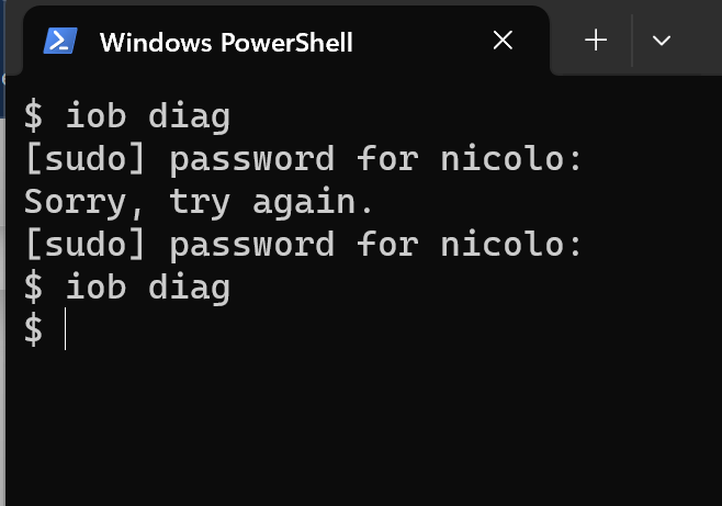

                • Nicoloma
                  hatte ich auch nicht..
                    @nicoloma
                    Bitte keine Screenshors von Text. Was soll das für ein LoginPrompt sein?
                    So schaut das auf einem aktuellen Linux in der bash aus:
                    echad@chet:~ $ groups
                    echad adm dialout cdrom sudo audio video plugdev games users input render netdev gpio i2c spi iobroker
                    echad@chet:~ $

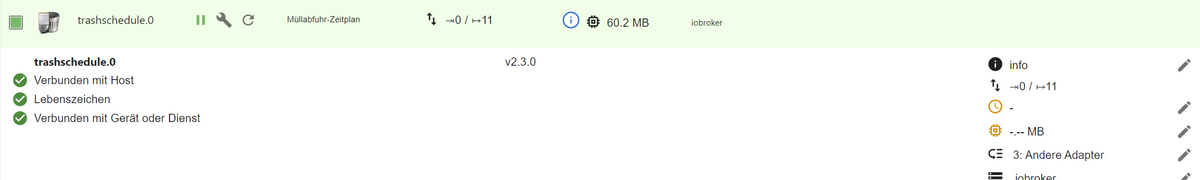

                                  2023-11-24 21:25:58.464  - error: host.iobroker Caught by controller[10]: 13: 0x12f933d v8::internal::Runtime_StringCharCodeAt(int, unsigned long*, v8::internal::Isolate*) [/usr/bin/node]
                                  2023-11-24 21:25:58.464  - error: host.iobroker Caught by controller[11]: 14: 0x1705b39  [/usr/bin/node]
                                  2023-11-24 21:25:58.464  - warn: host.iobroker instance system.adapter.trashschedule.0 terminated due to SIGABRT
                                  2023-11-24 21:26:15.274  - warn: hass.0 (7464) State "hass.0.entities.device_tracker.s21_von_espe_2.connected_to" has no existing object, this might lead to an error in future versions
                                  2023-11-24 21:26:15.274  - warn: hass.0 (7464) State "hass.0.entities.device_tracker.s21_von_espe_2.connection_type" has no existing object, this might lead to an error in future versions
                                  2023-11-24 21:26:15.274  - warn: hass.0 (7464) State "hass.0.entities.device_tracker.s21_von_espe_2.ssid" has no existing object, this might lead to an error in future versions
                                  2023-11-24 21:26:29.330  - error: host.iobroker Caught by controller[0]: <--- Last few GCs --->
                                  2023-11-24 21:26:29.330  - error: host.iobroker Caught by controller[0]: [33518:0x5e306c0]      720 ms: Mark-sweep (reduce) 19.1 (20.8) -> 18.4 (21.3) MB, 4.4 / 0.0 ms  (+ 0.4 ms in 30 steps since start of marking, biggest step 0.0 ms, walltime since start of marking 31 ms) (average mu = 0.901, current mu = 0.877) allocation f[33518:0x5e306c0]      739 ms: Mark-sweep (reduce) 19.9 (21.3) -> 18.5 (21.5) MB, 4.3 / 0.0 ms  (+ 0.3 ms in 15 steps since start of marking, biggest step 0.0 ms, walltime since start of marking 18 ms) (average mu = 0.862, current mu = 0.757) allocation f
                                  2023-11-24 21:26:29.330  - error: host.iobroker Caught by controller[0]: <--- JS stacktrace --->
                                  2023-11-24 21:26:29.330  - error: host.iobroker Caught by controller[1]: FATAL ERROR: Reached heap limit Allocation failed - JavaScript heap out of memory
                                  2023-11-24 21:26:29.330  - error: host.iobroker Caught by controller[2]:  1: 0xb85bc0 node::Abort() [/usr/bin/node]
                                  2023-11-24 21:26:29.330  - error: host.iobroker Caught by controller[3]:  2: 0xa94834  [/usr/bin/node]
                                  2023-11-24 21:26:29.330  - error: host.iobroker Caught by controller[4]:  3: 0xd66d10 v8::Utils::ReportOOMFailure(v8::internal::Isolate*, char const*, bool) [/usr/bin/node]
                                  2023-11-24 21:26:29.330  - error: host.iobroker Caught by controller[5]:  4: 0xd670b7 v8::internal::V8::FatalProcessOutOfMemory(v8::internal::Isolate*, char const*, bool) [/usr/bin/node]
                                  2023-11-24 21:26:29.330  - error: host.iobroker Caught by controller[6]:  5: 0xf447c5  [/usr/bin/node]
                                  2023-11-24 21:26:29.331  - error: host.iobroker Caught by controller[7]:  6: 0xf56cad v8::internal::Heap::CollectGarbage(v8::internal::AllocationSpace, v8::internal::GarbageCollectionReason, v8::GCCallbackFlags) [/usr/bin/node]
                                  2023-11-24 21:26:29.331  - error: host.iobroker Caught by controller[8]:  7: 0xf313ae v8::internal::HeapAllocator::AllocateRawWithLightRetrySlowPath(int, v8::internal::AllocationType, v8::internal::AllocationOrigin, v8::internal::AllocationAlignment) [/usr/bin/node]
                                  2023-11-24 21:26:29.331  - error: host.iobroker Caught by controller[9]:  8: 0xf32777 v8::internal::HeapAllocator::AllocateRawWithRetryOrFailSlowPath(int, v8::internal::AllocationType, v8::internal::AllocationOrigin, v8::internal::AllocationAlignment) [/usr/bin/node]
                                  2023-11-24 21:26:29.331  - error: host.iobroker Caught by controller[10]:  9: 0xf1394a v8::internal::Factory::NewFillerObject(int, v8::internal::AllocationAlignment, v8::internal::AllocationType, v8::internal::AllocationOrigin) [/usr/bin/node]
                                  2023-11-24 21:26:29.331  - error: host.iobroker Caught by controller[11]: 10: 0x12d8caf v8::internal::Runtime_AllocateInYoungGeneration(int, unsigned long*, v8::internal::Isolate*) [/usr/bin/node]
                                  2023-11-24 21:26:29.331  - error: host.iobroker Caught by controller[12]: 11: 0x1705b39  [/usr/bin/node]
                                  2023-11-24 21:26:29.331  - warn: host.iobroker instance system.adapter.trashschedule.0 terminated due to SIGABRT

                                      • Nicoloma
                                        Hallo Jungs und Mädels,
                                        ich habe immer noch das gleiche Problem.
                                        Kann bitte mir einer versuchen nochmal zu helfen. Mein Web adapter bzw VIS funktioniert nicht. Er zeigt keine fehlermeldung im Log an aber ich kann es nicht aufrufen.
                                        Ich wäre euch sehr verbunden
